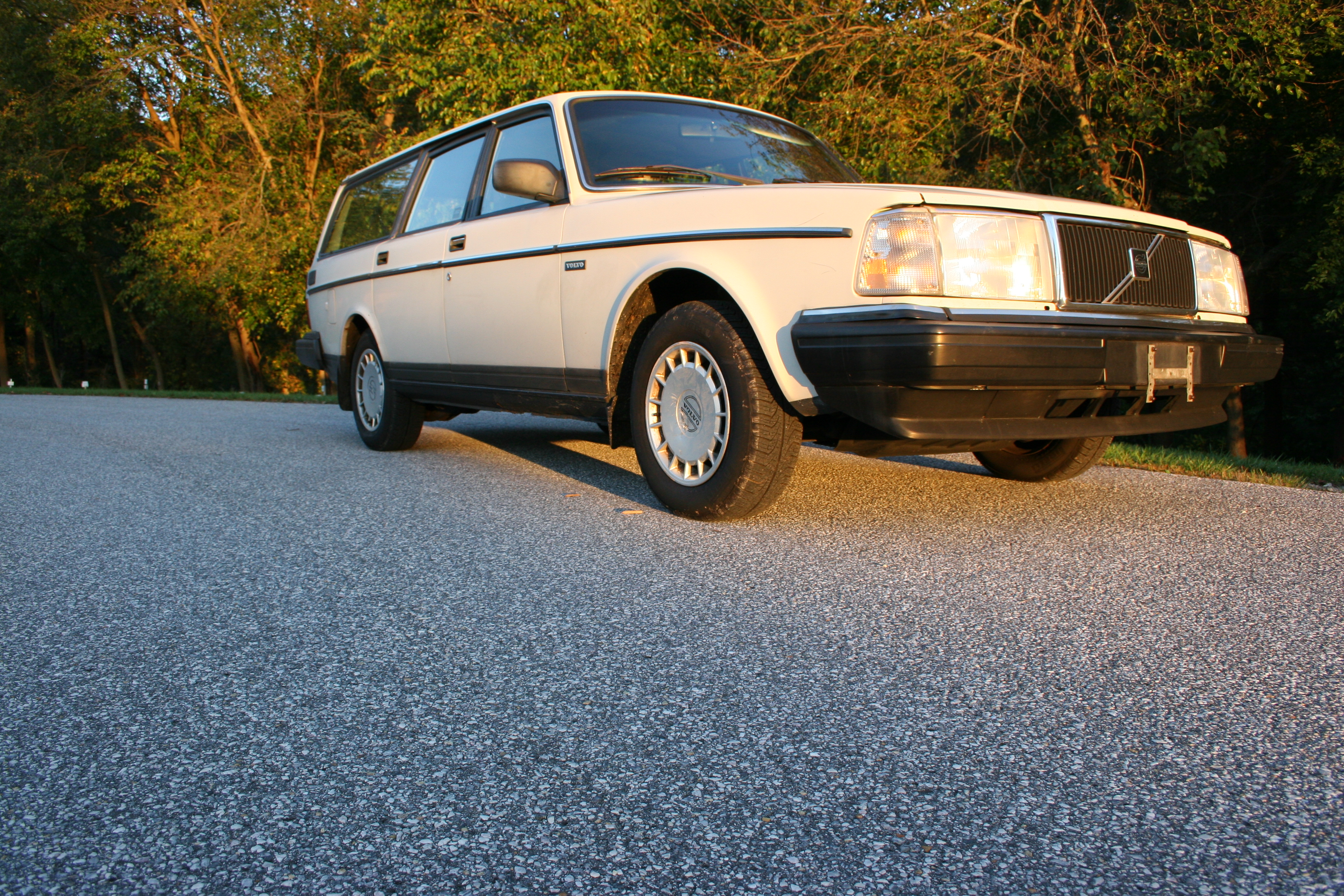

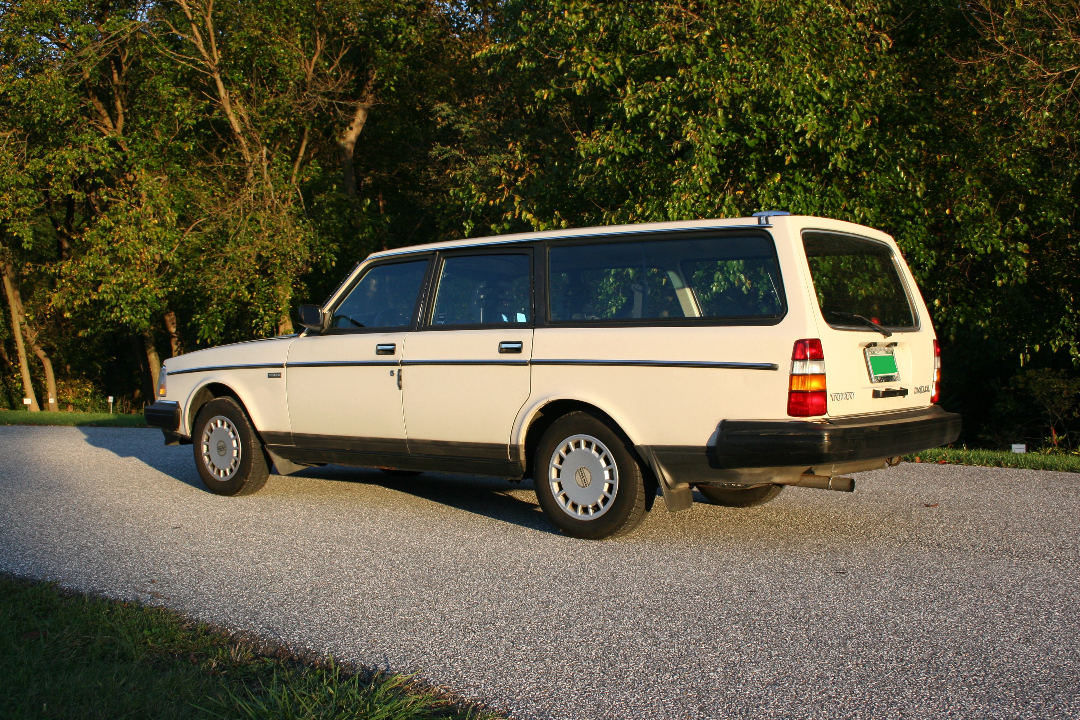

SO, enough with the backstory, here's the 1987 Volvo 240DL Wagon that I bought a few weeks ago after a long time wishing I had something of my own as well as a second car that wouldn't be as inevitably boring as a bone stock honda civic. I went for the wagon so the end result would be fun and still useful! The look of this car really dawned on me and I fell in love real quick.

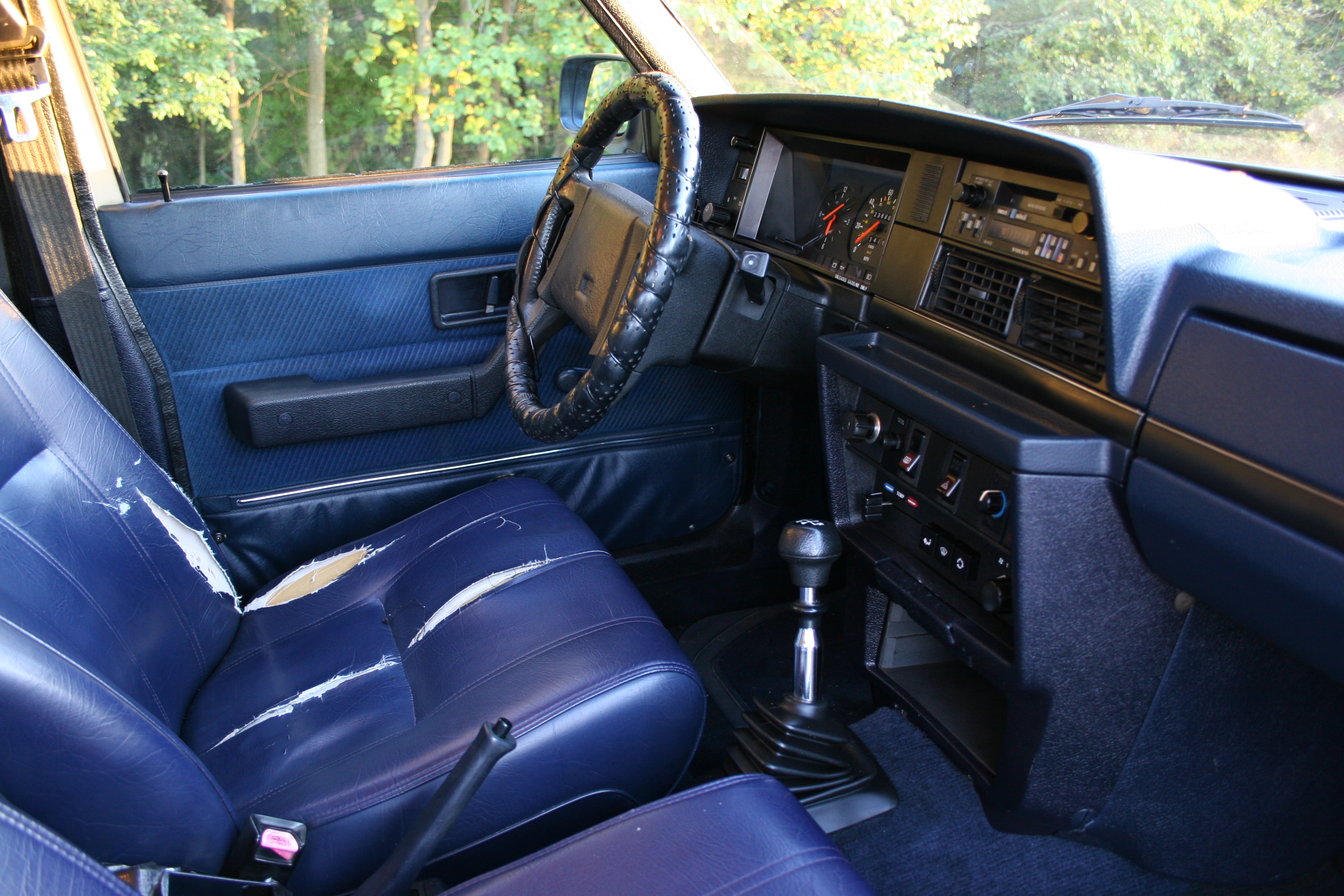

Interior is in very good shape, only the driver's seat and center armrest console are the only damaged bits, most everything else is pretty mint which is exciting!

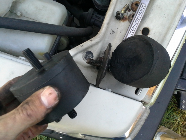

Motor/trans mounts came first:
As you can see the passenger's side was completely failed and floating. We lifted the engine with the cherry-picker and had a hell of a time getting this side in and out. Mistake was not just completely removing the brackets as a unit, which made the left side much easier. The trans mount was much simpler, and looked to be warped due to careless installation a long time ago. I could see why when installing the new one, the torque on the bolt would twist it out of position on the last turn or so and unless it was braced it would warp itself immediately.

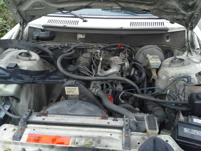

love the engine bay, looks like heaven to work in.

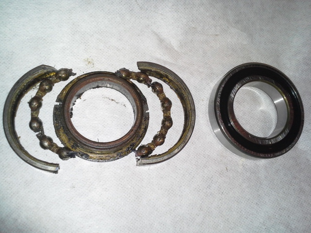

A DIY exploded view of the old center support bearing with the new one on the right.

dana wrote:love the engine bay, looks like heaven to work in.
My thoughts exactly when I saw it for the first time. Intake/fuel assembly is elevated and easy to access, exhaust side has a ton of clearance (due to the absence of a turbo... :shame: ). If you drop a tool through onto to ground, you can often just reach through the bay and grab it!

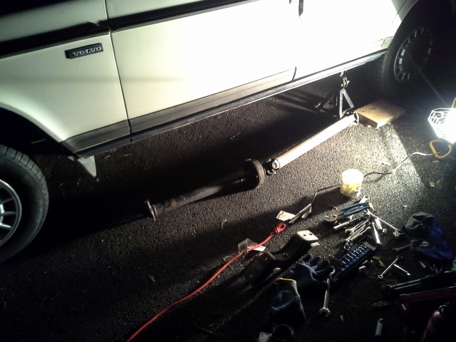

1. Disconnected the driveshaft intact.
No-wheel drive conversion complete!
Pretty simple, made some half-assed alignment marks that mostly wore off during cleaning (luckily there are arrows etched into the two shafts), dropped the crossmember (sandblasted and powdercoated as a sort of test by vt10vt) and

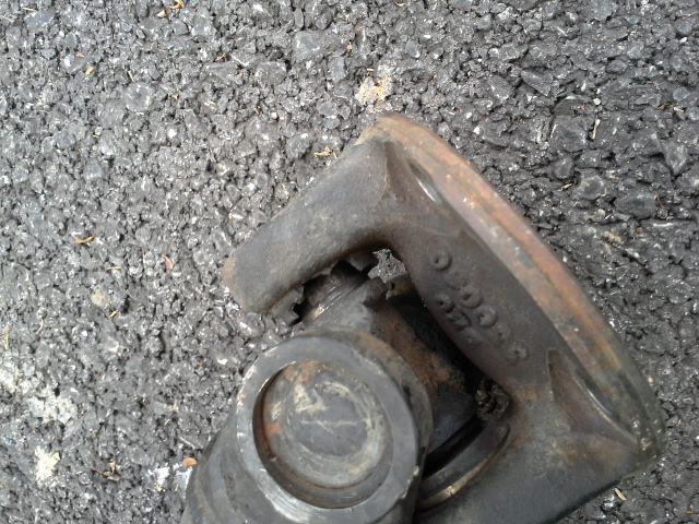

The u-joints were a different story. One of the rear joint's bearings/cups was completely failed and seized into the yolk.
The spider took a beating.
Here you can see where the rollers inside the bearing were smashed into the spider, pretty wild IMO.
I tried to press them out with two different vices and a socket, no luck whatsoever. Tried hammering them out, nothing. At this point I was nervous about damaging the driveshaft components and running out of options so vt10vt came through with a connection at a machine shop and he pressed them out no problem for cheap. :hail:

3. Center support bearing
Props to creativity from vt10vt and gregdell1121 when pulling the old bearing off the front section of the driveshaft:
After cutting rest of the bearing off, vt10vt decided to mention he has a puller. You know, after we violently removed all gripping surface. Gettng on and staying on the back of the inner race with the arms of the puller required sharpening the points on the claws and wrapping the arms with a hose clamp to tightly grip while the bolt was cranked.
Worked like a charm. Tapped the new bearing down using a piece of exhaust pipe and the old inner race.
Once that was done it was just a matter of fitting the rubber bearing support mount around the bearing, reinstalling the front section and the crossmember, then aligning the rear shaft using the arrows on each section to make sure the splines go in properly and everything is balanced, which it was and everything is good and road tested. :)

After looking into it a little bit, I'm inclined to say this is what will ultimately happen to the car.
For now I need to make sure it's gonna be on the road and running right so I can get to work until the "other car" situation is resolved. BUT once the car can become a real project again, the V8 setup seems like a more reliable option considering it could be a bench-build and N/A torque :thumbsup: for little $ and hopefully less headache than a turbo conversion.
That said she is running OK most of the time. Sputtering and sometimes just losing power, especially when starting from a stop...today it did it in traffic on the beltway. So that's kind of a bitch...but she always comes back.
And the horn has decided to smite me by randomly honking and sometimes just getting caught in a constant honk. Fixed with a folded up piece of paper for now.
