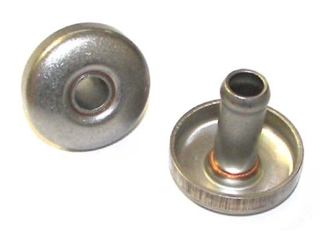

-Went to install the turbo and ran into an issue..... My motor is not set up for water cooling the K24 turbo I want to run. So I need to find a freeze plug with either an AN fitting or hose barb, make up hoses and tie it back into one of the heater core hoses. Any one have any spare parts for this? I have a call into force5 but haven't heard anything back yet. I was told the engine came from a 200q, but some early 200's had MC-1 engines. So that may be what I have? I really don't know how to tell.
This is the code on the block.
Re: Mars 83 MC2
So you have an MC engine that doesn't have this?
The only reason I can see for that is the swap retained the original oil only turbo. By the way, those freeze plug nipples are still available from 034.
