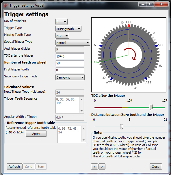

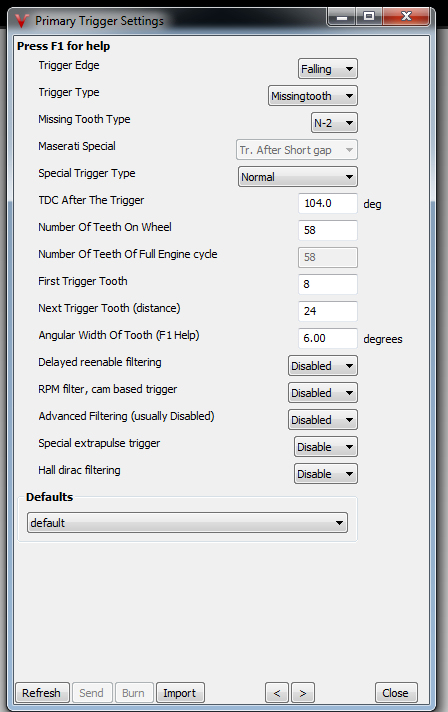

here is mine
tomorrow i will have time to explain it.
htwh
¯\_(ツ)_/¯
project 2226

OK! please do! trying to wrap my brain around what you've done...
