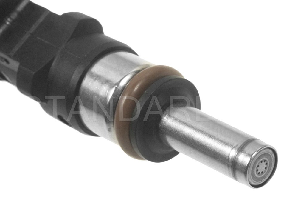

I'm really not sure about the spray pattern. The Volvo injectors are a 2 hole extended tip EV1 based injector, where as I believe the Evo X injectors are extended tip EV14 based with I think 4 holes. It can be hard to find pics of the actual injector tip. I figure with the 20vt originally being CIS, as long at the atomization is as good or better than the CIS injector, it should be ok with having the extended tip.
Re: Fuel injector selection 20vt
I was a little off on the home count... Look like the attached pic.

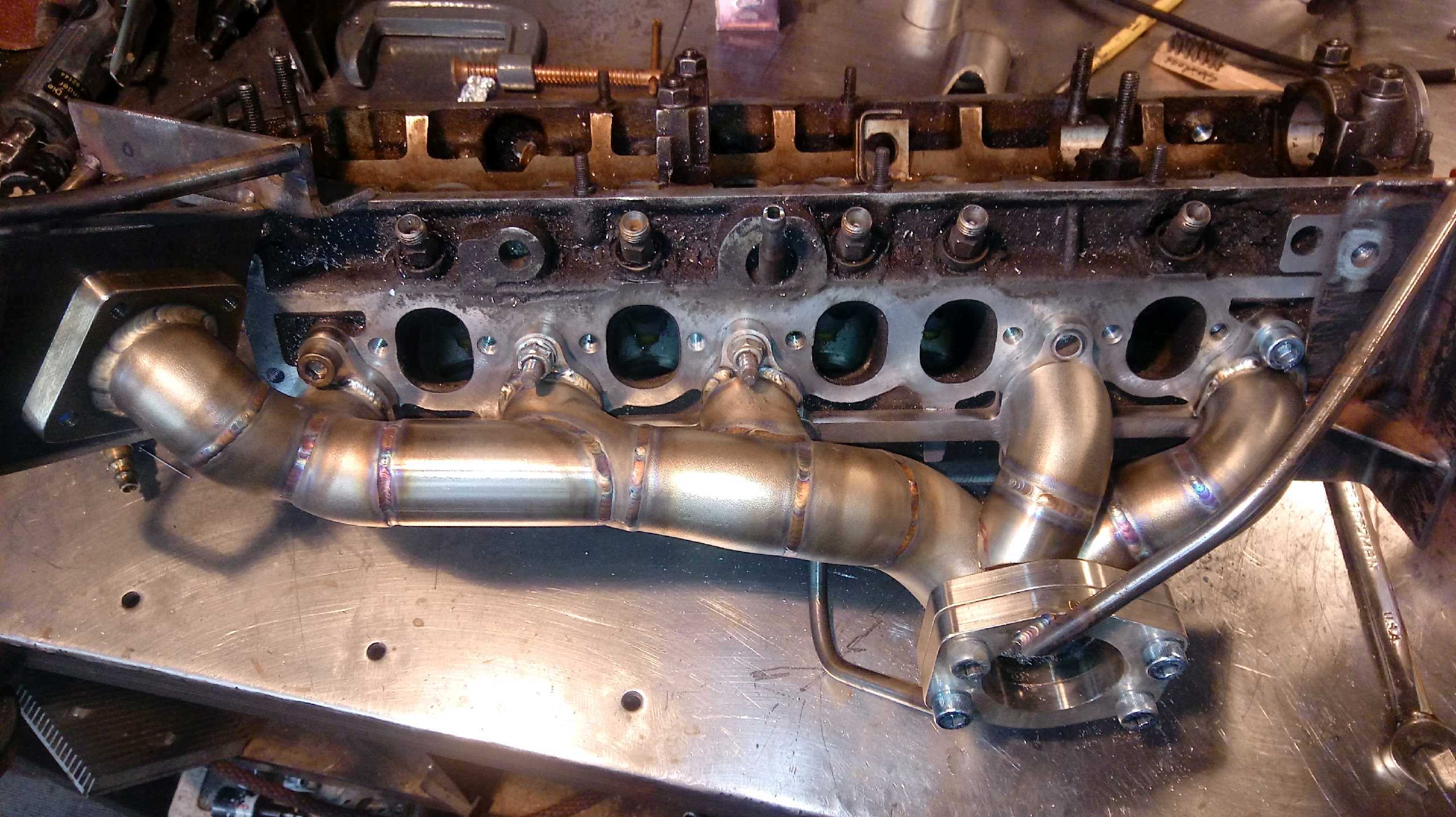

Wait! What?DE80q wrote:The new setup will have a tubular stock placement manifold...
A one-off or production item?

Mine will be a sort of prototype. But he plans to make more for those interested. Attached is a pic of it unfinished. It's missing the balance tube from the collector to the WG tube.bradyzq wrote:Wait! What?DE80q wrote:The new setup will have a tubular stock placement manifold...
- 0826180705a.jpg (356.43 KiB) Viewed 18963 times
