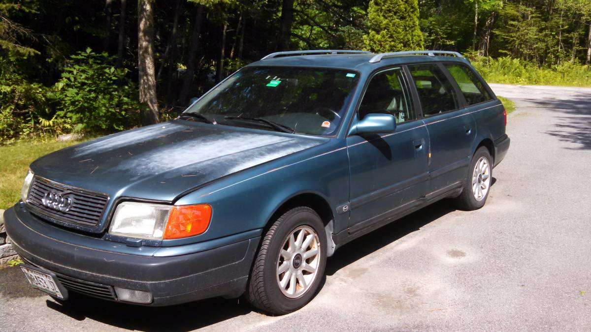

I am looking to get a c4q avant. I have found an automatic and since i would be swapping to a TDI with a 6spd manual and have a doner URS4 for linkage/axles/pedals/etc i was wondeirng what all else i would be needing to swap over. I have read that possibly the rear diff? I have read the tunnel needs modification. I have been going through Dana's thread, although his B3 is a bit different than a C4 but some good info for sure. Any info would be great

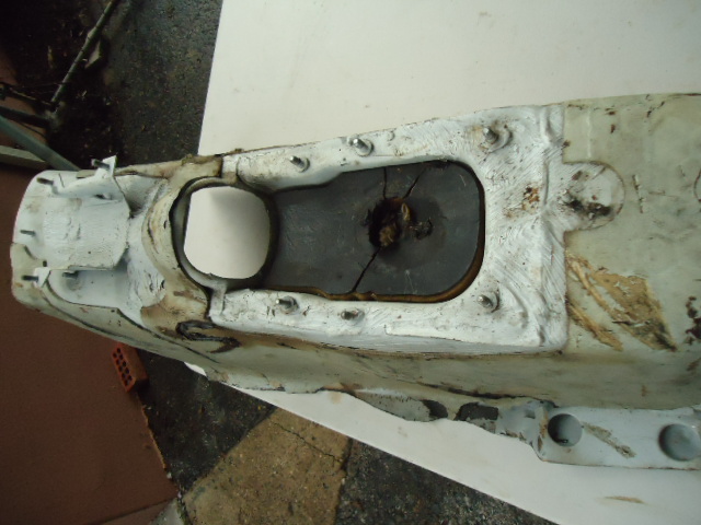

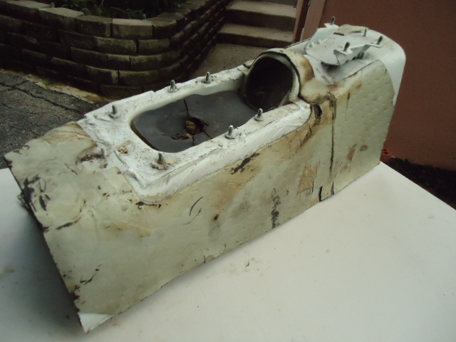

I have a trans tunnel cut from an UrS4 if you did not want to cut up your donor car.
