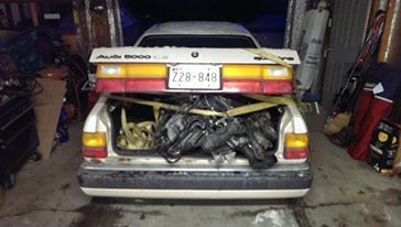

Let's start with some good old 5cyl content: the $500 5k of win bringing the engine home
The Engine.jpg (18.08 KiB) Viewed 25925 times

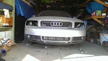

The shell losing it's 3.0l in the rents garage
The Shell.jpg (11.81 KiB) Viewed 25925 times

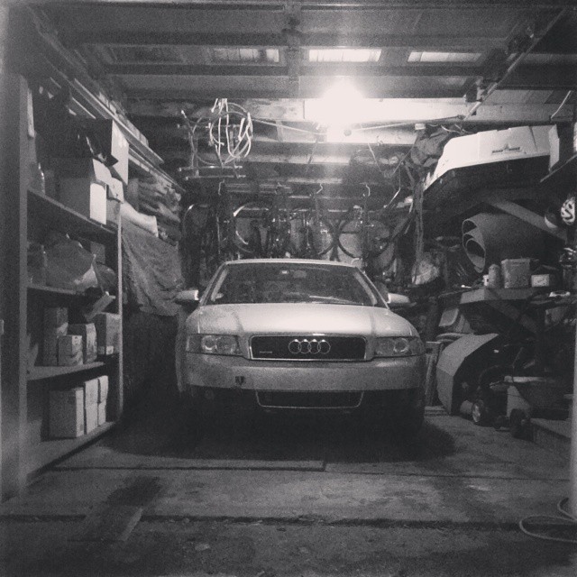

Moved to my house! I live downtown and got really lucky and have a garage and relatively big driveway
Burlington Move.jpg (103.48 KiB) Viewed 25925 times

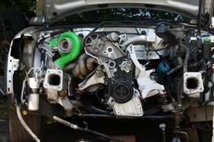

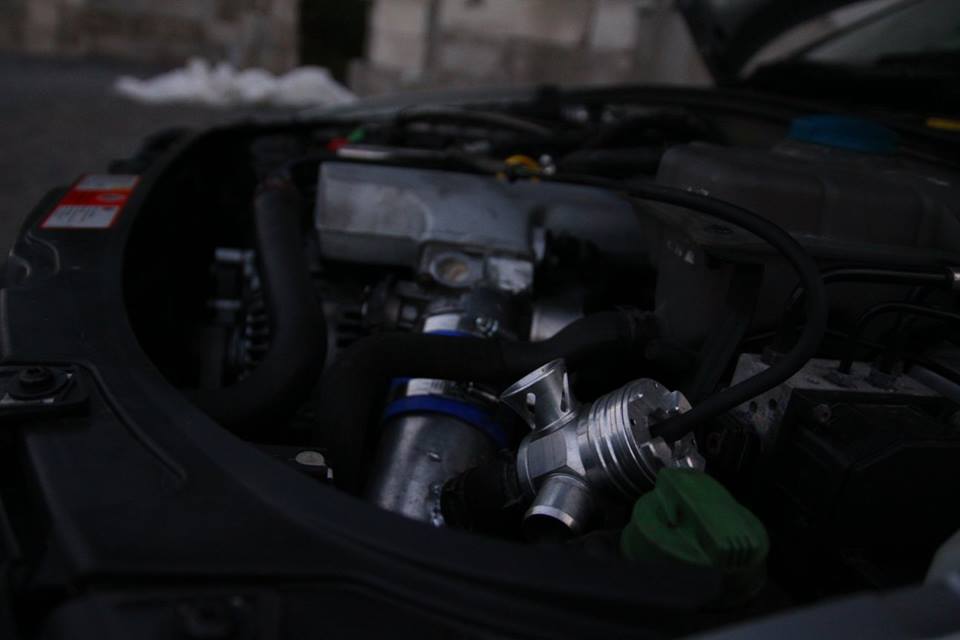

Clean engine bay
Engine Bay.jpg (18.93 KiB) Viewed 25925 times

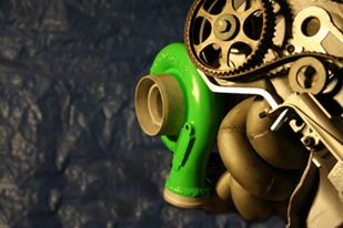

Gromit with the 7 blade HX35
Holset Gromit.jpg (23.5 KiB) Viewed 25925 times

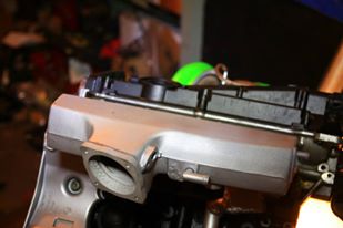

Manifold mockup
Manifold Mock Up.jpg (23.55 KiB) Viewed 25922 times

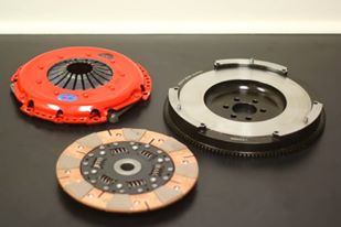

Custom 6 puck Southbend clutch and 17lb steel flywheel

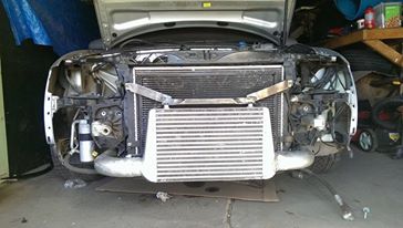

Intercooler install
Intercooler 2.jpg (16.8 KiB) Viewed 25922 times

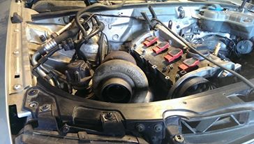

Coming together!
Artsy Manifold.jpg (15.58 KiB) Viewed 25921 times
Across Manifold.jpg (12.21 KiB) Viewed 25921 times

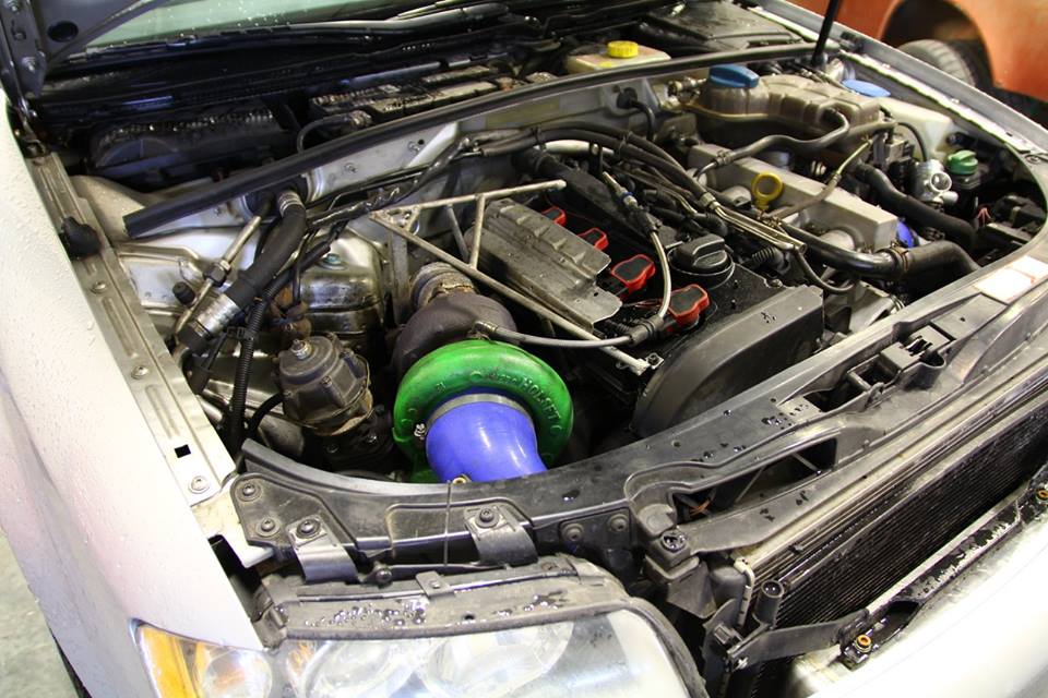

Money Shot.jpg (18.24 KiB) Viewed 25921 times
Real Bay.jpg (109.88 KiB) Viewed 25921 times

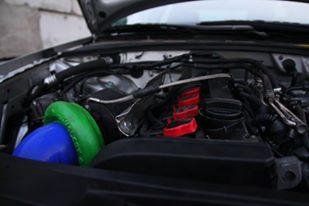

Re: Shawn's 1.8t B6: This car deserves its own thread
These aren't really photoshopped except for a couple small grease spots despite their name :)
Photoshop Bay.jpg (12.29 KiB) Viewed 25921 times
Photoshop Bay 2.jpg (33.2 KiB) Viewed 25921 times

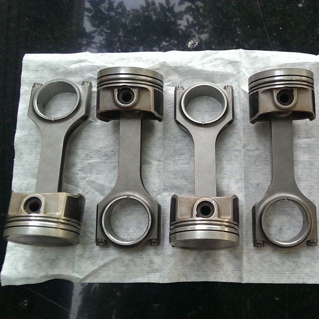

3 old and 1 new AEB pistons and reused Scat rods
New pistons 2.jpg (13.94 KiB) Viewed 25915 times
