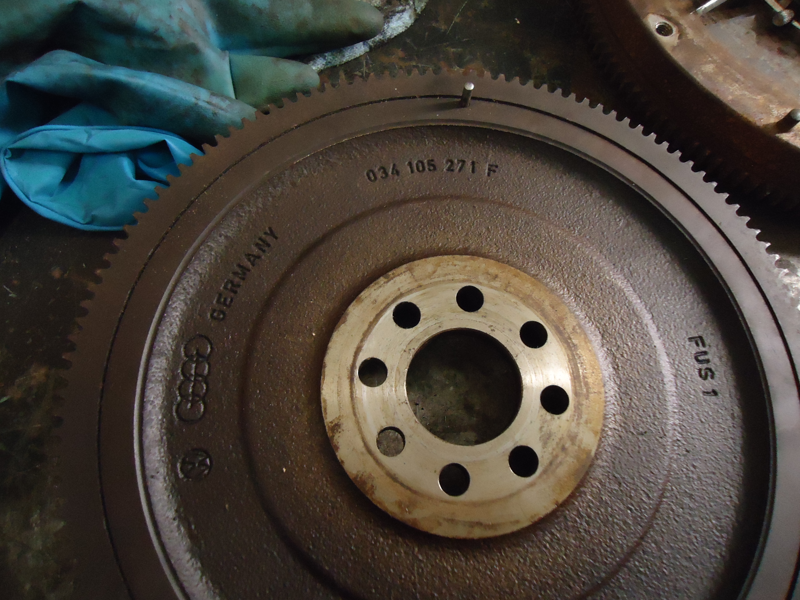

My flywheel weight data:
Stock 7a- 25lbs 6oz
"Lightened" 7a flywheel- just knocked off the weight ring off the engine side. 22lbs 13.2oz. Definitely did not remove enough material.Before picture

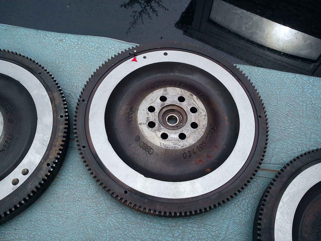

NG flywheel- 18lbs 3oz
NG. I was told this was from a 3b. Maybe a 200 with a 016 gearbox? Missing center spigot for mounting pilot bearing.

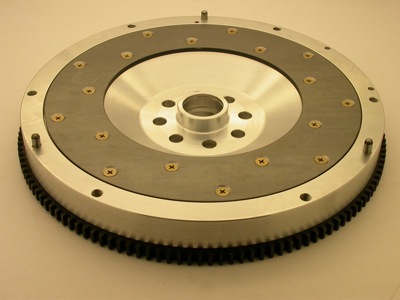

Fidanza- 10lbs 9.2 oz

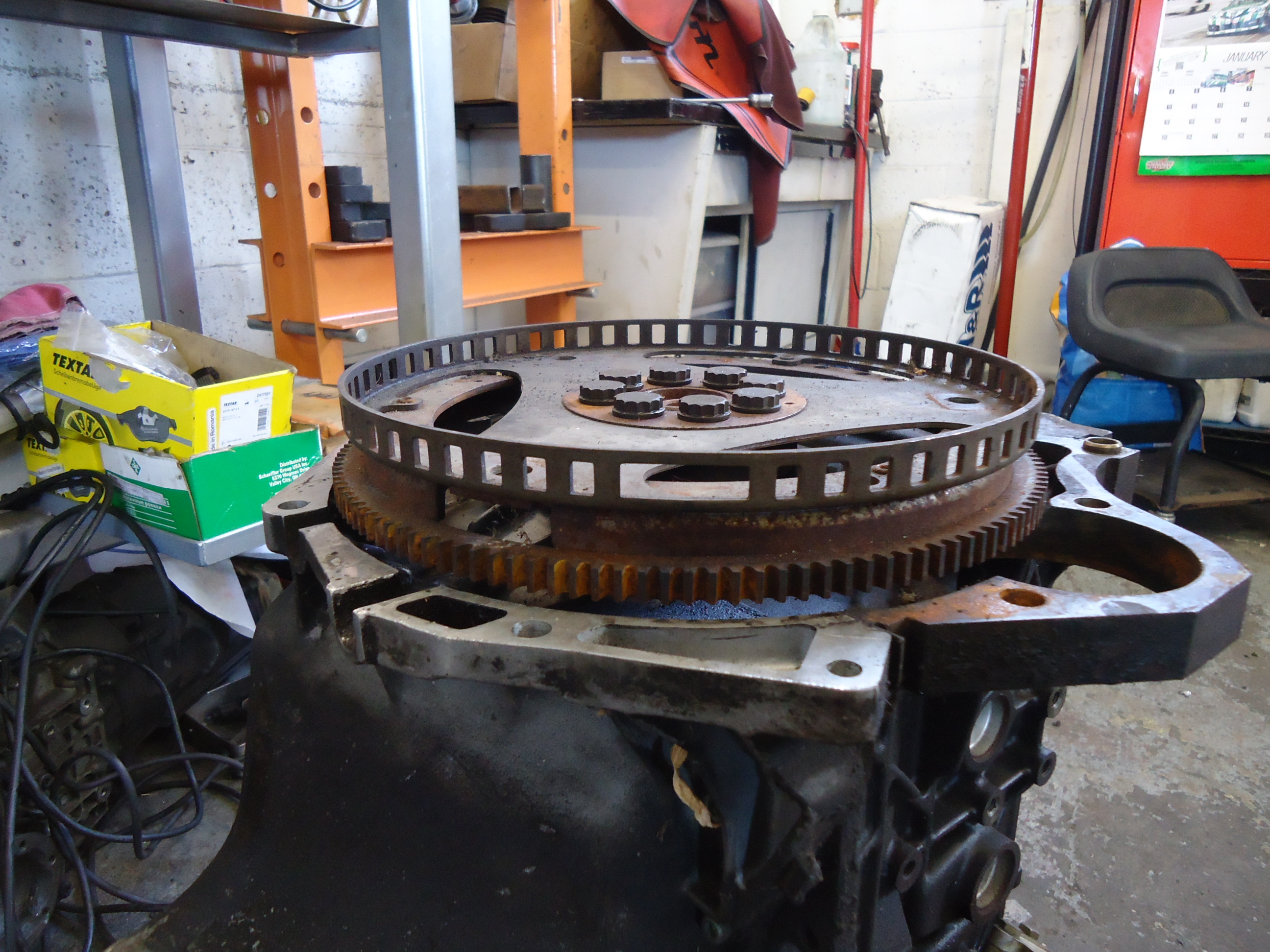

Next is a little something left over from snatching the 3.0 liter crankshaft out of an AVK motor swap we did.
AVK with automatic flywheel on a 7a engine. 22 windows between the -2 slot & the TDC timing pin on a standard flywheel. More suitable for a stand alone fuel system. Just add longer flywheel bolts & a small flywheel to attach a Tilton clutch.

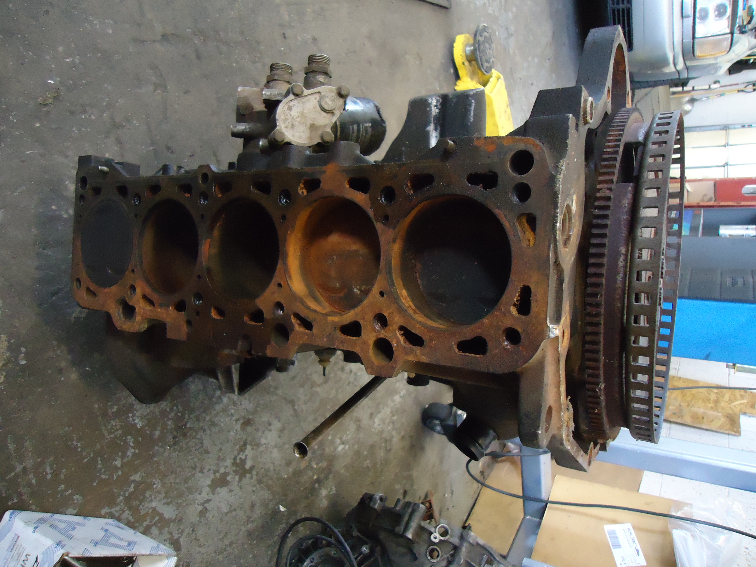

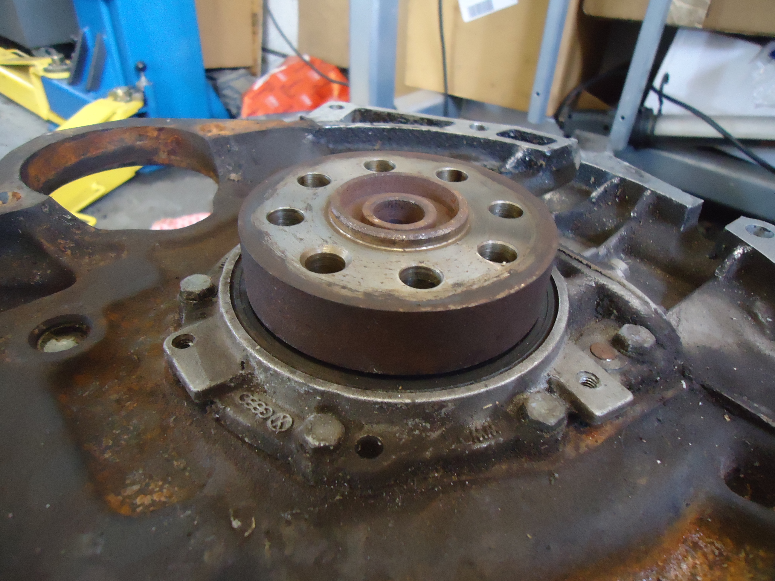

More pictures of the AVK flywheel on a 7a block. This better shows the relationship with #1cylinder @TDC & -2 window on flywheel.
Spacer used on AVK is needed for correct ring gear location on 7a crankshaft.
