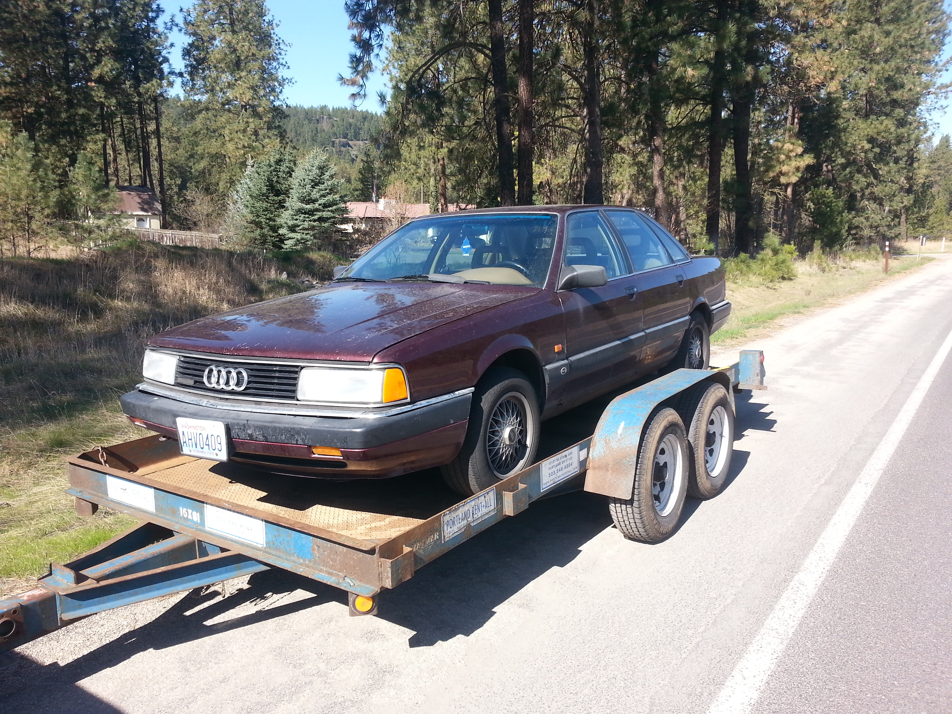

Kevin, this was a maroon car with tan interior. It came out of colorado and eastern Washington. It's really a fun car to race, has some interesting characteristics. Also everyone races bmw and mustangs etc... it's fun to have something different. I'll check out the autocraft site, the stock fenders are super lightweight, the hood though is a brick. I'm not sure what turbo to go after, the 3071 seems like plenty with good spool up, maybe I'm wrong though. I'd love to do a lot of head work, but I think that the money spent would be better other places for now. I'm also trying to get a 200 trans am shifter replica from 2 bennett. Also I have another question 3b, were thinking about setting up the engine bay for quick engine gearbox swaps, like 10min. The front clip would be quick release, 1 harness connector, quick release drive shaft and quick releqse mounts, future upgrade.

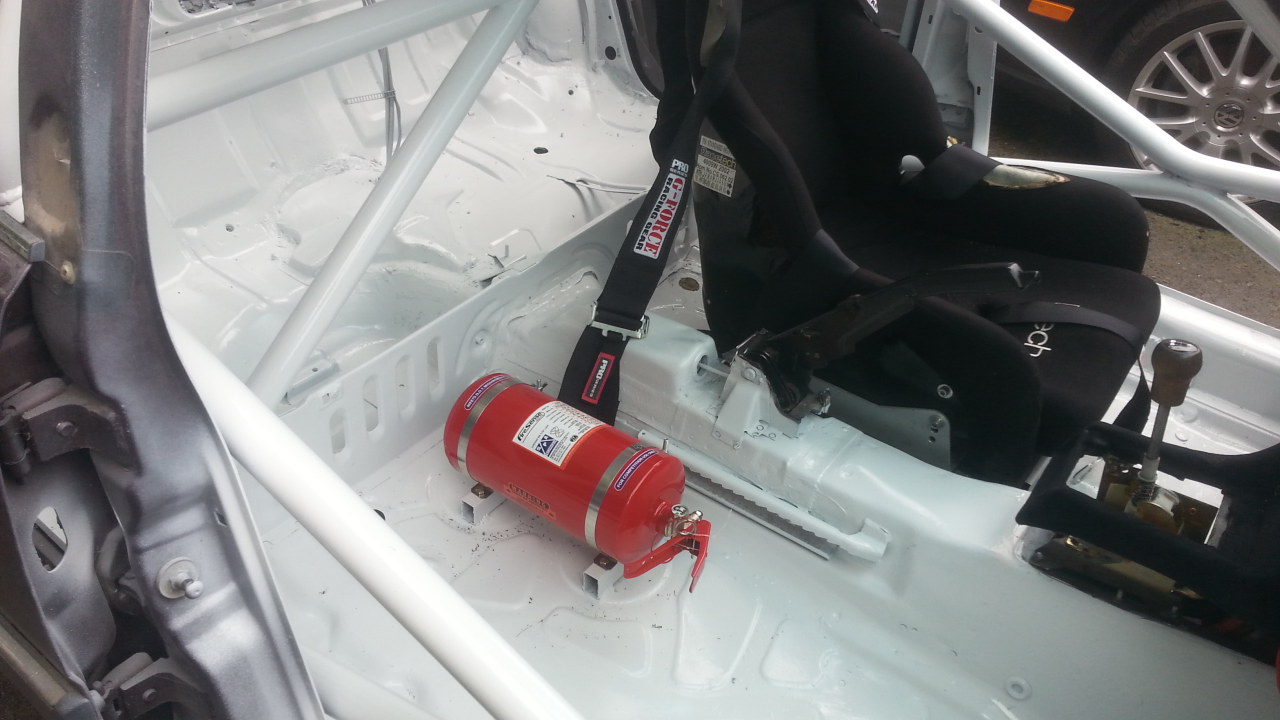

Fire system mount
Fire system mount

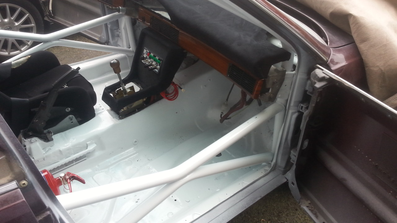

Interior
Interior

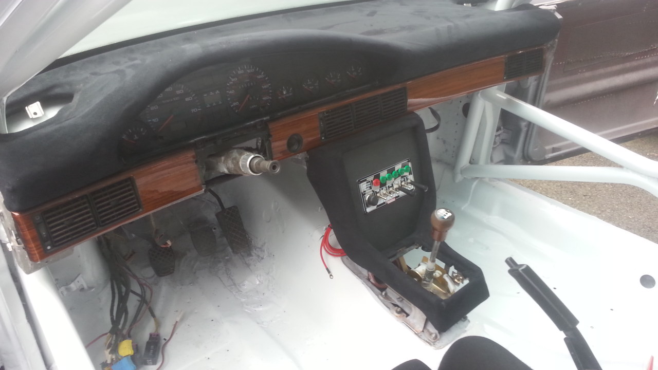

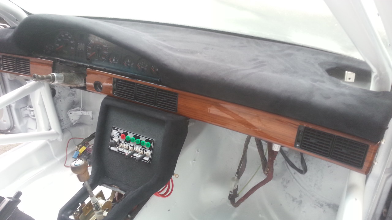

Dash, notice the wood trim, a little bit of class!! Plus the dash and center stack is wrapped in Alcantara

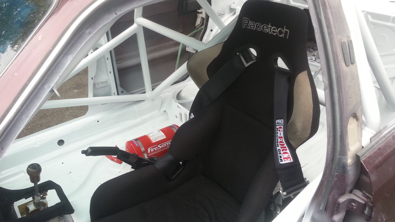

driver's position.  We stripped the car completely of the sound deading, lots or work.  The interior is painted with Dupont single stage factory pack white
RaceTech composite seat.  The seat is on dual locking sliders, plus there is an adjustable rear seat brace on the roll cage that can be adjusted during drivers changes

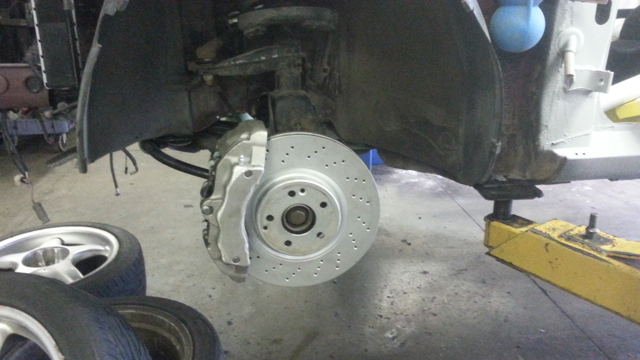

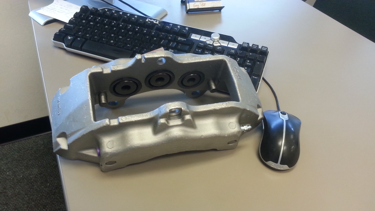

17z 6 pot calipers, we can get these for only $110 each rebuilt in raw

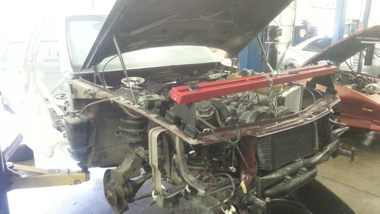

when we were working on the gearbox, constant issue
brake setup, no adapters because they weren't allowed, just some grinder work

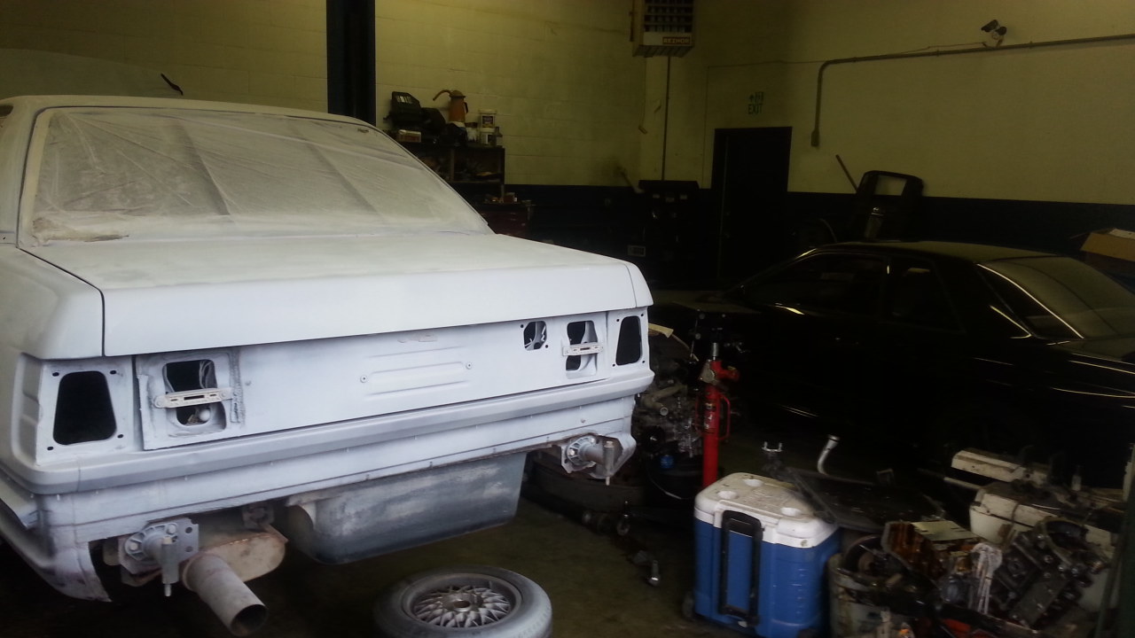

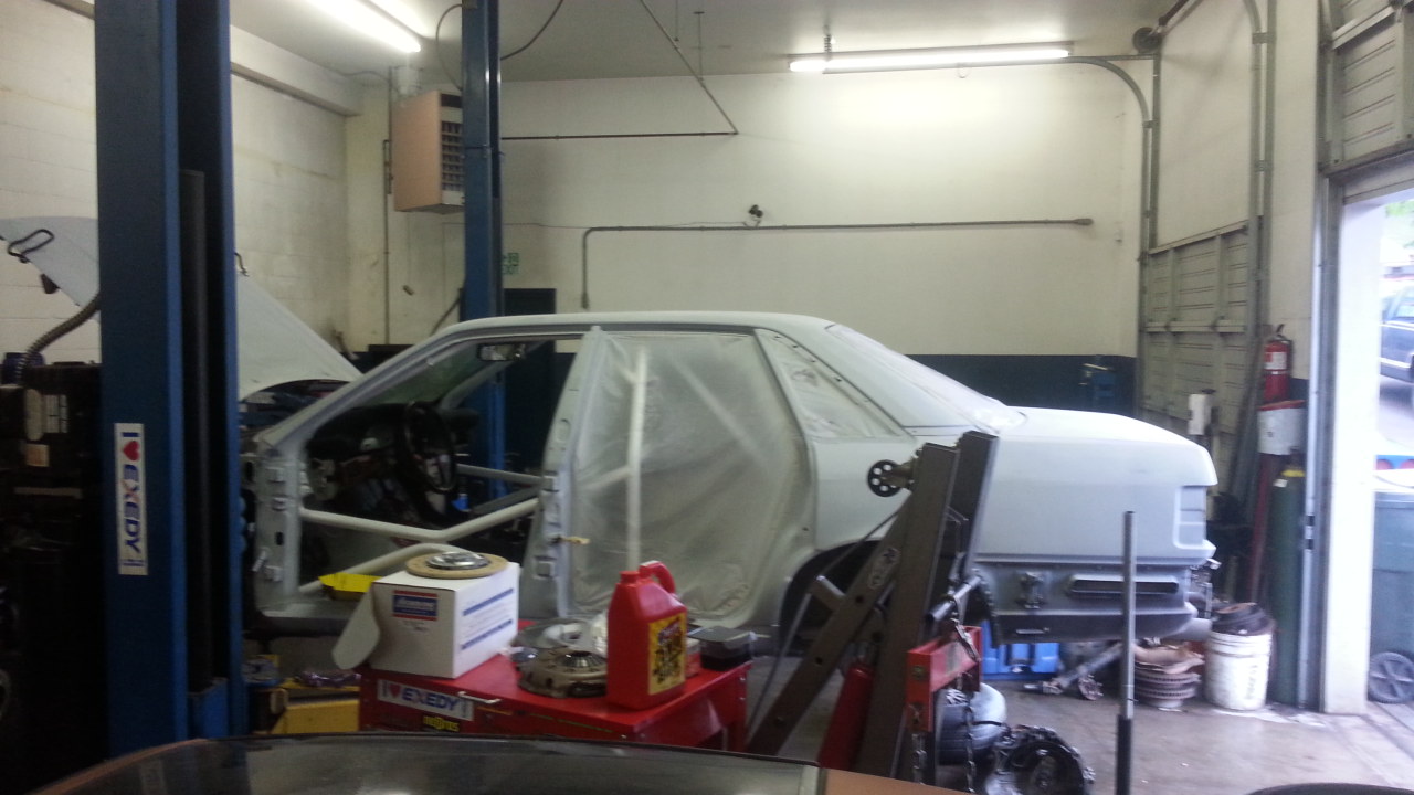

in primer, notice there is no sunroof, we re skinned the roof, only 91 200 20v with no sunroof I believe

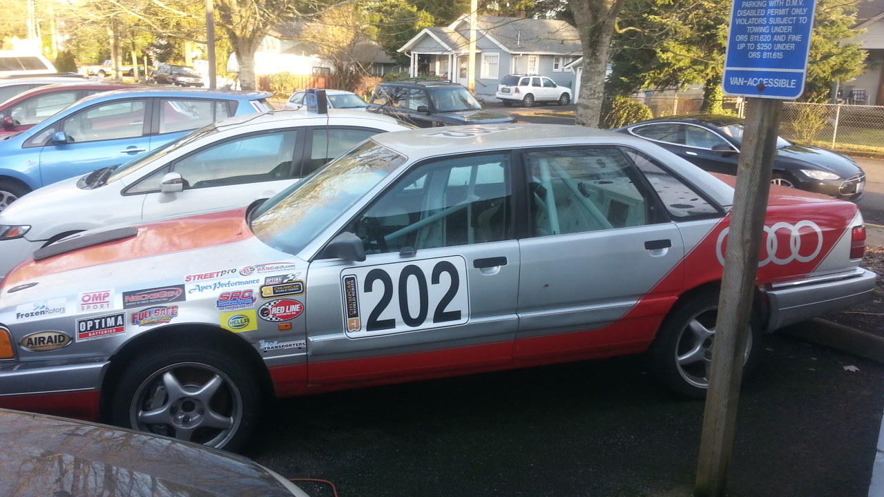

fresh paint, these aren't vinyl graphics, it's all paintwork.  We copied the audi v8 dtm car paint, like it better then the trans am look
off to a 24hour race, one of my friends that helped run the pit crew

I didn't realize those had an 016 and not an 01e from the factory. Definitely go for the o1e swap.
Car looks good. The juxtaposition of the full dash in an otherwise completely stripped and clean interior is hilarious to me.
