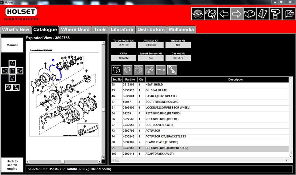

i managed to get a copy of the factory holset parts catalog software! this is really freaking useful!
