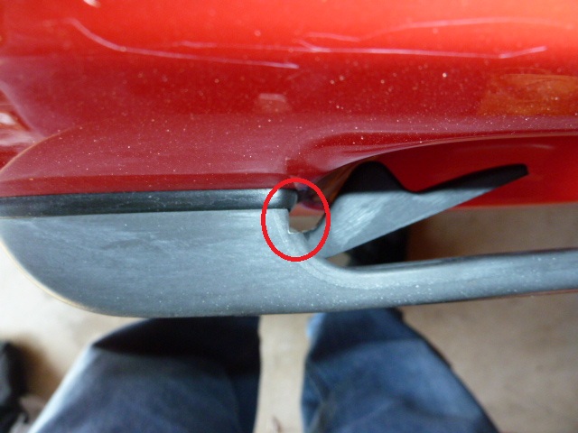

It was nearly 50 degrees here today so I took advantage of a slow Saturday to poke around the car a bit. I'm still waiting on some extra lock cylinder wafers so I can re-key my drivers lock, but I got the pass front handle out. I'll use that lock cylinder as a guide for the drivers side.
I got a few extra parts in the mail so I planned on installing them. First thing was to see if the rear windows worked, because I was told that they didnt. Oddly enough they work with the switch in the dash, but not the doors. I suspect the switches arent hooked up back there. Luckily they work!
Next up was the trunk wiring as I was blowing the fuse for the lights on the drivers side. As expected and noted by others there are some wires that need attention. I'll take care of this tomorrow with some new wire, solder, and tape.
Lastly I was trying to figure out why the trunk doesnt open when its in the position where you dont need the key. It works if you put the key in, turn right a bit, and push in. I'm not entirely sure what I'm missing or what is supposed to happen, so maybe somebody can check or even help on this. Some insight would be helpful. I did get a spare lock cylinder assembly, but even from that I cant tell how its supposed to unlatch.

The drivers door used a different key than the others. I really dont care for that so I opted to re-key the drivers lock cylinder. Driggs was kind enough to send me a few spare tumblers which had extra wafers in them. My goal was to match up the passenger side lock cylinder with the new one.
The front handles I got were from Autohausaz and not too bad in terms of quality *knock on wood*. My original thought was to new the brand new lock cylinders but old wafers, but that didnt work. Perhaps the new springs with the old wafers was an issue. Either way I had to swap out a few of the wafers and I was in business. The clips that attach to the end of each handle (I bought about 6 of them new) went on great and the installation of the front handles was very smooth. I now just need a new or different pass front lock rod as something is wrong with mine (I think Driggs mentioned this to me). Luckily they are only 10 bucks, but if somebody has one I wont turn it down. Lastly I tossed on a minty OEM pass rear handle. All handles open and shut with ease! I was a bit spooked as I bought all new hardware, but the screw that goes in from the side of the door is a torx, not a normal phillips head. I used one of my new ones only to find a fat phillips screw in the cubby near the end, oh well. Its not pretty, but the drivers panel is on. Progress!
Also got the trunk hinge wiring taken care of. There were a few wires in sad need of repair. Got the soldering iron out and tackled that. Lights work as they should, no fuse blowing.
With that out of the way I was going to pull the fuel sender in the tank. I had done this before and it came out easily, but this one wont budge. Any tips here? I'm going counter clockwise with a hammer and screwdriver/pipe/etc. Tips would be nice.
Also, the power locks dont seem to work. Ive never had to troubleshoot this. Tips on where to start? I did check the vac reservoir in the trunk, and its there with the vac line attached. This may be why the trunk doesnt open without the key?
