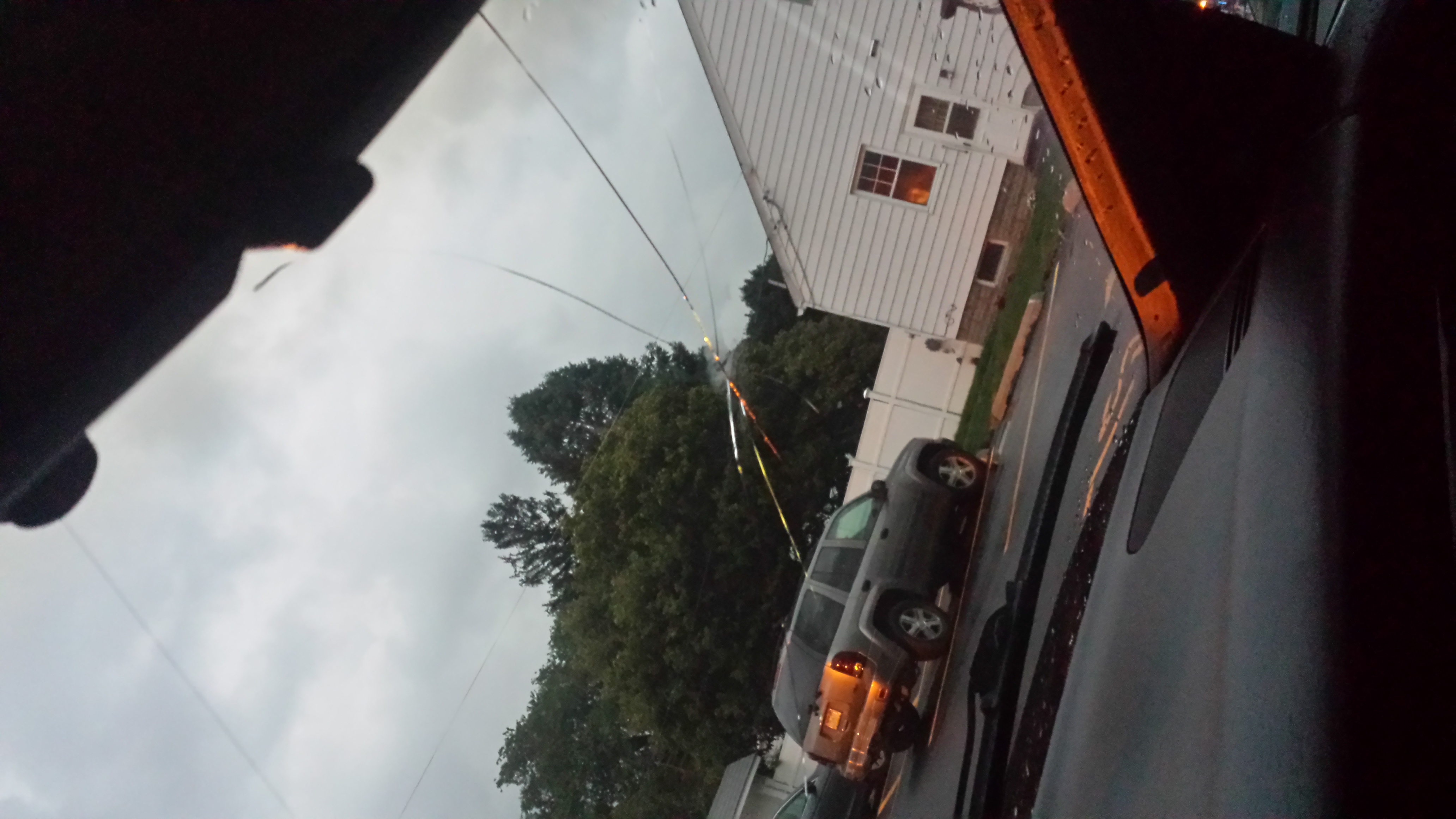

Now for the potatoes of this whole thing. Am I going to have to search the earth for a replacement windshield? NLA?
Safelite had one in their warehouse. Everyone in the office that heard the p/n asked "wth is that for?" Lucky me :)

Now I'm ju$t concerned about whether my chrome accent around the glass will be salvageable. BTDT's?
