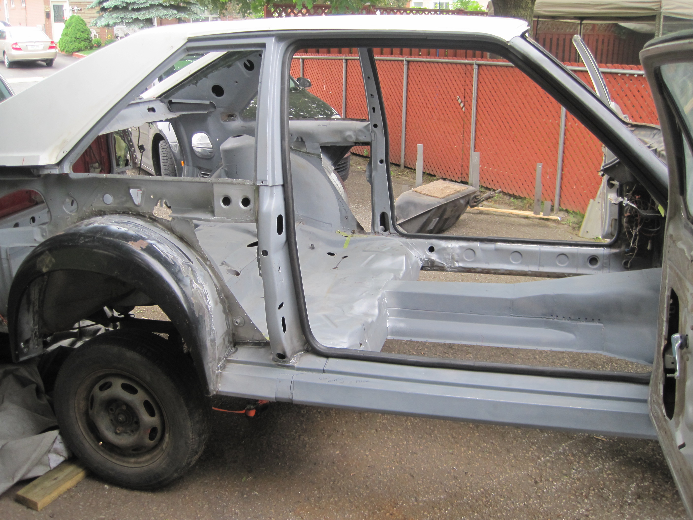

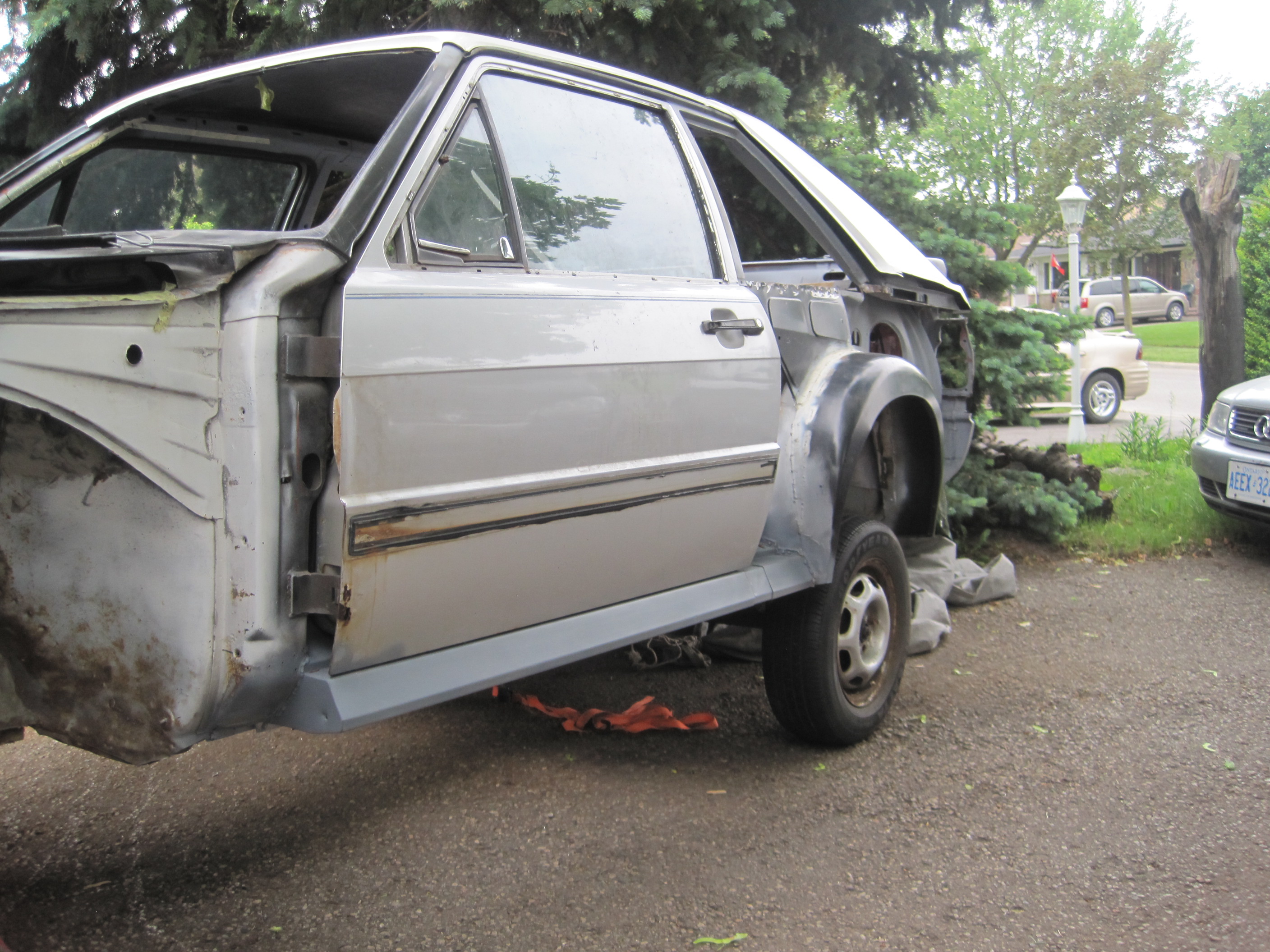

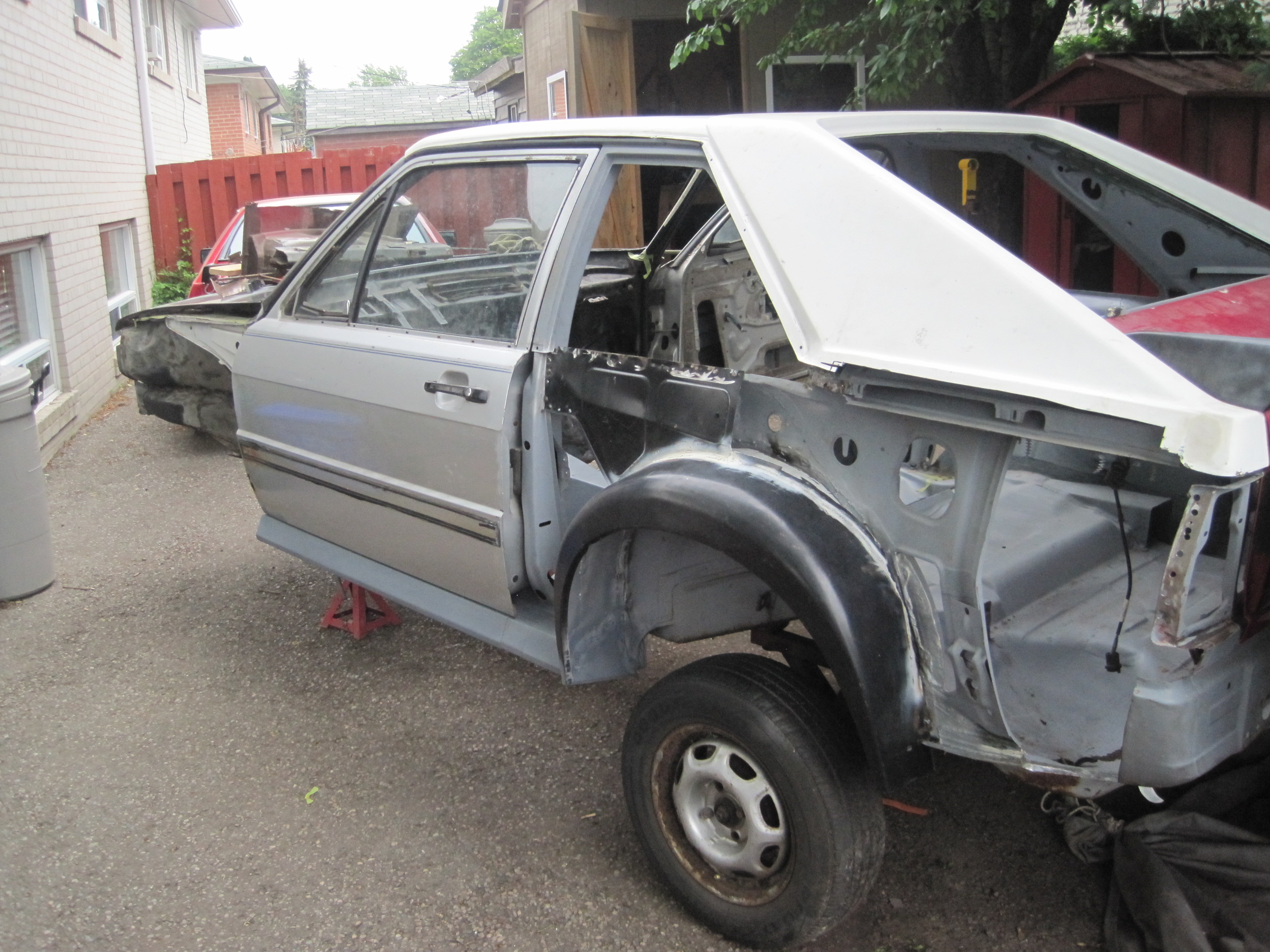

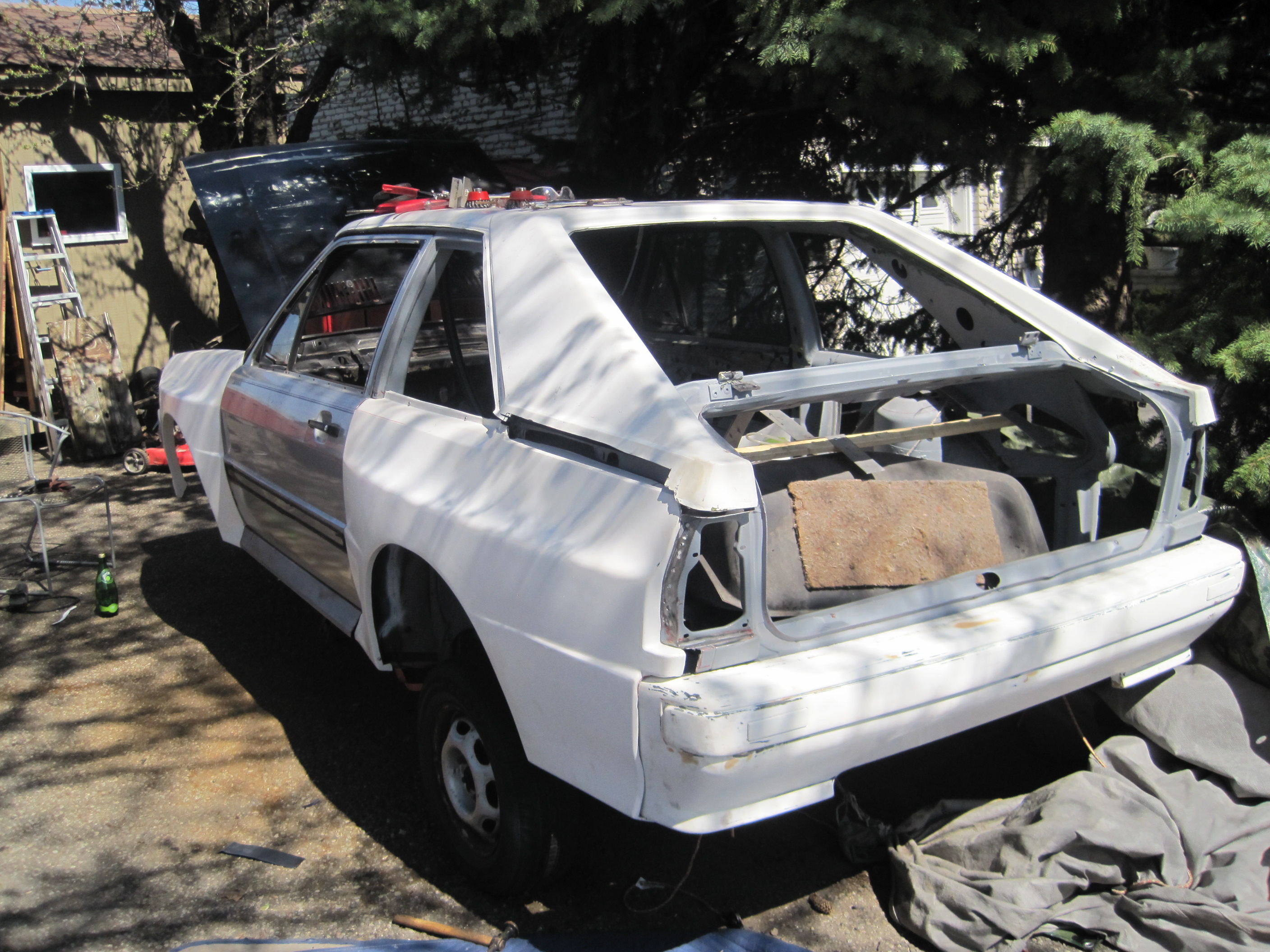

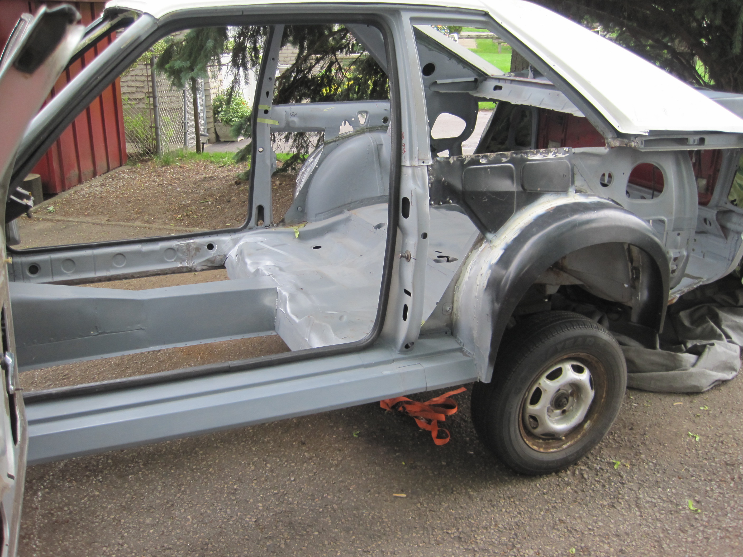

I can truly say I hated installing these rockers and rear inner wheel arches.
The rear carbon fenders must have easily been off and on at least 20 times per side. The inner wheel arch has to be spot on as this dictates door gaps etc. I still have probably another 10 hours in getting the rear carbon panel fitting the way I want it to, but at least the bloody rockers are done :D
A few pics.
Cheers,
Craig.
Verifying fit
Verifying fit

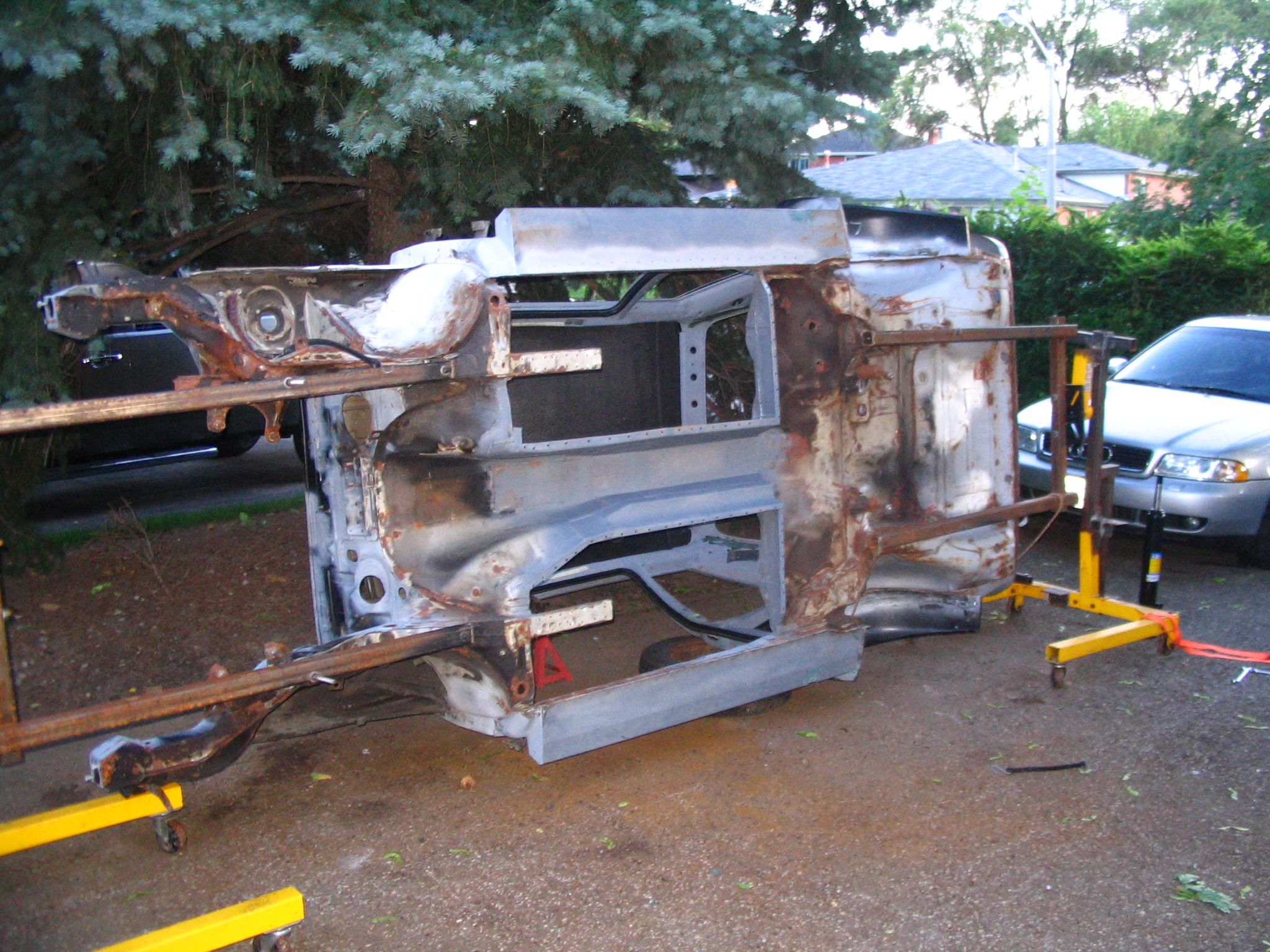

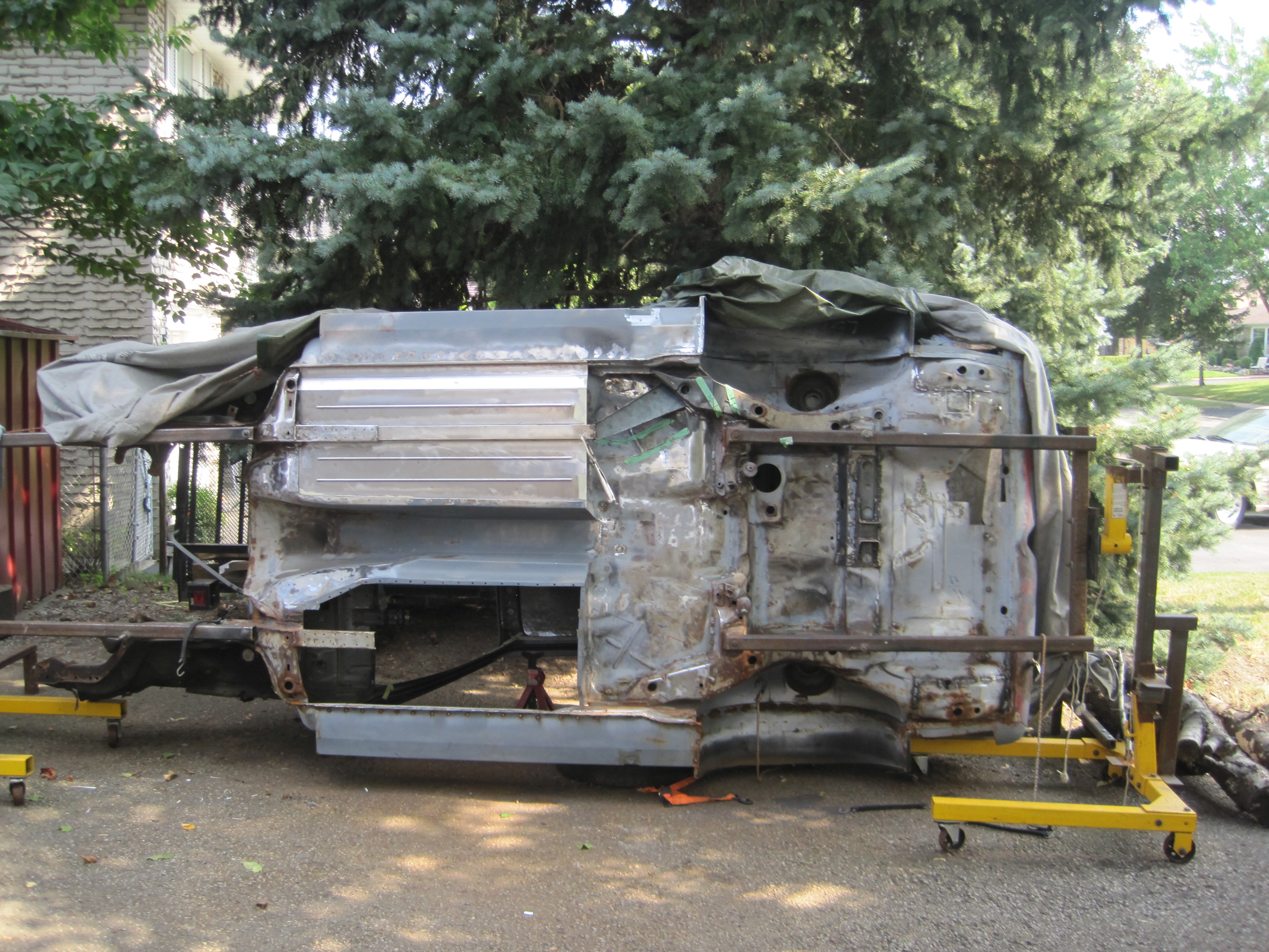

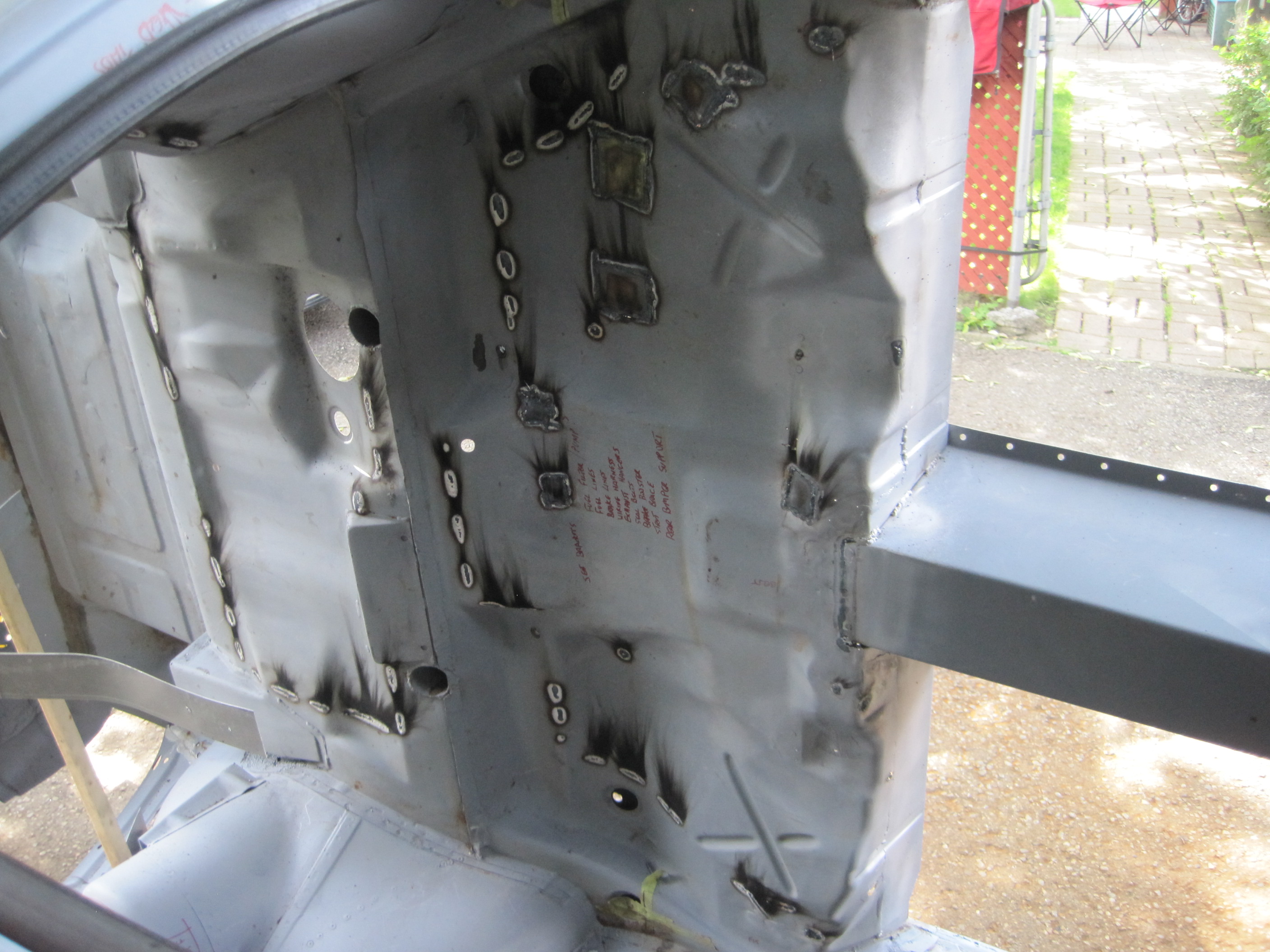

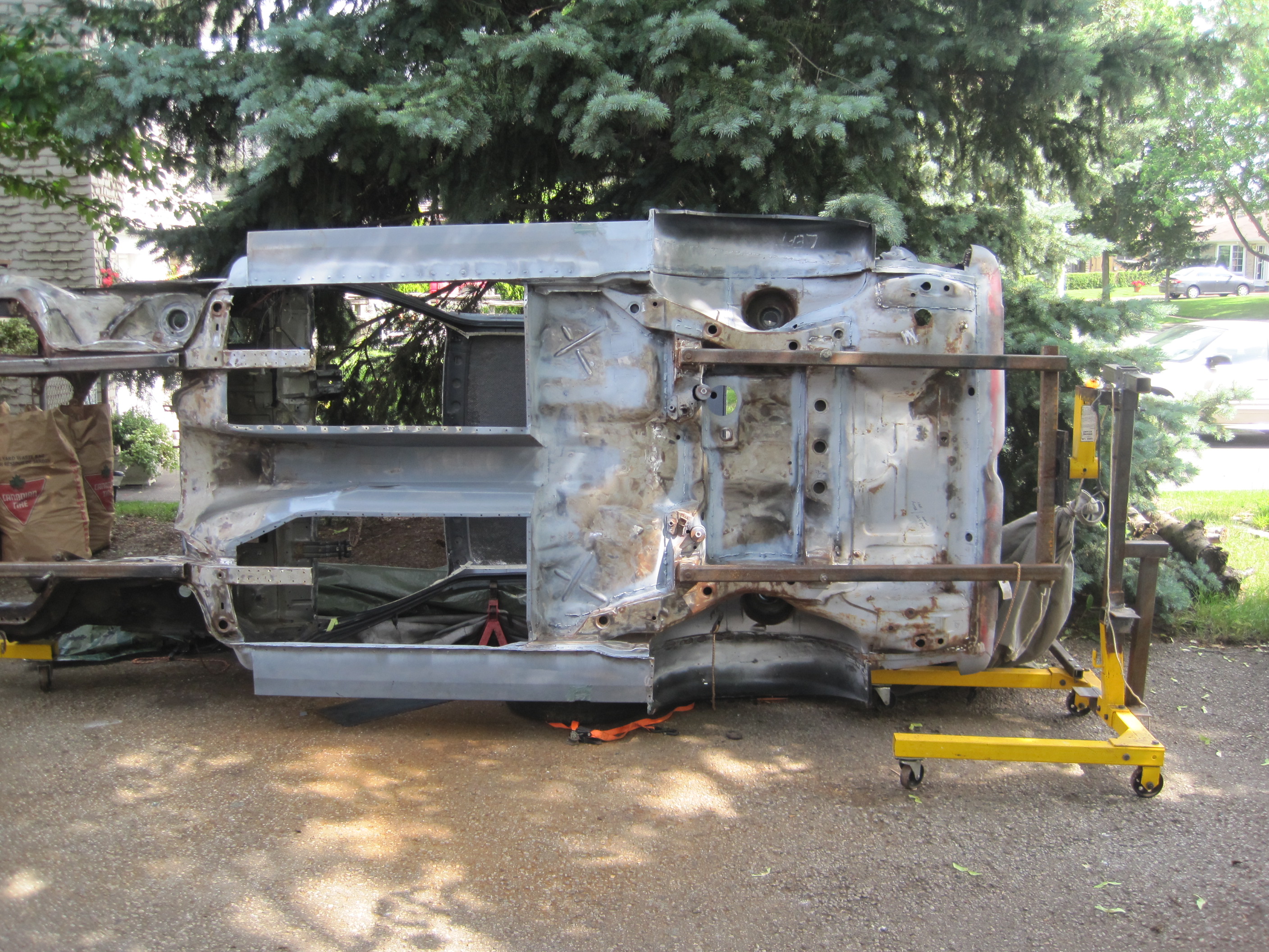

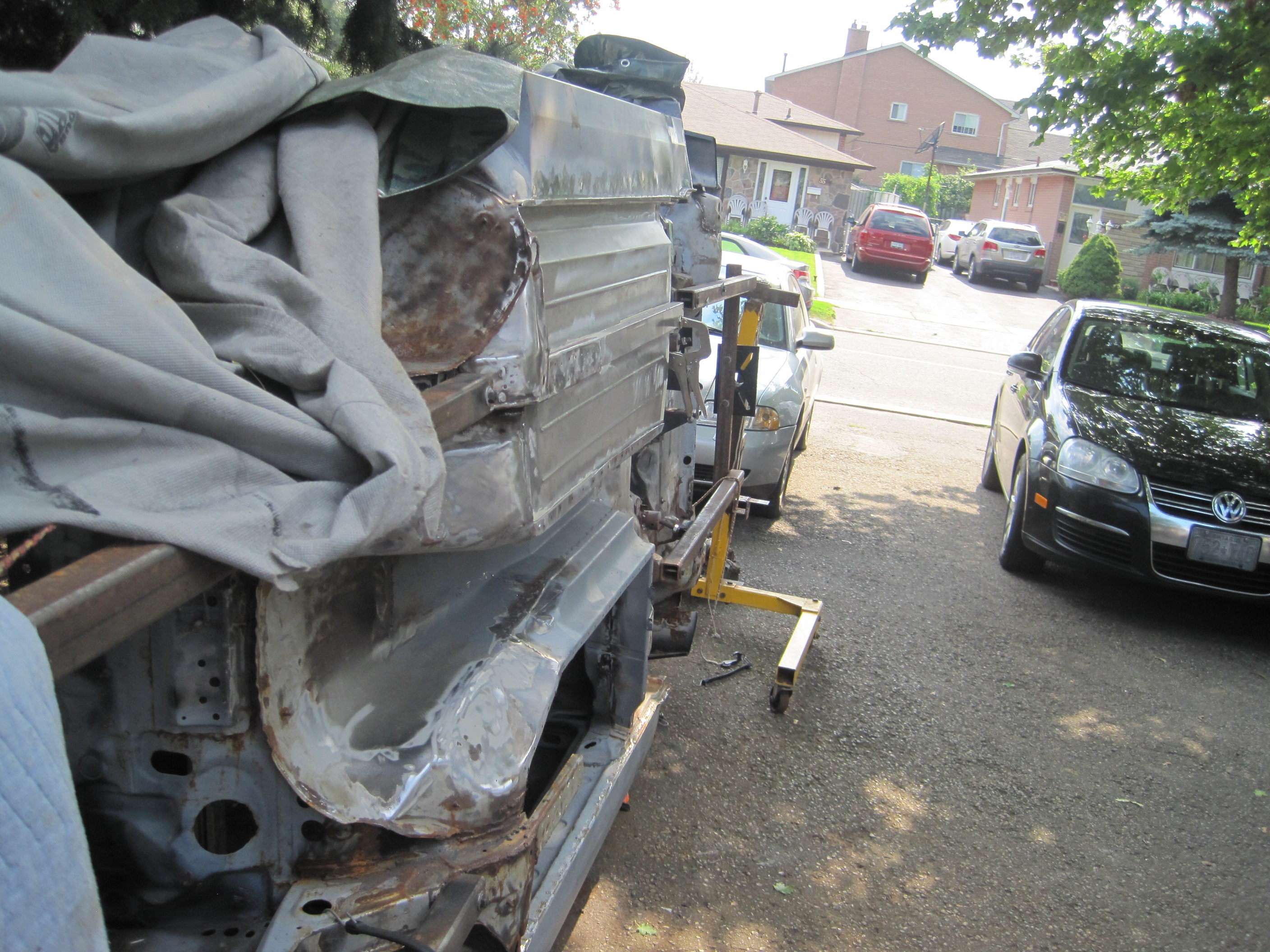

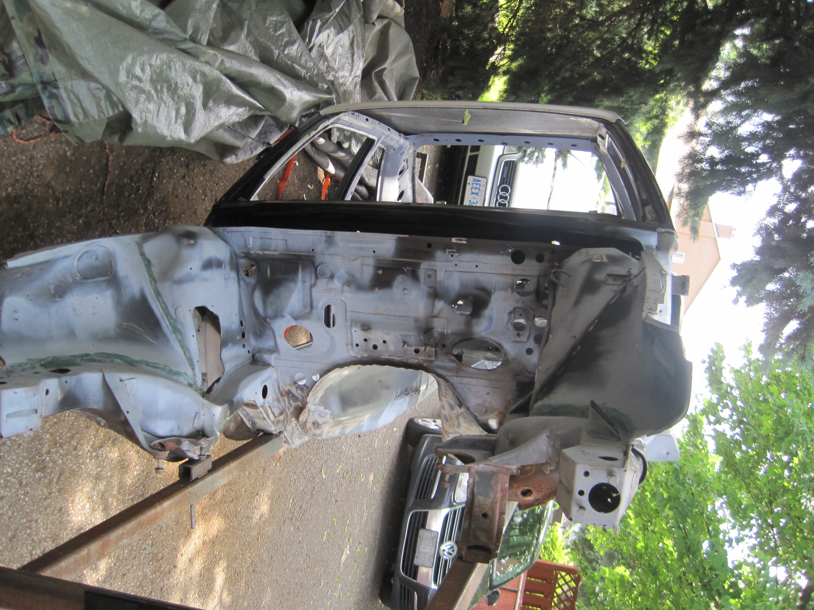

Now the fun can begin.
Car on it's side ready for surgery.
Some holes to fix in the floor,and then on to further strenghthening the floor.
I think at this rate I could omitt the roll cage all together, however roll cage is still going in.
Also started seam welding the shell.
I'm copying my urq build with the subframe connectors etc. This is the fun part for me. I like the challenge of making it all come together........most times :D

Nice!
BTW, do you have more detailed pictures of your "rottissery"? Can't remember, but thought they were made of heavy duty engine stands... any details or upclose pix would be awesome. Toying with making some for our UrQ rebuild down the road.
highlander69
Posts: 279
Re: Craig's Sport quattro build
Post by highlander69 »
Justin, I'm still refining the rottisserie, when you need picks let me know and I'll send you them.

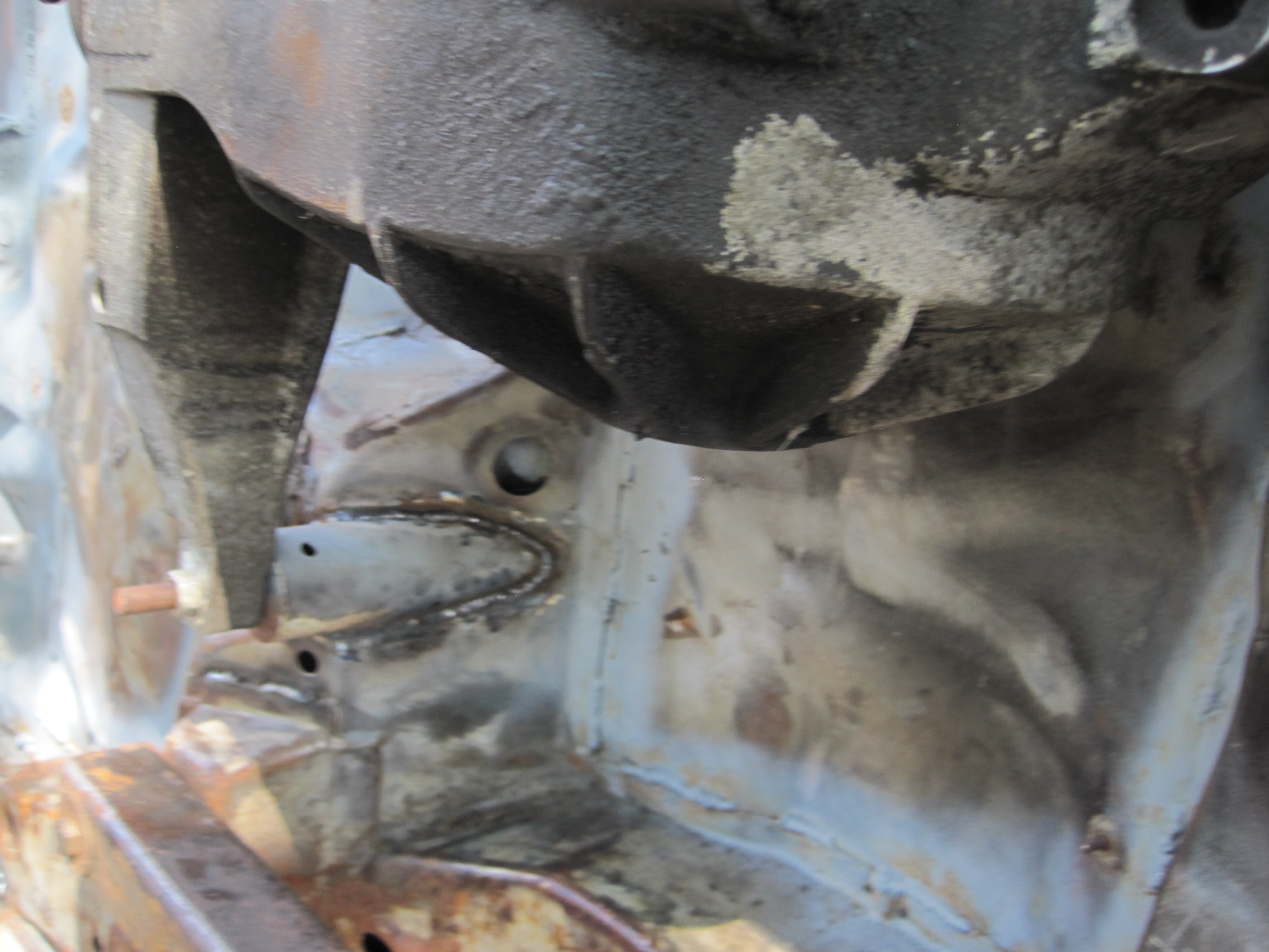

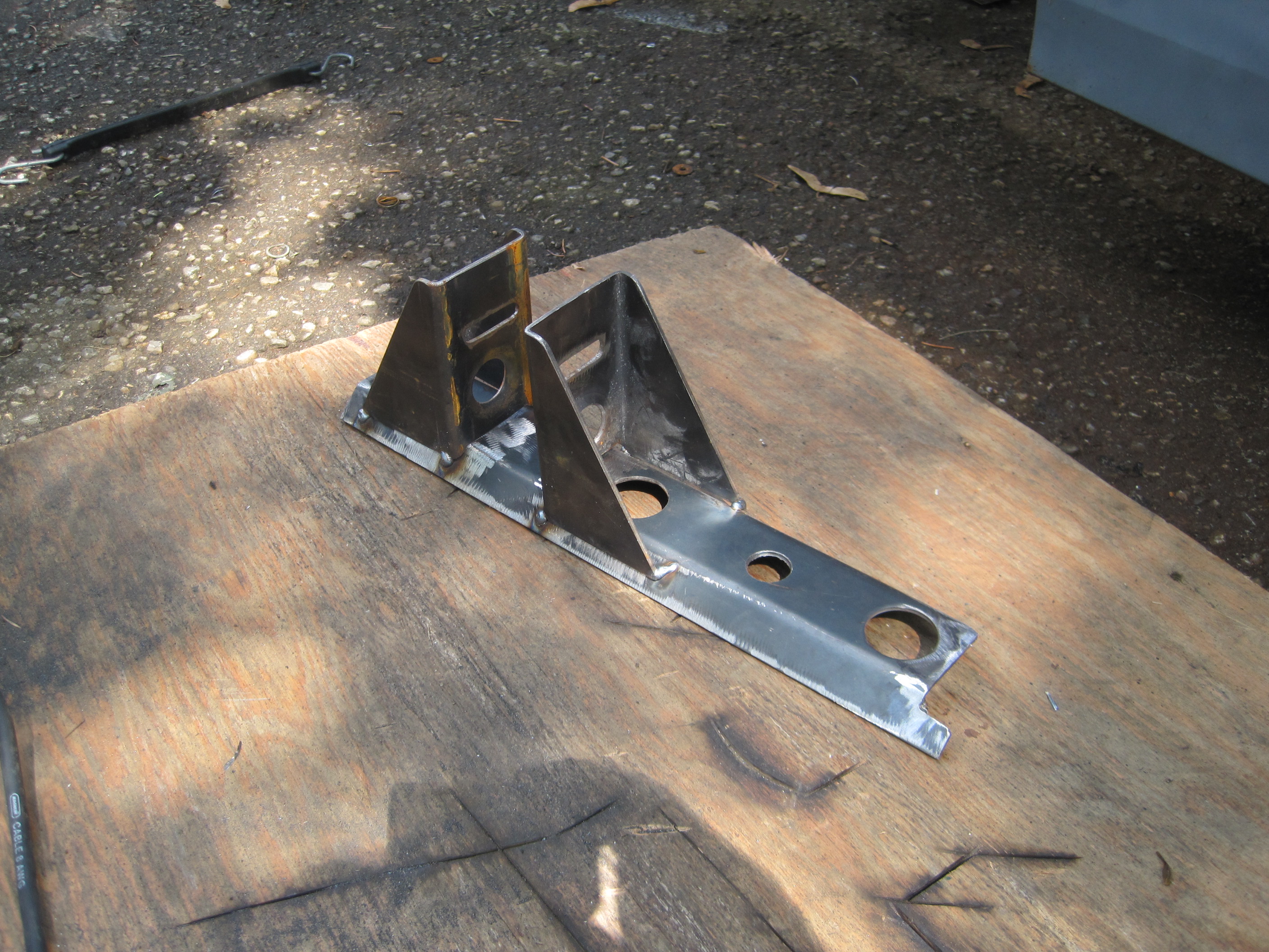

A few old pics guys of the rear diff mount.
I decided to mount the diff to the floor just like the rally cars. Lot's of work but worth it IMO.
I have to send some dxf files away so I can get some parts cnc plasma cut. The plan is to get most of the sheet
metal on the floor done, and hopefully get it in primer before winter.
Cheers,
Craig

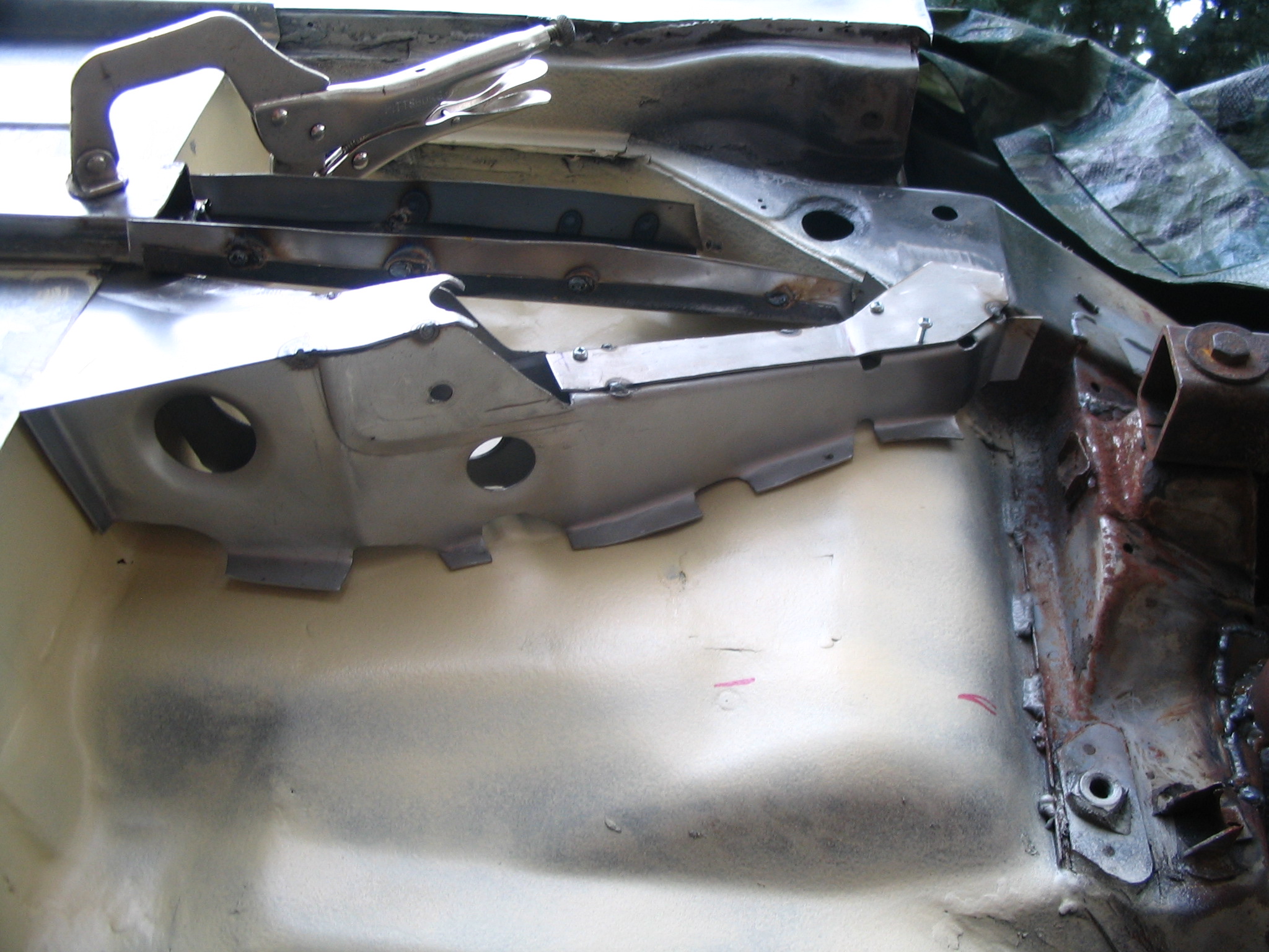

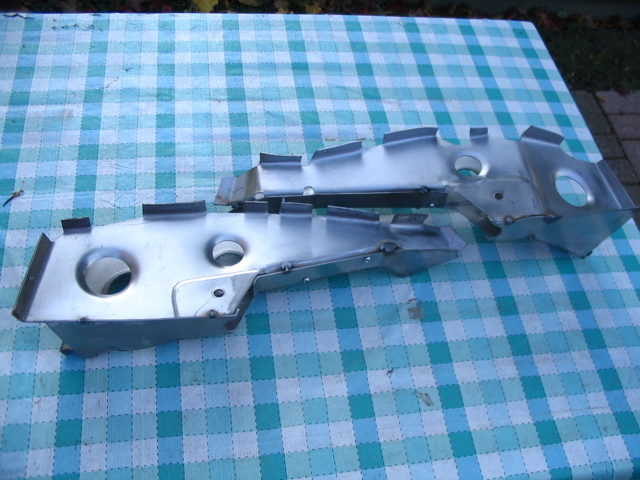

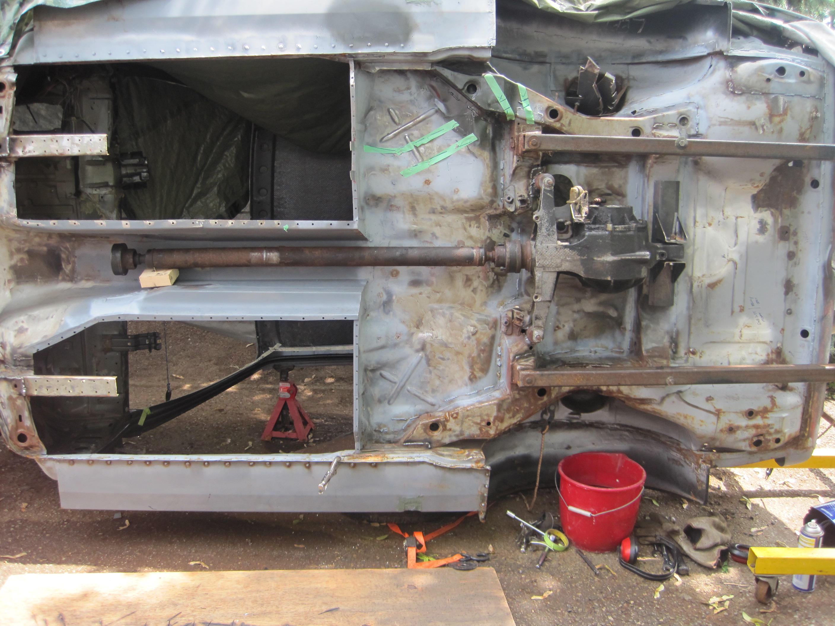

Just a small update guys.
I welded the diff mount to car and made up a strengthening plate for the sheet metal. The factory S1E2 also installed this bracket. Funny, I've never seen this on the A2 or first generation
sport quattro rally car. I'm no engineer, however if it's good enough for the factory, it's good enough for me :D
I also fettled the floor and went about fabricating the subframe connectors. It's not done yet,but you get the idea.
Cheers,
Craig

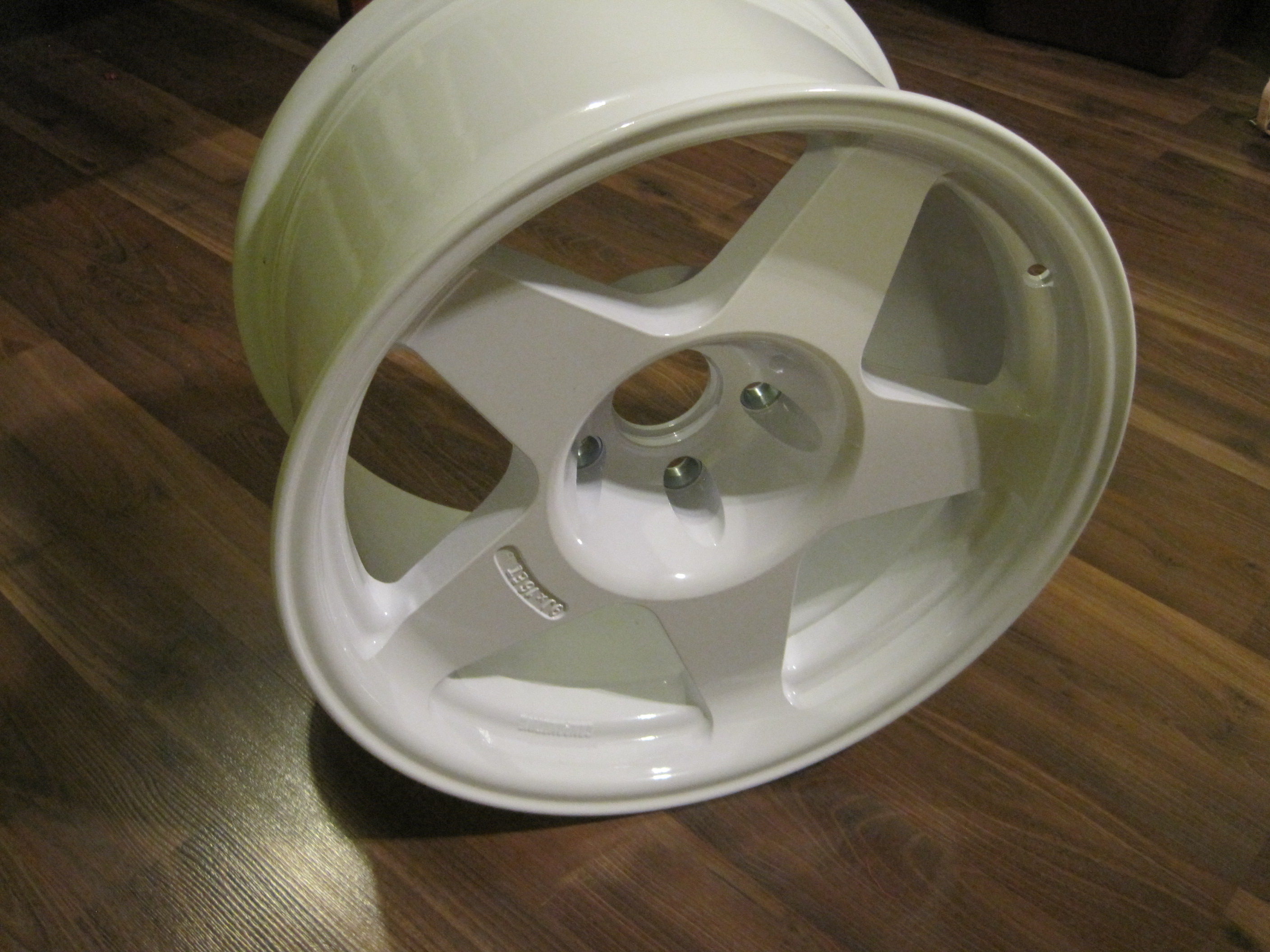

Oh,
I've have 5 off these Compomotives sitting in my basement......... :D
Cheers,
Craig

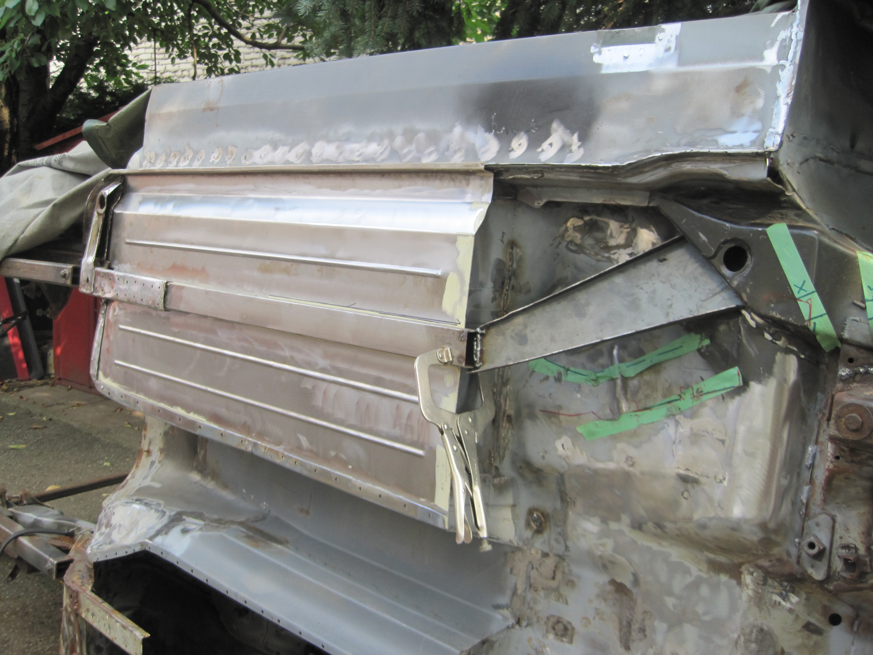

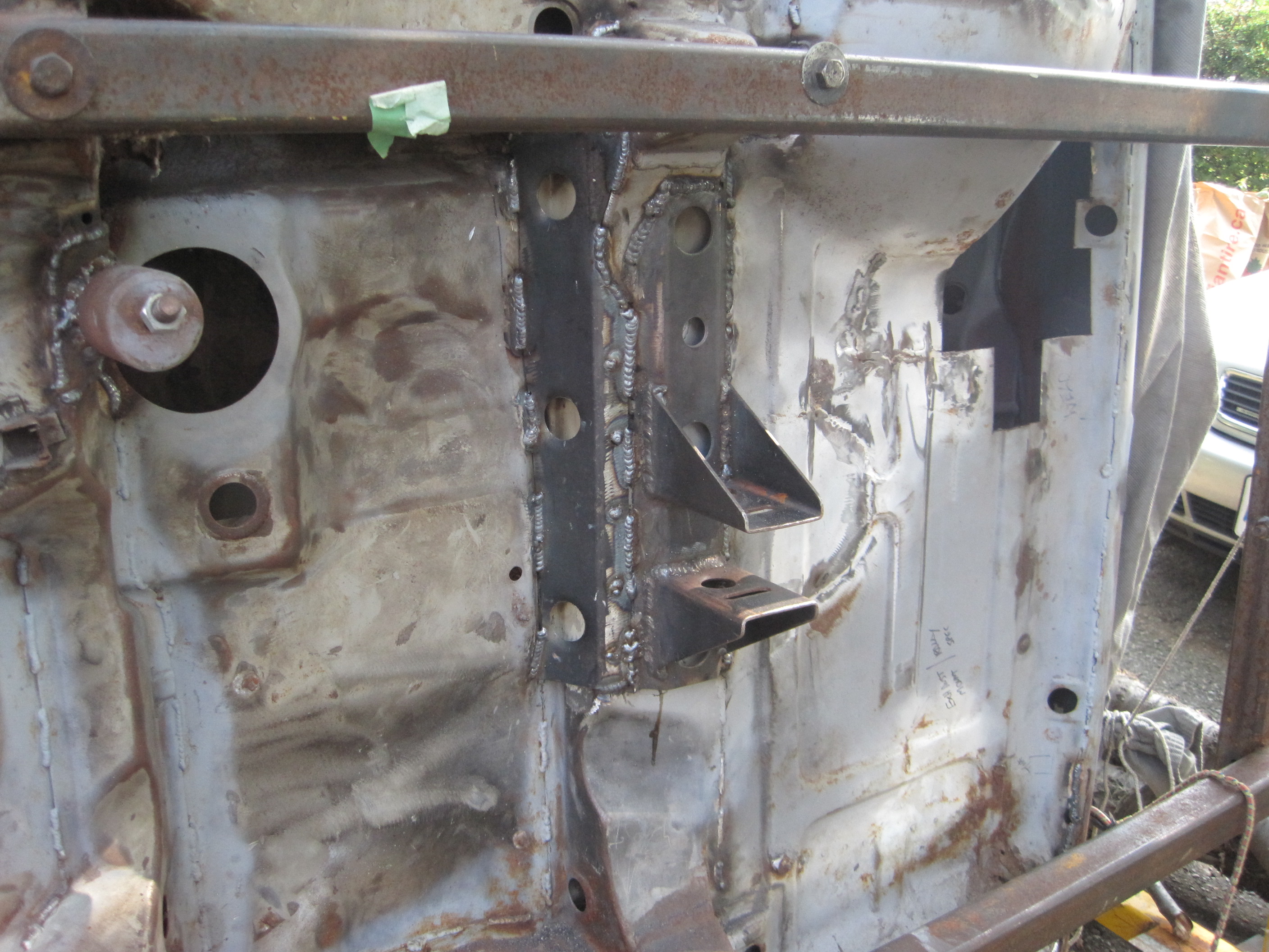

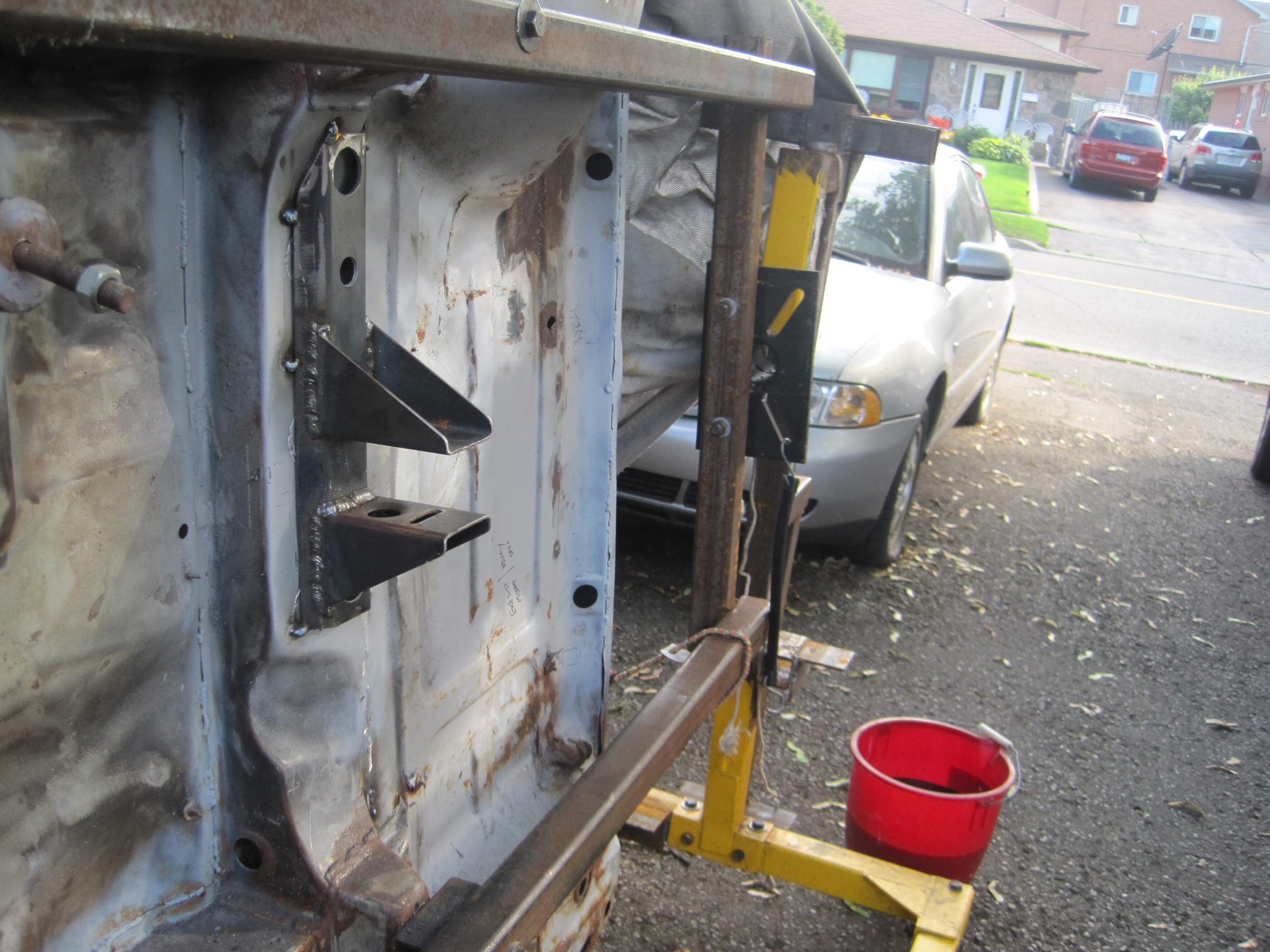

Posts: 279

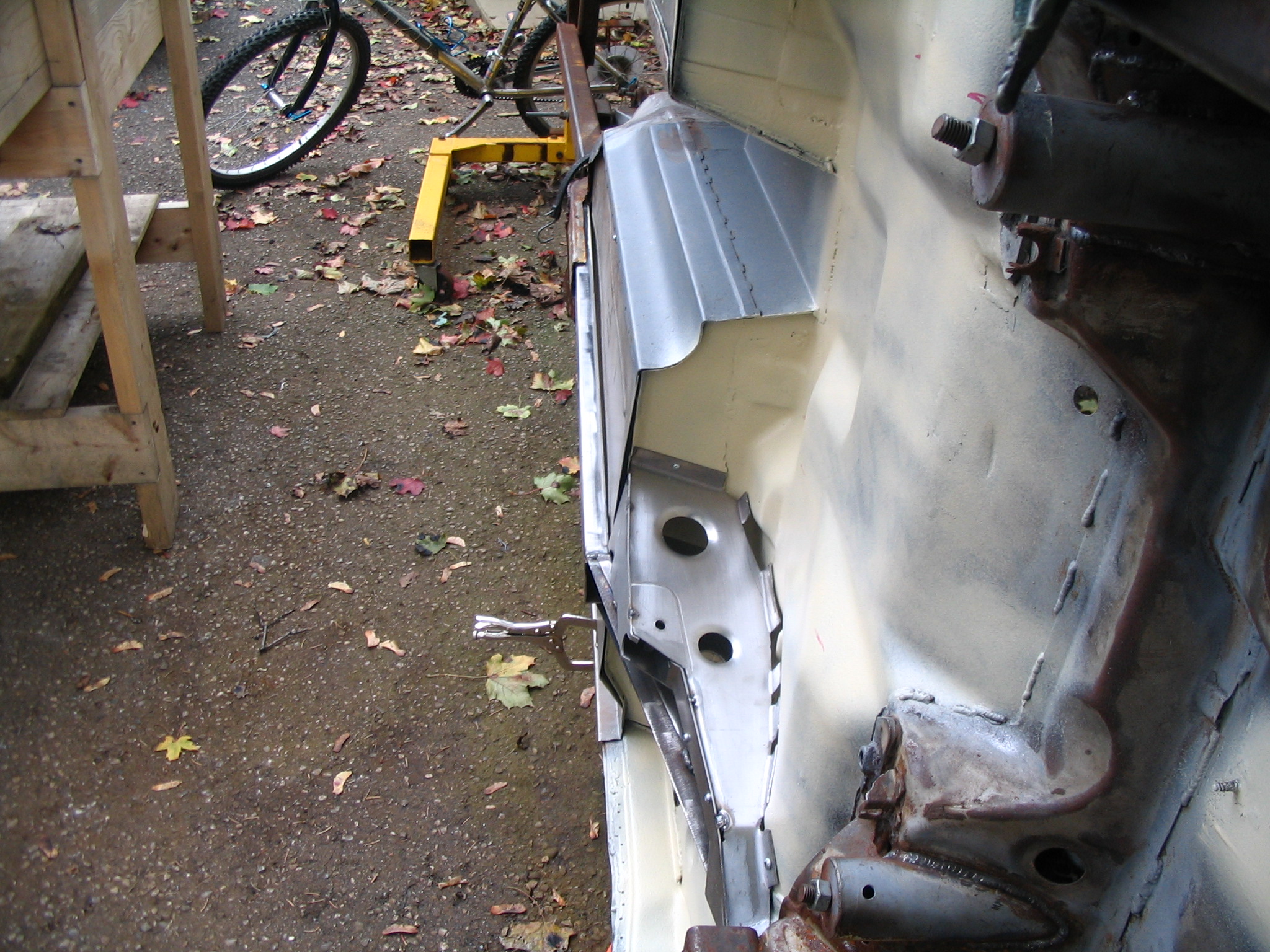

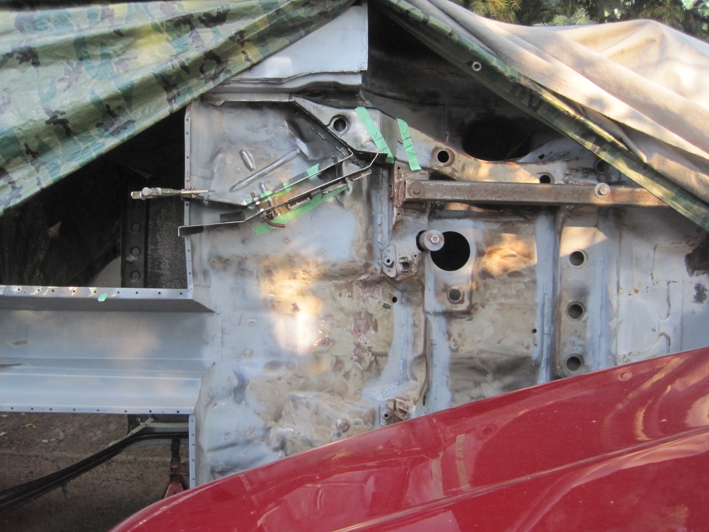

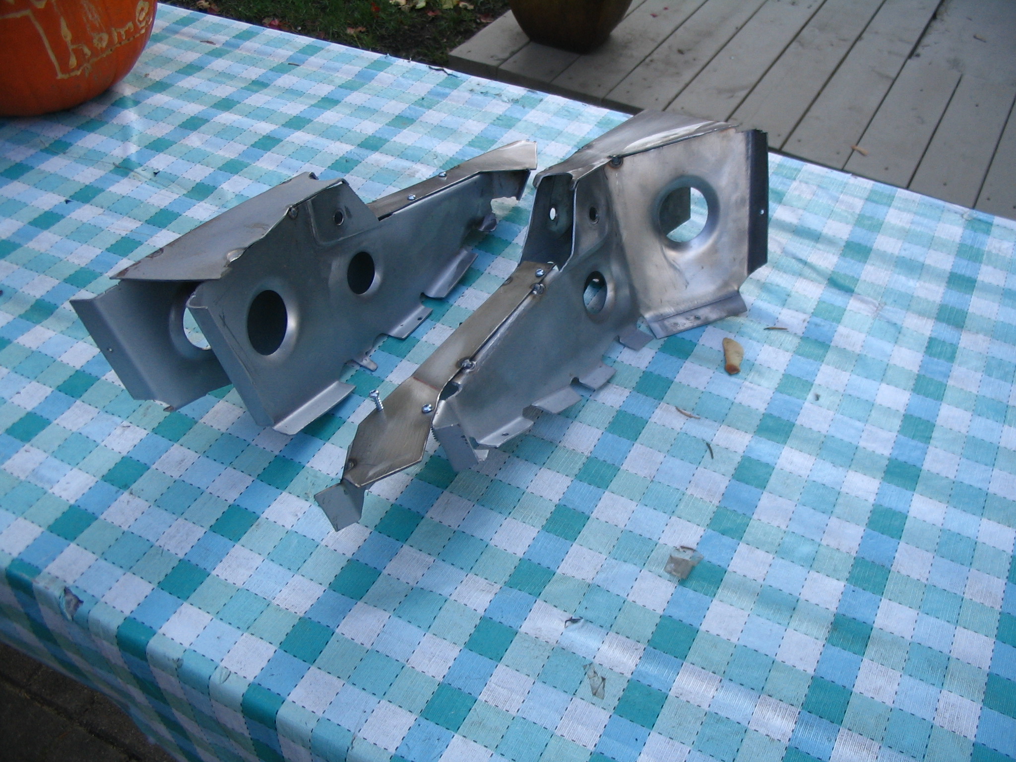

Managed to get some work done to the car this week. I fabricated rear control arm stay bar brackets for the body as per rally car spec. These parts were.. bar steward's to get just right, but I managed to replicate the factory NLA pieces. As usual thanks to Martin for having said NLA parts on hand so as I could copy them. The weather is closing in on me, but I hope to get the floor welded in before the good old Canadian winter sets in.
A few pics.
Cheers,
Craig

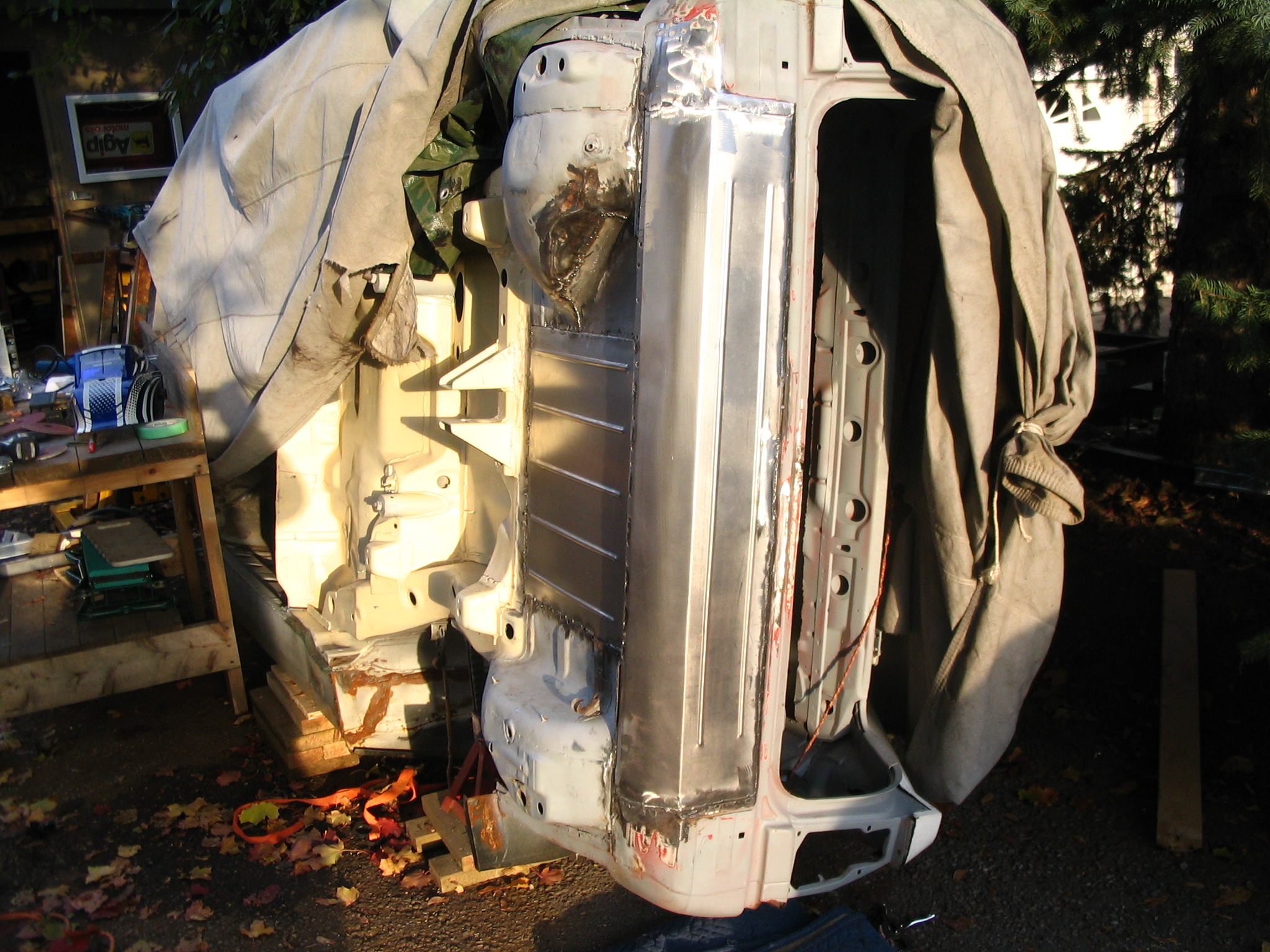

Think of me Matt freezing my bollocks off while you work in your amazing workshop :D

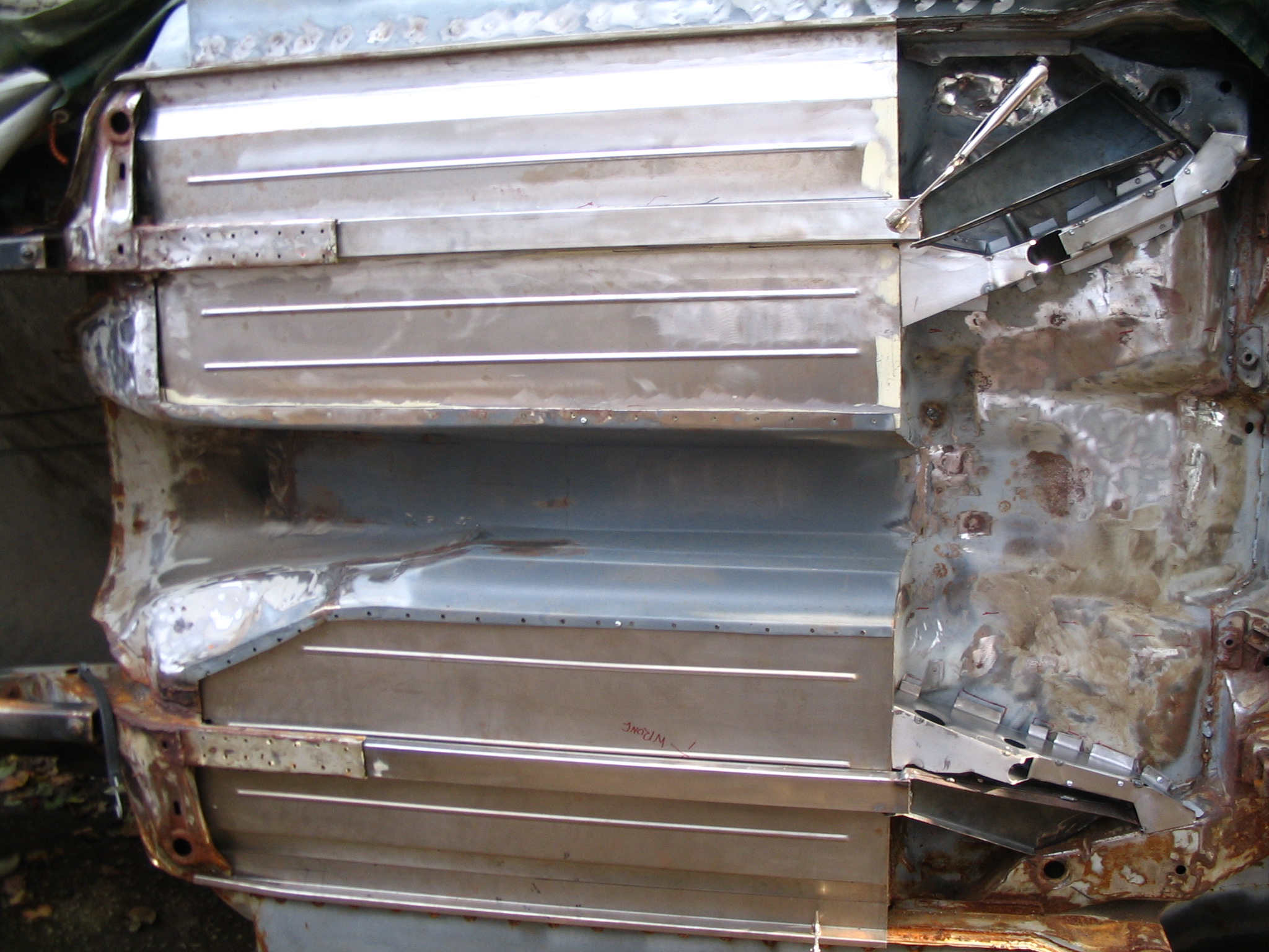

I decided to cut the trunk floor out after finding several rust holes. I could have patched them up, however I decided to start from scratch. I also replaced the sheet metal that the bumper bolts too. A tricky piece to make from scratch also :D
A few pics. I still have to grind all the welds etc, but you get the idea.
