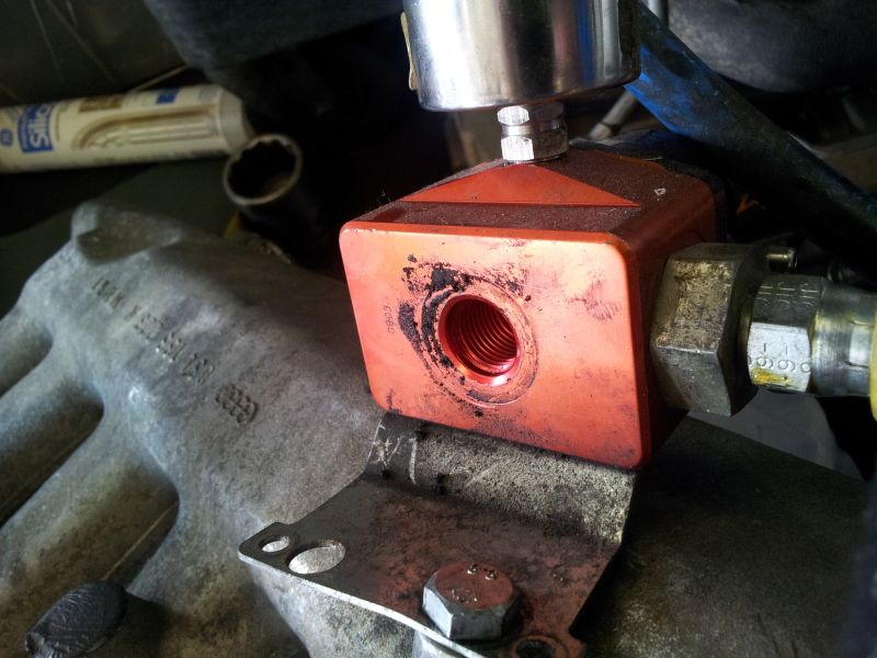

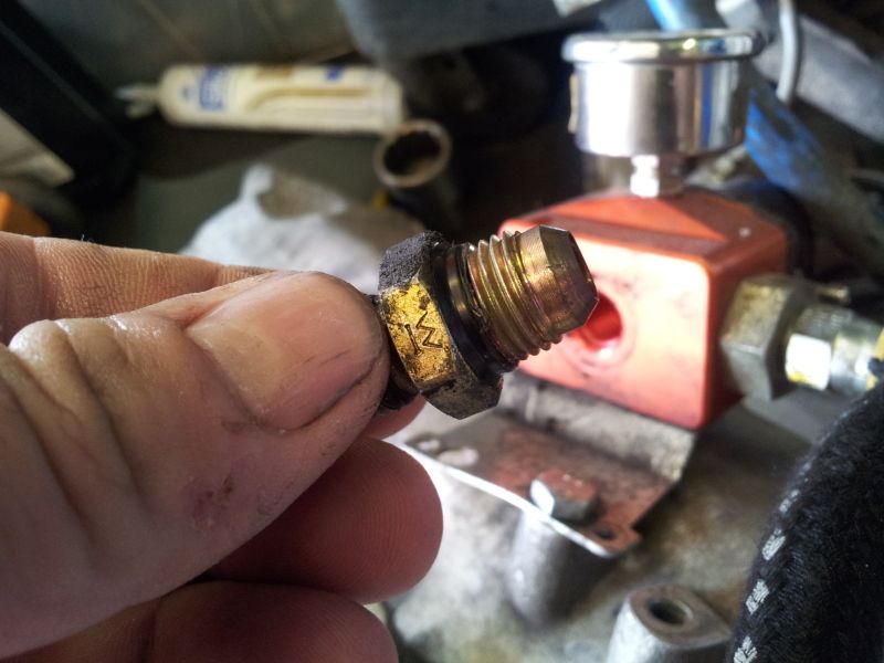

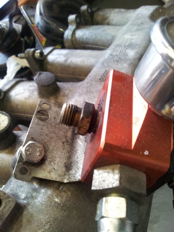

Is there any type of thread sealant that can be used on fuel fittings? The fitting to the bottom of my FPR still drips a little and I feel like I've tightened it up as far as possible.

Most AN fittings don't require any, but I still use a bit of teflon tape on critical connections - even though some will say not to. It can trick you into using too much torque and pulling a thread or snapping off a fitting.
Re: Darin's 80tq...fuel leak ...
Ya, I always use teflon tape on those connections. It's cheap insurance.

You have AN fittings they use an oring seal, you might need to get a washer to go around it. take the fitting down to EVCO and tell them you need an o-ring and washer for the fitting and hand them the fitting.
or these, its prob the seat as the threads arent of sealing type

sorry for the dirty pics.... should have wiped them off. There is a counter sunk spot for an o-ring on most of these style regulators, replace the o-ring and tighten it up, shouldn't leak anymore. Those aren't pipe threads and tape wont seal it up.

Def wrong type of fitting to go into that fpr. I doubt it needs a flare.
Yeah, that is the wrong fitting, but they work with the right oring. That Oring on yours Brent looks beat. My guess is that Darin's looks the same. Darin, you probably just need a new oring. Like Brent said, go down to EVCO and ask for a new oring for that fitting(in your pocket at the time)

I needed the end on the bottom to connect to the stock fuel line the an flare just had the correct thread......
