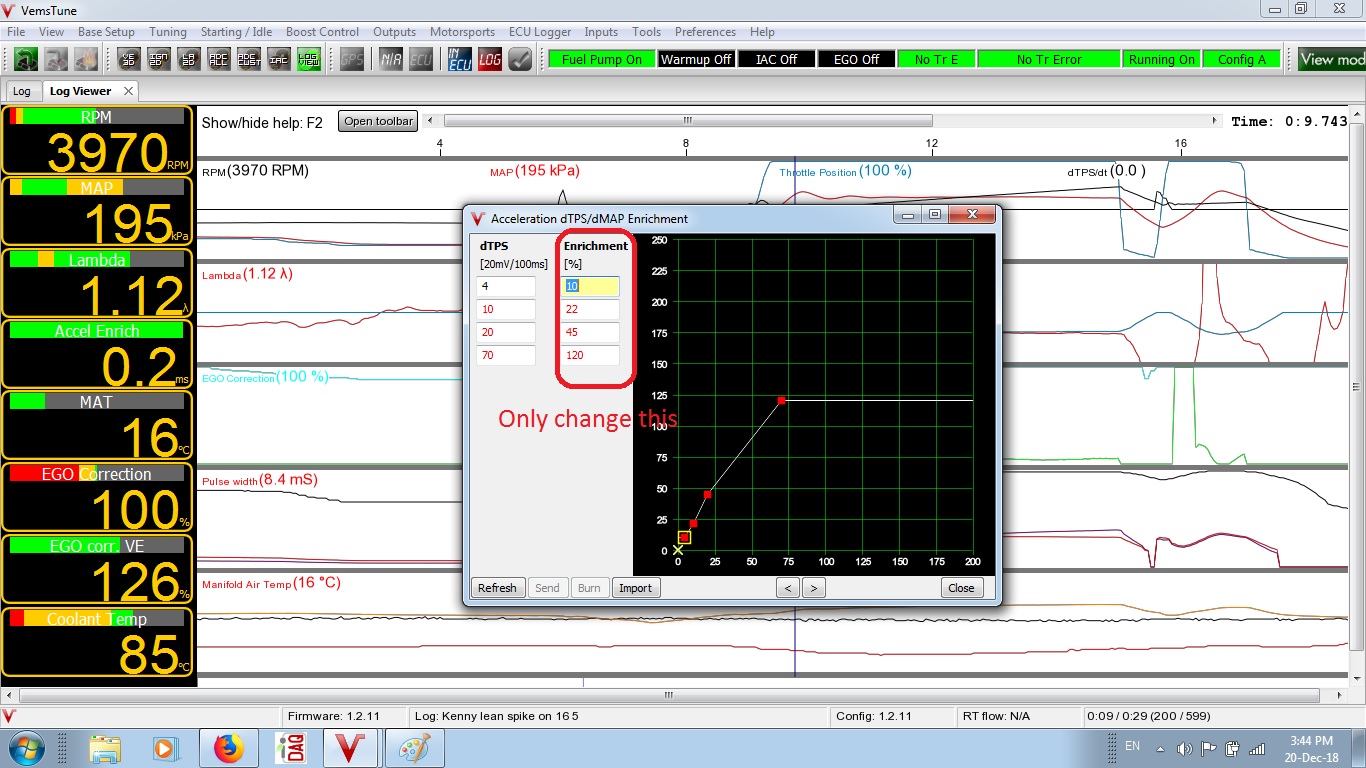

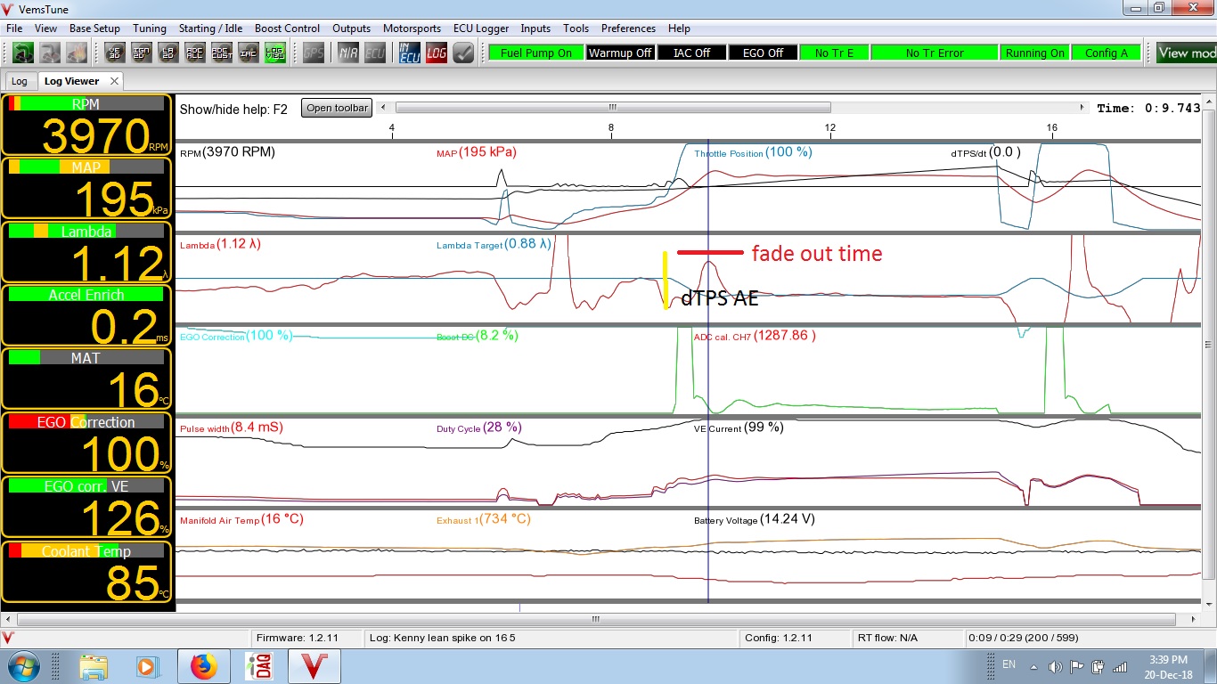

That lean peak has nothing to do with your compressor wheel. It is just injector and AE settings. Your AE settings don't go high enough. Highest dTPS you have is 26, while when you mash it, it shows 66! That is why you go crazy lean! See pictures.

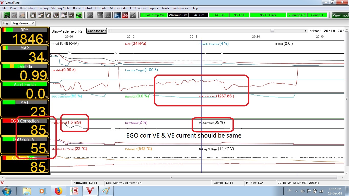

Another reason you have lean peaks on accel is because EGO is pulling a lot of fuel. It is canceled on throttle input, but it does have an effect.
I hate to say this, but your VE table needs a lot of work. You say it maintains target lambda with EGO on or off. Why does the log then show EGO correction 85%? I can see in the log with my settings that it pulls fuel almost everywhere. EGO correction should be 100% if on target. Another thing is that you reach very low IPW. Just 1.4-1.5ms. The Dekas are not really linear that low. They start to go unstable at 1.7ms I have noticed. That is why you have that weird oscillation in lambda and MAP between time mark 11.30 and 12.20, I think.
Is your thermostat new? Coolant never goes above 87C. I recommend you get a stock 87C 'stat.
I see the on/off EGO issue at the end. That is odd, but not because of the higher enable temp. That is something else.

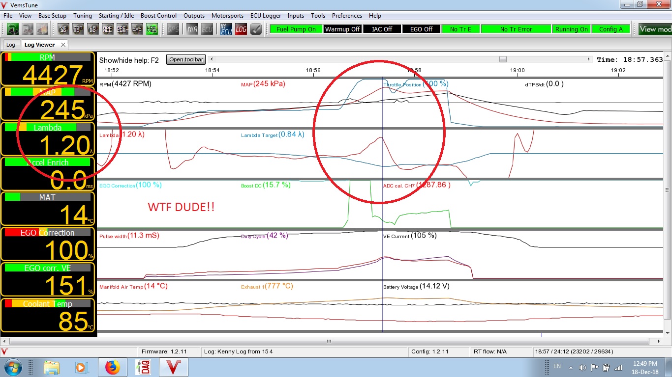

Try to cover as much of the vacuum area as possible. Like slowly climbing in the revs in second gear and third. If you can cover the same rev range with two different MAP rows, it can really help predict the upper table. After that, low boost along the MAP rows. Then we have the third and fourth points. The table is not completely linear, of course. There is a changeover where it curves sharply in low vacuum. Say below 40 or so. Small dip around idle, but not too steep. What you might find is a very slight dip in the mid range. I've seen this in a few maps besides mine.
Speaking of steep, your ignition timing changes were very sudden. 10 degrees in 500 rpm. Should not really be more than 5. The table is more conservative now, but not badly. Pump gas, remember.
If it goes too rich in boost, it is not as bad as very lean. 1.2 @ 245kpa is not good.
I'm temped to give you my VE map and see what happens...
Also, a fuel pressure sensor would be good idea at this point. It has helped me understand better what's happening. If you see some weird shit happening like oscillations or sudden drops, you can save the engine too.
A decent 100psi sensor is like $150. Make sure it comes with a calibration cert. Wire it in to one of the open analog in channels. You will have to check how to do that on your PnP. There is a tutorial on the VEMS YT channel on how to configure that.

Well, that is it! Current VE is what you have in the table, but the ECU says you need 144 in order to hit the requested lambda target. If corrected VE asks for 144, put that in. Then try again. EGO control tells you what you should aim for. It's not always spot on, but you get close.
The idea is to hold in certain cells so that fuel requirement stabilizes. Any sharp transitions cannot give good information for tuning.
That is why dyno-tuning is so much faster. You can hold the engine in the cells you want. It brakes down the car by applying load so opening the throttle further to go up the MAP axis at one RPM column. You do something like this with brake boosting. I cannot do that here because of traffic.

here is a run from today. as you can see the AE kicks in alot as i start to push the throttle, as it gets to 100% AE is gone and when i over boost to 205kpa i run lean for a split sec. thoughts?
I did 3 pulls and all were the same issues. This lean issue is my main concern right now so I'm trying to nail this down. Really need some help on the AE side of the house.
I've since adjusted the dTPS/map in a hope that it helps. Chris you said the if the dtps reads higher then the scale, say 50 and I only have valve for 26 it will use that 26 value... my issue is that my 26 value was 198%...198% seems like alot to me. Either way, I checked my log and I dont see dtps anywhere near the lean spot not near 100% WOT . I guess I could say...I'm lost on this one.
lean spike on 16.5.vemslog

morris400 wrote:here is a run from today. as you can see the AE kicks in alot as i start to push the throttle, as it gets to 100% AE is gone and when i over boost to 205kpa i run lean for a split sec. thoughts?
I understand tuning AE is frustrating. I struggled with it too for a while.
Kenny, I don't want to be a dick, but you really are not listening. Like I said many times, those kind of lean spikes are going to kill your nice rebuilt engine.
That 198% is the max. Cannot go higher. It is too much actually.
The reason for it not being enough is because of your AE RPM table. It is subtracting enrichment again because it is (way) below 100% which is the base line.
You said you are starting to figure out AE. Good.
I have made some changes to your target lambda table. Its nice to see it maintains target, but 0.88 at 200kpa is a a little lean still. I have changed that to 0.85.
Again, I have changed the AE tables. Have added some fadeout time because it seems it is not long enough.
You need to play with JUST dTPS. Only that. You said my settings made it go very rich at idle when using AE. That is normal. It is partially because there is no load on the engine and also because you back off immediately. So, fuel is dumped. That is why stop and go uses so much fuel. There is also the issue of fuel film, but that is very advanced.
So, I put 1000rpm at 80%, the rest 100%. Cruise along at 2500, then press with a little change first, then move on to more throttle change. Hold the throttle after accel, do not back off for at least 5-6 seconds. If you see lambda dip to below target lambda then recovering to target, good. If lean spike, add more enrichment at that dTPS point. So, say dTPS of 20 and still lean, increase % AE. See pic.
The reason for the 100% in the RPM table is because some FW has 0% as base line, but not 1.2.11. There 100 is base. Most engines need more enrich at lower RPM, but less at higher. Because of the fast change in kpa, it needs extra fuel to cover the sudden change. Say you have dTPS 25 with 40% enrich at 2500, it will need less at say 4500. If dTPS 25 with 40% extra is good at 2500, it will be too much at 4500. That is what the RPM table is for.
I have attached pictures which attempt to explain it. There is a delay between dTPS and lean peak. That is what the fadeout is for.

That log was perfect. What you see happening there is correct. What you call overboost is no issue. It is not causing the lean spike. AE is only for the initial jump from low kpa to high. I'm a little jelly that you can hold boost so steadily.
Almost stalling out is not completely because of very rich, that also has to do with timing. Remember I put in 3 degrees more at 700? That is to "catch" it and push it back to idle.
If you touch the throttle and it rich bogs, then you need to reduce AE % at that dTPS. Say dTPS of 4 or 5. As discussed already, if at higher rpm, like 2000 it is not enough, that is when you adjust the RPM scale like you are.
In the mean time, cruise around at very low RPM to tune your VE table. I mean 1000-2000rpm. Find a quiet road and just cruise along in 2nd gear between 1000-2000, then 3rd, then 4th. These gears will cover different MAP rows. Try to limit throttle movement as much as possible. Hold certain RPM or MAP points. Do this with EGO off. This way will dial in VE and daily driving will be much smoother. Same with above 2000.
If your VE table is off, it will mess up the AE.
You have an interesting event in your log from timemark 35.00 to 35.8. There you can see the effect of EGO control messing with your fueling. EGO correction is at 95%. Then, a small change in kpa makes it go a tad lean, 1.07, even though VE in that cell is nearly the same as requested. This why nailing the cells as accurately as possible is key. The same can occur everywhere.
Then, at tm 38.4 you can see why your low dTPS is too rich. Only 4 to 6, but lambda drops to 0.81 in the trough. So, reduce the AE %.
