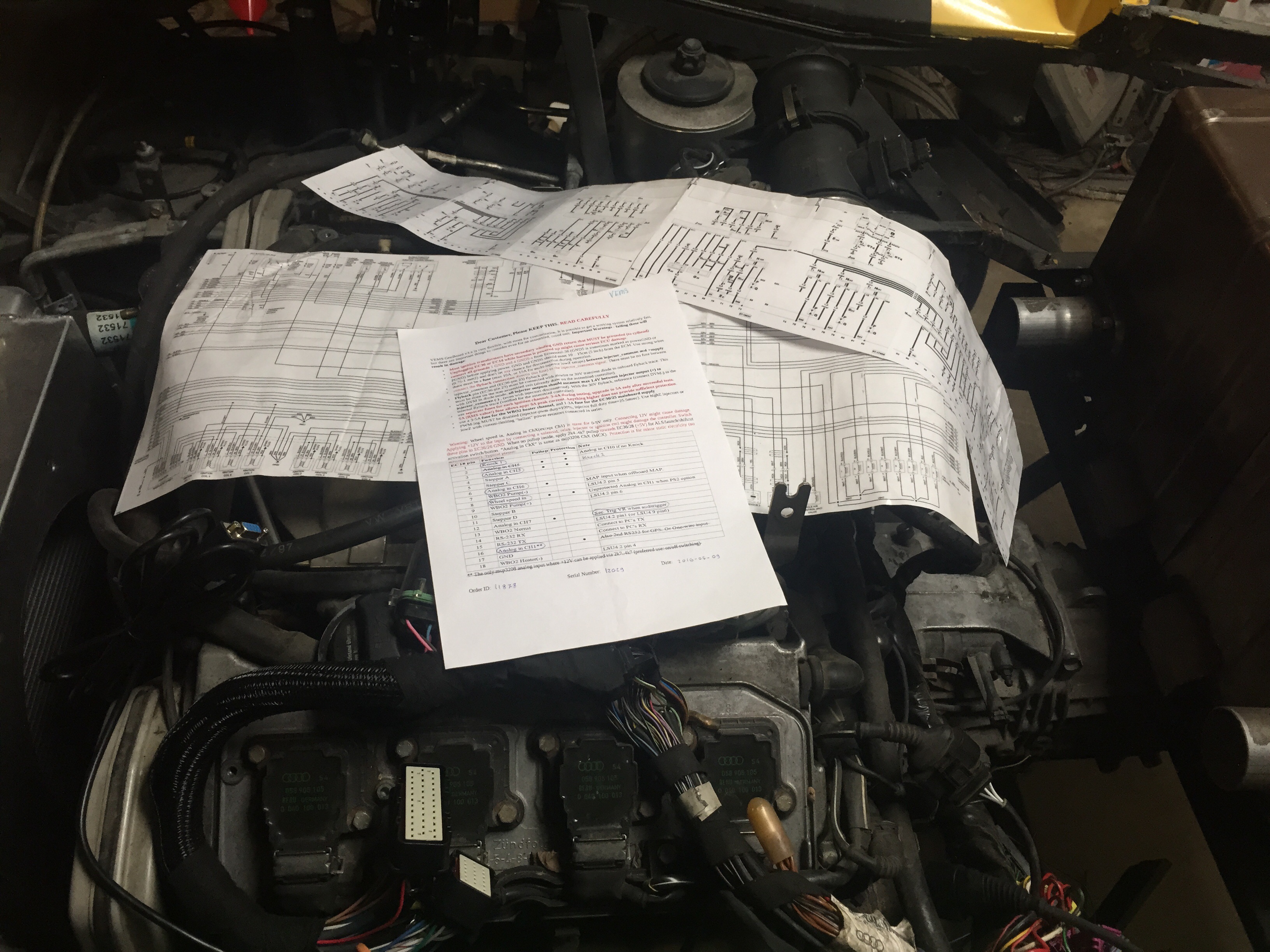

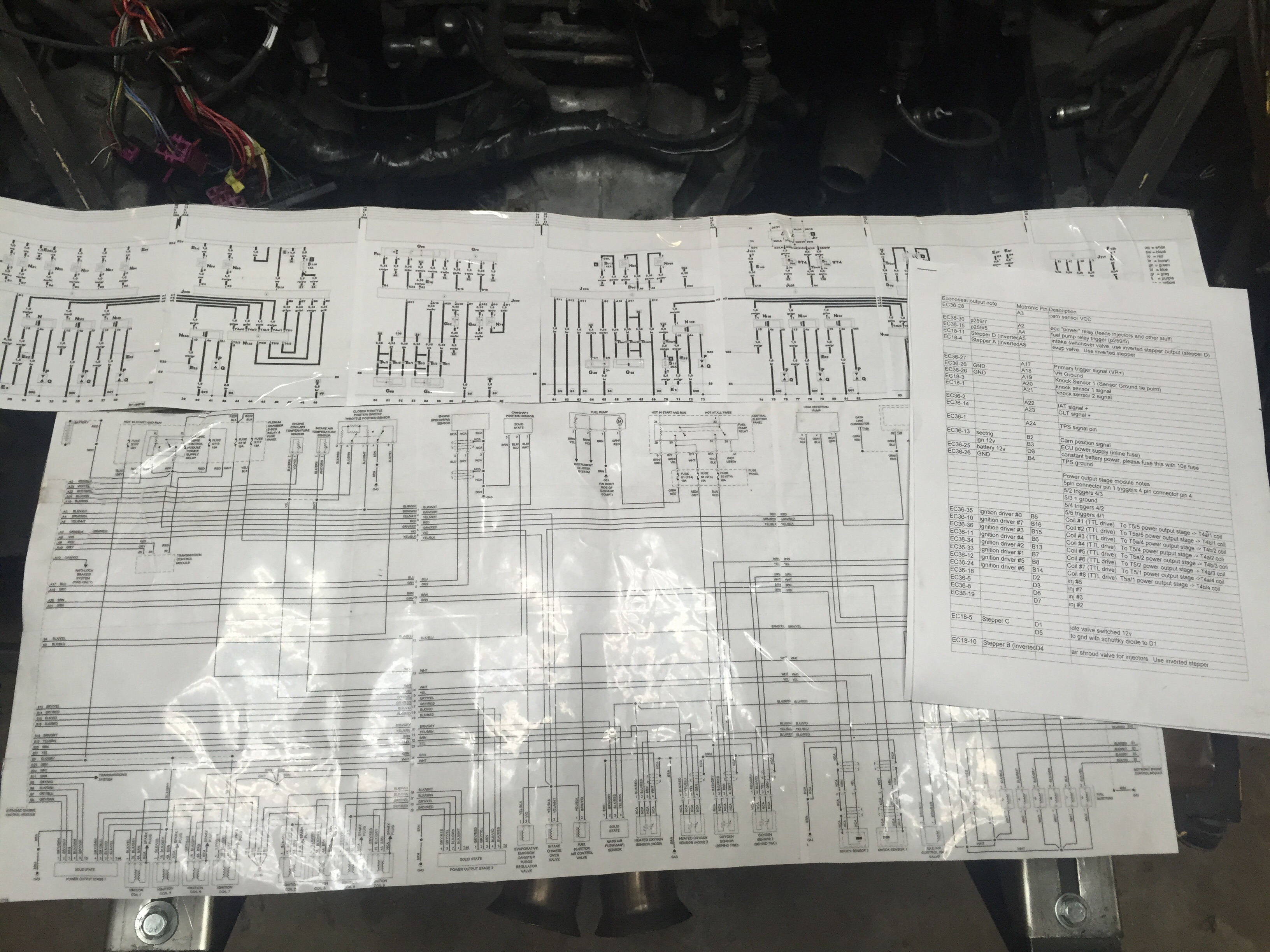

So I printed out and laminated the wiring diagrams so hopefully I canget them all figured out. I didn't know I needed another O2 sensor so I need to order a WBO2 (LSU 4.2). Still just trying to figure the system out. I see no inputs for power on the adapter harness that Marc made so it has to come off one of those wires mentioned above. I know Marc is busy so hopefully he will have time to email me back. I just don't want to go hooking things up and mess up anything.

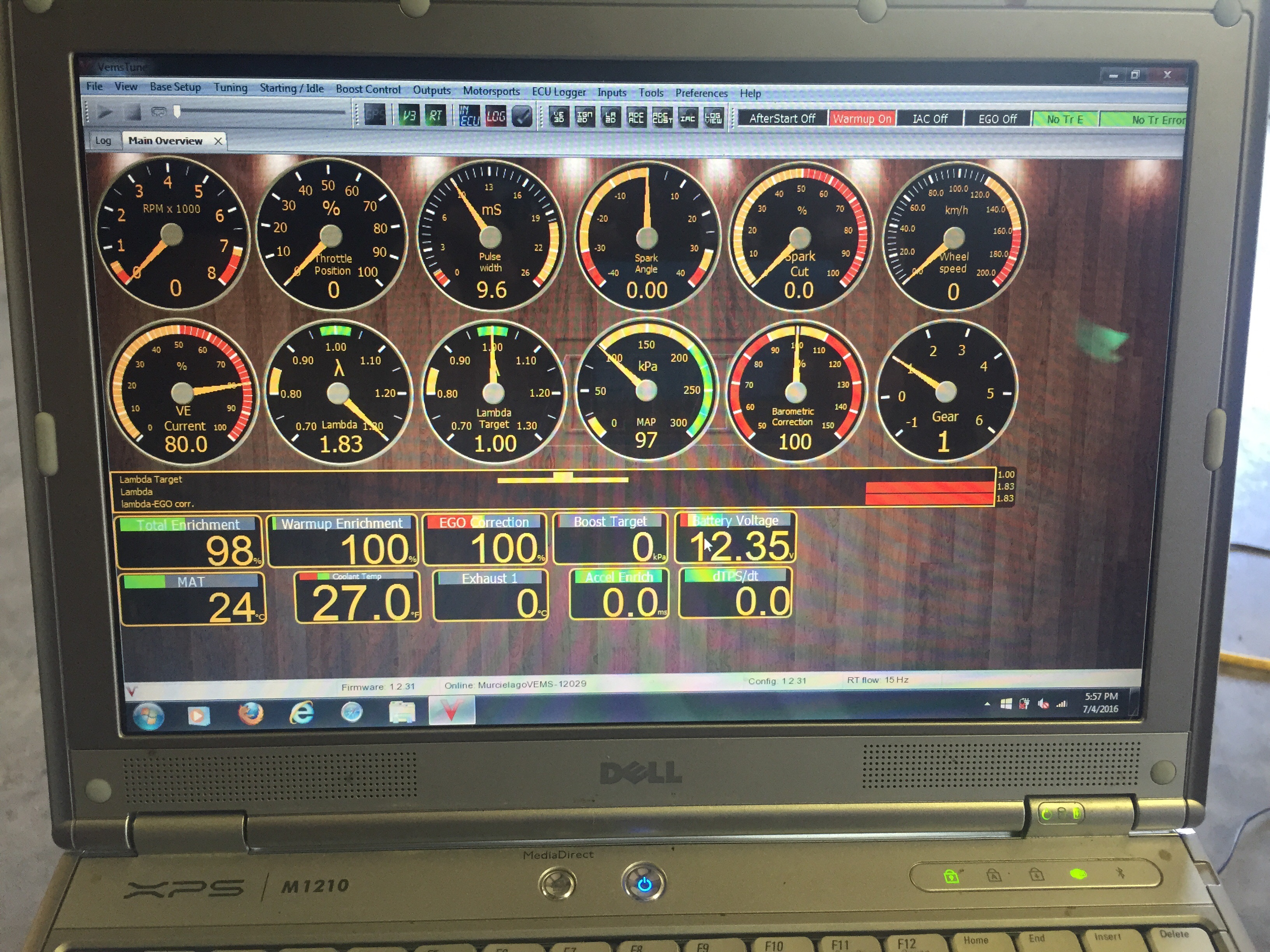

Finally traced a few wires enough to locate a couple hot wires that needed to be connected to the harness to power up the VEMS. Got the engine turned over but no readings changed on the laptop. Need to read up more on what I need to look for.

alright, so you're pretty close by the looks.
sensor readings look fine. first things first is to see if you are getting any triggering. what you are looking for is if the rpm gauge moves while cranking. note that voltage can swing quite a bit and it might drop comm with the laptop while cranking so you might not see it. other way to tell is if you are getting spark or fuel while cranking.
if you dont have triggering at all, start there, might be some issues at the sensor, but if it was running before that tells me the polarity might be backwards (which would be my fault, but its easy to fix in the harness on your end without shipping anything).
I'll try and get back to your email later today.
bottom line though, if you had it running with the stock ecu you pretty much have all the wiring already done that is necessary for it to run on the vems.

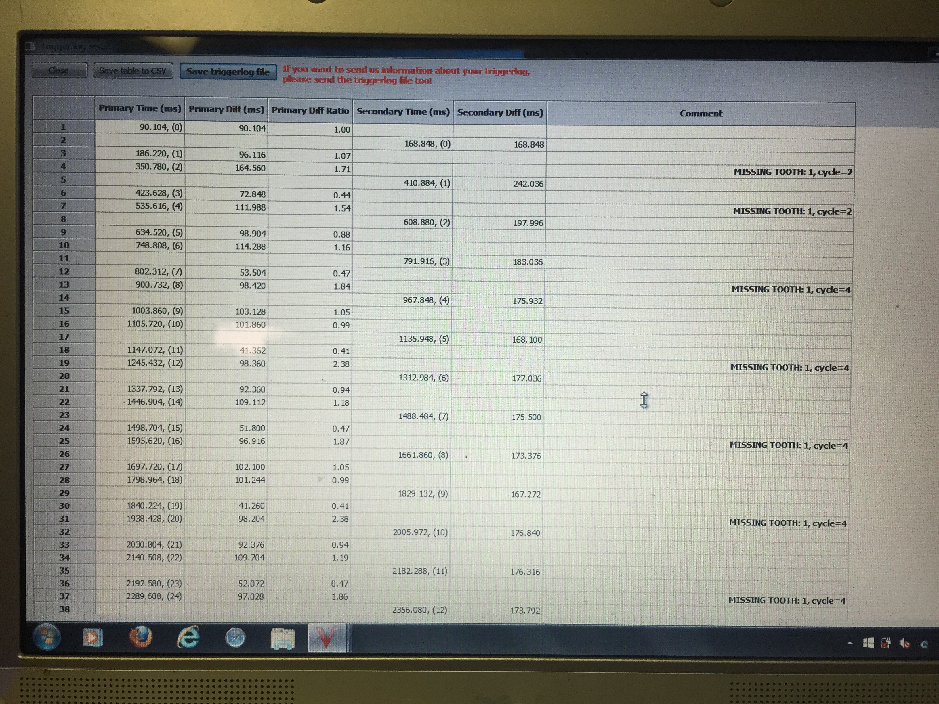

Here is a quick snap of the recorded trigger log. If it's easier I can email it to you. I don't really know what im looking at, im going to also continue reading up. Lots of different things to research on this!

I want the .triggerlog file that was generated in your vems_files directory. send me that.

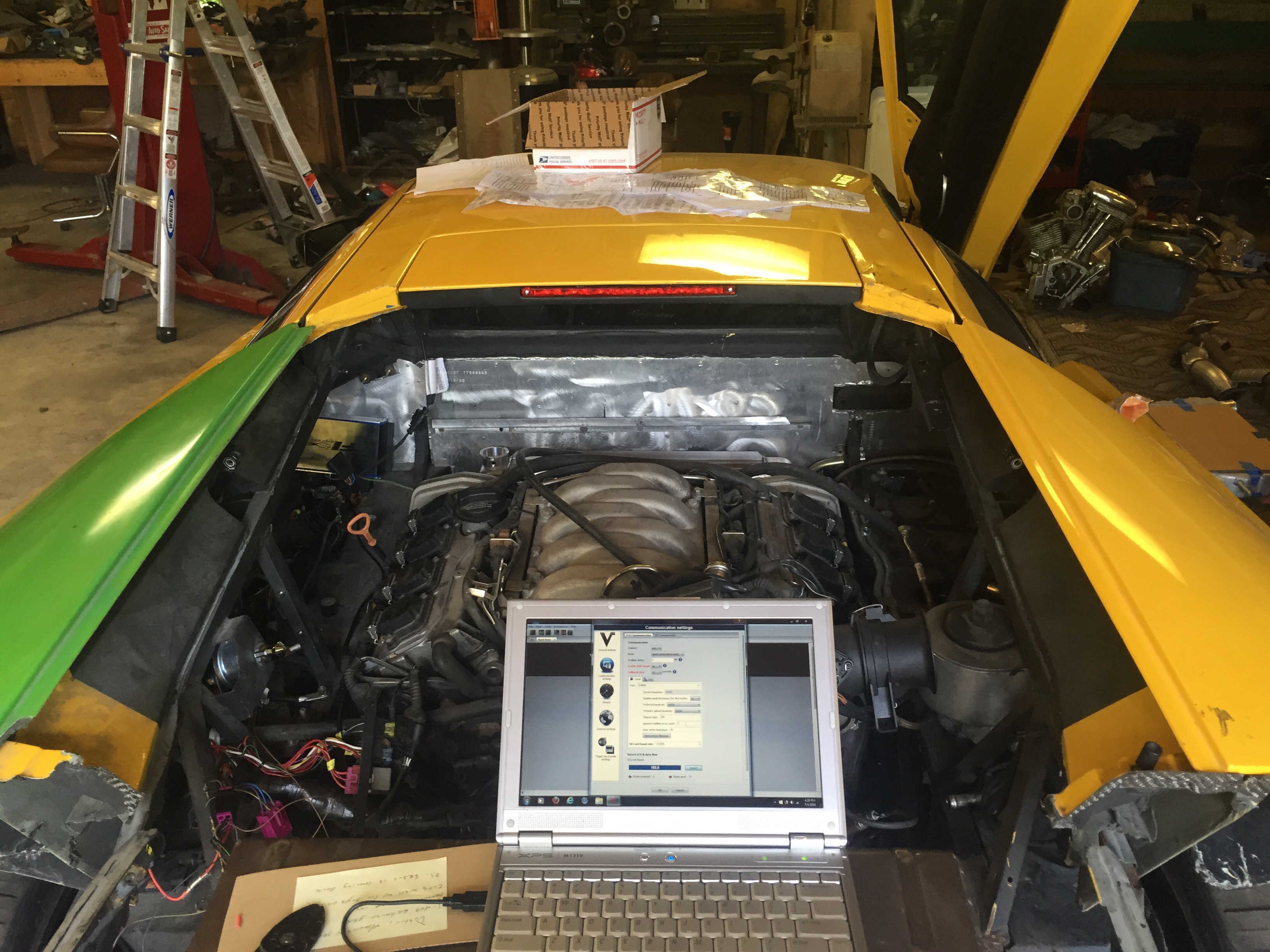

So Marc and I have been at it all day via emailing back and forth trying to get this thing going... We're getting really close timing is still kicking my rear but we have fire and fuel! If I can just get them to hit at the correct time. Made this little video.
