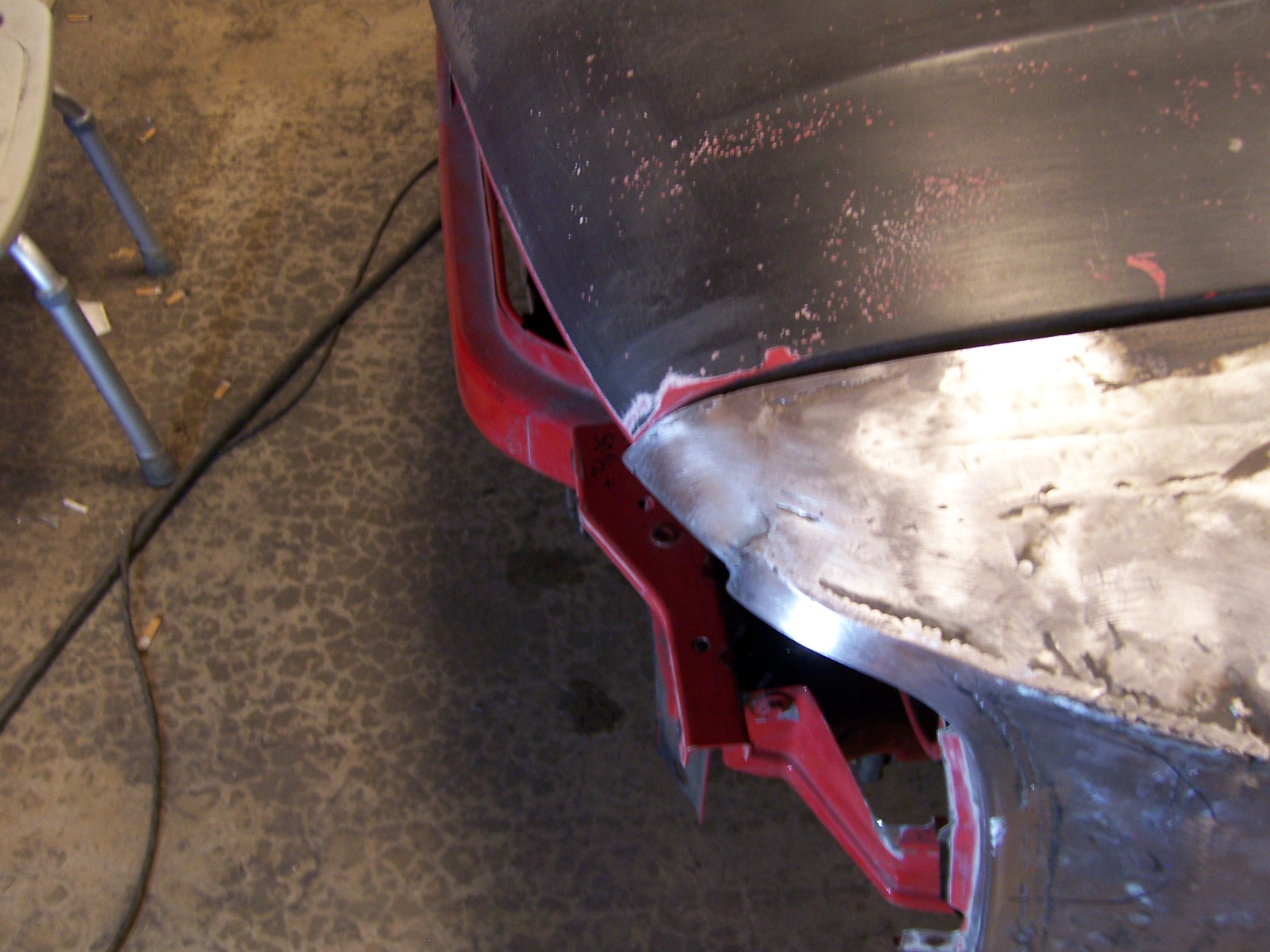

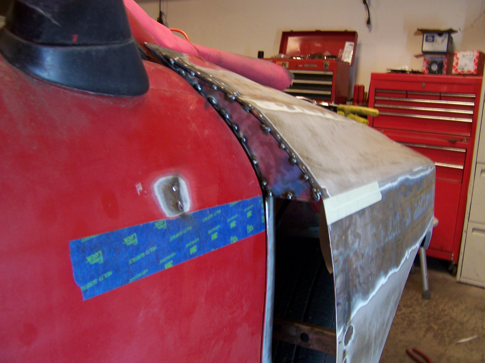

So had some time to work on the car. In order for me to place the Headlight/Headlight Frames, the back of the Front fenders needed some rigidity. Because the back of the fenders more or less floated Adjustments in that area caused the front of the fender to move.
At this point I decided to stabilize the back and work my way forward while paying attention to fender height as I went.
This:
To this to get started:
Not much but progress never the less.

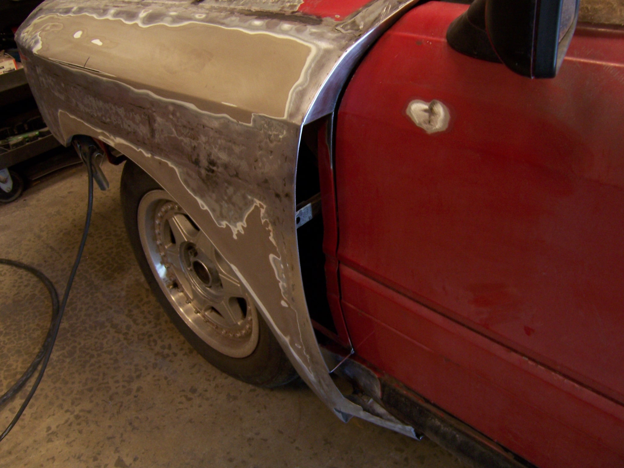

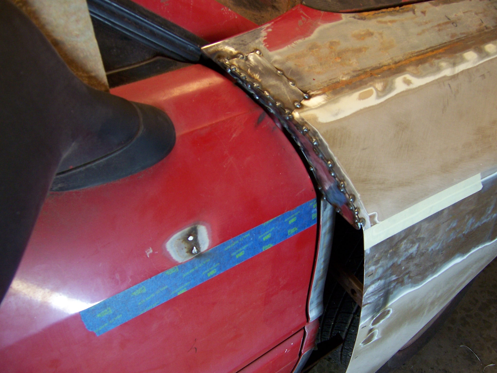

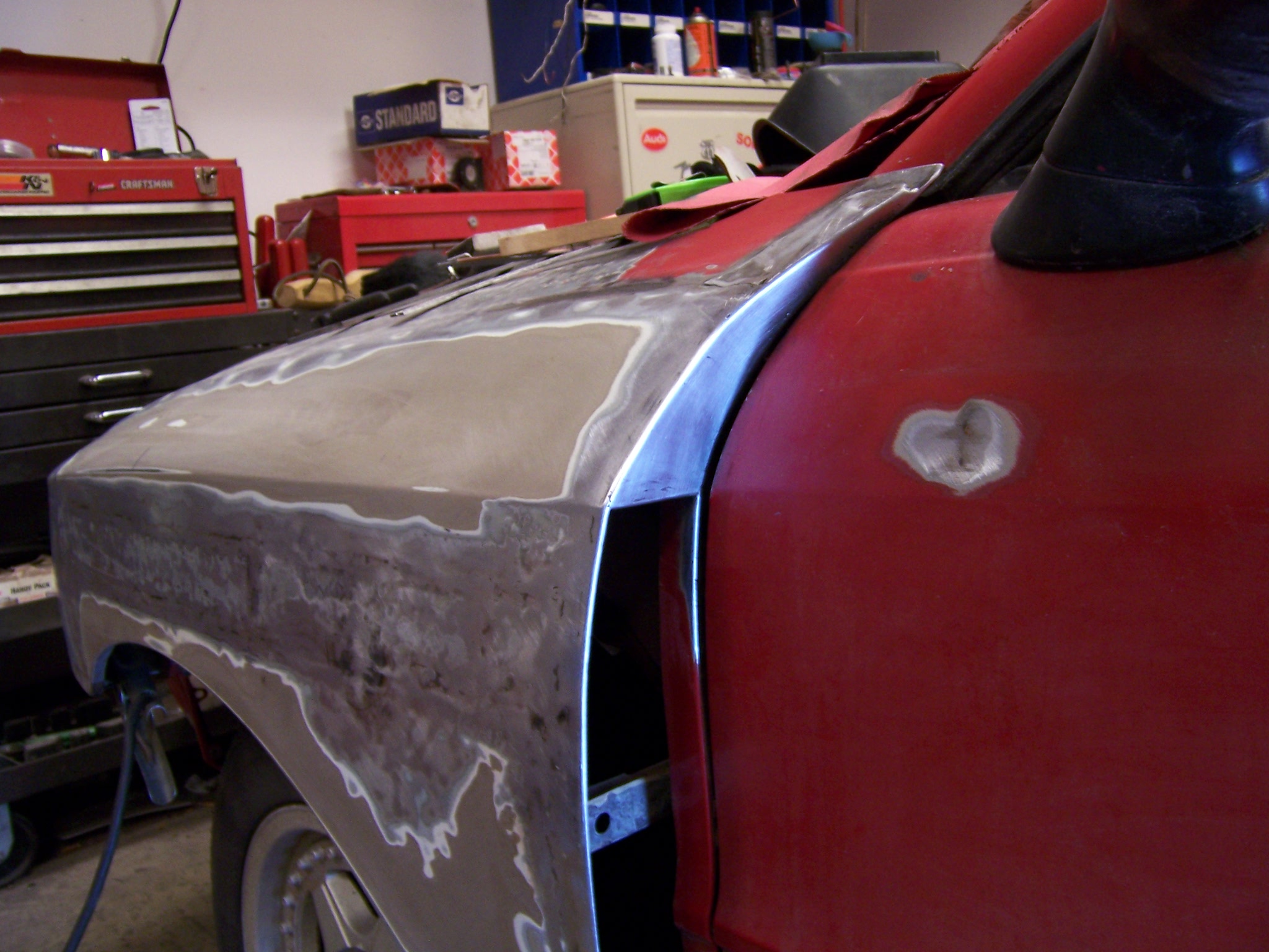

Did more "Edge Refinement" on the slot of the fender in the quest of stabilizing the sheetmetal. Since I don't have a bead roller I have to use wire frames to get a nice edge on the metalwork. I bend these by hand and the process is not fun as the wire is really stiff. :wah:
Final slot size (Blue tape on bottom for visual aid)
Doing this produced the desired results of increased stability.
PRY4SNO wrote:Devil is in the details, keep it up!
So true they take so much time, but are most important for the overall look/feel. :wave:
You could try to roll the metal around the wire if you have room like the old large fendered cars.
Looking good for sure!

ringbearer wrote:You could try to roll the metal around the wire if you have room like the old large fendered cars.<br abp="672"><br abp="673">Looking good for sure!
That was one of the options I had , besides beet rolling. I had cut one panel already to a bodyline so there was not enough metal to roll it around the wire.

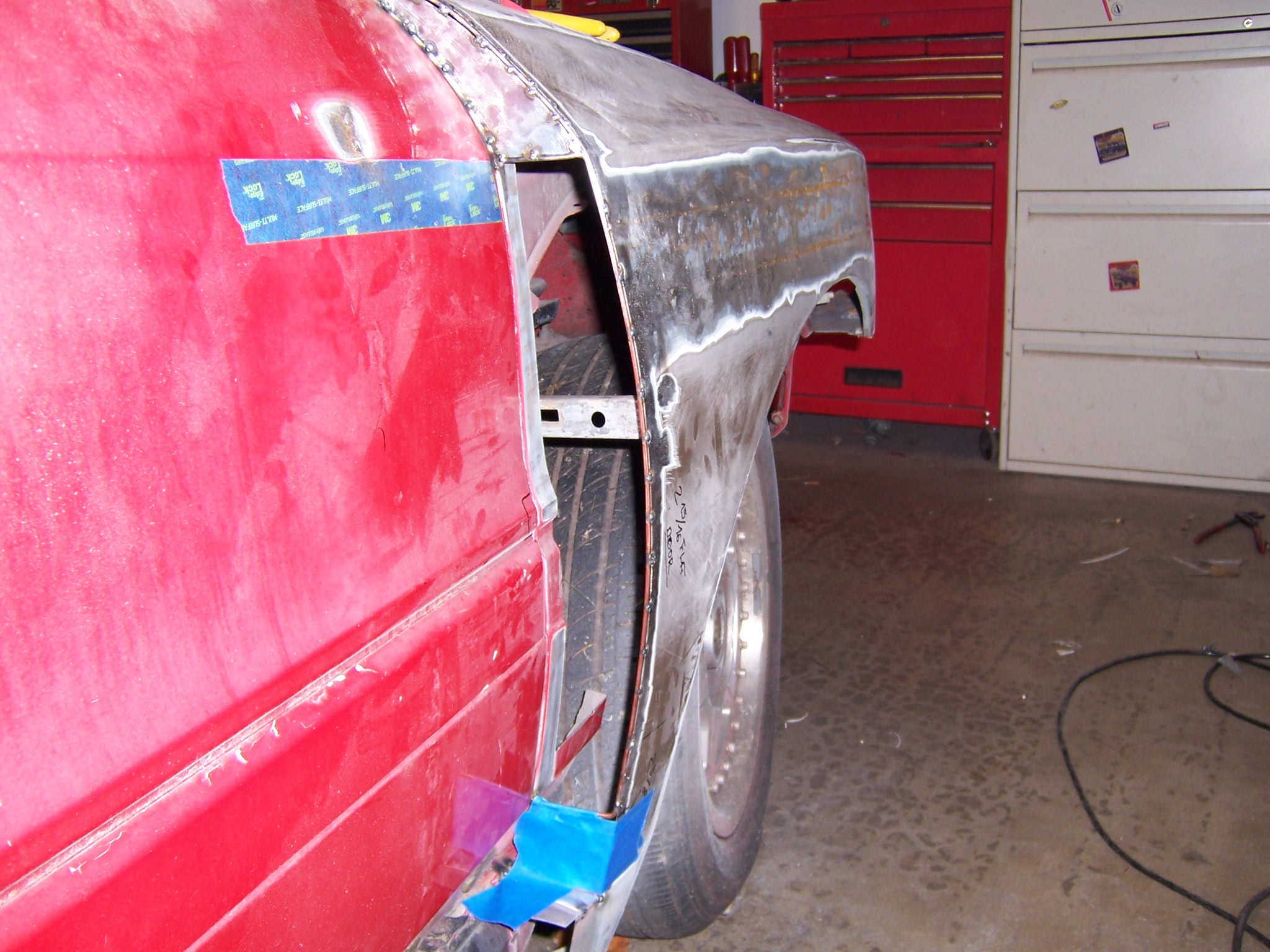

Finally more work done. Driver side fender got some love in the slot area. Placed wire frame , Welded and Ground flush.
Some of those edges are starting to take on a finished look. Area above slot got the same treatment on the fill panel.

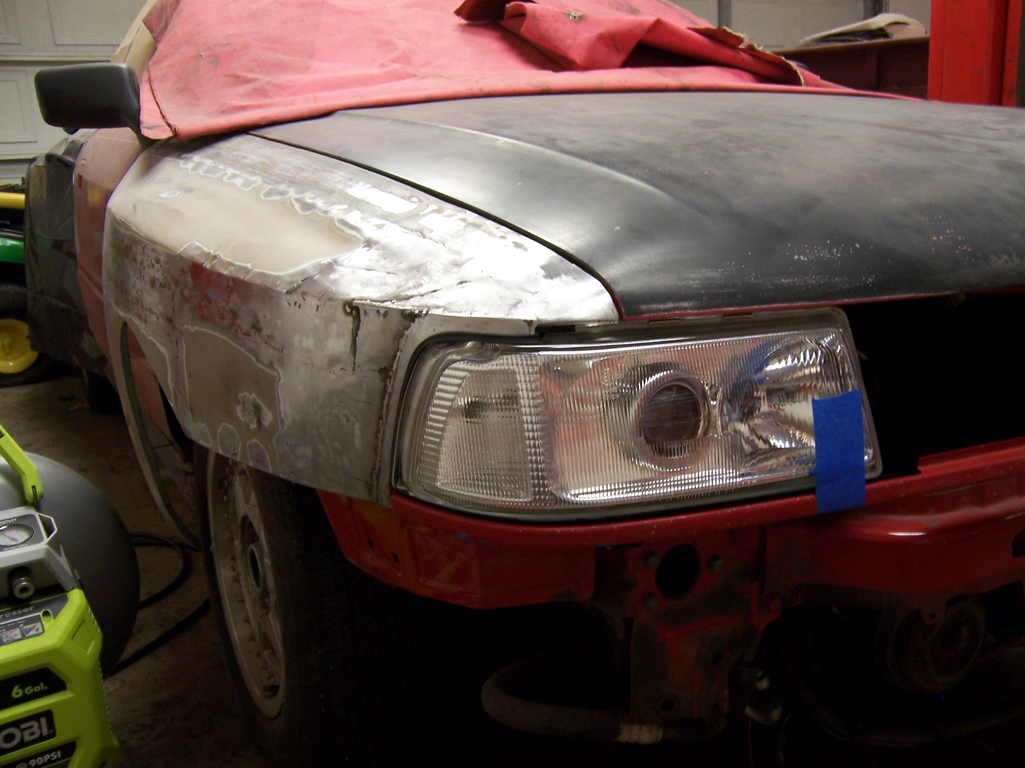

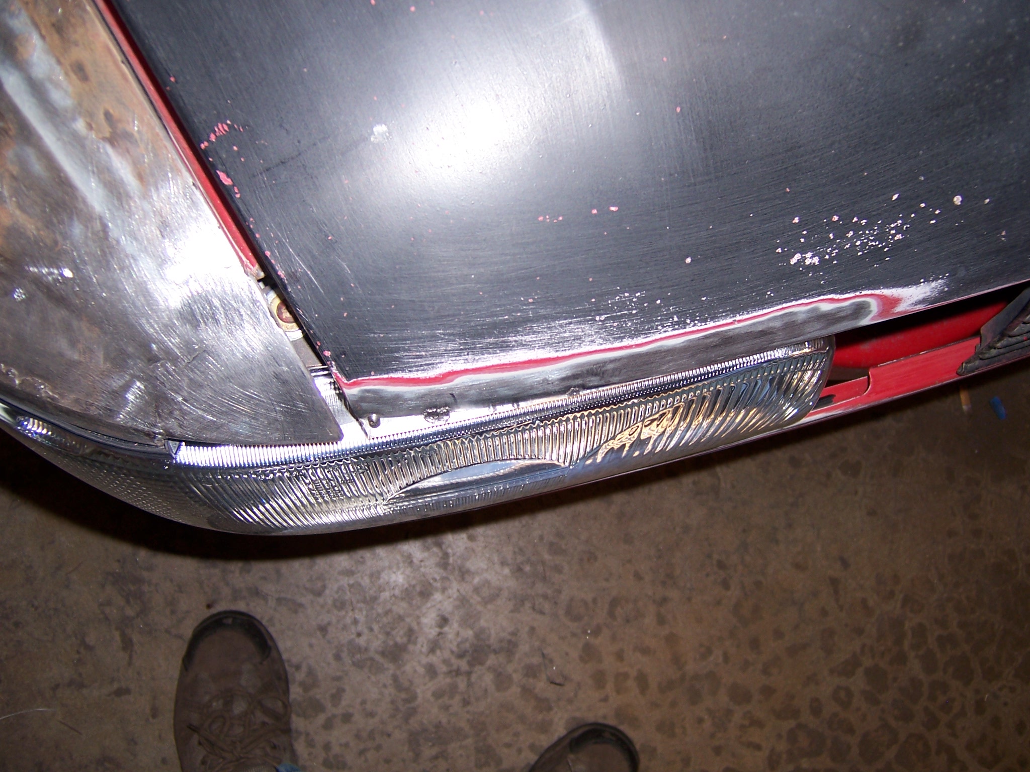

Had some time to do the headlight frame on the drivers side. Not as elegant as I hoped for but bondo will do the rest. Had to cut the fender upfront to do some more tugging and pulling to make it all come together.

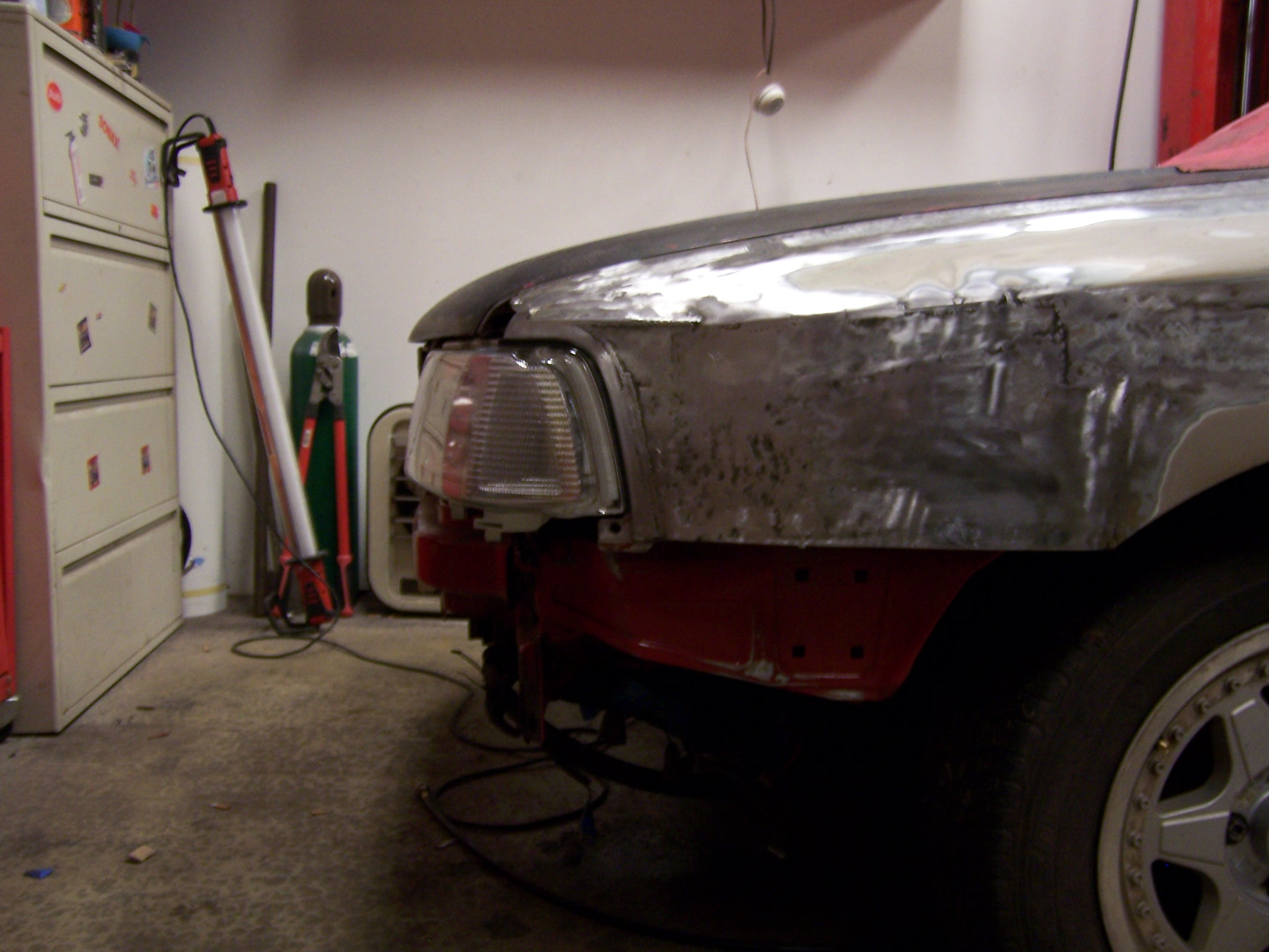

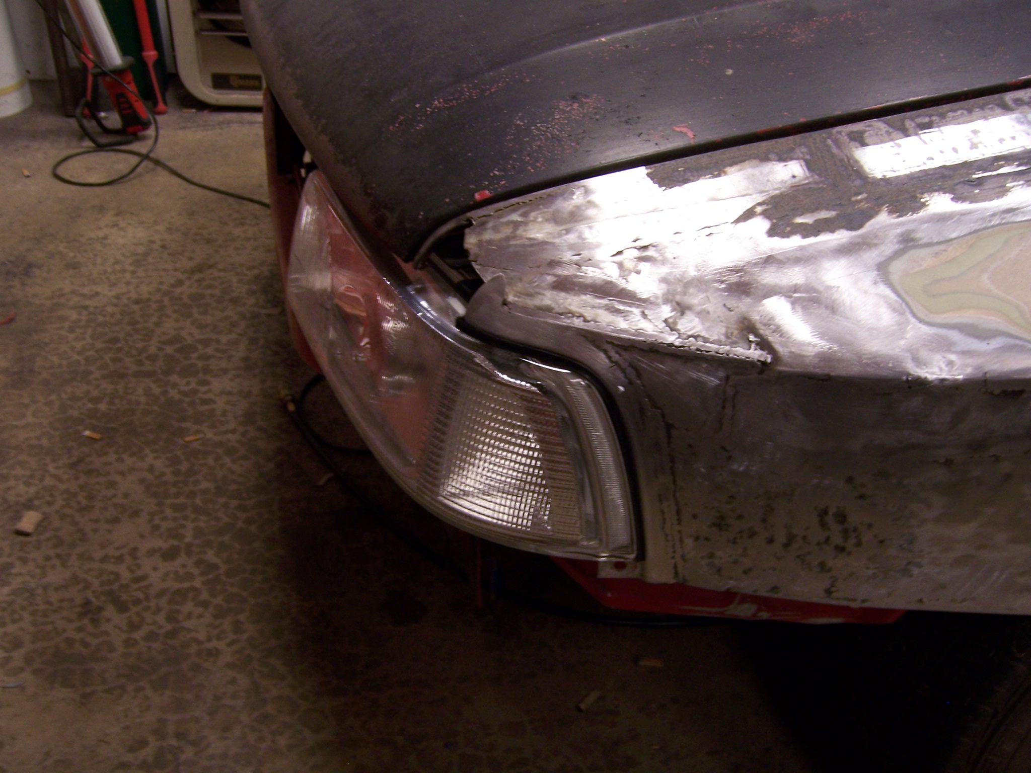

Noses of fenders on both sides are done.
Was working on the headlight trim when time ran out . It sits as is.

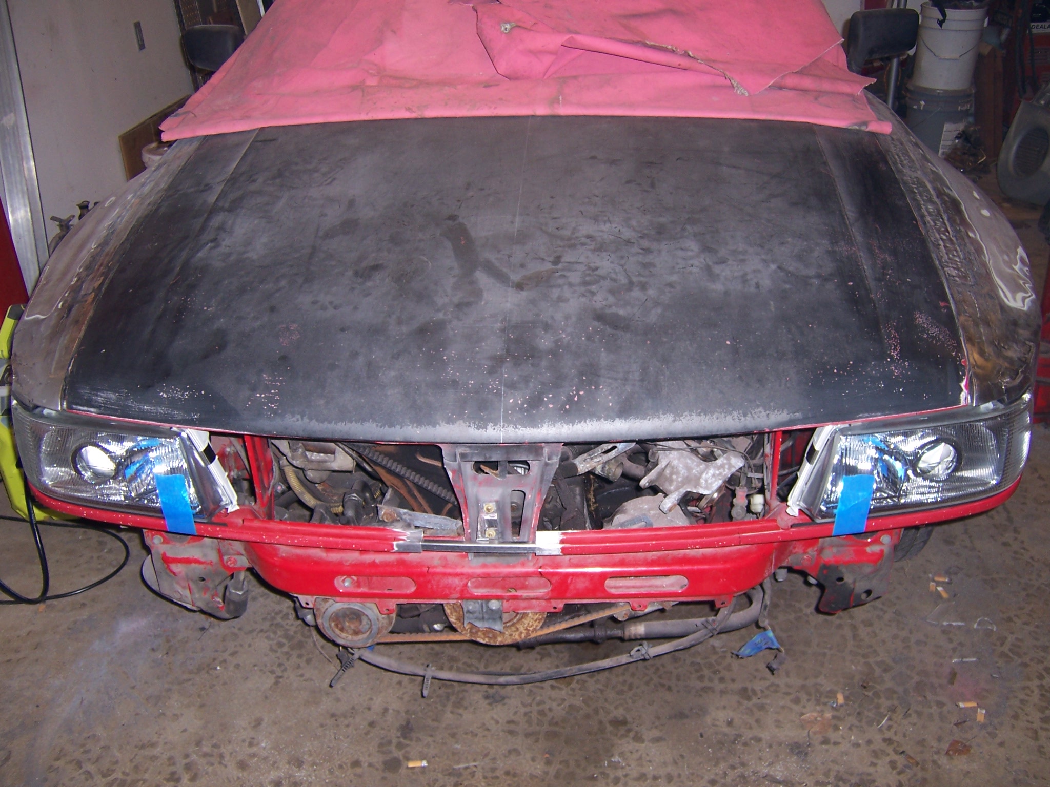

Hood was in need of some "bondoshelfs" to line up with the rest of the front fenders.
Headlight trim is welded back together and waiting for filler.
