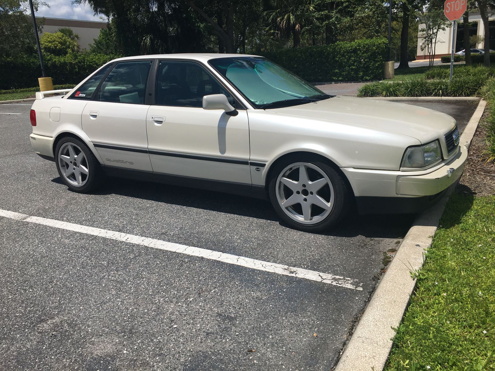

Nice Work! I have read thru all the post a few times now & enjoyed the progression of your B4 project.
Here is a picture of my B4 I picked up last summer.

A1QSHIP wrote:Nice Work! I have read thru all the post a few times now & enjoyed the progression of your B4 project.
Oh shoot .... hey that might be my friends old car! Did it come with ATS type 10’s on it ? From the west coast ?
Bought from a guy in Orlando, FL who got it from someone in Utah. It came with the wheels shown.
I'm wishing that they were 5-lug now but that swap is soon to come.
