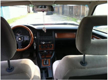

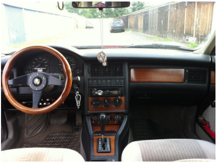

Oh man, that thing would have been a PERFECT candidate for this build... 2.0 means it has the motor mounts & most other bits to do a 1.8T swap, and its already automatic. Ugh.
I'm going to try and install the B5 shif lever & trim when I do the swap, but I'm not quite sure how it will all work out. I would also really like to have a screen showing gear for tiptronic mode like the A4 had, but that is likely beyond the scope of my electronics abilities. Obviously I have some work to do on figuring this all out. LOL
Has anyone swapped a b5 cluster into a b3/4 dash? That might be my best option if it's possible...
