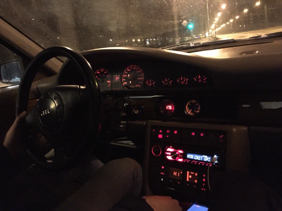

Dmitri's got the newer style (C4?) CC module in his 200! I'd be interested in finding out what's involved with that swap. Even without functional A/C, I'm about done with the GM unit.
- xPhnNAwWsaQ.jpg (110.58 KiB) Viewed 28816 times
Ok now I'm interested...
Whoa. That's awesome.
Hot Damn.
Probably need all the associated controllers, and probably the heater box/the gadgets retrofitted to the T44 box.
Still don't know for sure if the boxes are the same from c3 to c4.
Now we just need to learn to speak Russian so Dmitri can explain it!
I have a prefacelift b5 cc unit (new style, same as in C4?) and it doesn't fit without major modifications..
Got the unit for a cup of coffey.
The steel plate behind typ44 cc unit is too small for the b5 unit to fit. The wiring is also quite a bit different, but this could be altered I believe.
I thought to do quick swap with wiring mods but found out that this would need hacking the steel plate and gave up.
Maybe Dmitri could help us out?
I believe the last V8 Audis also have the new style cc units so this should be applicable for the 200 also.
