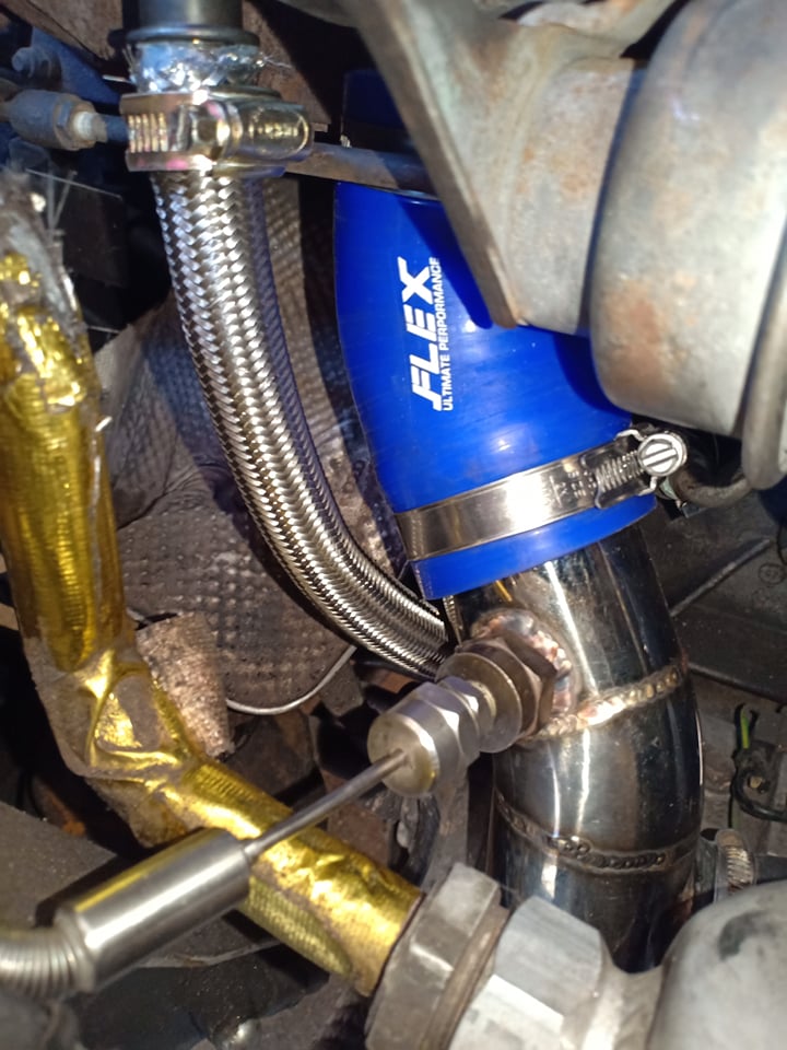

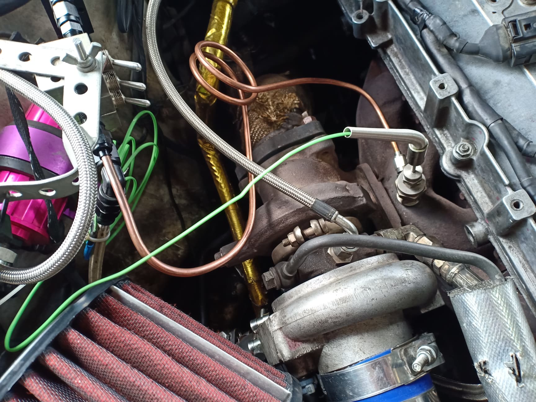

The back pressure sensor and EGT sensor in front of the turbine are finally in. Haven't hooked up the new EGT yet because I want to integrate it into the current sub-harness. The BP is working now. And yes, the turbine is restrictive. Have a EMAP/IMAP ratio of 2.5:1. No bueno.

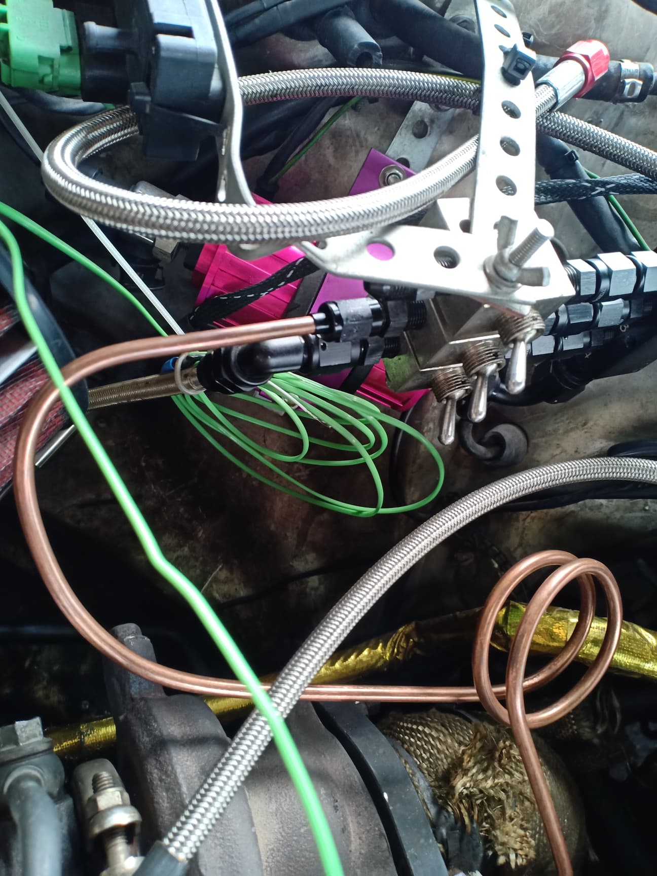

Also installed the water injection stuff, but with less success. Found I cracked the top of the pump and some funny things happen PWMing the DO solenoid with VEMS. Solenoid is connected to EC36-34. The nozzle holder is in, but I'm not happy with how I mounted the hose and solenoid.

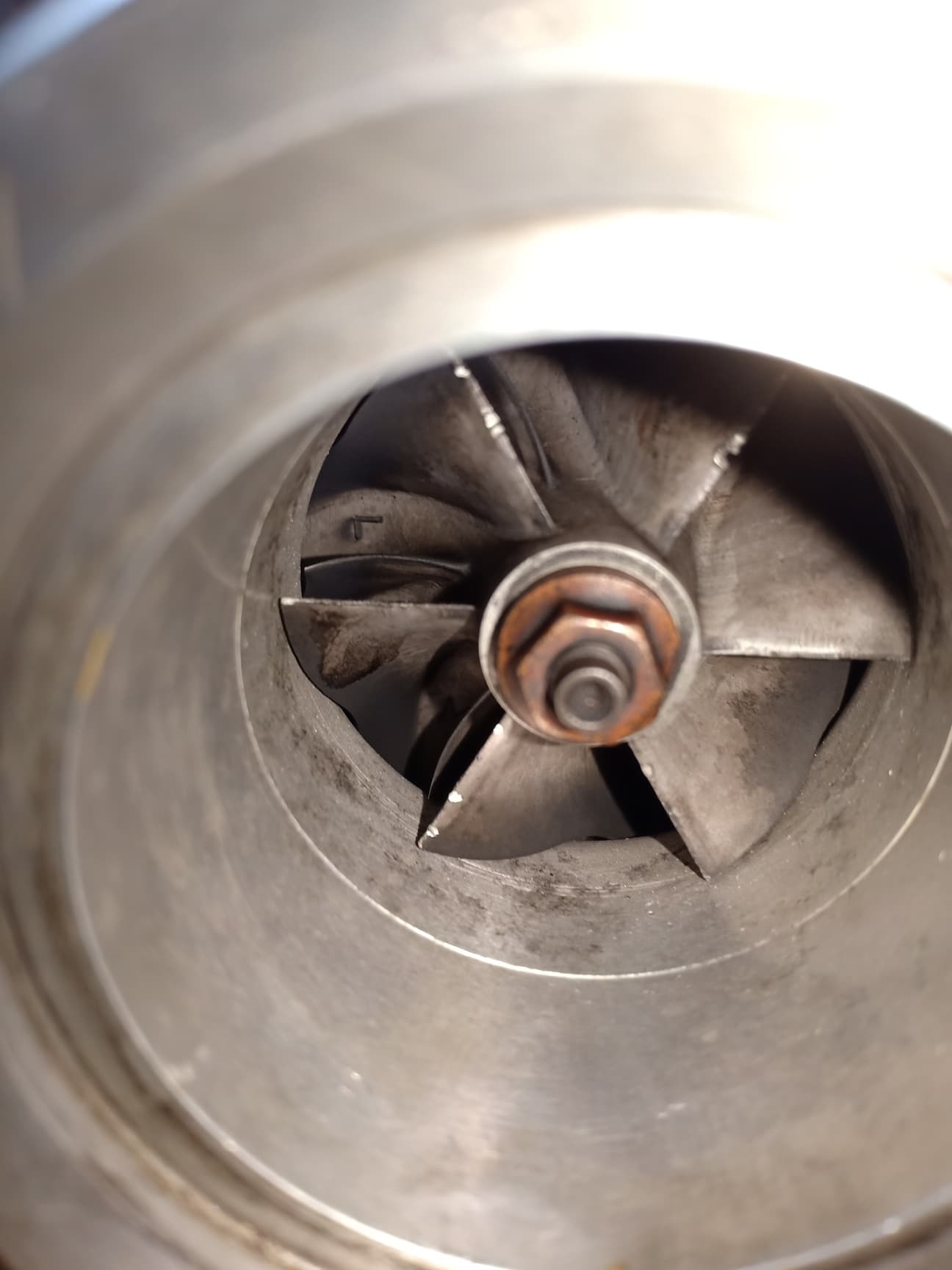

Oh and managed to damage the compressor wheel with my dumb ass.

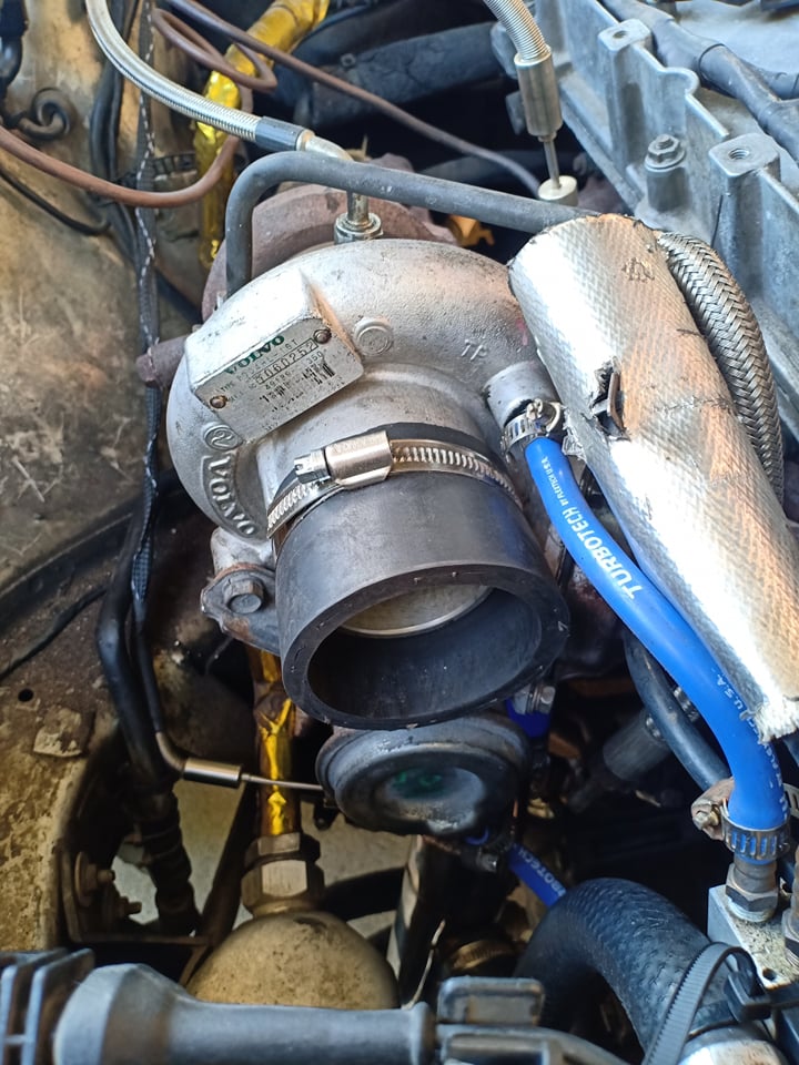

The 15T turbo was worn out. CHRA is done and a good deal on a TD04HL-16T from a Volvo came up on FB marketplace. Swapped that in after a bit of clean up and fiddling around. Bolts right in to the old hotside. Got a new turbo to IC pipe welded up yesterday and it should flow way better than the old monstrosity.

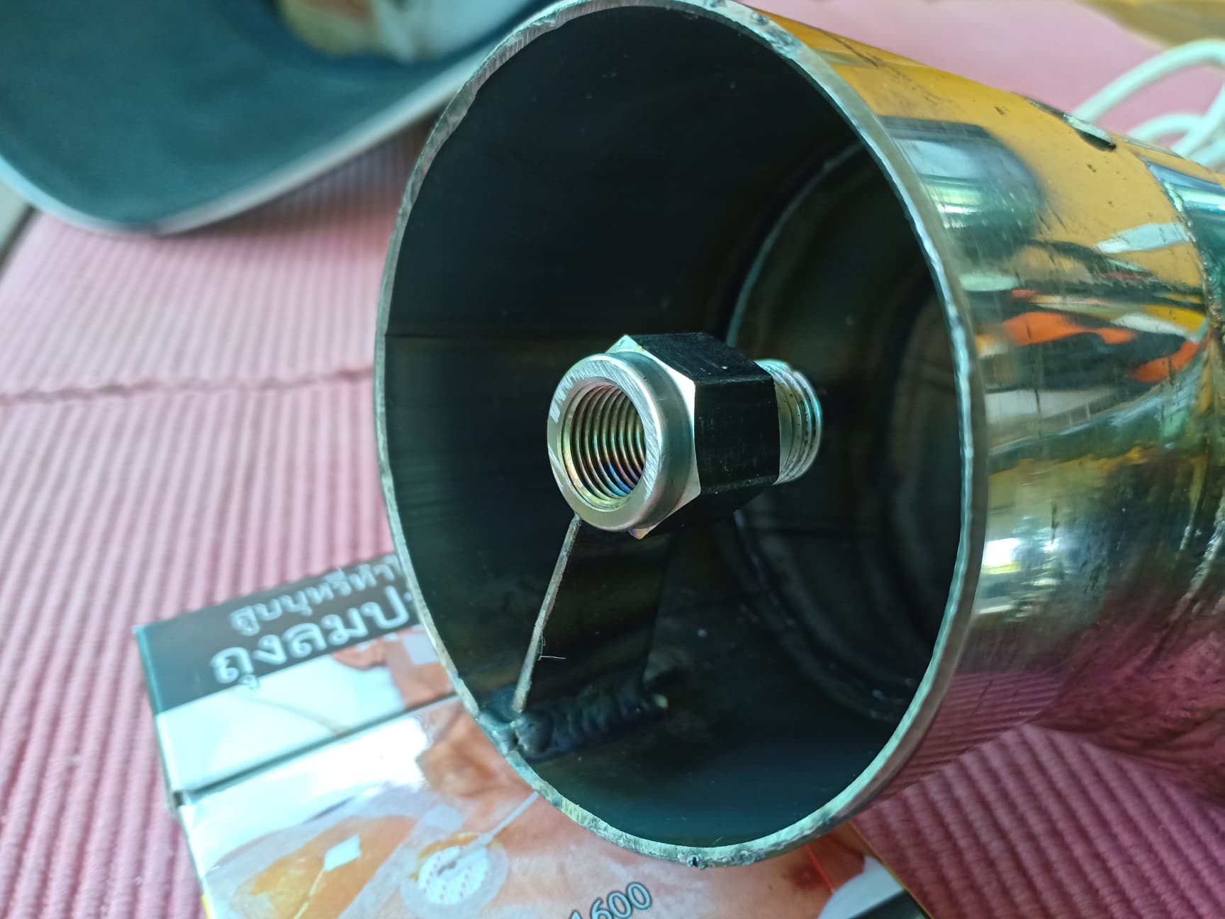

The K type in the outlet shows 170c at WOT @ 210kpa, top of 4th. I love data.

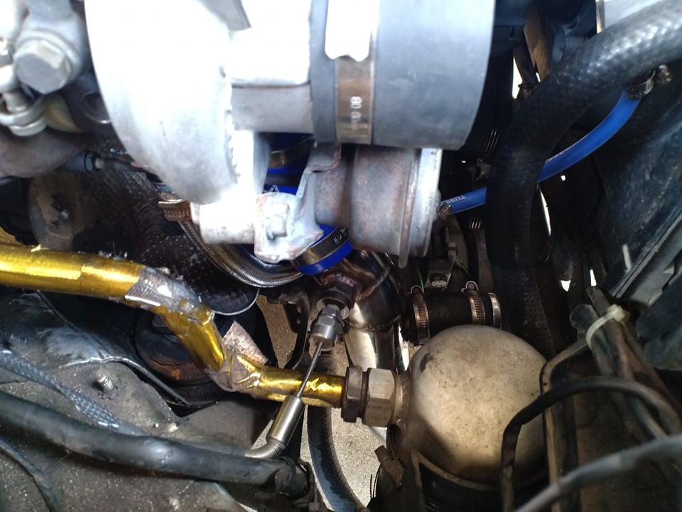

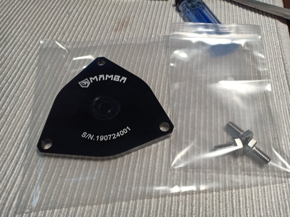

Tech tip: If you ever use a TD04HL with stock oil drain, an AN-12 PTFE hose slips right on, just tight enough. Also, the stock Volvo turbo has a Compressor Bypass Valve. The diaphragm might be K, but the seal ring is not. Got a block off plate from Mamba and now it doesn't leak! Yay.

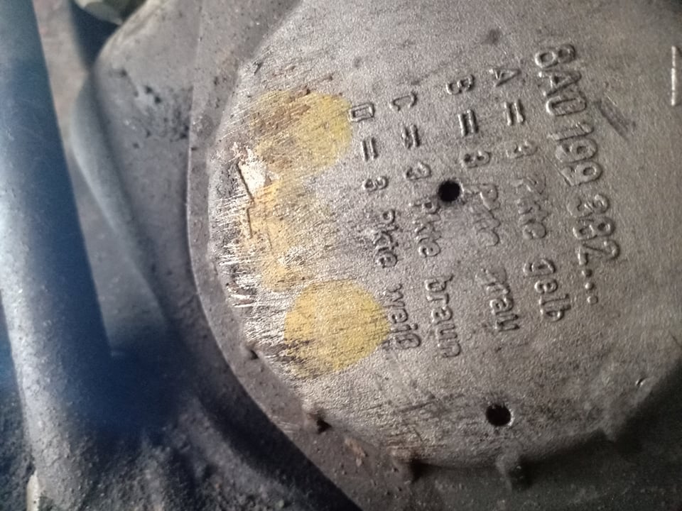

- AEB to ABK mount.jpg (119.36 KiB) Viewed 11266 times
- 16T pipe EGT 1.jpg (93.4 KiB) Viewed 11266 times

- 16T CBV block off.jpg (96.78 KiB) Viewed 11266 times
