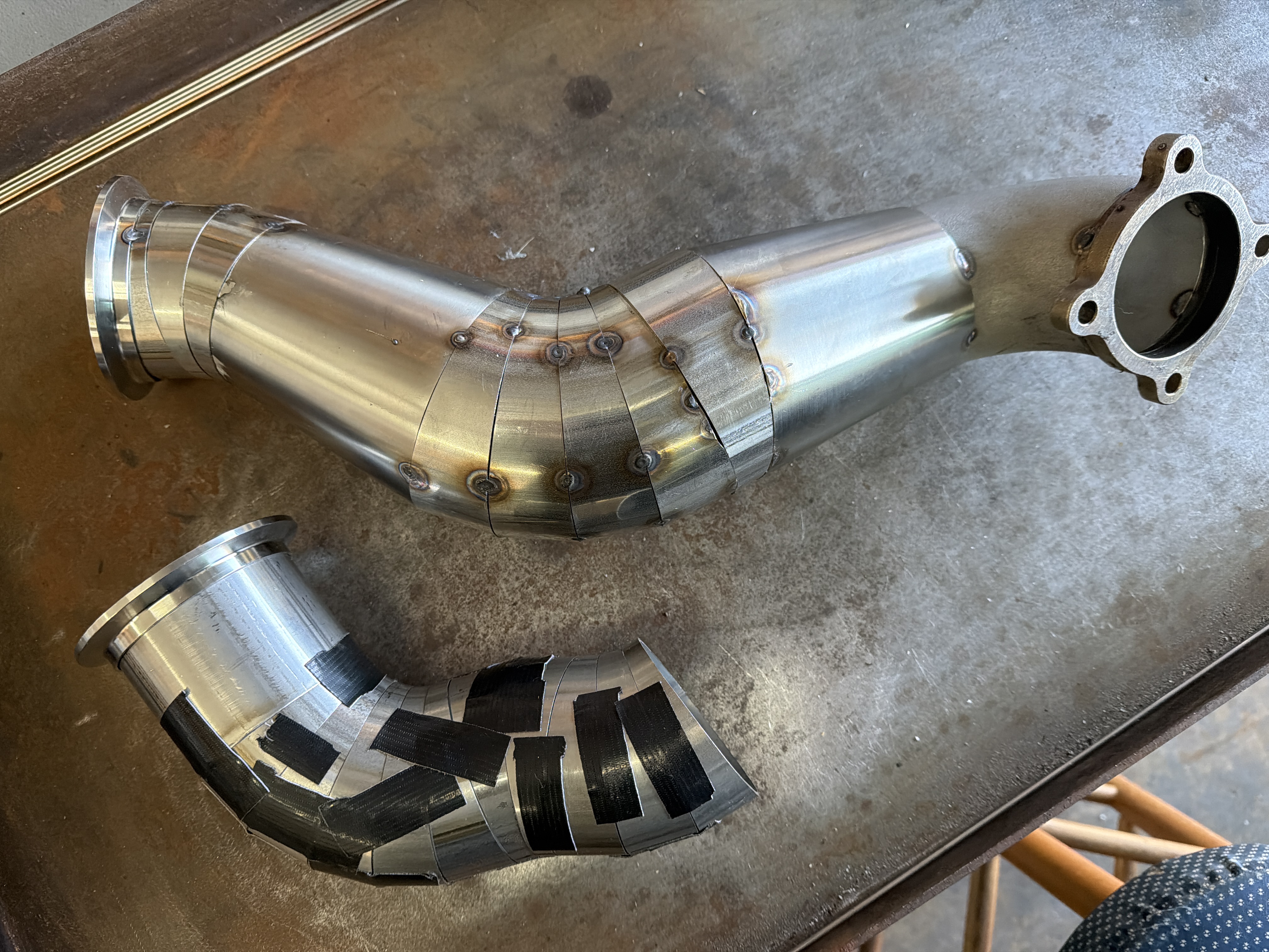

Re: Andy's 91' 80q
Posted: Thu Feb 05, 2026 11:16 am
by rennenmsports
I shortened the downpipe a little to fit this
I hope haha. Wish me luck. 3” oval tubing. More ground clearance and will leave more room from melting the axle boot

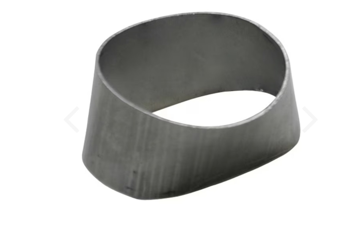

Re: Andy's 91' 80q
Posted: Sat Feb 07, 2026 9:42 am
by rennenmsports
Here’s progress so far. No oval tubing. Can’t get it to fit 😞 do you all run 3” tubing? I’m worried about ground clearance and melting things?

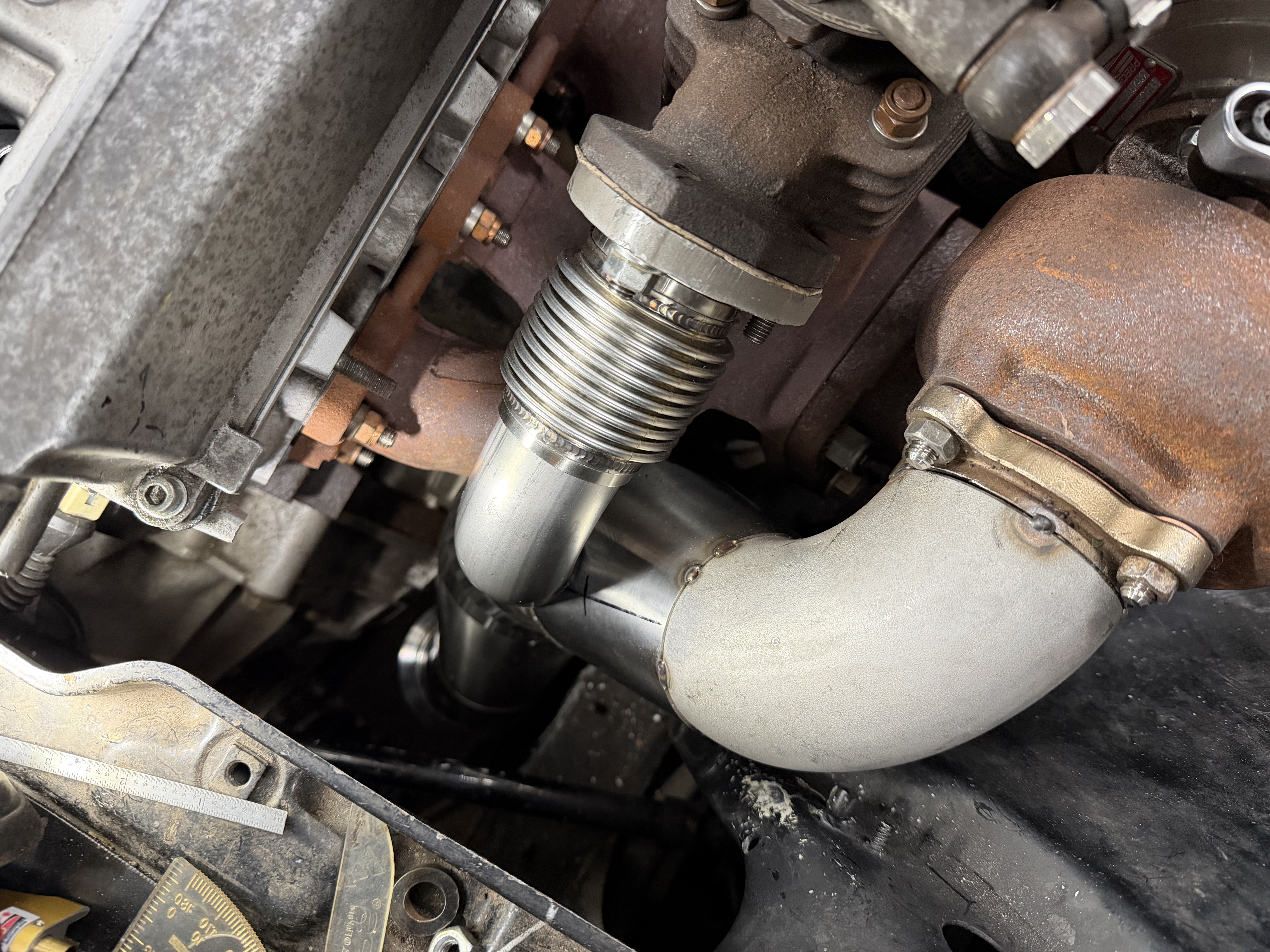

Re: Andy's 91' 80q
Posted: Sat Feb 07, 2026 1:18 pm
by rennenmsports
1 3/4 roll cage tool and a serpentine belt alignment tool to merge the wastegate into the downpipe

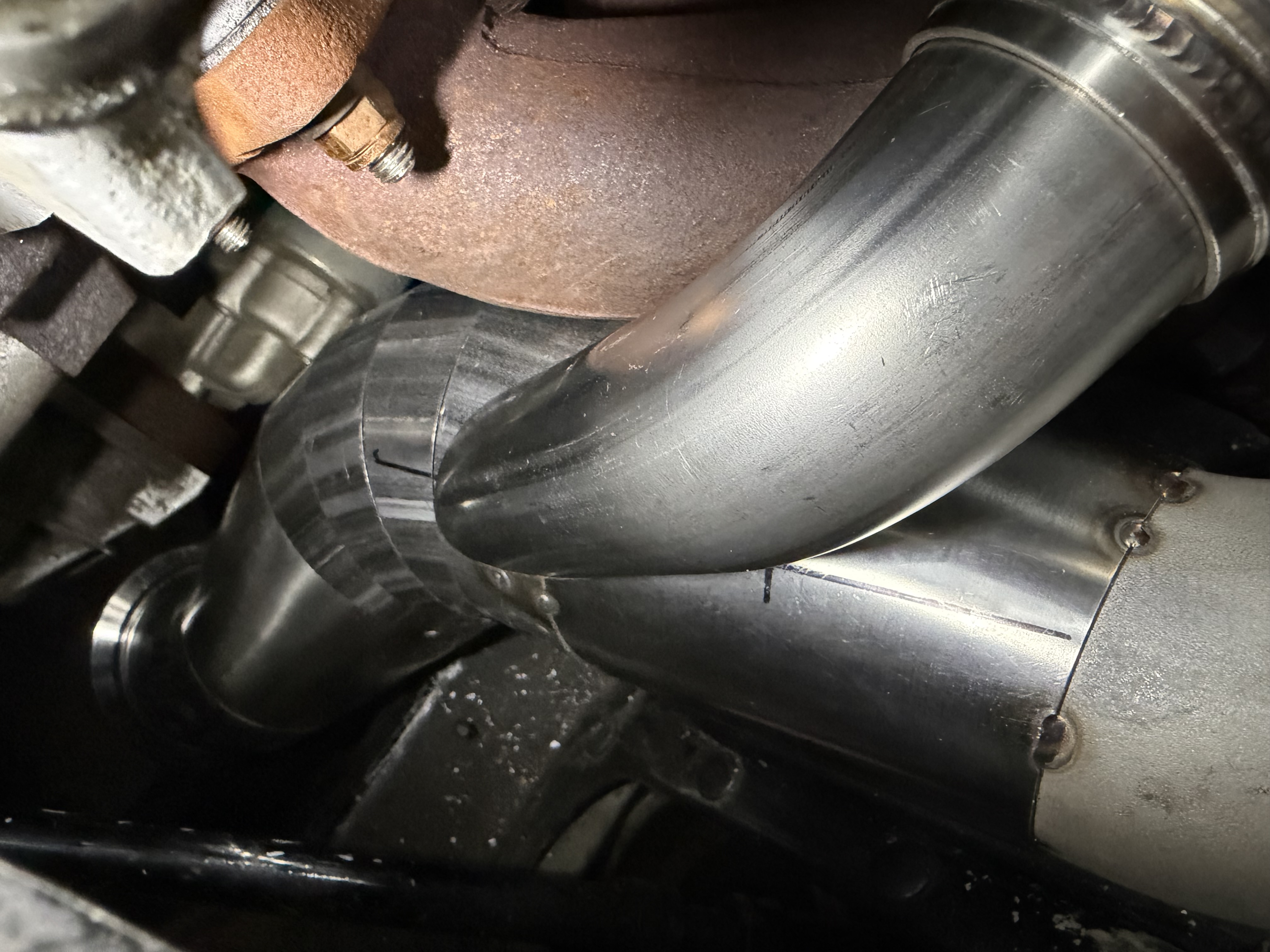

Re: Andy's 91' 80q
Posted: Sat Feb 14, 2026 8:32 am
by rennenmsports
I’ve got 3/4” clearance from the drive axle boot. Heat wrap and a custom heat shield

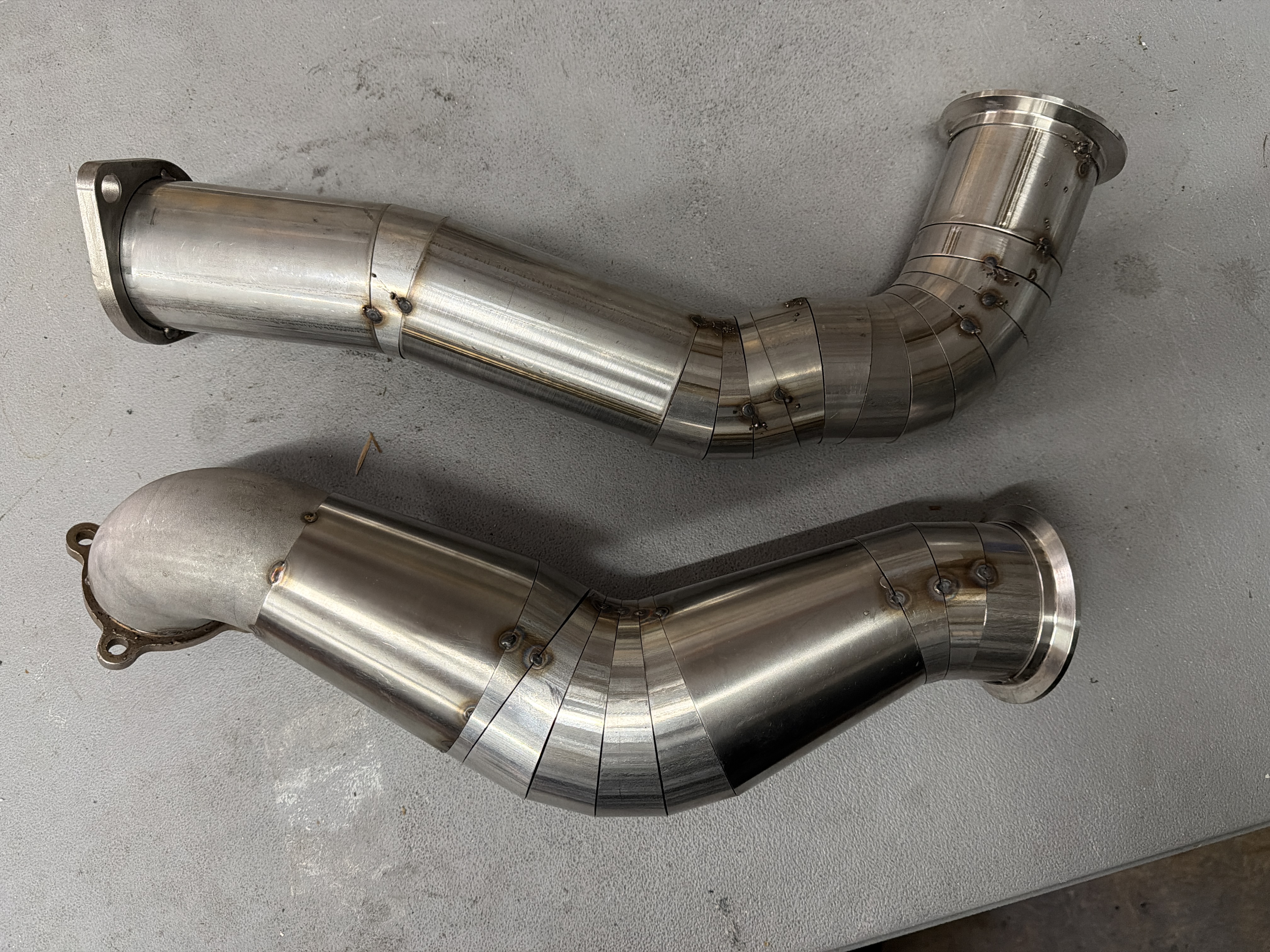

Posted: Sun Feb 22, 2026 4:59 pm
by rennenmsports
Got the downpipes all welded up. Had to take a little off the subframe pinch weld. Doing the heat shields and secondary support bracket now
