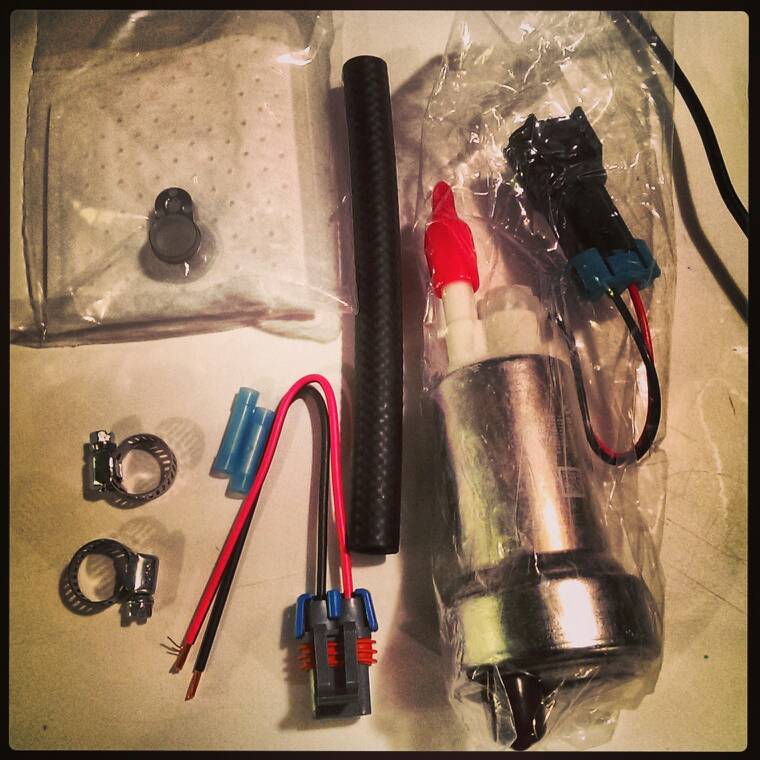

Walbro 416 E85 PUMP received...
S4Pirate
Posts: 58
Joined: Sat Mar 09, 2013 4:46 pm
Re: A tale of Rubí... Bottom End Assembly Commences w/PICS
Post by S4Pirate »
You gonna pop some kind of pickup on there? Curious to see how that works out. Looks good!

S4Pirate wrote:You gonna pop some kind of pickup on there? Curious to see how that works out. Looks good!
Wouldn't that cloth like pickup suffice?
S4Pirate
Posts: 58
Post by S4Pirate »
Funny, didn't even notice that in the pic. That looks a little different than the material I've used (not worse/better...just different). I've used pickups in jeep fuel cells and they all are usually more of a nylon mesh. Now we just need to get you some e85 to go with that pump :D
