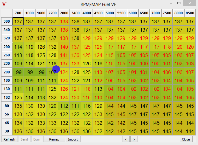

I took a look at your log. First I was looking at requested lambda and was like damn... that is spot on! I wouldn't change a thing! Then I realized my mistake LOL.
I gave it a quick first pass shot at tuning this a bit for you, but there is something wrong with my VEMStune so I can't save the config. I'm uploading a pic of the table if you want to input my values. I only tuned in the areas you made a pull in and smoothed it out around that a bit. I also took the rich hump out of the map by quite a bit (still no idea why my engine needed that).
If you do decide to use this, just make sure you monitor closely on the first pull. It's been a little while since I last tuned anything
It should be an improvement and I seriously doubt it is too far in the lean direction. I think you'll need to take more out if anything, but you never know.
- ben fuel tune.PNG (52.19 KiB) Viewed 32833 times
Re: Ben's Oceanic AAN 4kq - That boost life - Tuning time
Thank you Chris! Ya man, last night I worked on the tune some more along with this morning before work and I have almost exactly the same numbers you do now (Minus taking out the top end of the hump).
SO, I guess here is my next question/problem, do you guys have ANY theories as to why I am getting severe boost oscillation after 6100ish RPMS? I experienced this exact same problem with my last setup (Holset goodness) and ultimately ended up blaming the turbo at the time and now it's clear to me that I was wrong. The only thing that is the same is my BOV, Charge Piping and HD N75 valve, otherwise it's all new and different from what I had before. So this leads me to believe that my El-cheapo BOV is the culprit. What do you guys think?
