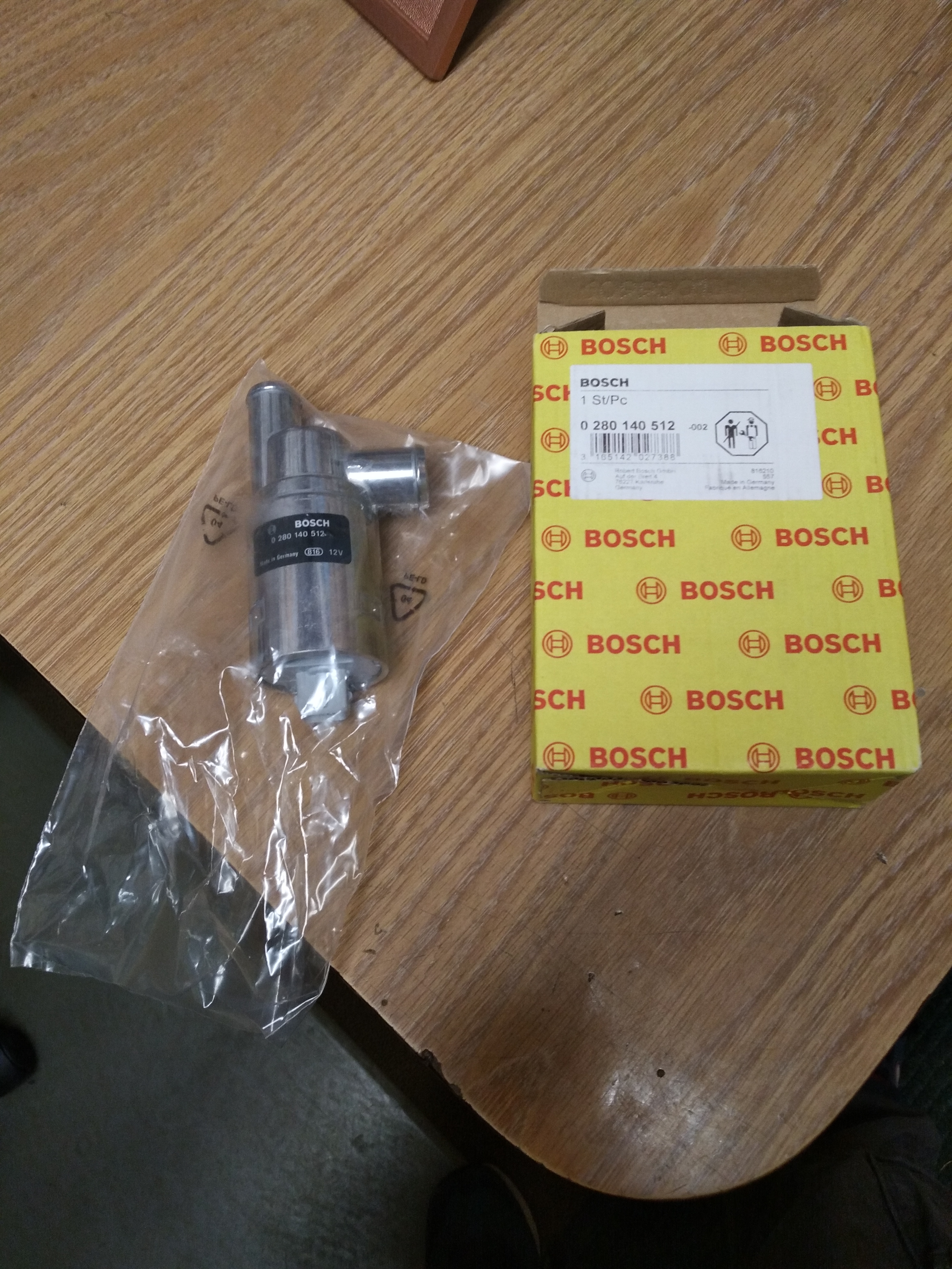

How TF do I keep buying new defective items!? The FAE oil pressure sender was also defective. OEM VDO sender worked as soon as I installed it.
I'm blown away by how healthy the motor runs now. I run the holsets to 30 psi with zero oil in the catch can!
Just this week alone:
One defective IACV from eBay
One defective m1-205 oil filter Frome Autozone (had a rattle internally)
:idunno:
I quit buying non oem stuff a while ago for this reason!

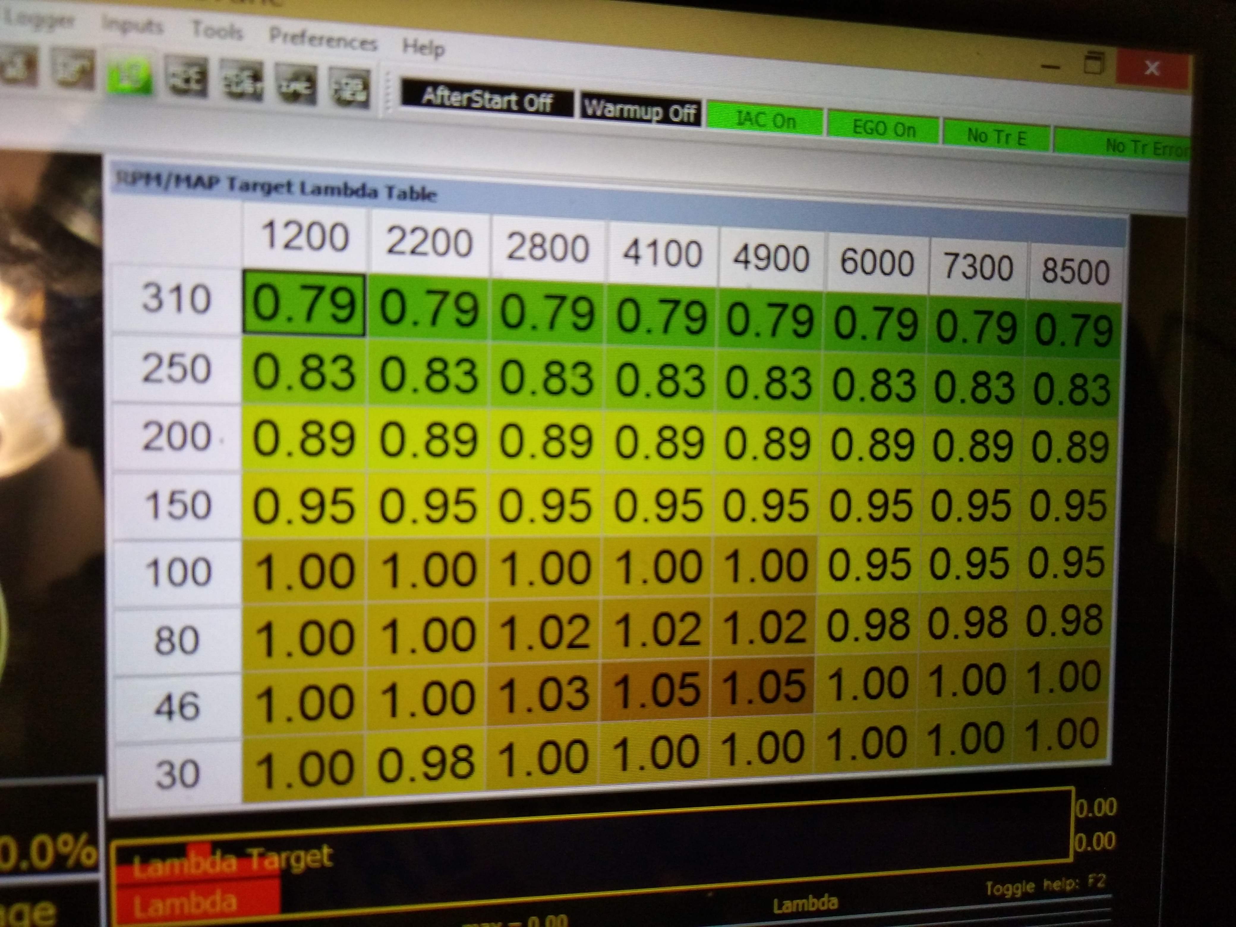

so i went out to do donuts with lots of boost and the resulting log was quite rich overall! tune is excellent during other driving scenarios including boost though . only time it gets "weird" is between shifts. heres the log file. i probably had the heat on which ALWAYS makes lambda off during inconsistent throttle intervals. does this seem reasonable?
winter donuts.vemslog
(66 KiB) Downloaded 1478 times
i disabled all the rich decal settings that were active during the breakdown so break in would be safe
Is this reasonable you guys think? 0.79 lambda at 30 psi seem too rich or good? This is with the new direct port meth injection spraying. Feels very healthy at that afr.
Marc says this all looks good for lambda target. Happy Thanksgiving everyone!
Yeah doesn't look bad to me. Happy Holidays
Thanks man you too :)
