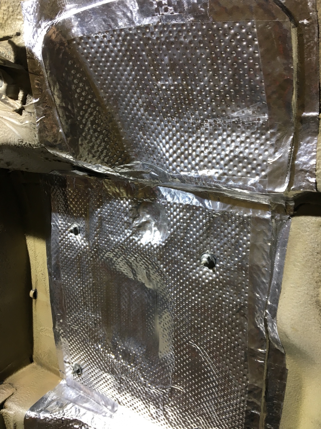

I decided to not put the rear heat shield back on, put heat shield directly on the chassis instead.

Re: eS2 evolution
It's almost like you're intentionally goading me to get cracking on my project. Alberta needs moar 20vt Cq content.
Keep at it. Me likey.
