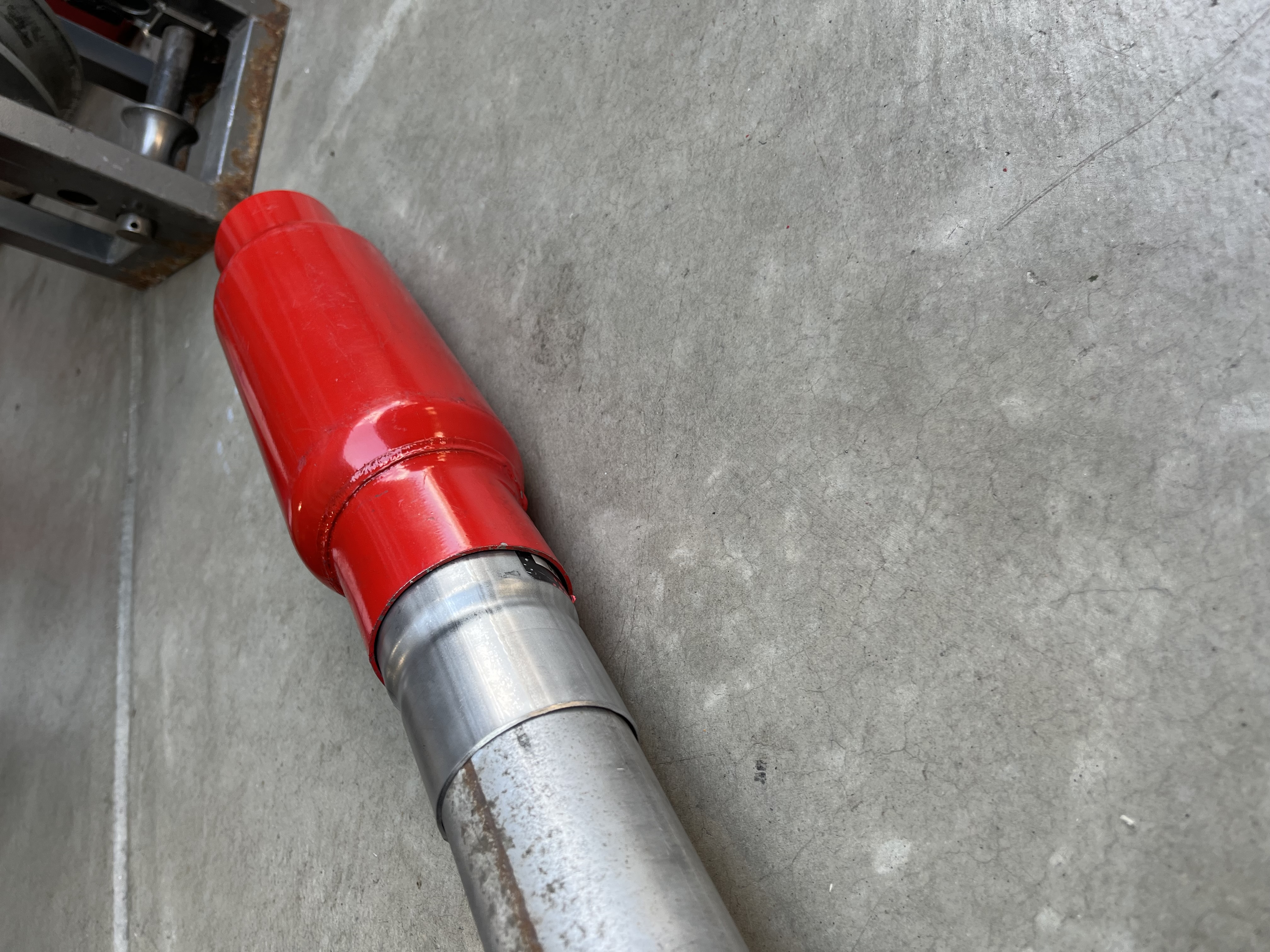

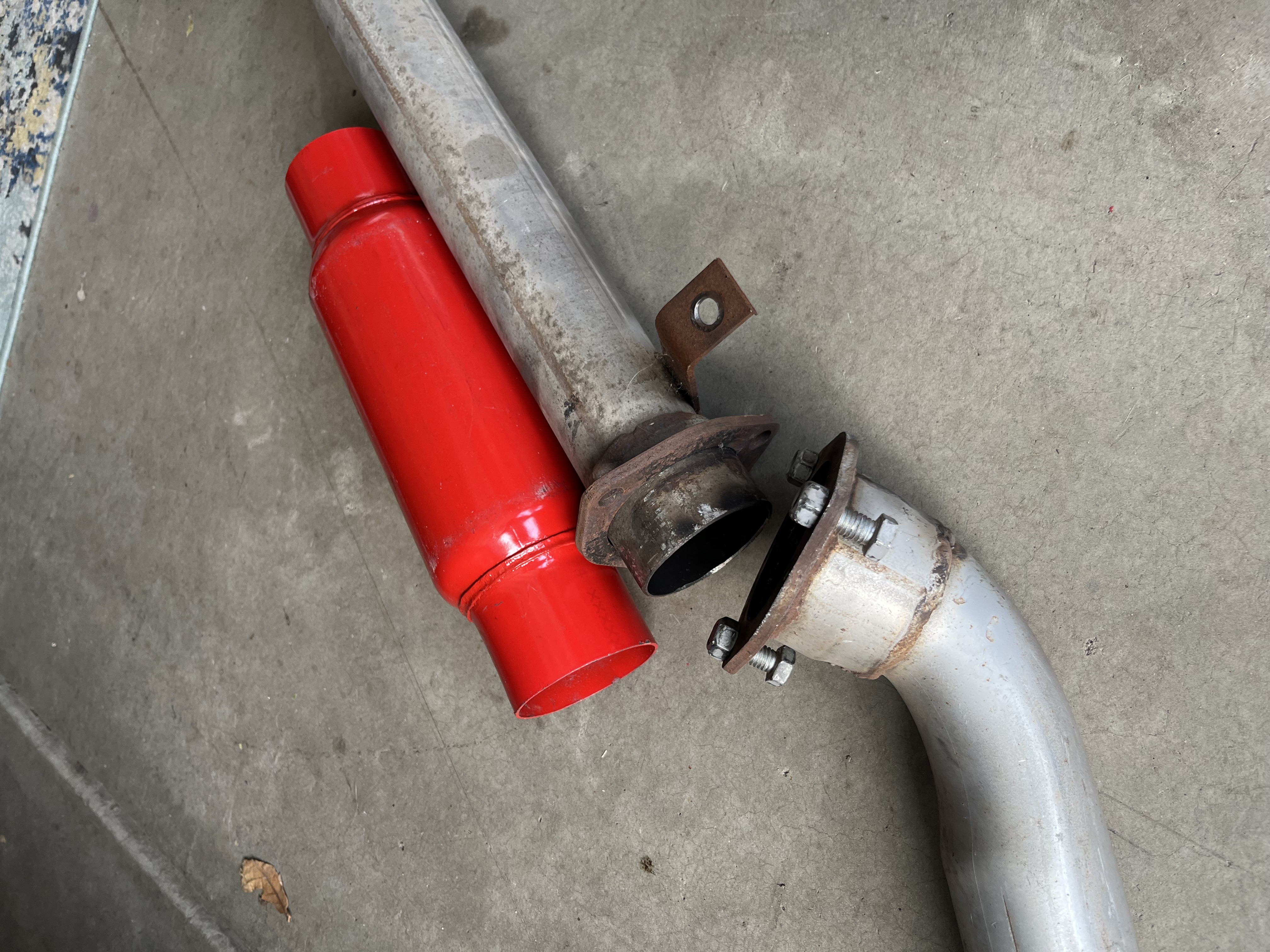

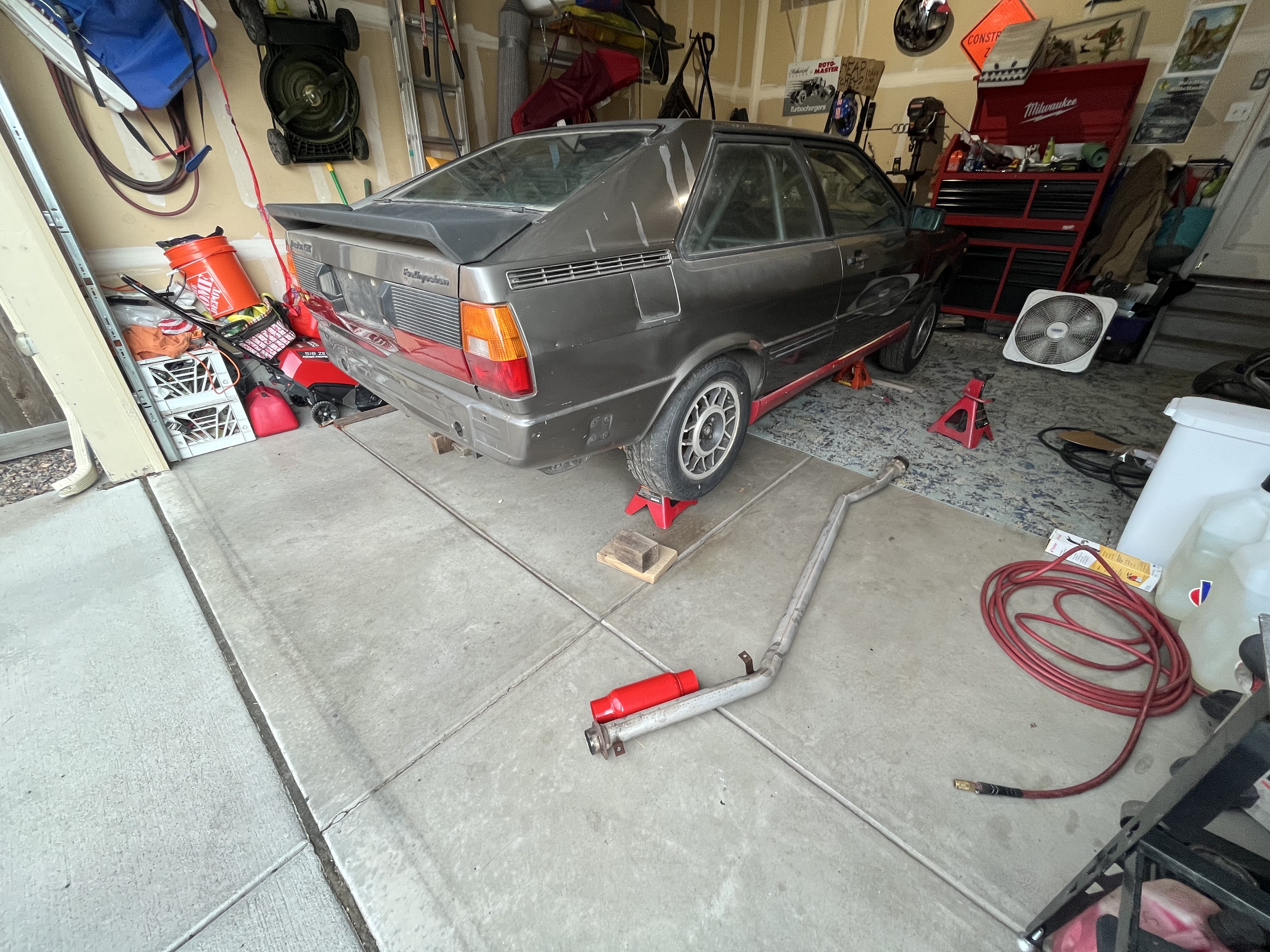

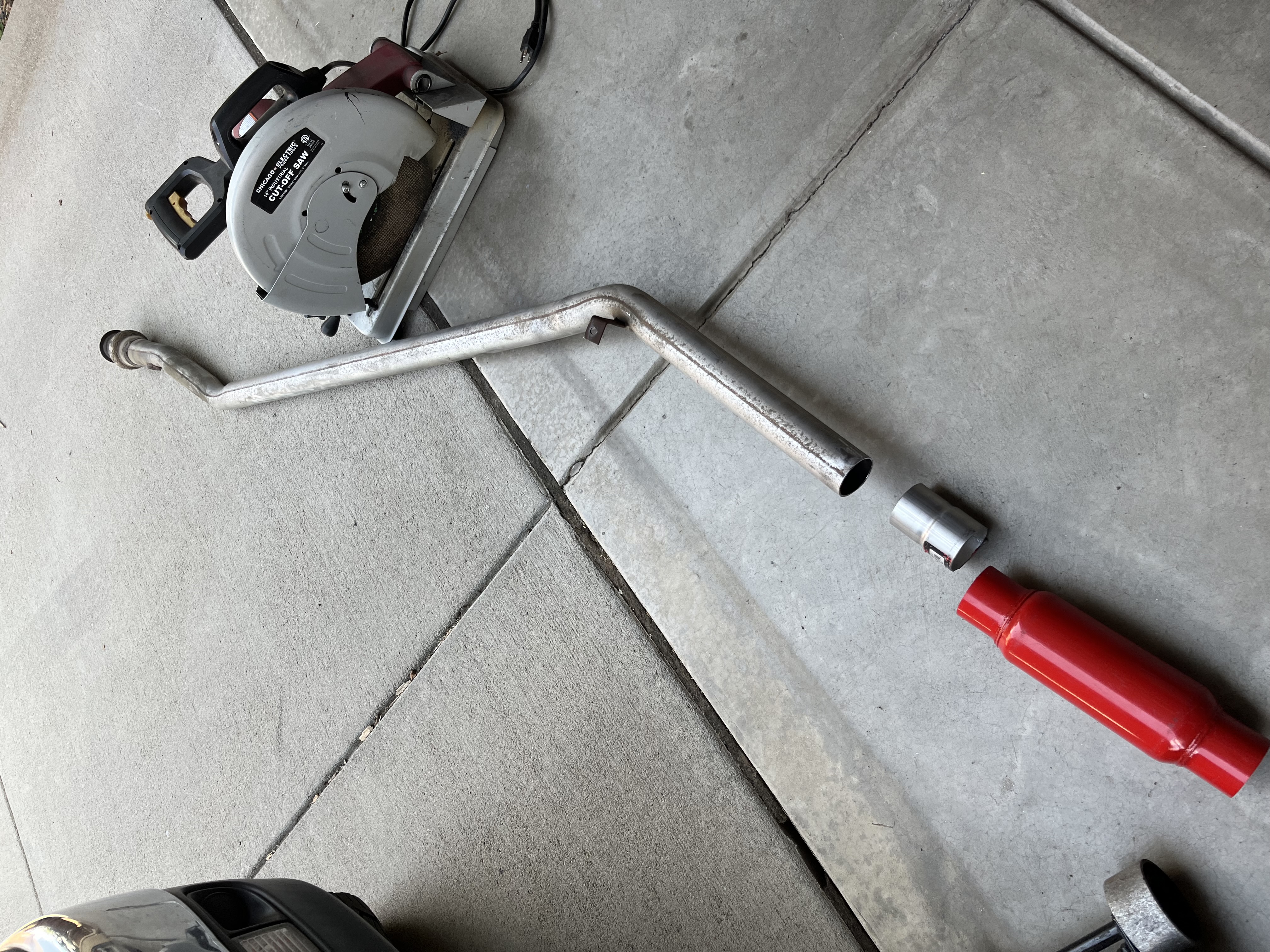

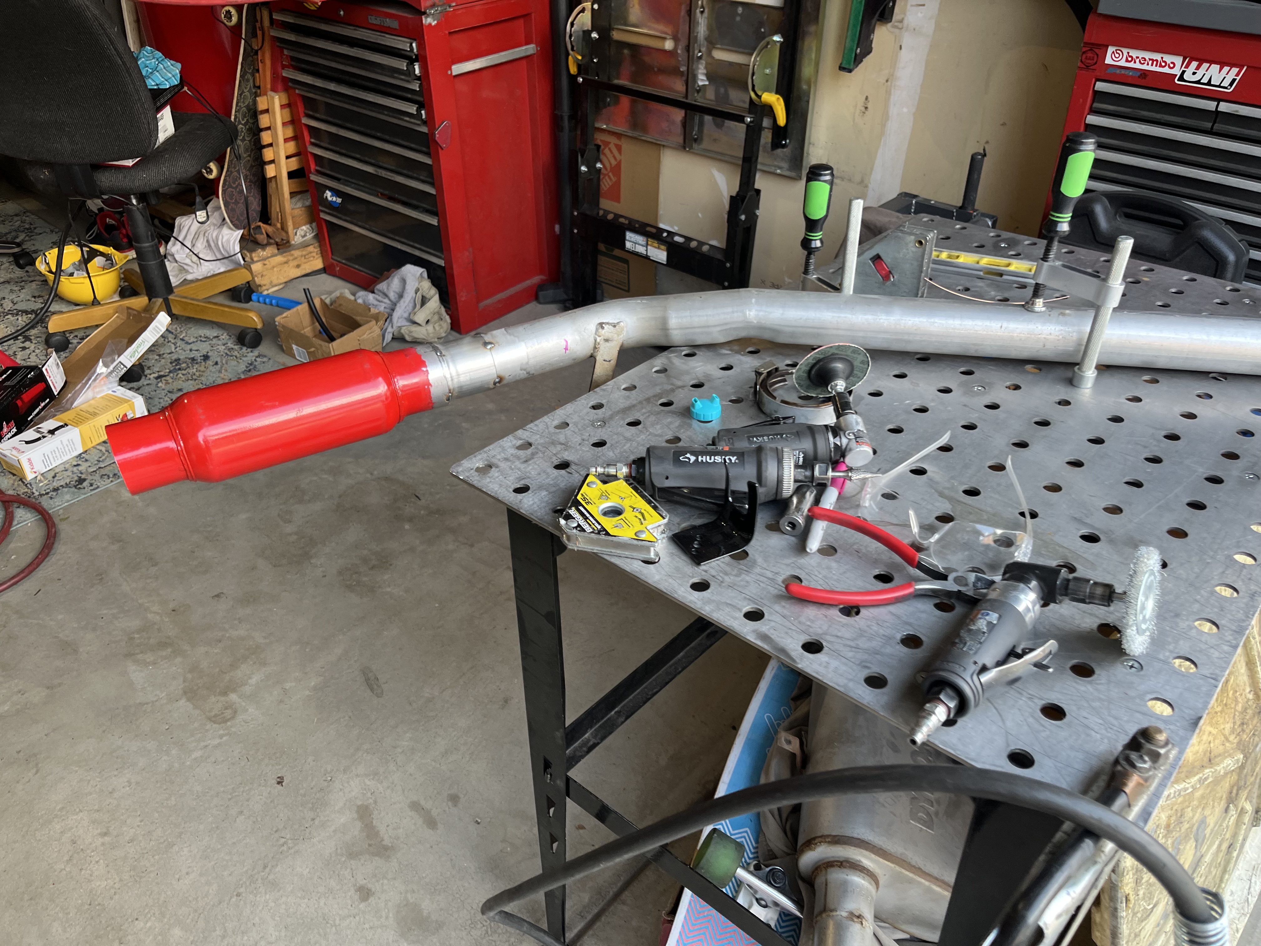

The exhaust set up. It’s just tack welded together. The cherry bomb is kind of loud so we might have to put something different in. We will see. Thanks for looking.

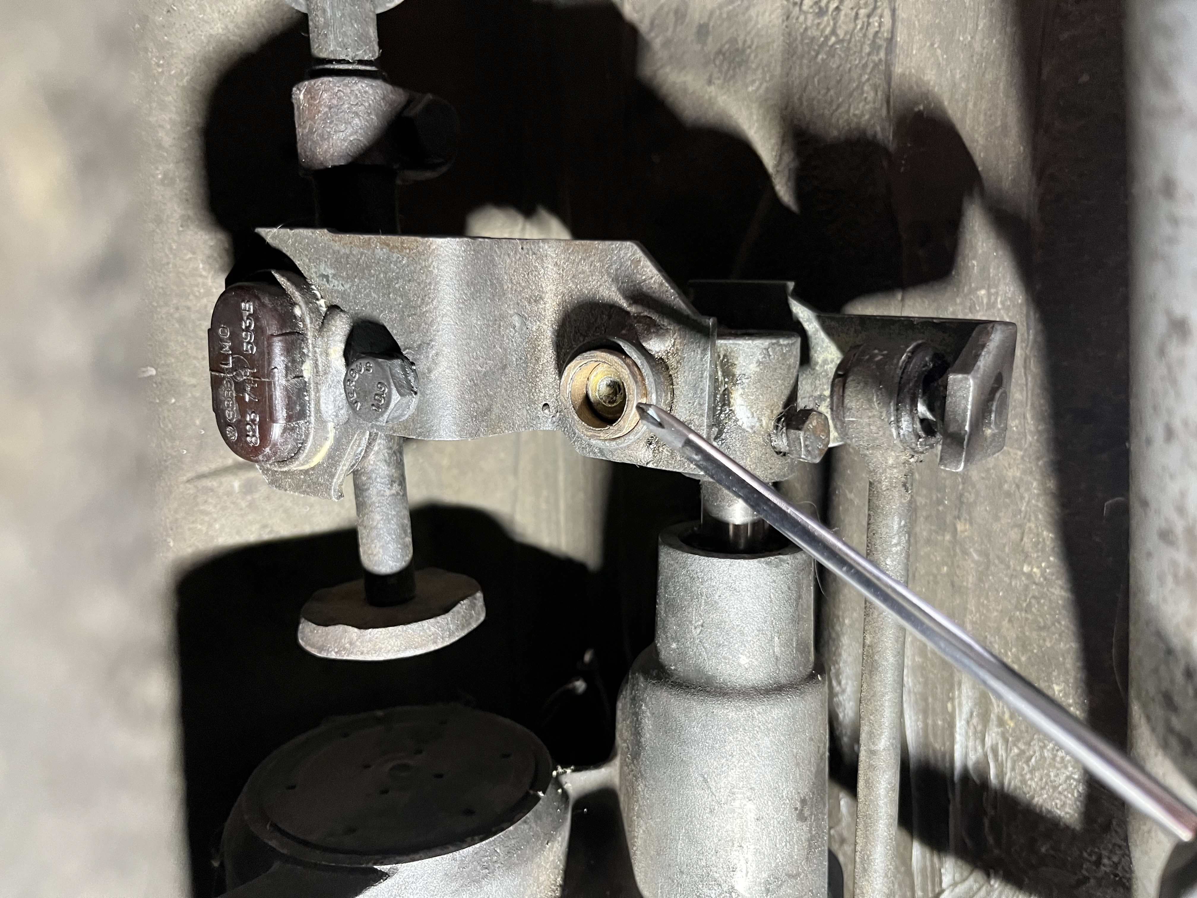

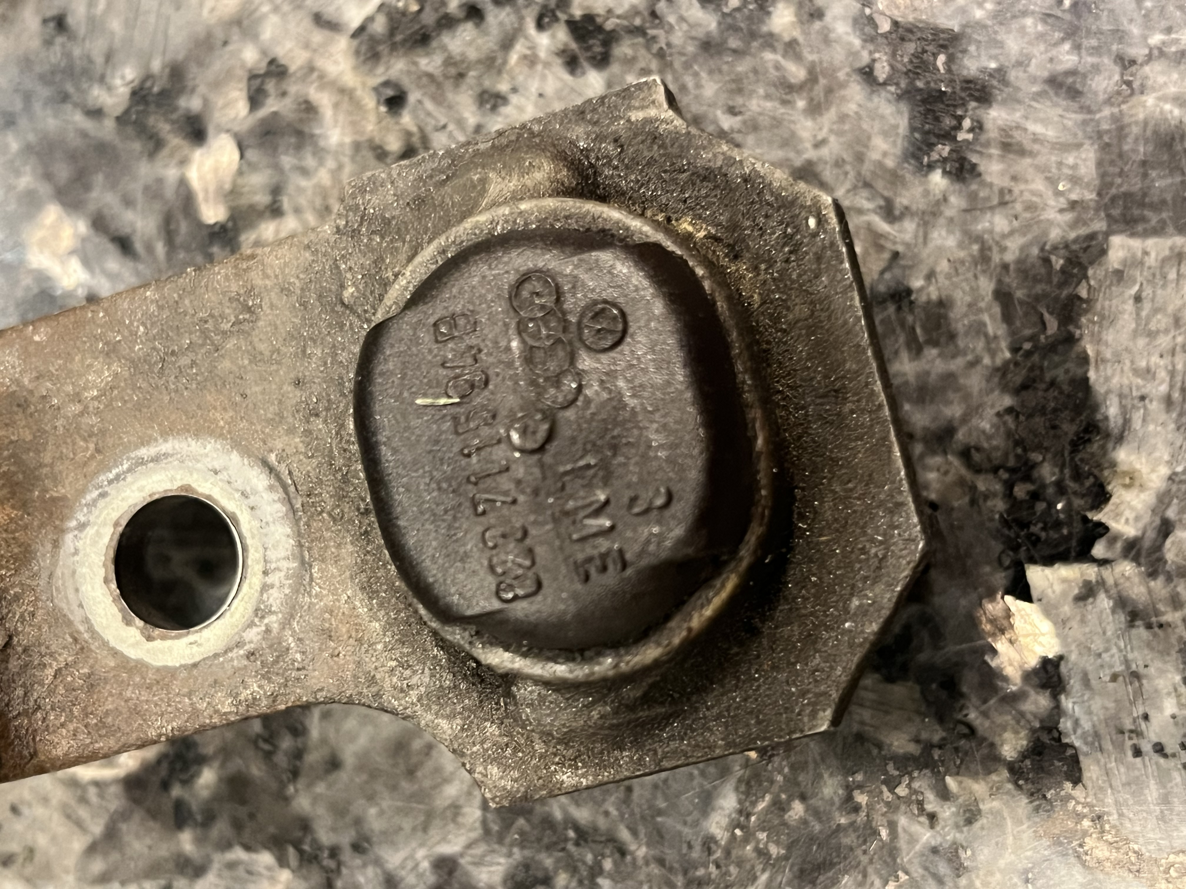

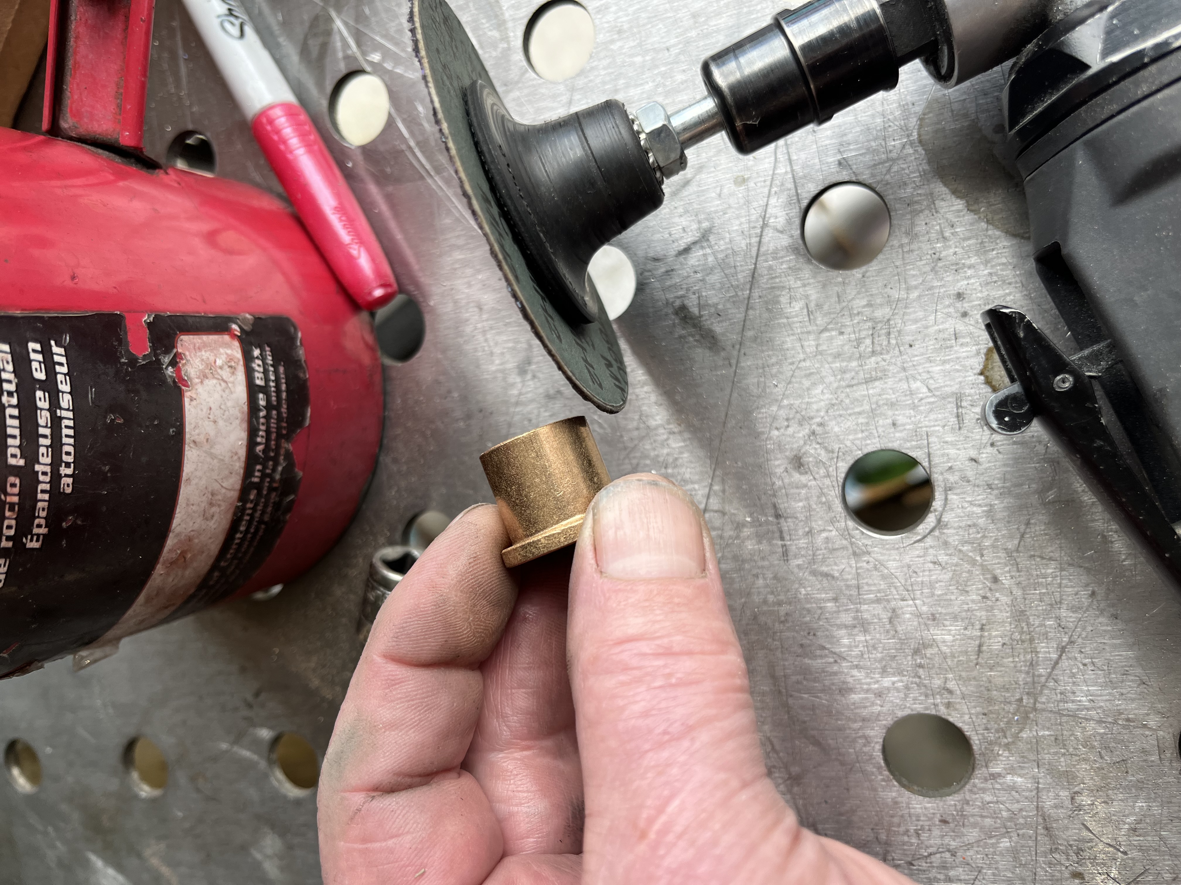

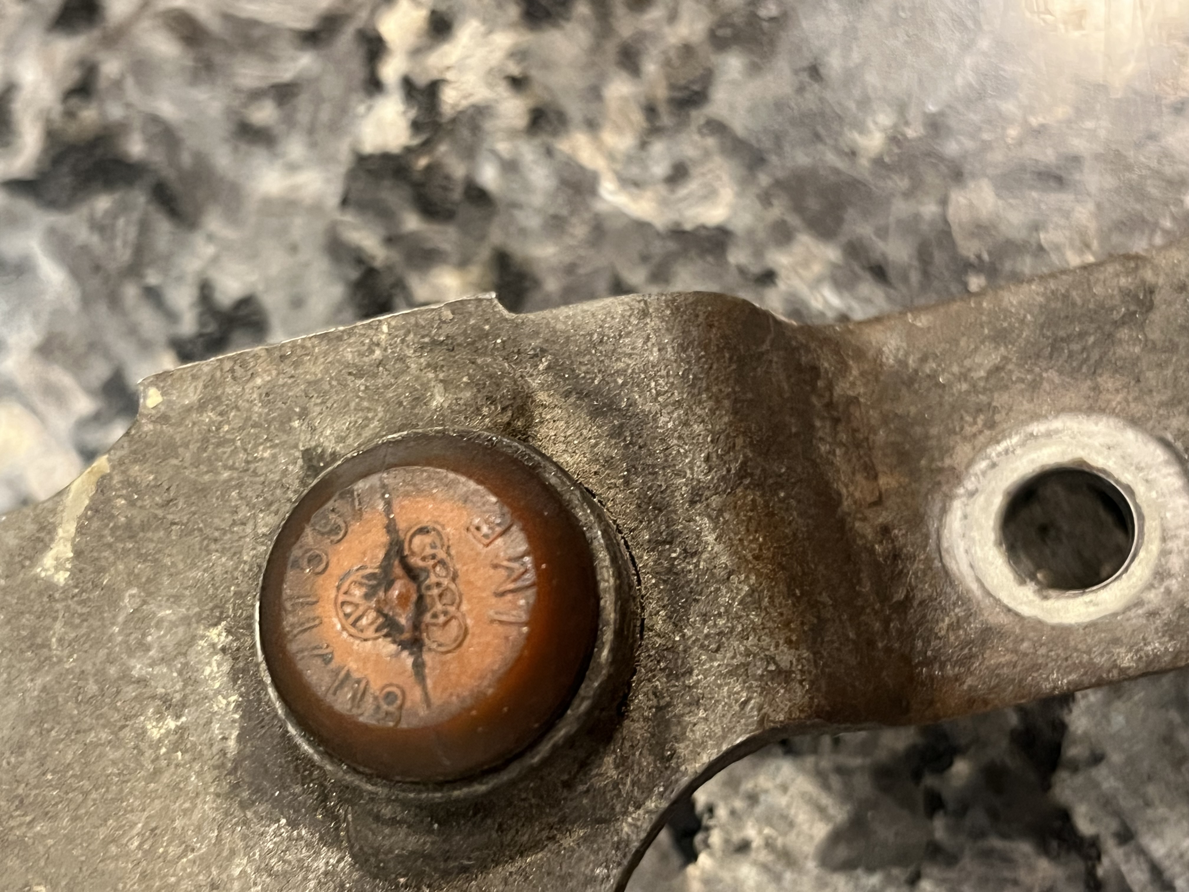

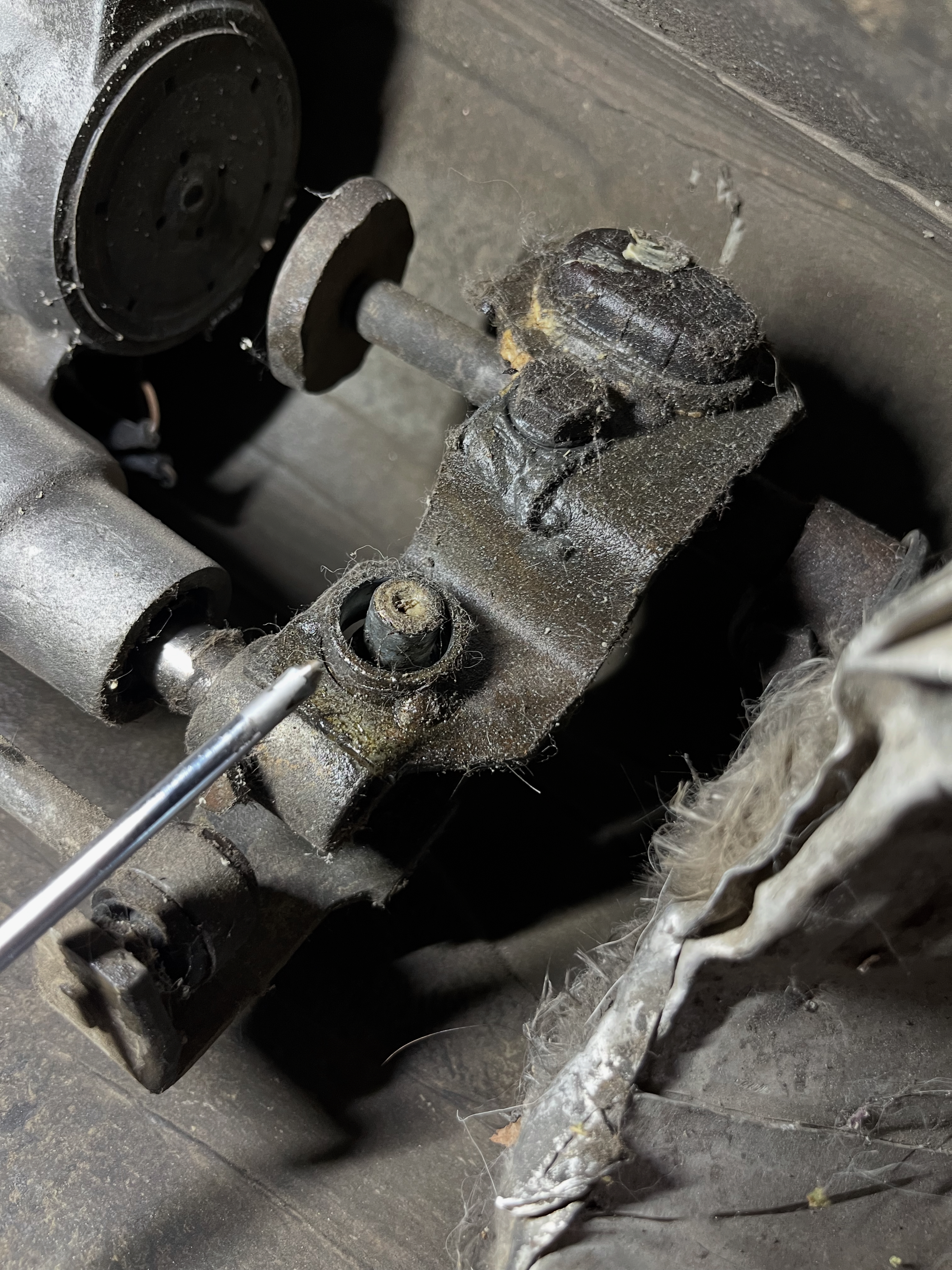

I also had some shift linkage issues to figure out. Some of the parts are unavailable, so I had to improvise with some brass bushings and the precision grinder. The other side is still an OE bushing. Shifts like greased lightning! Thanks for looking.
