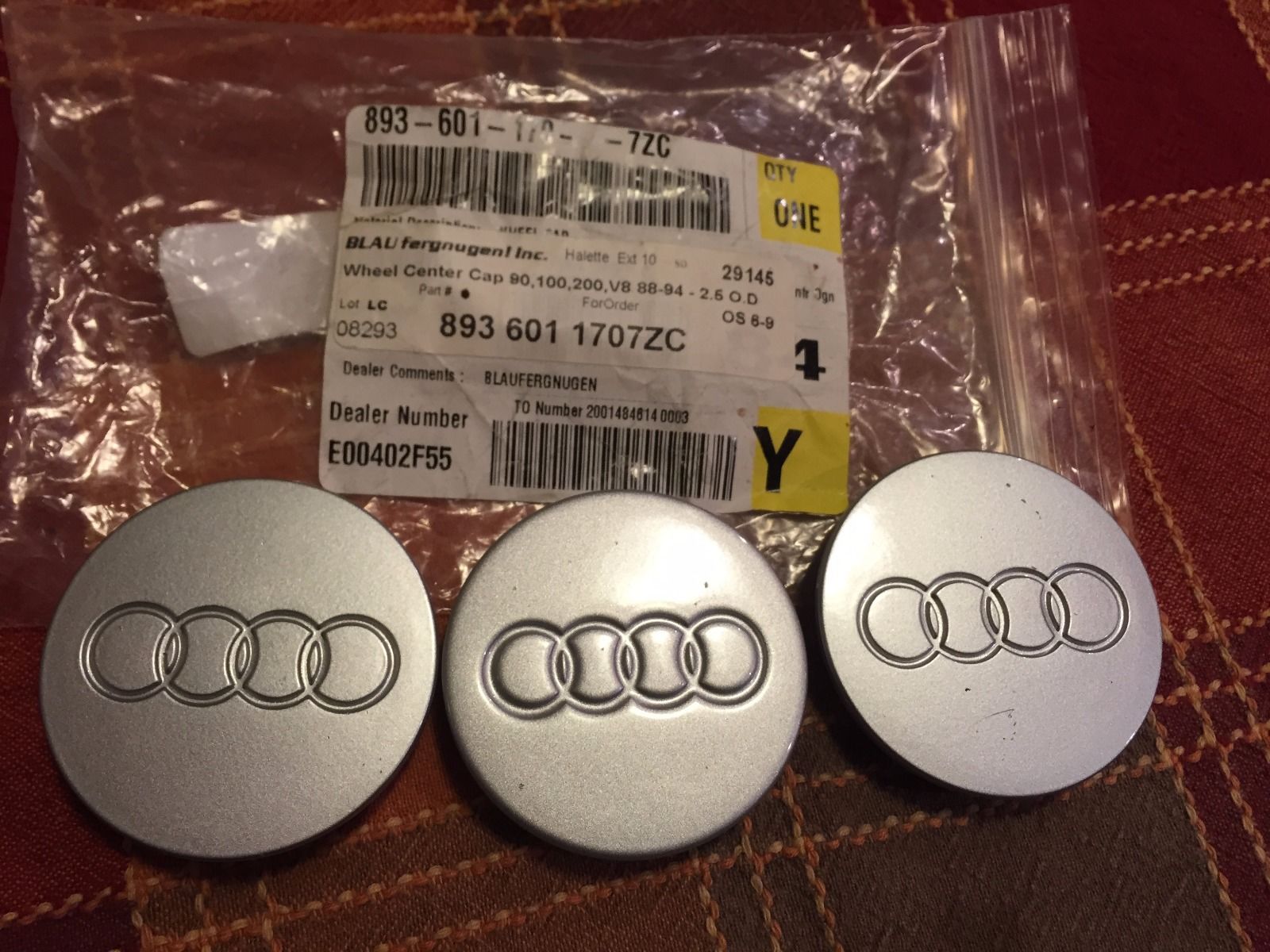

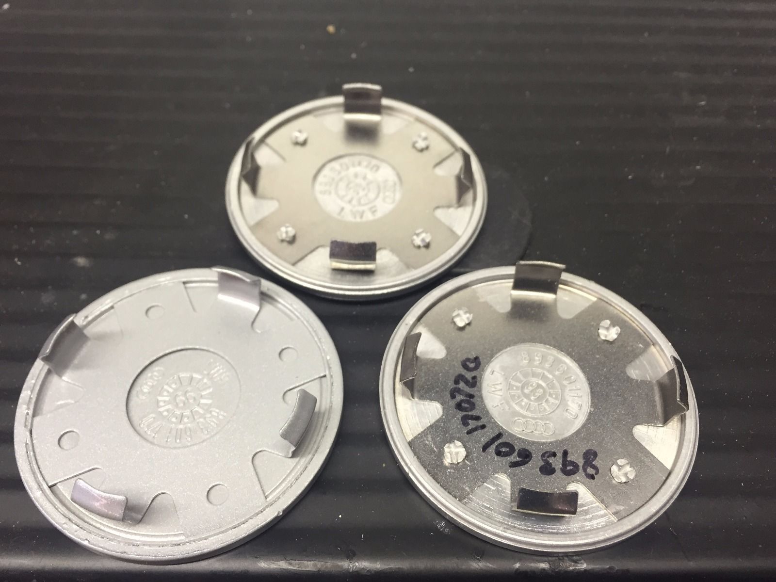

Mcstiff wrote:I measure 63.5. The color is not an exact match but really close.
Thanks Ed! That's about what I expected. Now I have to make a decision. To get caps like these and have them machined for customization purposes or go with resin covered "stickers" for Ronal style plastic center caps.
Something marginally interesting, but definitely a concern for me if I go the machined metal cap route is that there seem to be some slight differences between these little caps over the years. Likely due to manufacturing efficiency changes. Check it out... one is not like the others, and none are quite like yours!
CENTER CAPS.JPG (264.12 KiB) Viewed 30942 times
CENTER CAPS 2.JPG (180.78 KiB) Viewed 30942 times
The differences are slight, but they will bother me! I like the smooth edges of the middle one (and yours), but if I have something engraved into it, the tool will leave a more square edge around the lettering like in the two caps to either side. Bah! So stupid lol

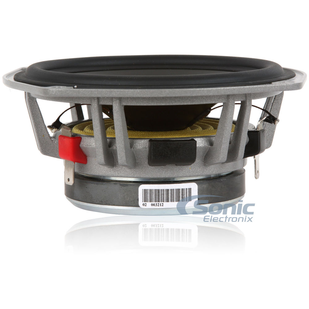

Next was the speaker installation. I wanted at least a little midbass to hold me over until I do the front doors (if ever). I decided against the Focal Utopia 13ws because they need a sealed enclosure, and I didn't want to get into that just yet. Maybe I'll change my mind and try it later, but for now I decided on using some JL Audio C5-525cw woofers for rear midbass. Here are some pictures of them before installation. They are definitely nice and Made in Germany as a bonus!
Compared to the stock speakers... look at the difference in magnet size!
They drop right into the doors easily. There is practically a cavern back there. The focals would definitely fit right in there, but again, custom boxes would have to be made. Maybe later!
