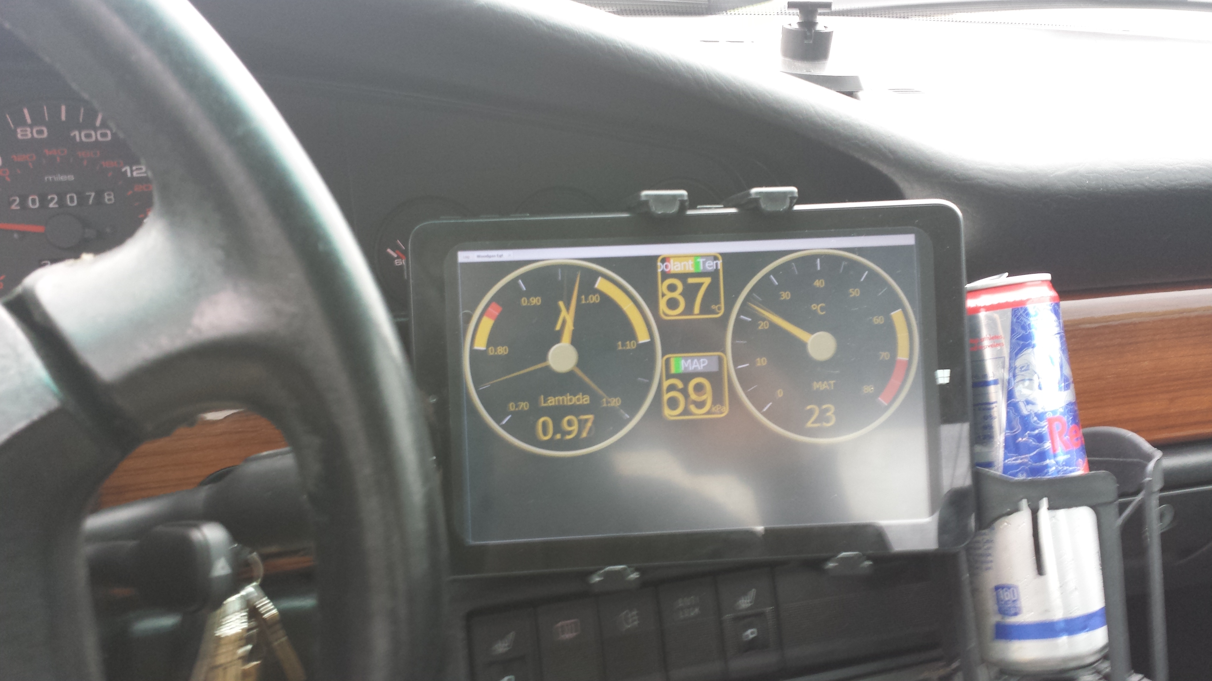

In comes the insignia (bestbuy I'm told?) Windows 8.1 tablet with bluetooth I got new locally without the box for $40 off the retail price. So awesome, this thing! It connects to the BT dongle really well so I can log/tune all on the same interface. I made a gauge face that resembles my 4 most important gauges from VEMSdisplay. I even tried bluetacks android emulator to get back that app I miss already :( It took some coaxing to even get bluetacks to work on a 1 gb ram OS but I only knew what to google so I didn't hack any of it myself lol.
Well I got VEMSdisplay to start and all but it sticks at the point of asking my "phone" to turn on bluetooth. It was all a bust. I hears interesting things about apps interfacing perfectly using the emulator but this sucked.

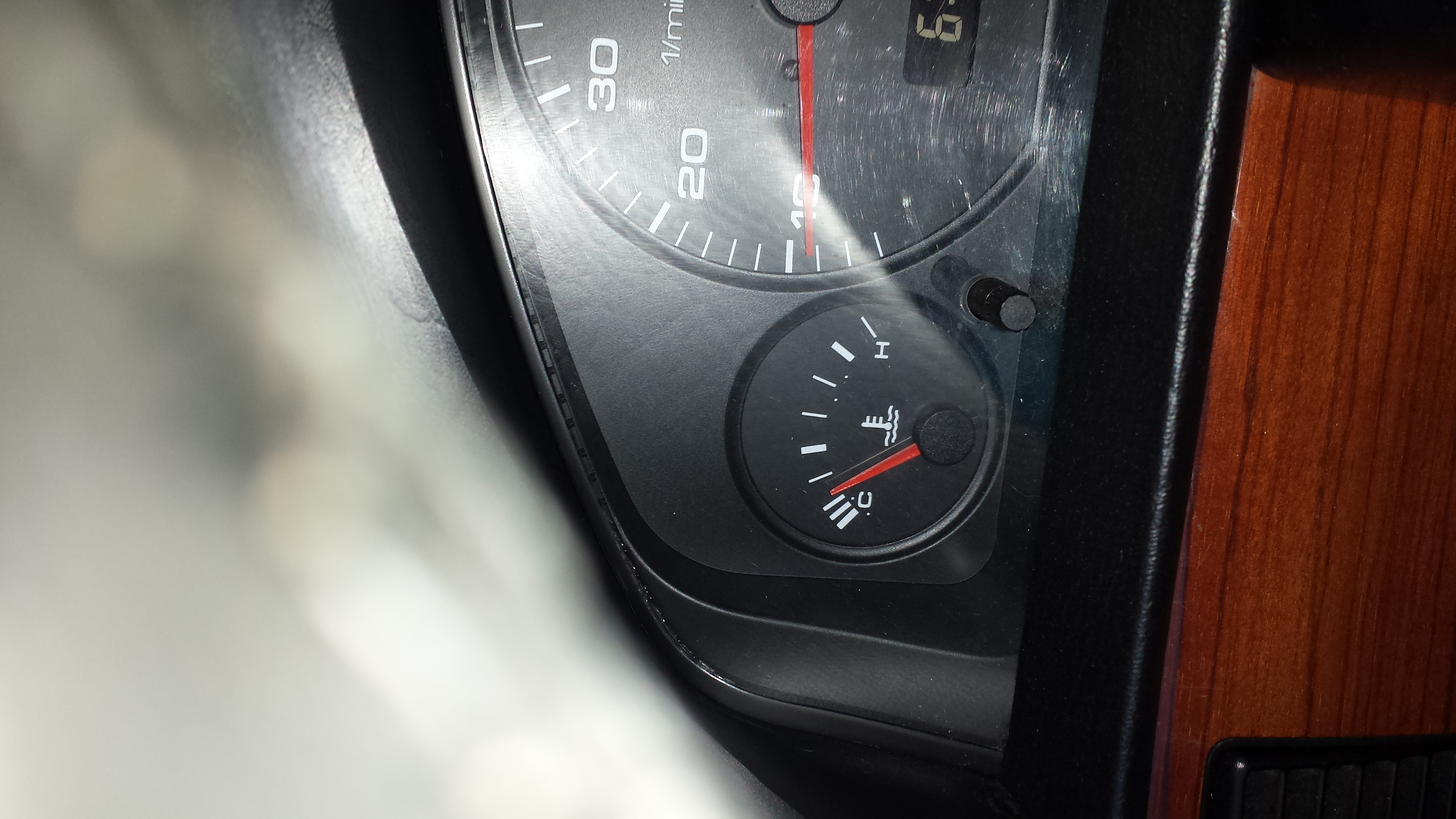

Below is the strange over-cooling I get sometimes after cruising for awhile in weather colder than 60F. That's the lowest it's gone. I haven't checked if that brings it back into warmup enrichment or not. I don't think the t-Stat is bad since this only happens sometimes. Also the radiator stopped leaking

When your dash gauge goes that low, what does your VEMS gauge show? My 80 apparent has the wrong MFTS, and I always show low temperatures in the dash, but the gauge on tunerstudio shows the true story.
I think you're onto something there but it's the oem mfts. The vems gauge said 89C when that happened I think. At the time I just figured that it took the temperature from a different spot like the water manifold or something
I think you're saying I should buy a new (and oem-correct!) Mfts just to be sure since it's so old already lol.

When I used to drive my 200 in winter, the temp gauge would be even lower. Never affected how the car drove or how well my heat worked. I had a 100 fwd 5cyl that was the same way too. I didn't ever check to see what the actual temp was while running at that spot on the temp gauge.
Nice thabks for the reassurance.

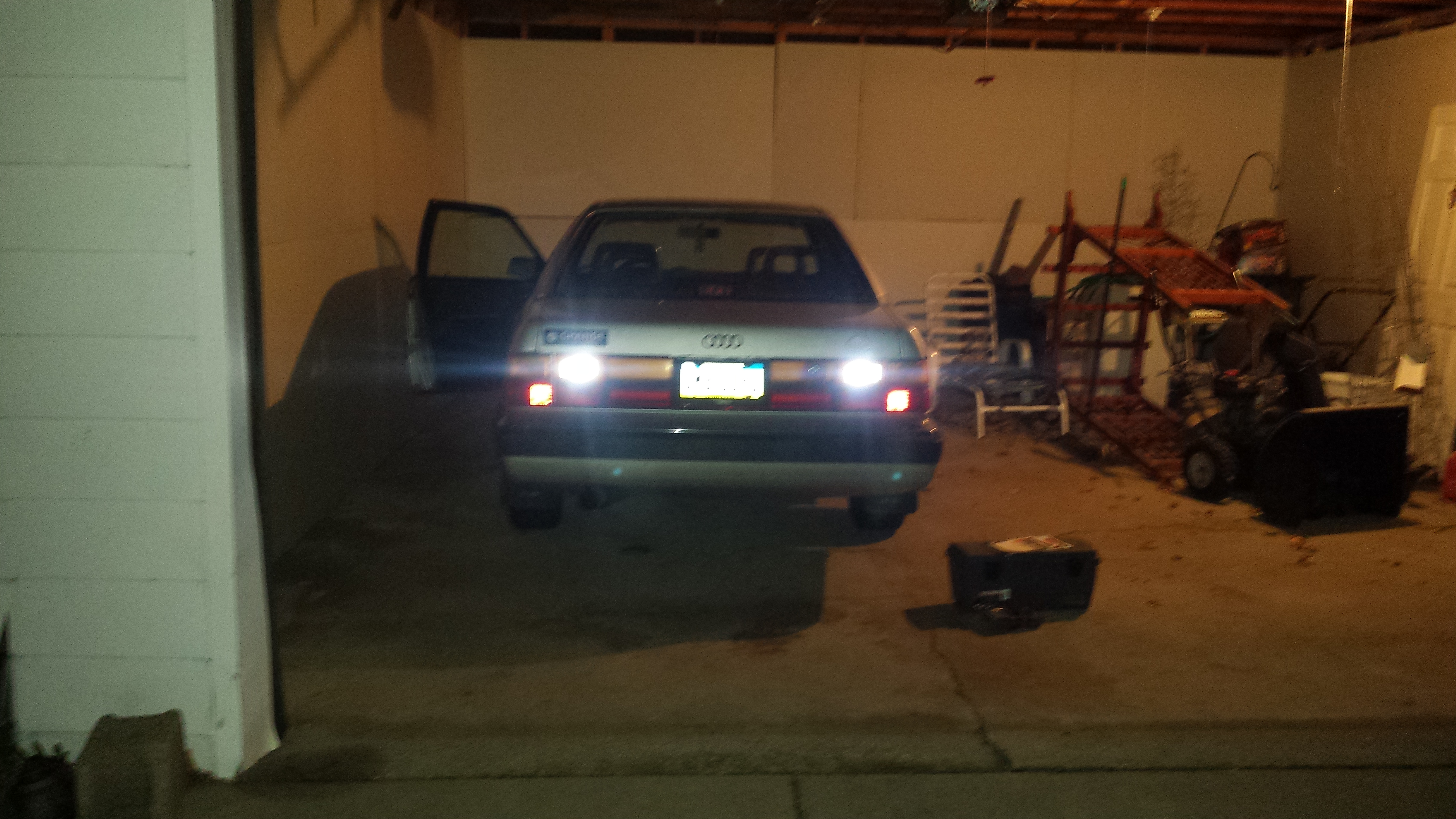

My LED reverse bulbs REALLY worked out well

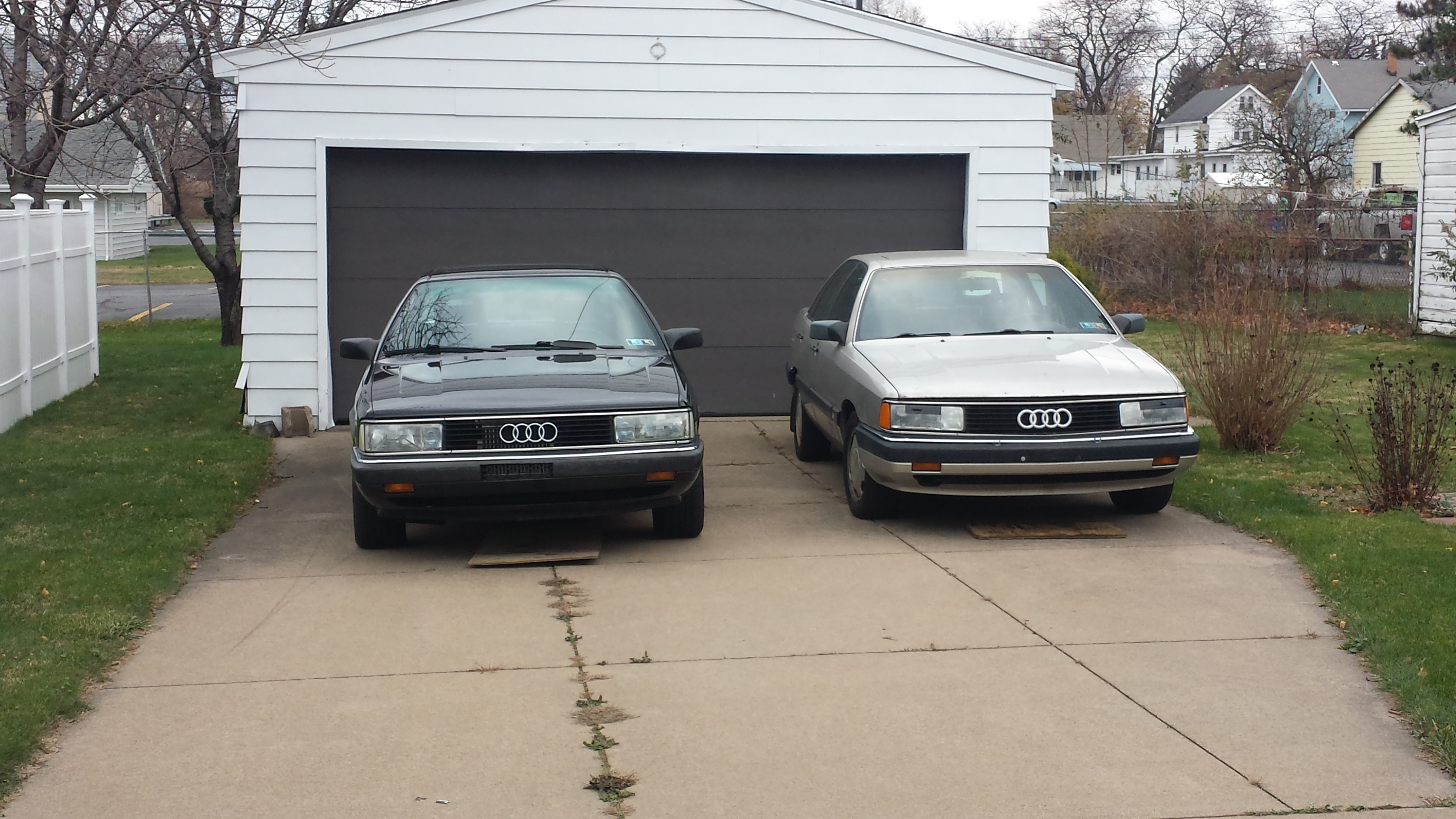

Thanks for your sentiments on working on Thanksgiving, but I'm good man! I am thankful to have a good job
By the way, your cars look great in that picture, especially the 20v! I always wished I could find one in Black or another dark color. My avant is close enough to dark I guess lol.

Thanks for the kind words
somebody saw me at the gas station and said the 20v was the sexy one and asked why I even drive the 5k. I've been through alot with the 5k and it's sentimental. It's not about "looks" for me hah. With the 200, it's the total package for me. Great car and great colors..
