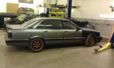

Re: Josh's 2.5 200QT
Post by 2.5TYPE44 »
spoiler 2.jpg (20.9 KiB) Viewed 46205 times
amd is the best
Post by amd is the best »
Just so you know, mine is straight from eBay and cost me like $25. It's a universal "M3" style lip that is 50.5" in length.
Post by 2.5TYPE44 »
I like it! Very clean look.
