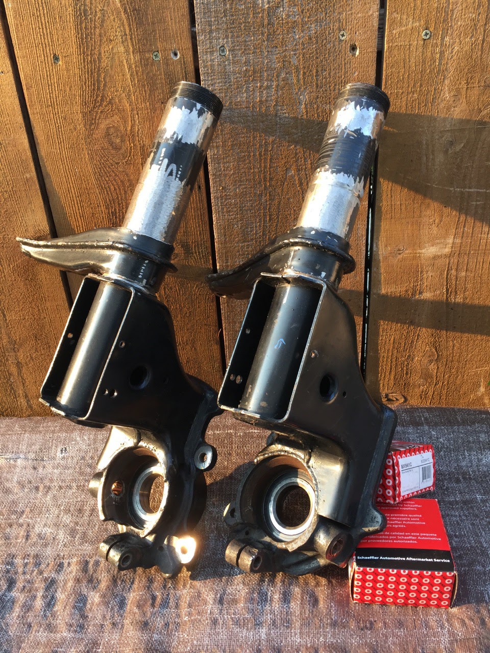

First thing's first. We will need to cut off the factory spring perch.
Get a grinder, a grinding wheel, and go to town on the weld. Be careful to not go deep and actually cut into the strut tube as that's not easily fixable.
Once the weld is mostly ground through, you may be able to smack the spring perch with a hammer and break it off the rest of the way. Once it's broken off you can get to the weld a little easier and get it completely gone.
You can cleanup the last of it with a sanding flapdisk to get it nice and smooth.
Once the spring perch is off you can then attach your coilover sleeve perch.
There are two different ways to do this.
The tried and true method is cutting out a ring and welding it onto the strut tube.
The method I've used for this first guide is using what I've seen called a clamping collar.
It's just a 2 piece ring that is clamped down to tubes.
They look like this.
Here is the one I used for the front struts. They are different sizes on the front and rear so pay attention to the sizes you are getting. They need to be as close to the size of the strut tube as possible for a snug fit.
https://www.amazon.com/gp/product/B002E ... UTF8&psc=1
When you have that clamp on there you can then work on sliding the coilover sleeve onto the housing.
The coil sleeve itself will be too long to fit in between the shock nut and the sleeve perch if you're running your steering arms at the stock length (we'll go into lowering the steering arms later on.)
I was actually able to just cut the sleeve in half and use one half on one strut housing and the other half on the other strut housing. This leaves a little gap in between the shock nut and the perch but I was okay with that for now. If you want to cut costs this will allow you to only purchase one sleeve for the front's if you'd like. If you want the sleeve to run all the way up to the shock nut, order two and cut them as close as possible to exact length from the perch to the shock nut.
The next step is to assemble it all together. Put the gold spring perch onto the sleeve, slide the sleeve onto the strut tube, put the needle bearing onto the spring perch, slide on your bump-stop if you have leftover OEM ones or if you purchased new ones, slide the spring on, put the spring coupler onto the spring, slide the take-up spring onto that, put the top gold spring perch onto the take-up spring, put the factory mount onto that perch, and then bolt it together. it will look like this once you have it all complete. I will add pictures of each step in the future.
