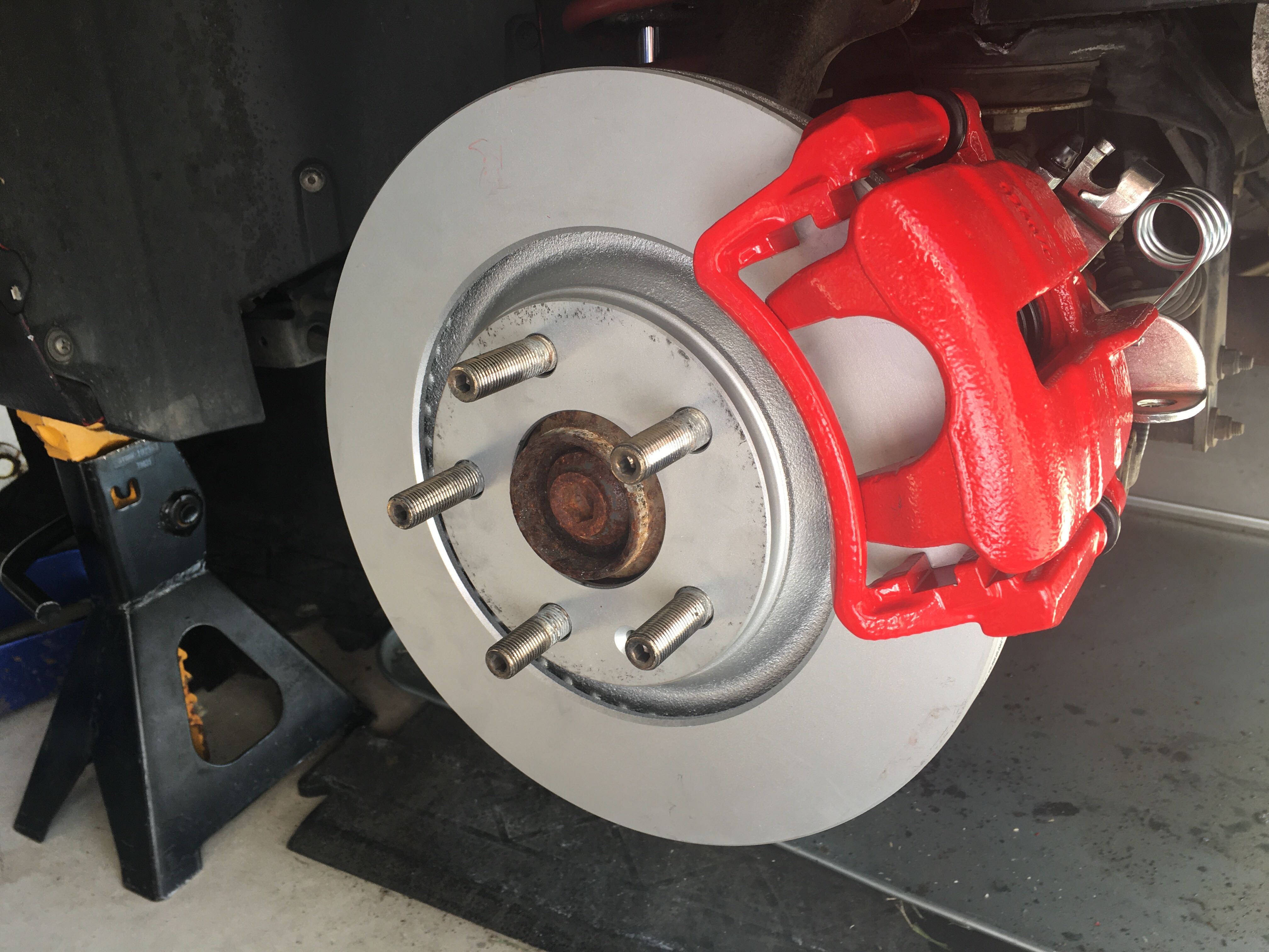

Here is a shot of the B5 rear, the issue is my S2 Sedan hub rotor mounting surface is closer to the caliper carrier than the B5. Given my experience with custom brackets, I'm leaning toward a no adapter solution and reselling the apikol kit. I already have the B6/7 rotors and the ECS rotors I have are close to end of life.
I did think about bolting the carrier to the inside of the adapter but I'd need to tap the adapter and that is the rough side of the the carrier. Might be too much offset anyway. KISS.
Re: 1PissedOff90
Finally ended up buying Powerstop B6 calipers, looks very good to me (we'll see how the finish holds up). Just need lines (the B6 is a larger banjo) and pads.
