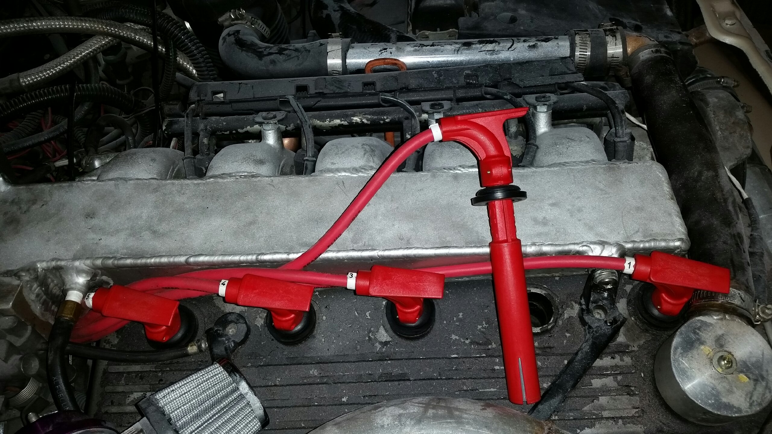

msd hemi wire kit plus five autozone 5/8" pcv grommets for dust covers. :drive:

pkw wrote:msd hemi wire kit plus five autozone 5/8" pcv grommets for dust covers. :drive:
Awesome thread, nice work all around.
Any specific information on this? Ie, part number haha!
pkw
Posts: 277
Joined: Sun Mar 23, 2014 10:05 pm
Re: MSD universal hemi wires....nice red ones
Post by pkw »
msd #31539
autozone pcv grommet #42066 to use as a dust cap x 5
summit racing's pic is incorrect but it gives you an idea.
wires come with hei ends and they worked fine for my 034 dis coils
http://theprojectpad.com/viewtopic.php?f=11&t=1534

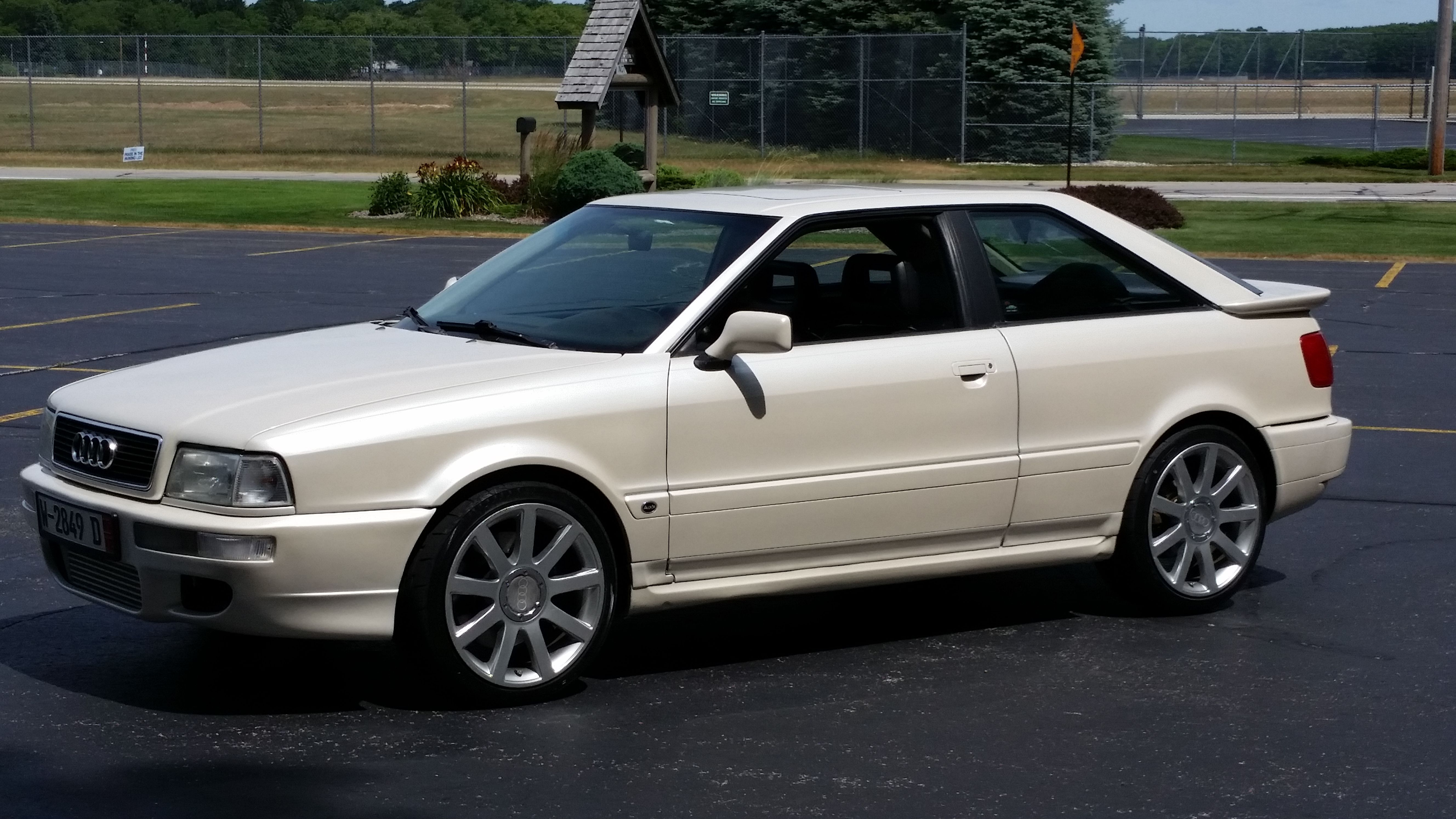

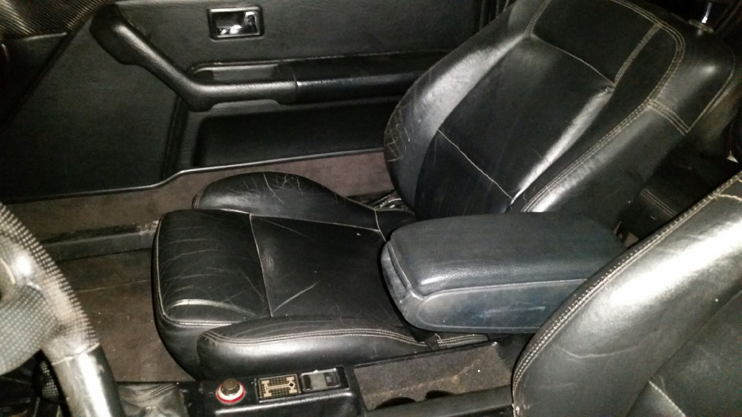

Installed an armrest today because I love to lean my right arm on something during long drives. Works well.
