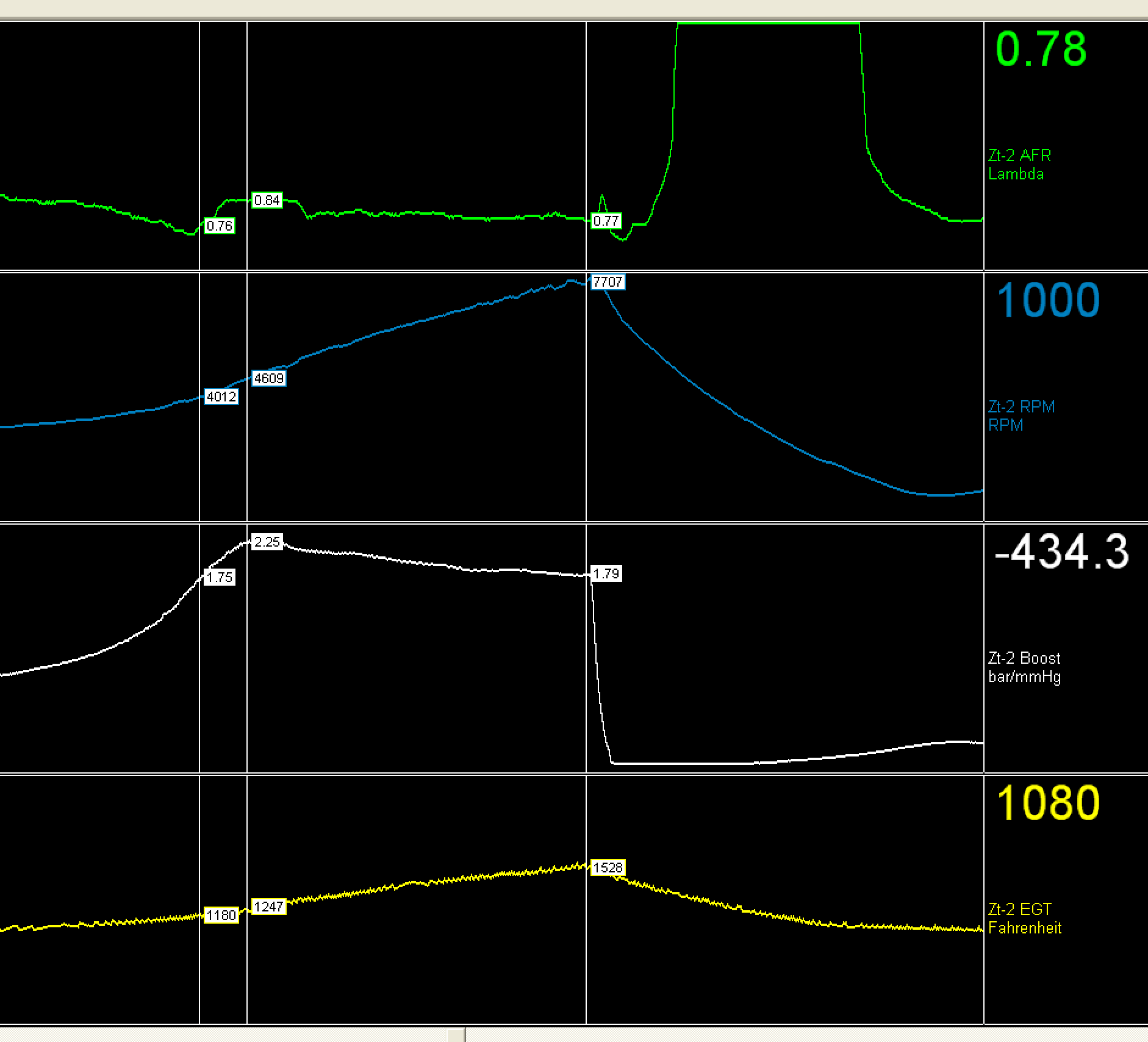

Can you provide any logs or data for boost profiles in 3rd or 4th gear, Jim?
Interested to see when your car starts to come alive.
- Posts: 2144
Re: Best 550whp 07K turbo?
I run a quick spool valve and t4 divided housing. It spoils fast. In 6th gear it will make 1bar by 3300 rpms. 3rd gear is around 4300 for full boostversacehobo wrote:Can you provide any logs or data for boost profiles in 3rd or 4th gear, Jim?
How many kPa is full boost?
- Posts: 2144
2.2 bar on 07k cams
1.85 bar on ttrs cams
Here is a 3rd gear dyno pull on the stock 07k cams and valves.
