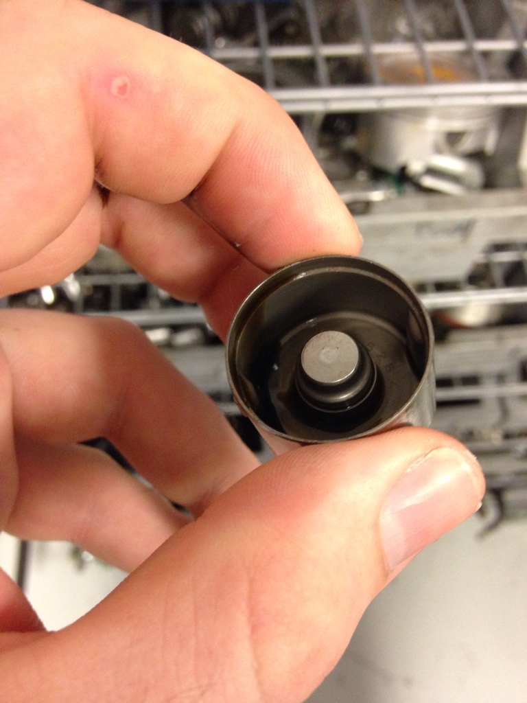

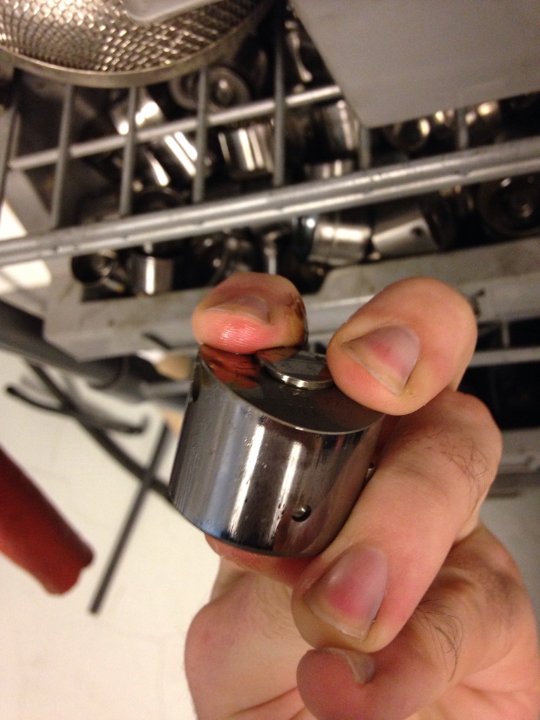

One other lifter option might be Porsche 997 GT3 exhaust valve lifters. They are built like a solid lifter bucket, but where the peg and lash cap go is a little version of the hydraulic lash adjuster you usually find in these lifter. We have a whole bin of them at work, I'll try and get some dimensions if I can this week.

Damn, my bad, the small lightweight guys are on the intake side. They're smaller outside diameter than the exhaust lifters, which I believe are the same size as the old vag stuff.
