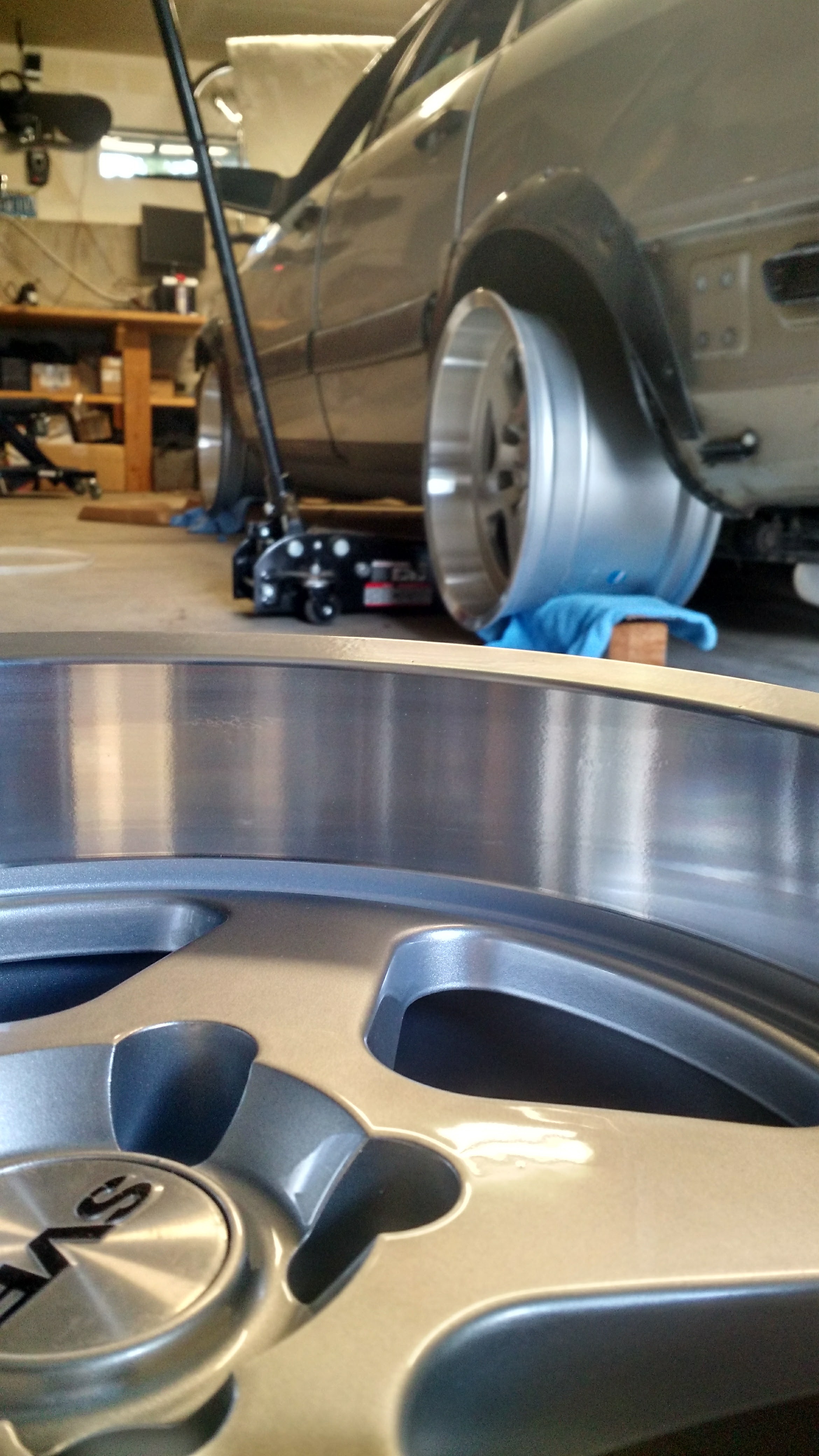

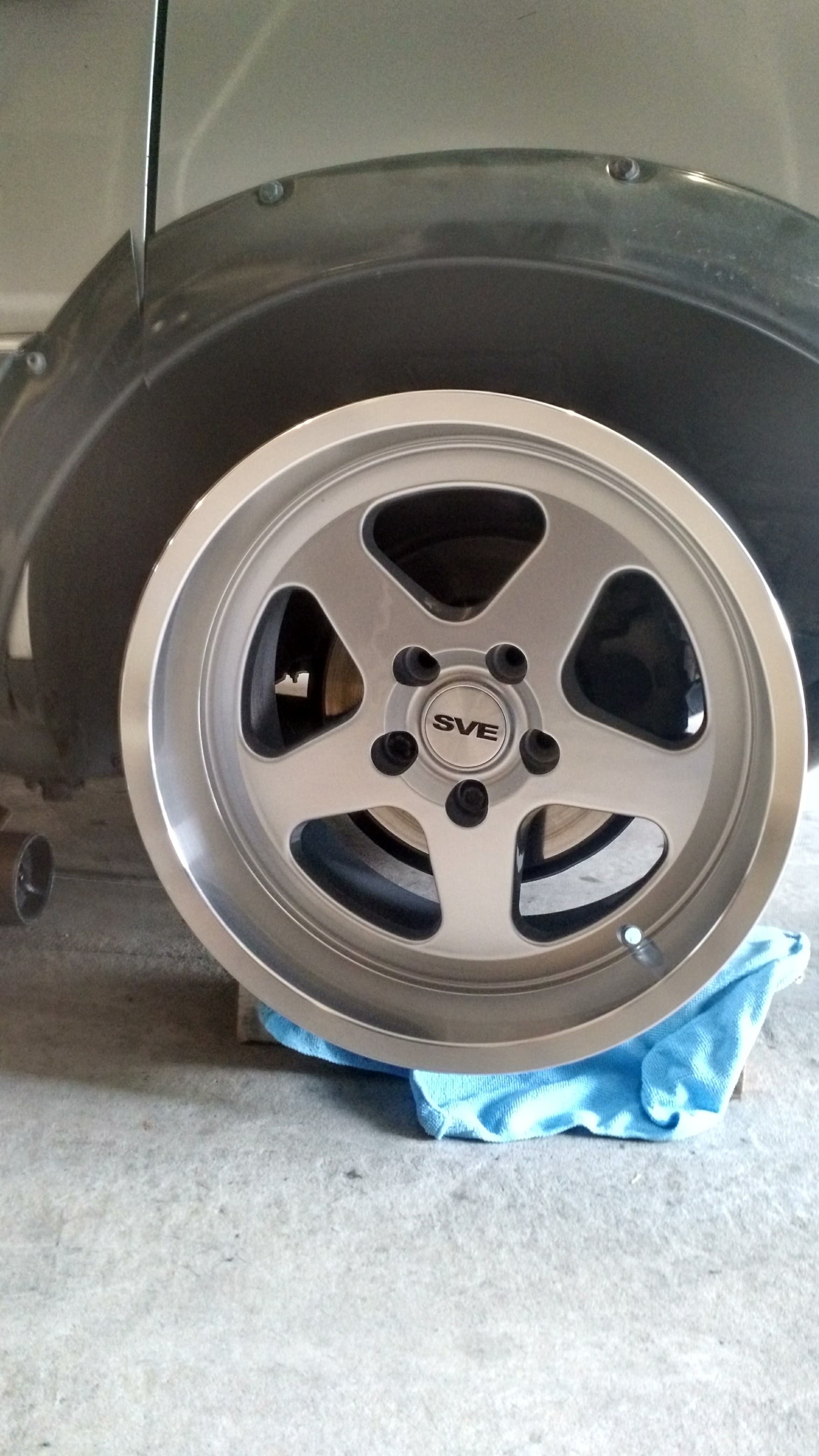

StanceNation Son.
- IMG_20170413_181525.jpg (973.1 KiB) Viewed 57711 times
- IMG_20170413_181551.jpg (1.08 MiB) Viewed 57711 times
Re: Phil's 20vt 5ktq, "TurdQuat" EFR7163
I wanted to run these x10's so badly... settled on 9's since I didn't have the fender, but I'm REALLY pumped to see this on yours!

Love the look of the car and the new wheels. Maybe I missed it but could you tell me the wheel offset please. Hard to tell but it looks like the wheel sticks out about 3" further than stock. If this is the case they might fit on my car after 5 lug conversion.

17x10 ET22 bolt pattern is 5x4.5 I think? whatever 5x114.3 in standard sizing is.Einbilden wrote:Love the look of the car and the new wheels. Maybe I missed it but could you tell me the wheel offset please. Hard to tell but it looks like the wheel sticks out about 3" further than stock. If this is the case they might fit on my car after 5 lug conversion.
