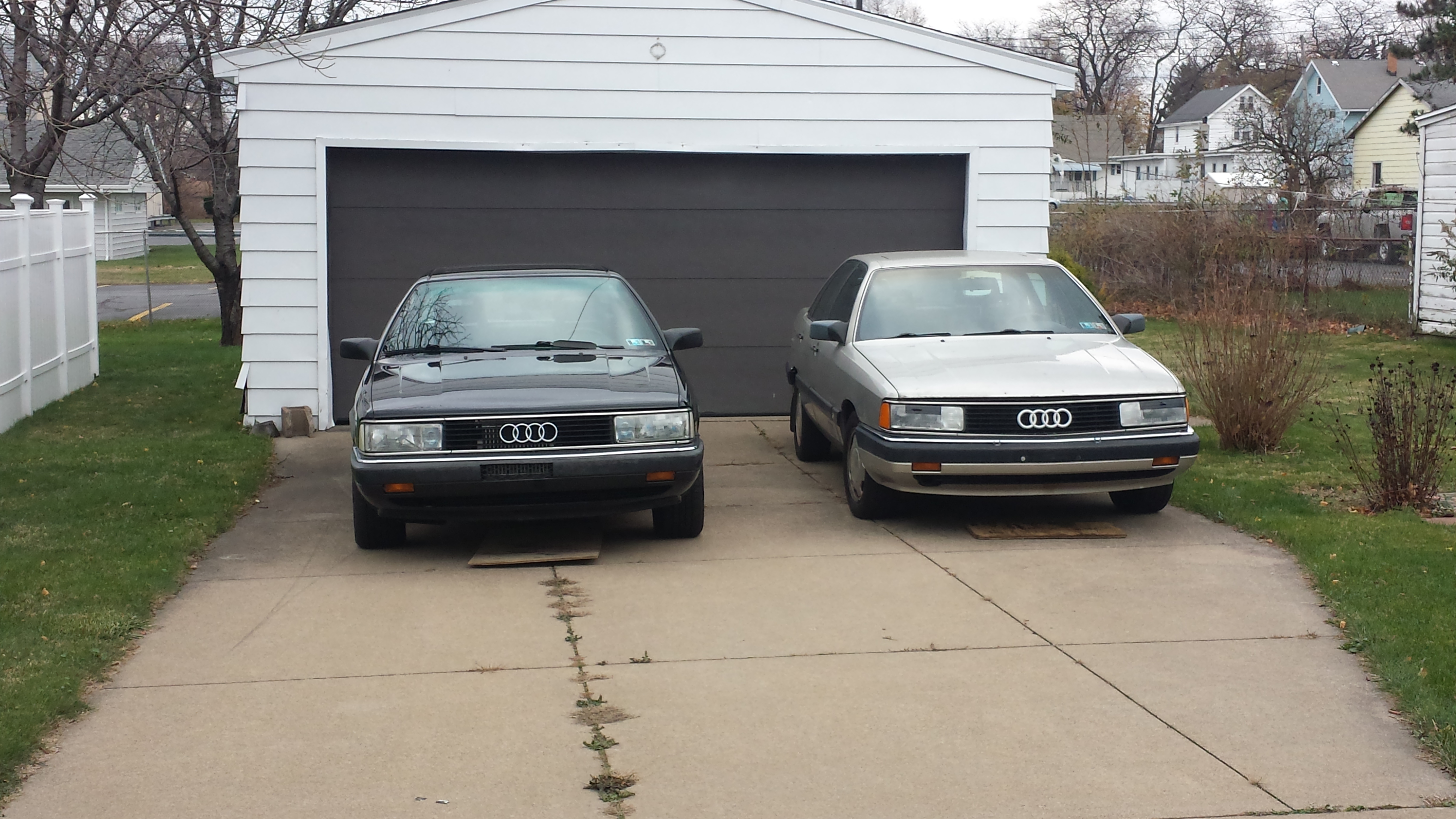

Awesome man looks great in yellow lol! Look at us with out cut-out front bumpers for our intercoolers :D
You definitely went a little larger on yours.
