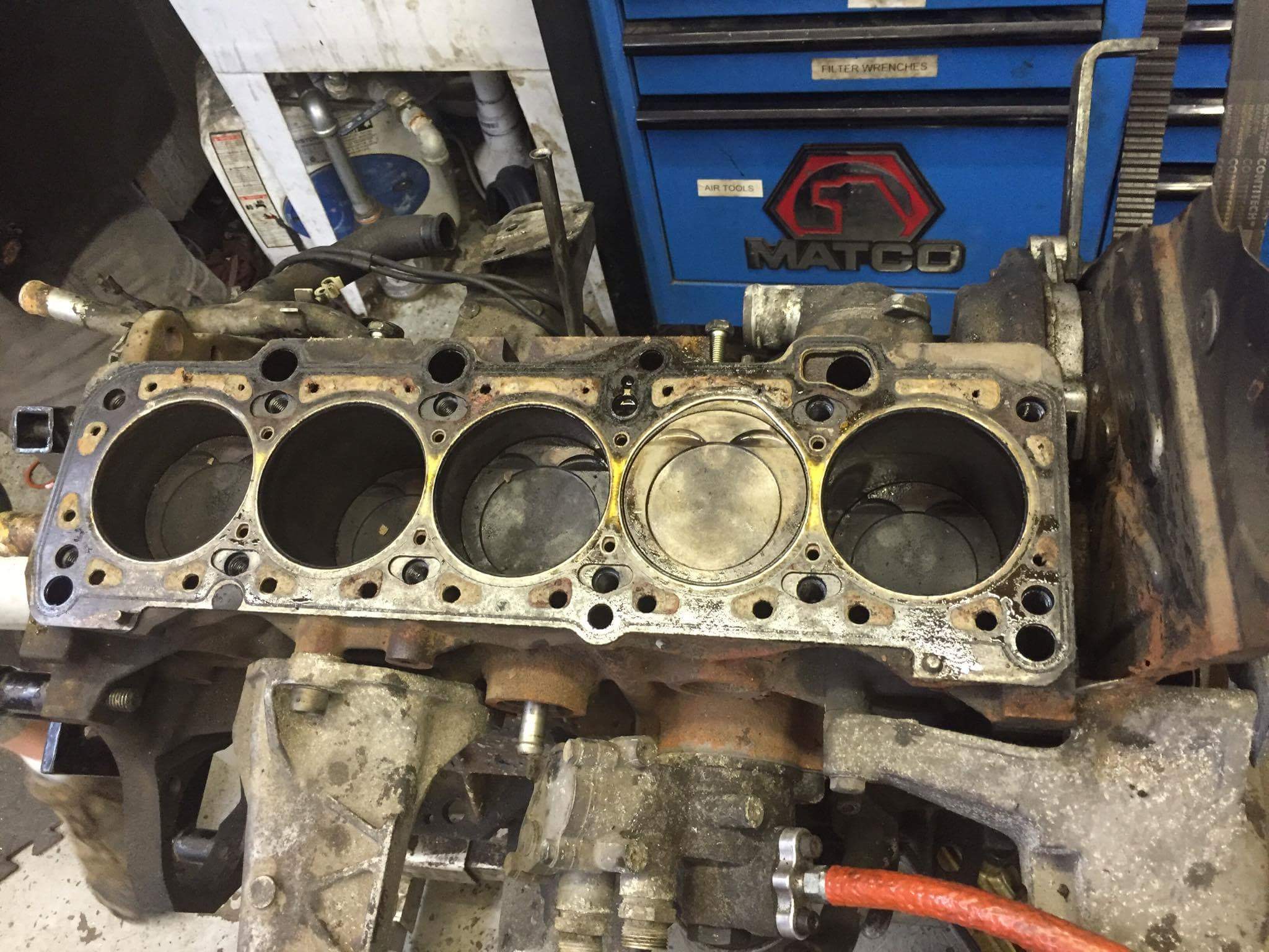

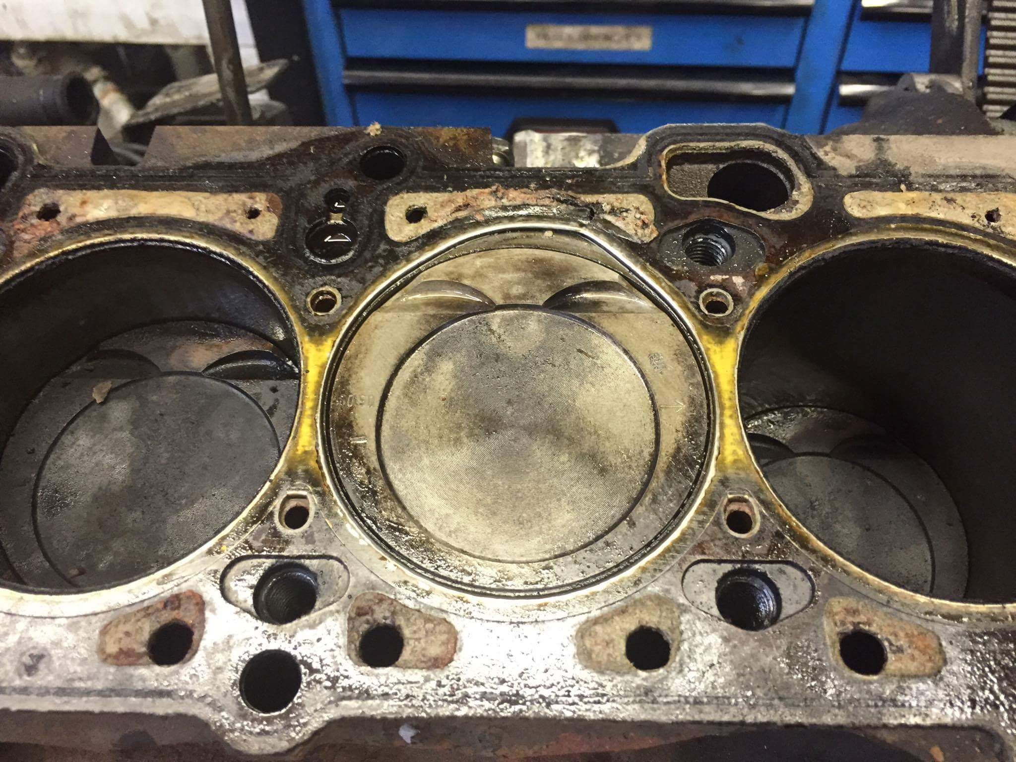

Steam cleaned!
- received_10155167755597786.jpeg (358.43 KiB) Viewed 40432 times
- received_10155167755457786.jpeg (336.79 KiB) Viewed 40432 times

Dang! I dont know if I have seen one, is that what the stock HG looks like?
Re: Chris' 200 20v Avant - RENNWGN - Blowed Up
That happenes, how does the head look?
