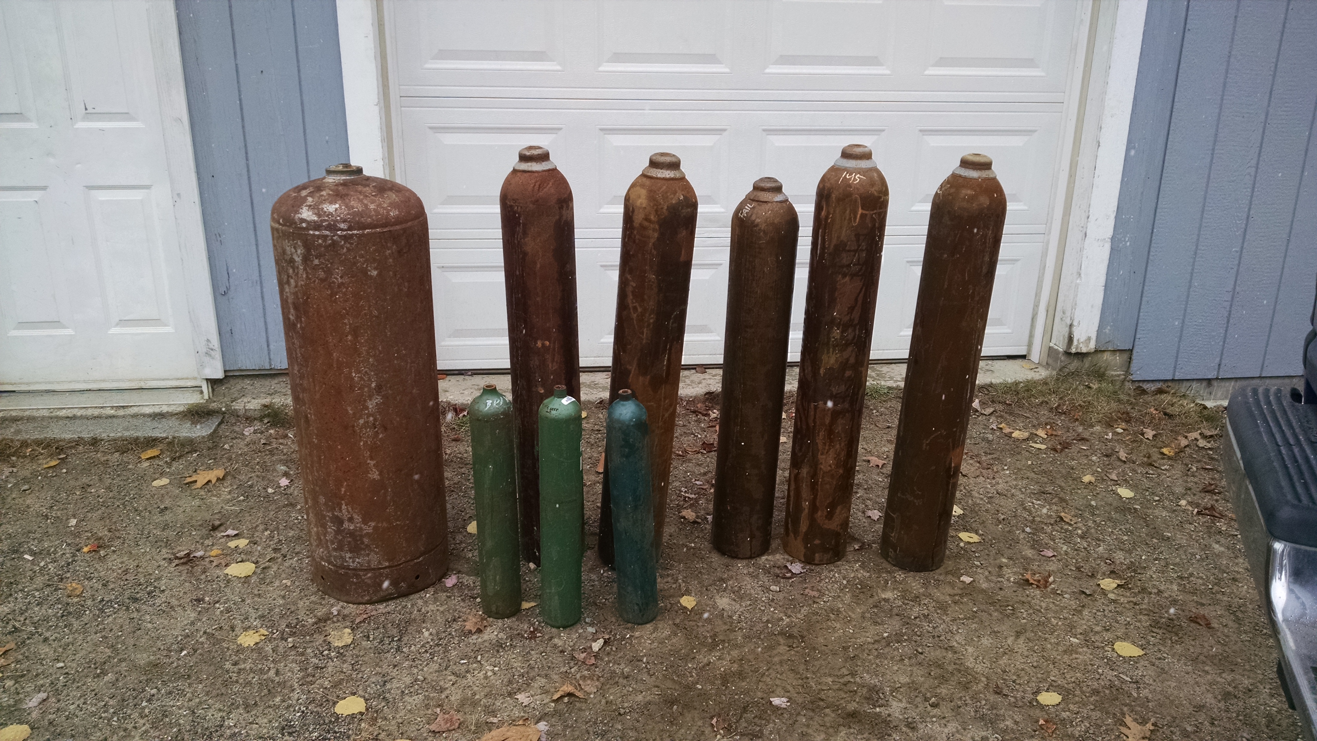

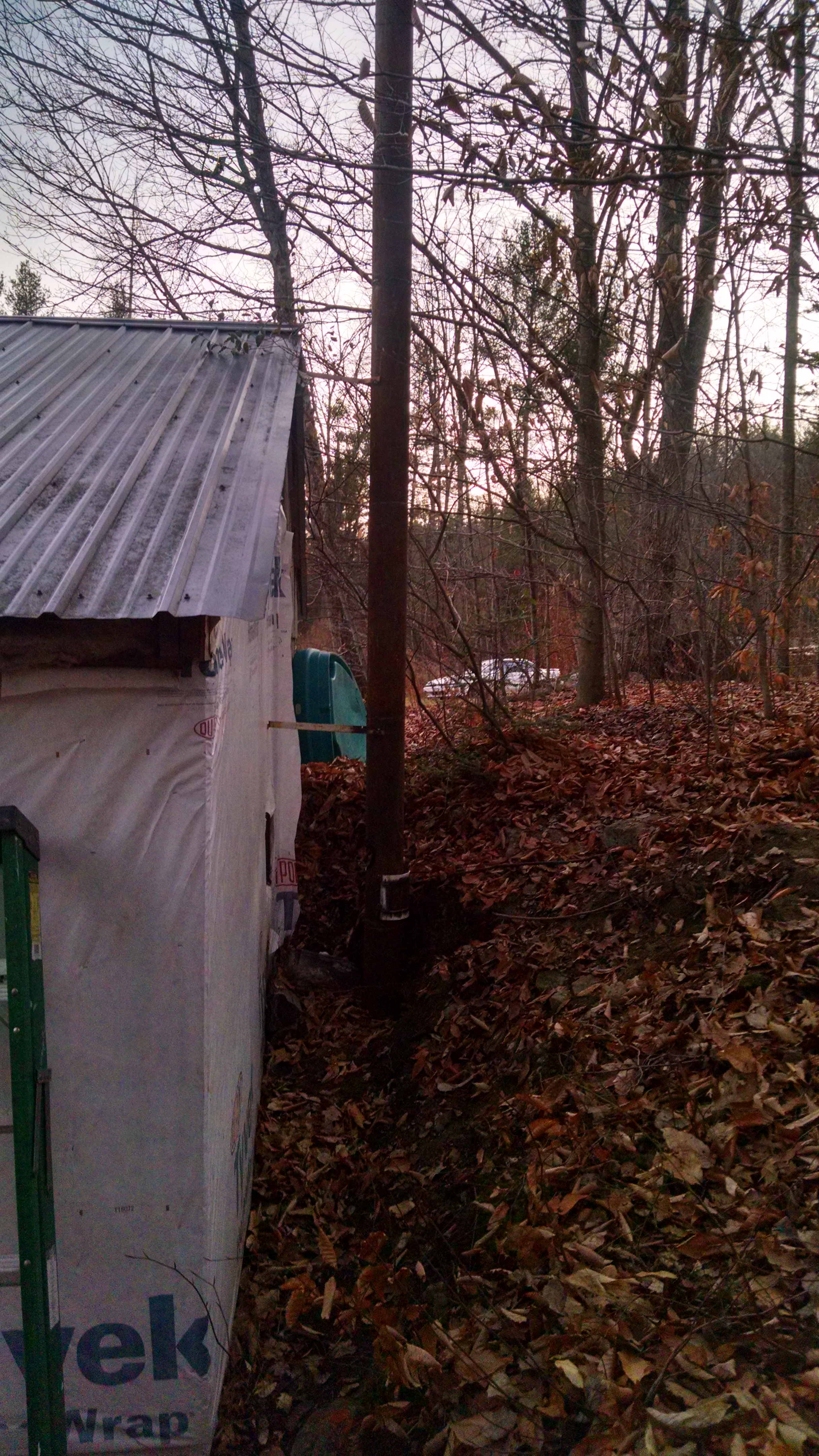

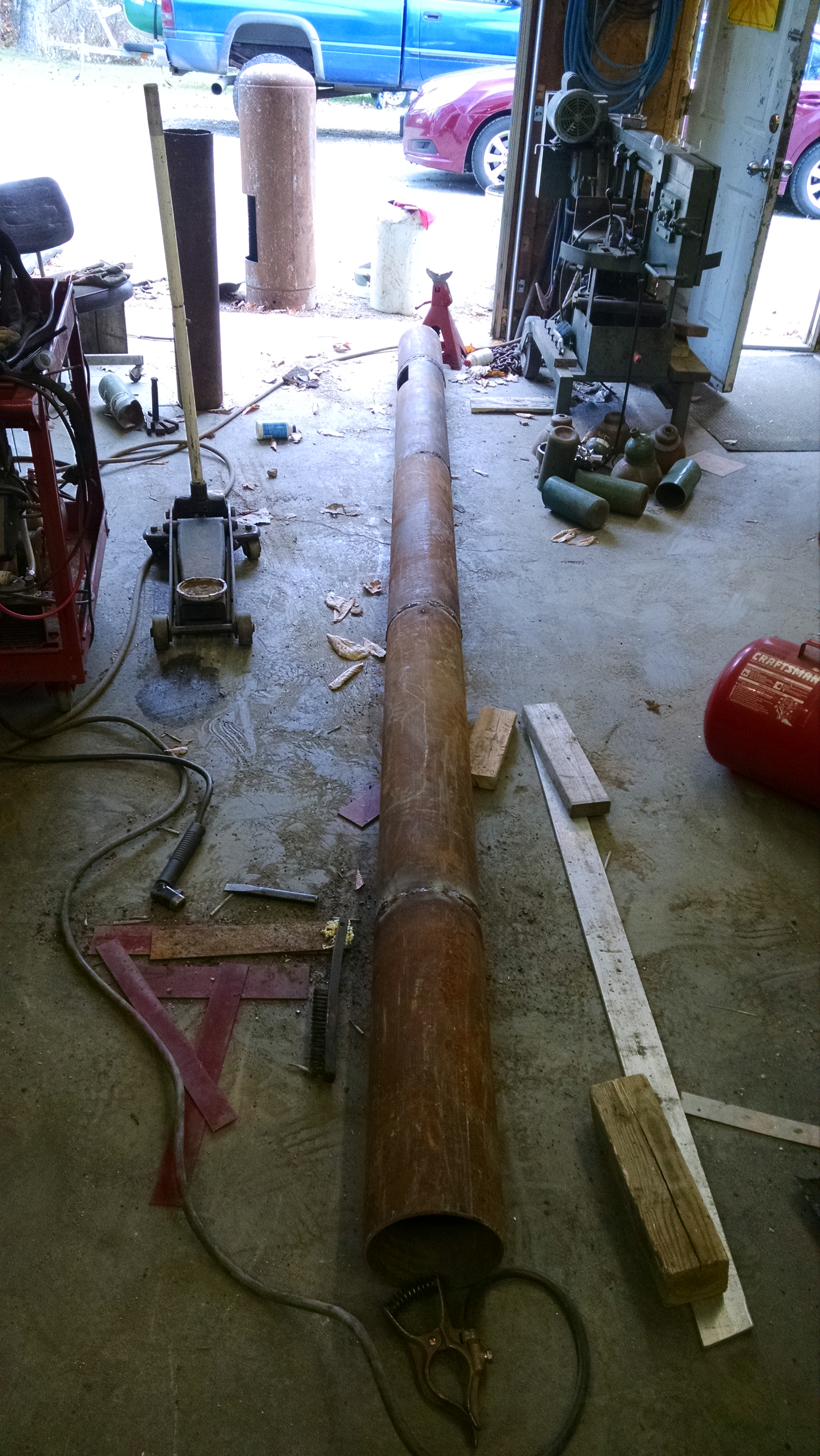

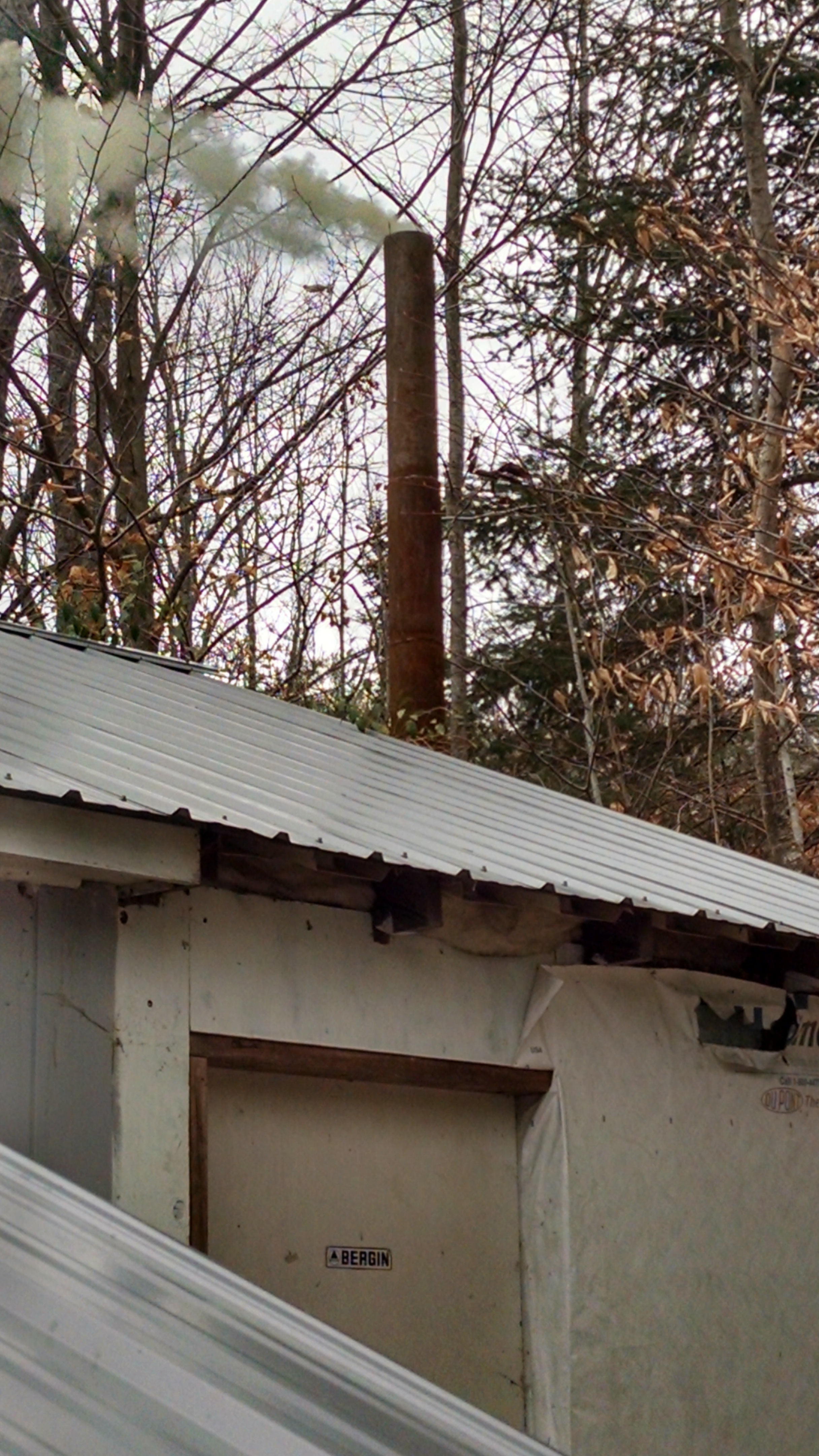

I found a few version of this on YouTube so I figured I would give it a shot myself, with the price of scrap low I went to the local salvage yard that the air gas plant scraps all there bottles and got some supply's. 1st off I built a new chimney since my stove pipe one was getting rough, I used 6 argon tanks welded end to end to make an 18.5' chimney
Don't judge the welds,  I'm a tig welder not a stick welder

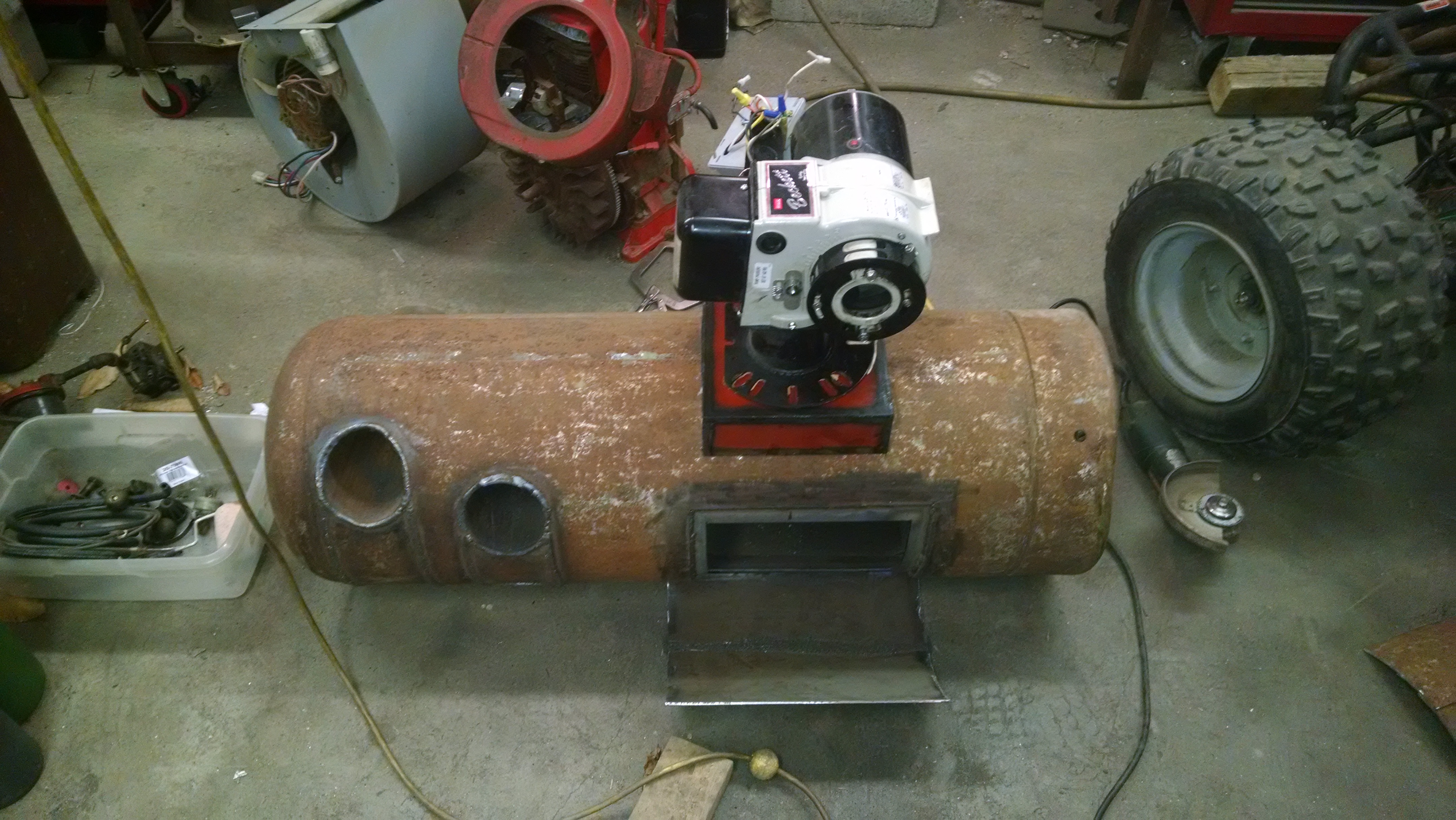

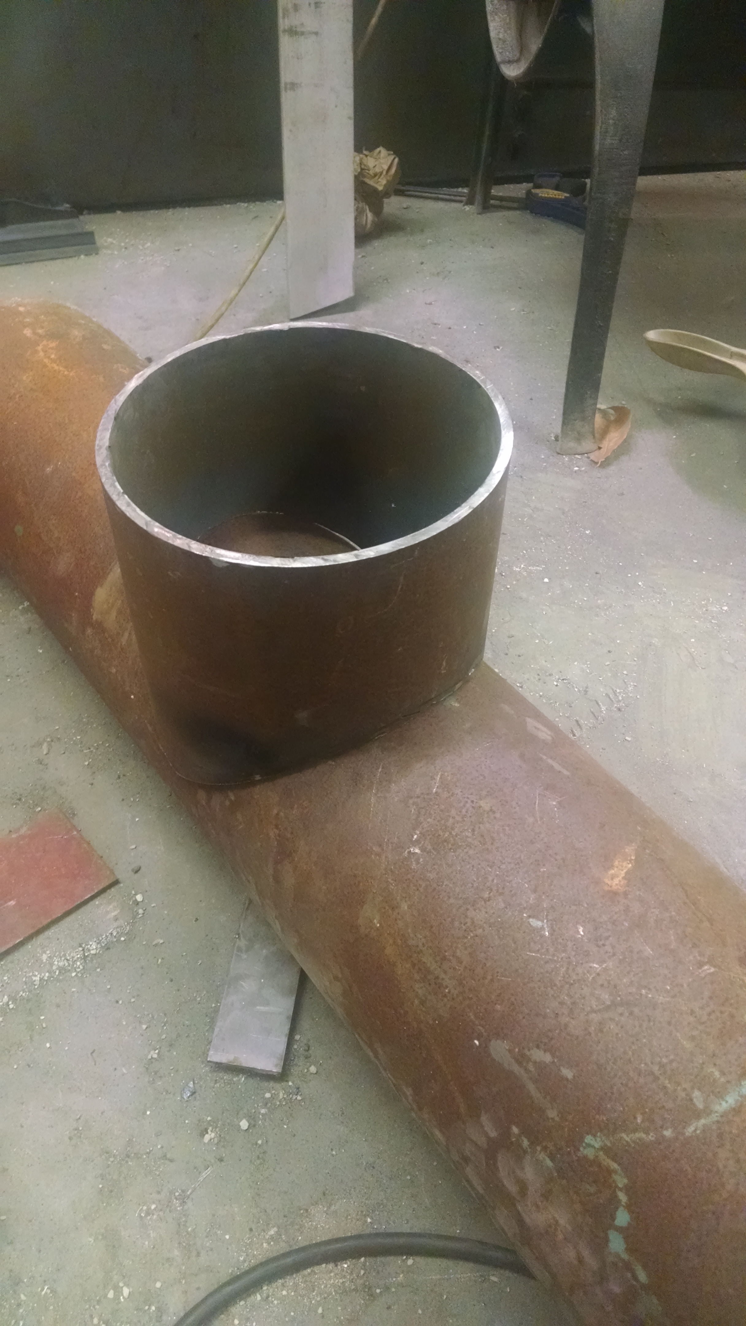

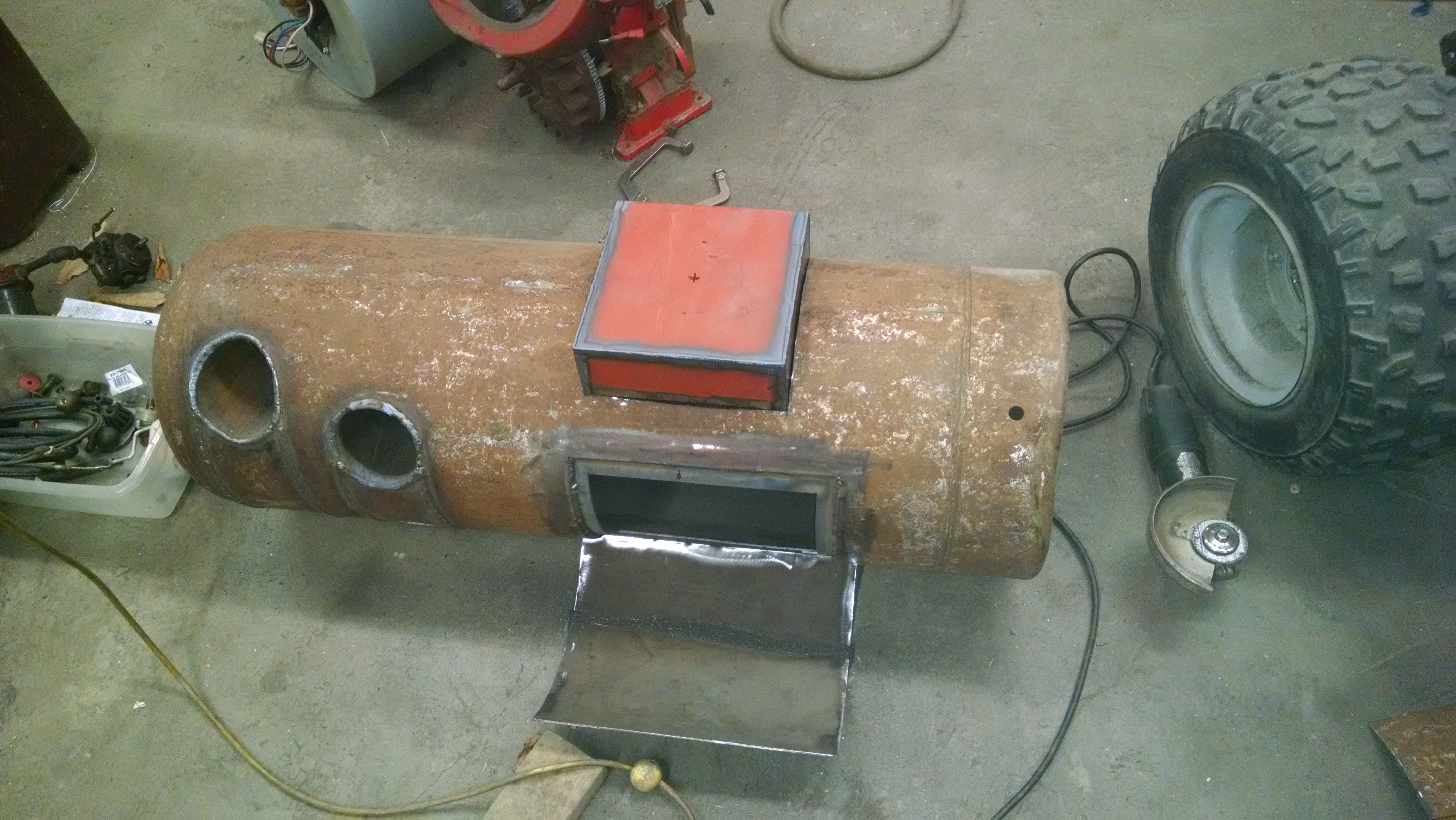

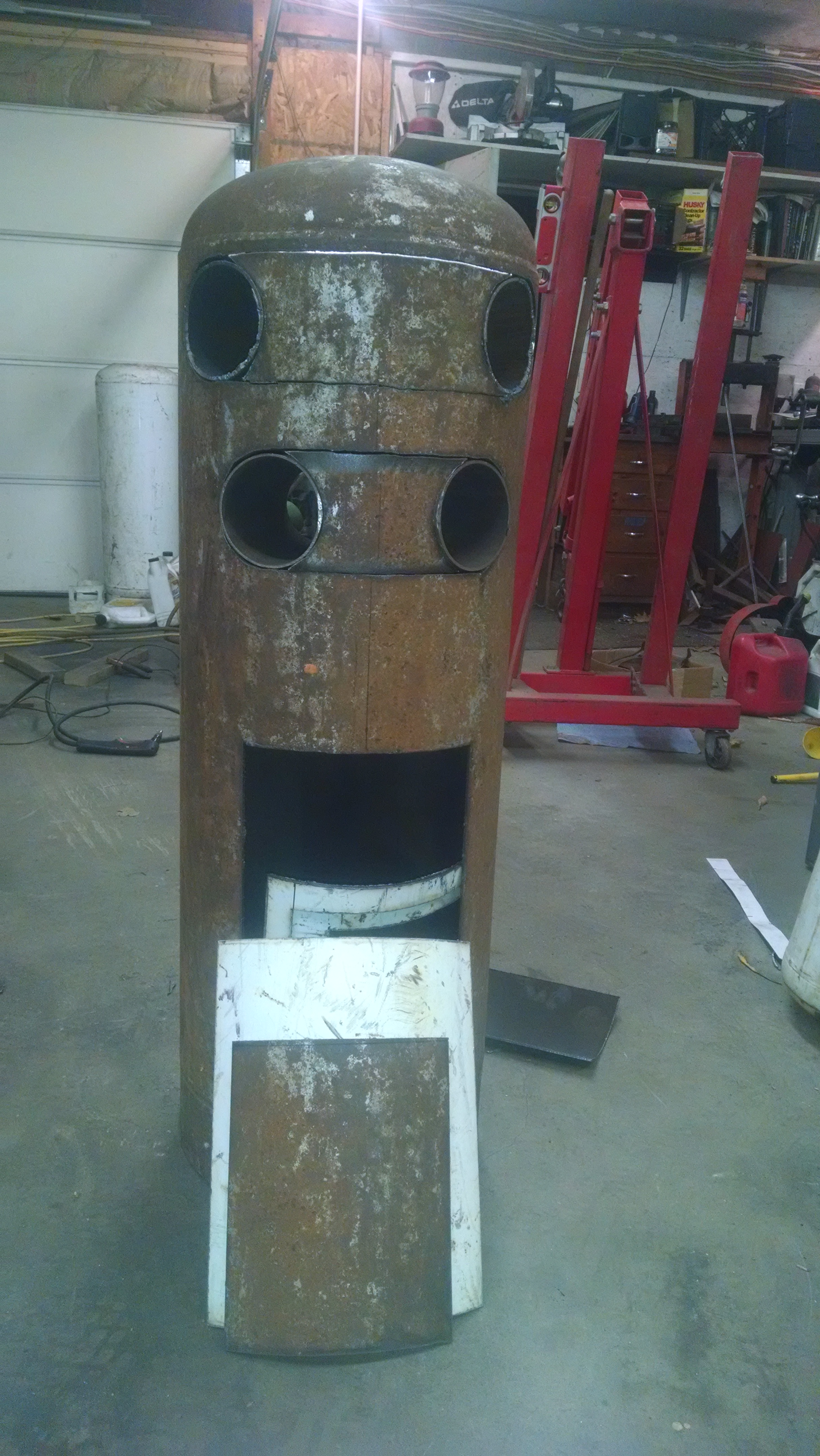

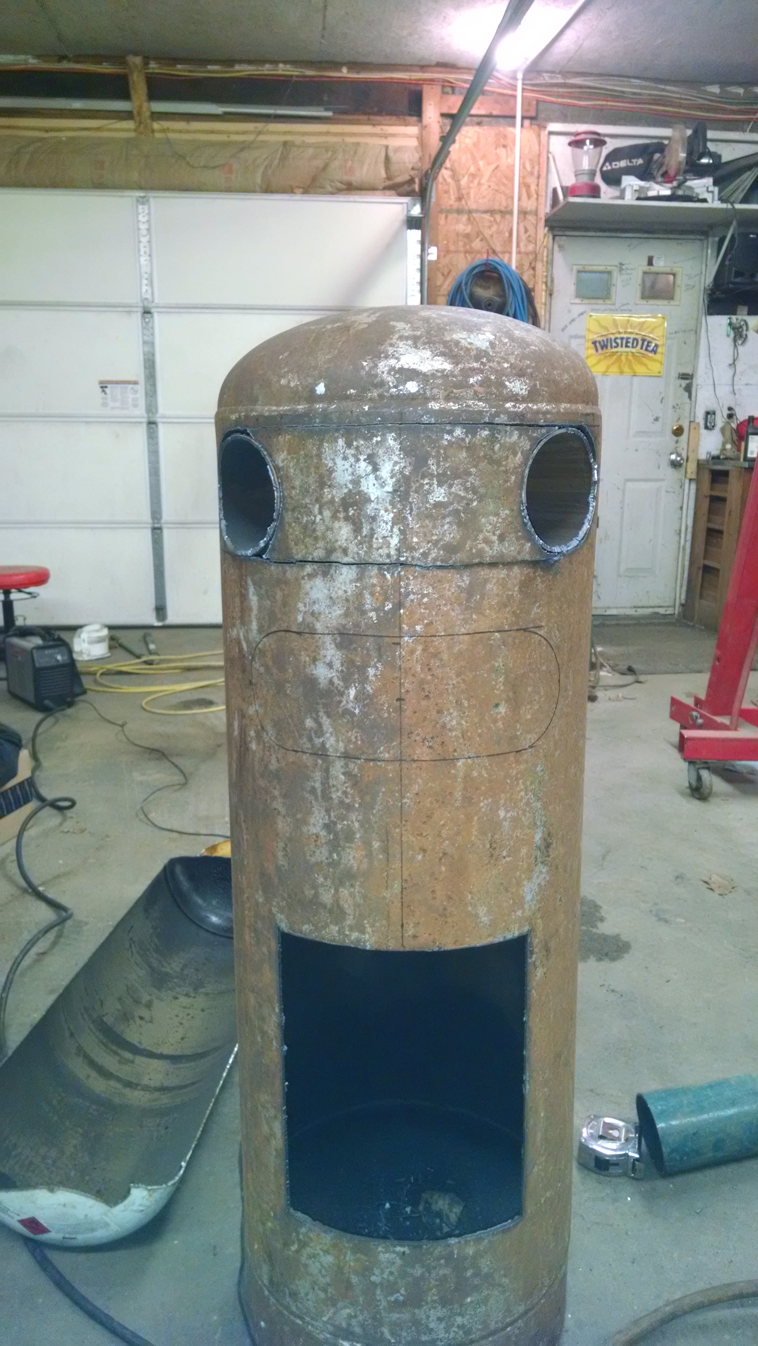

Ok so now that the chimney was done I could move onto the waste oil furnace, the main part of the furnace is an old propane tank. Some how I don't own a plasma cutter yet so I luckly have really generous friends and I was able to borrow one for a long weekend to get 90% of the cutting done, this saved me tons of time and cut off wheels.
I have a 1/4" steel fuel line going down the ctr of this tube for the oil and the blower pushes air through the pipe cooling the line and feeding the flame
I'm using a oil burner that was going to get scrapped since it was attacked to a cracked furnace(freebie!). It's only being used as a blower since this is a drip style burner.

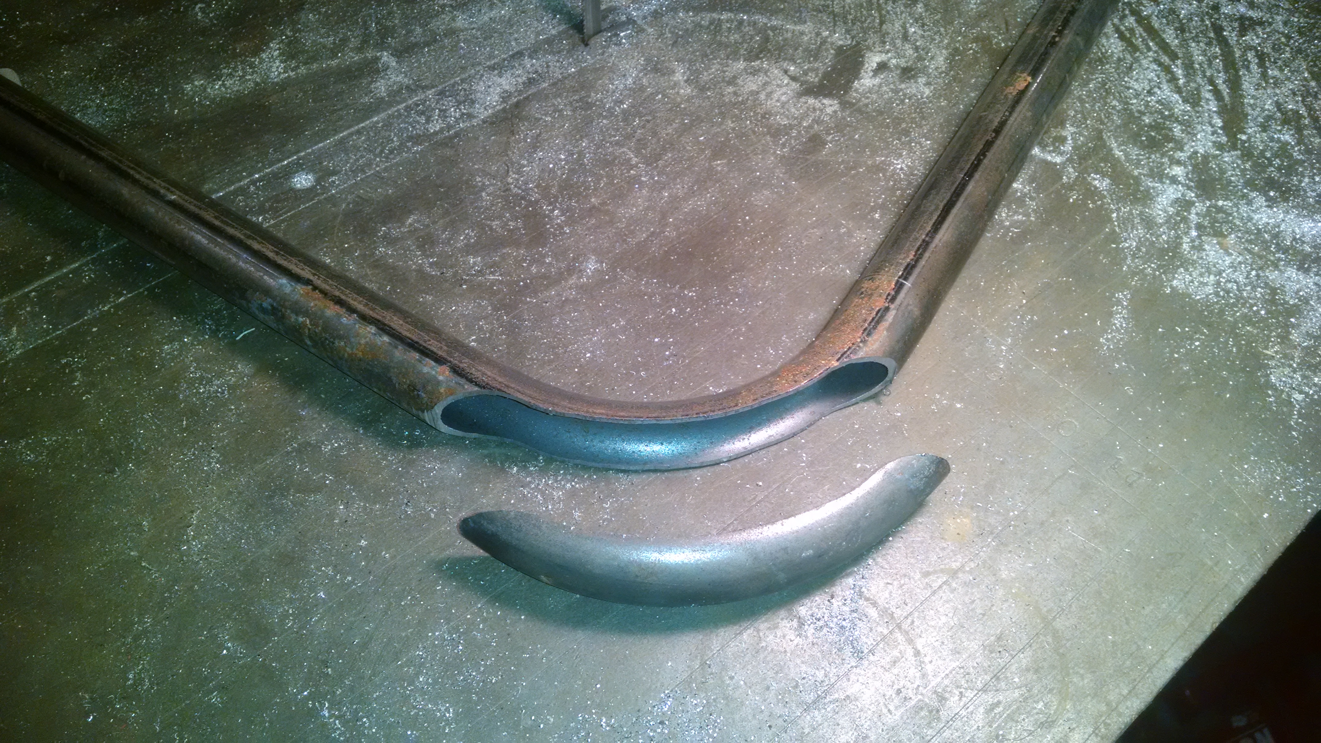

The through holes are oxygen tanks,  the are v's and exit the ctr of the back and will be hooked to duct work to pump air into the main room in my shop

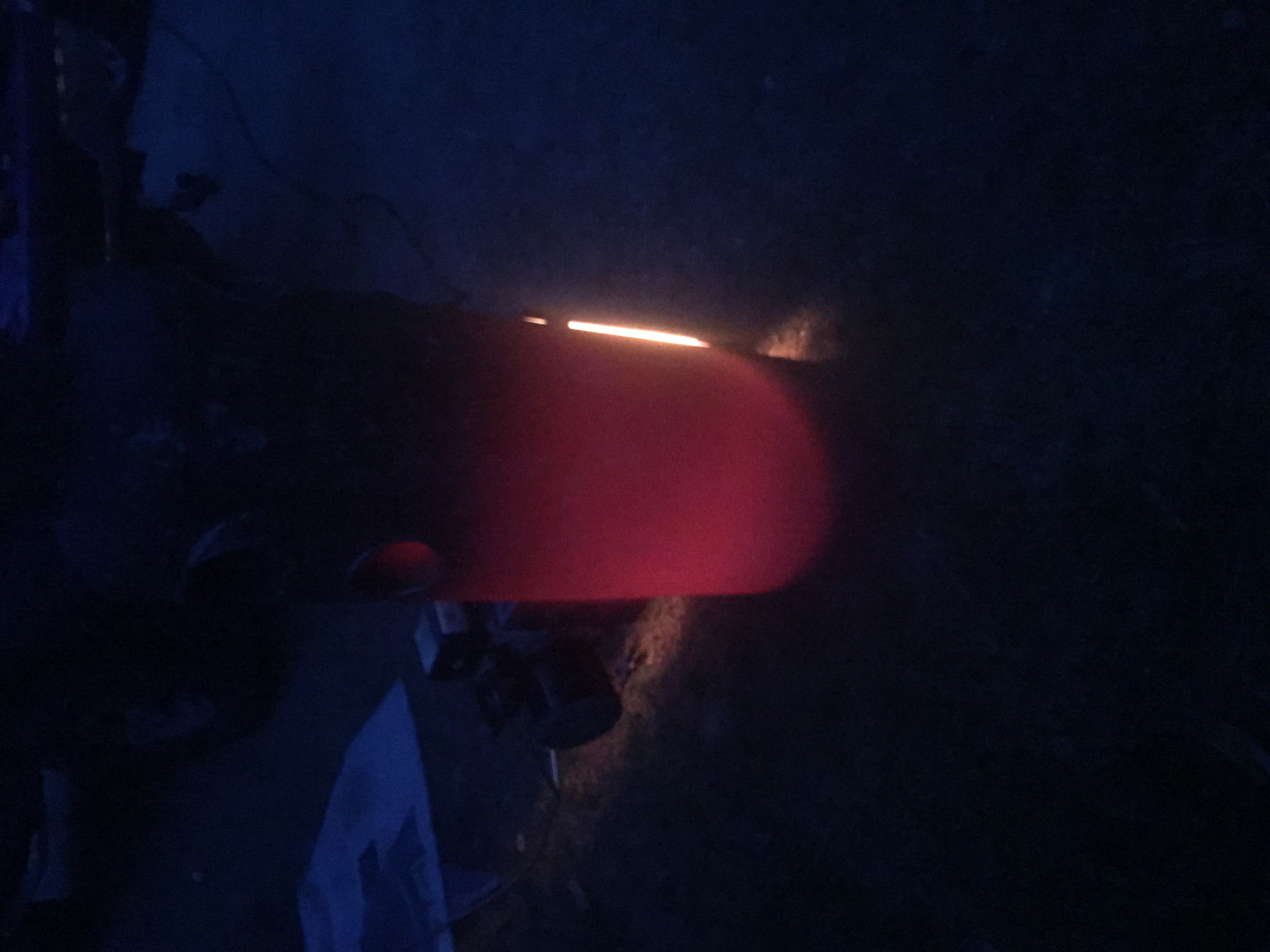

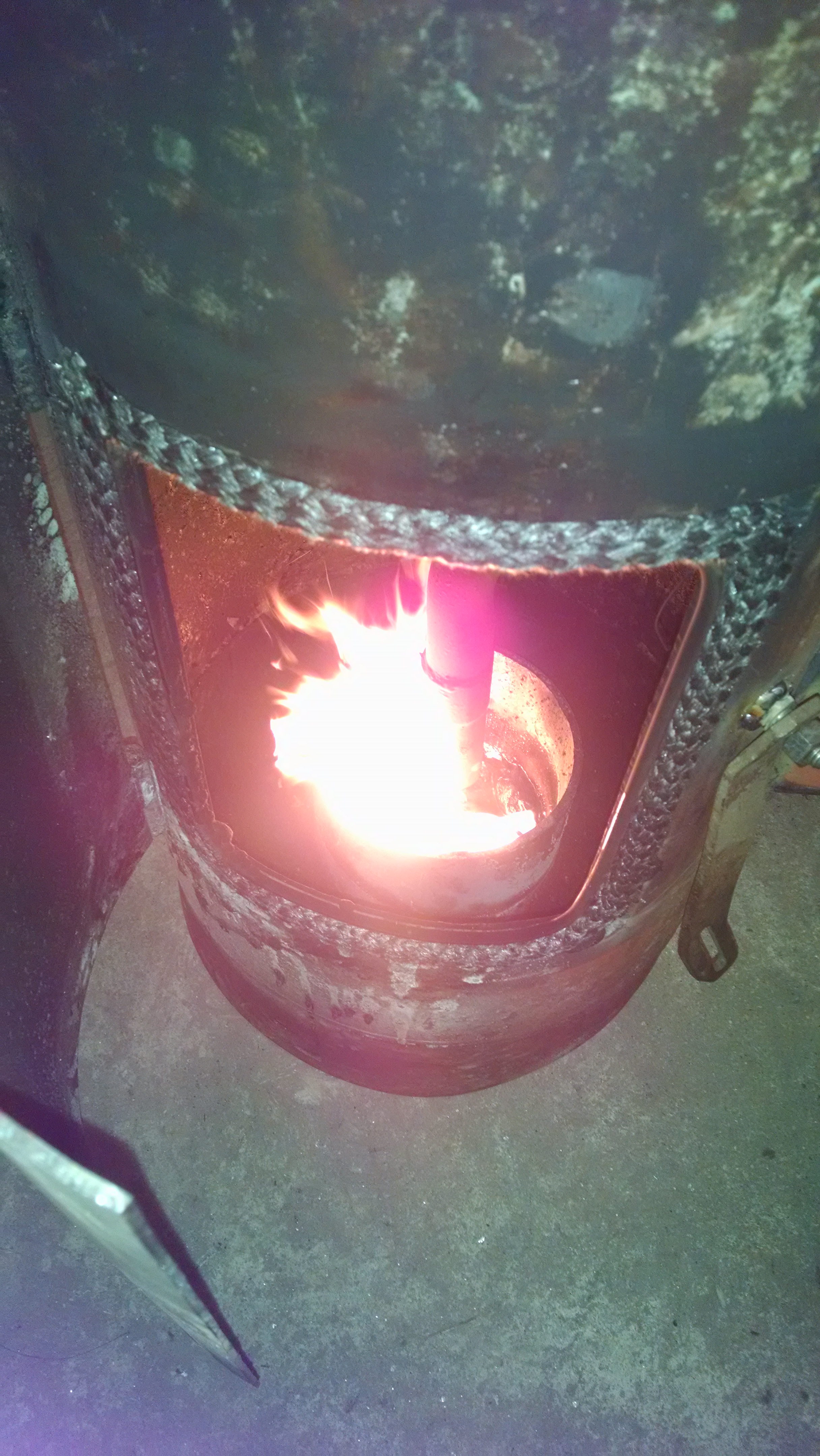

So I've had it running for a week now, but before that the 1st test failed I flooded it and instead of spilling all the diesel I was using to test it I just figured I burn it off. That was a bad idea it was rolling coal like crazy so I made the second bad decision and turned the whole propane tank into a burn pot by turning on the blower sending burning diesel all through the bottom of it. After 2/3rds of it was glowing I used a fire extinguisher to shut it down, good news is all the welds held through the extreme heat cycle. I'll post the link to the you tube videos I based this off of
The burn pot is the bottom of a argon tank but I think it would work better with a thin ss pot with a flat bottom  so it gets hotter a burns better
Oops this is when I decided to shut it down with a fire extinguisher

Thanks I think 150 gallons might last me all winter. I've had no issues with it now that I have the needle valve in the feed line. I'm pretty sure this will hold up for awhile nothing is thinner then .125 except I've gone to a thin ss bowl for the burn pot, it gets hotter faster to start easier and I can run less fuel and lower the heat a bit. Next upgrade is some sort of thin ring in the burn pot to try and help control the the shape and the intensity of the flame.
