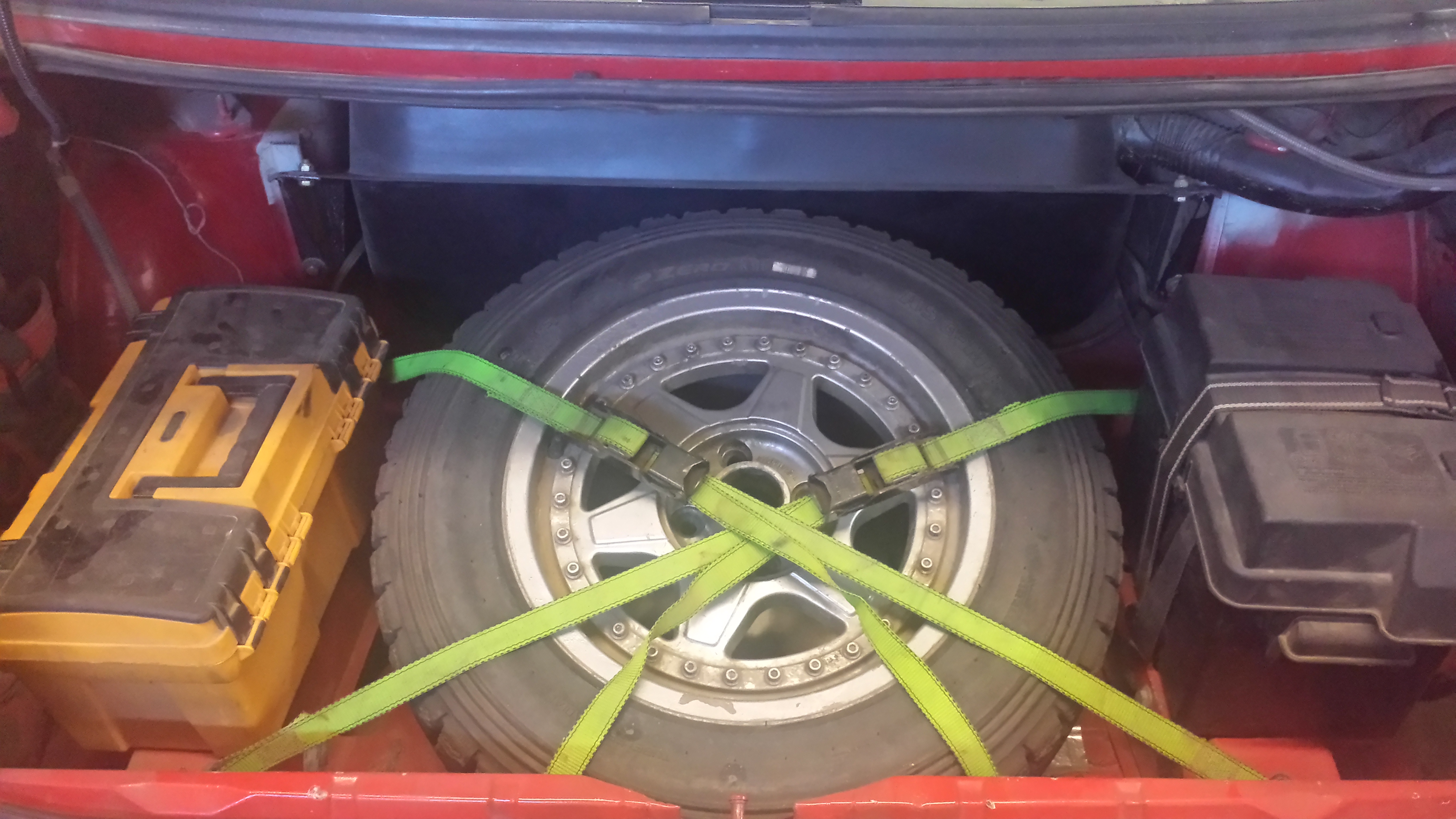

how are you fitting a spare tire in the trunk? The b3 is nearly a no go. I'm considering mounting on top of the trunk!
vbares
Posts: 36
Joined: Thu Apr 18, 2013 11:31 pm
Re: 4kRR Audi 4000 Rally Rig
Post by vbares »

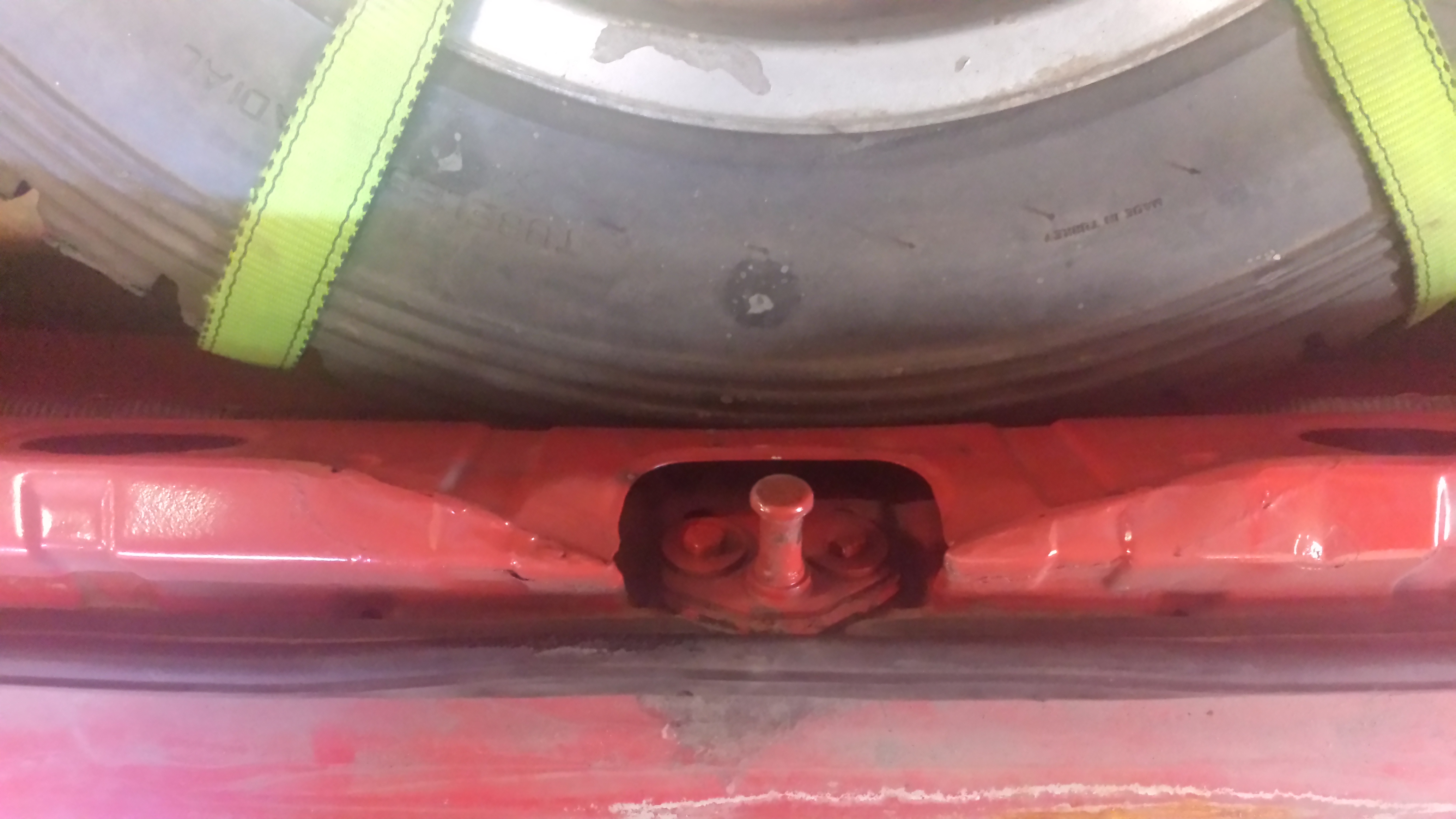

I'll take some pics tonight - its a tight squeeze and I cut some body material near the lock pin...
2015-10-08 12.10.42.jpg (1.54 MiB) Viewed 49490 times
2015-10-08 12.10.25.jpg (2.25 MiB) Viewed 49490 times

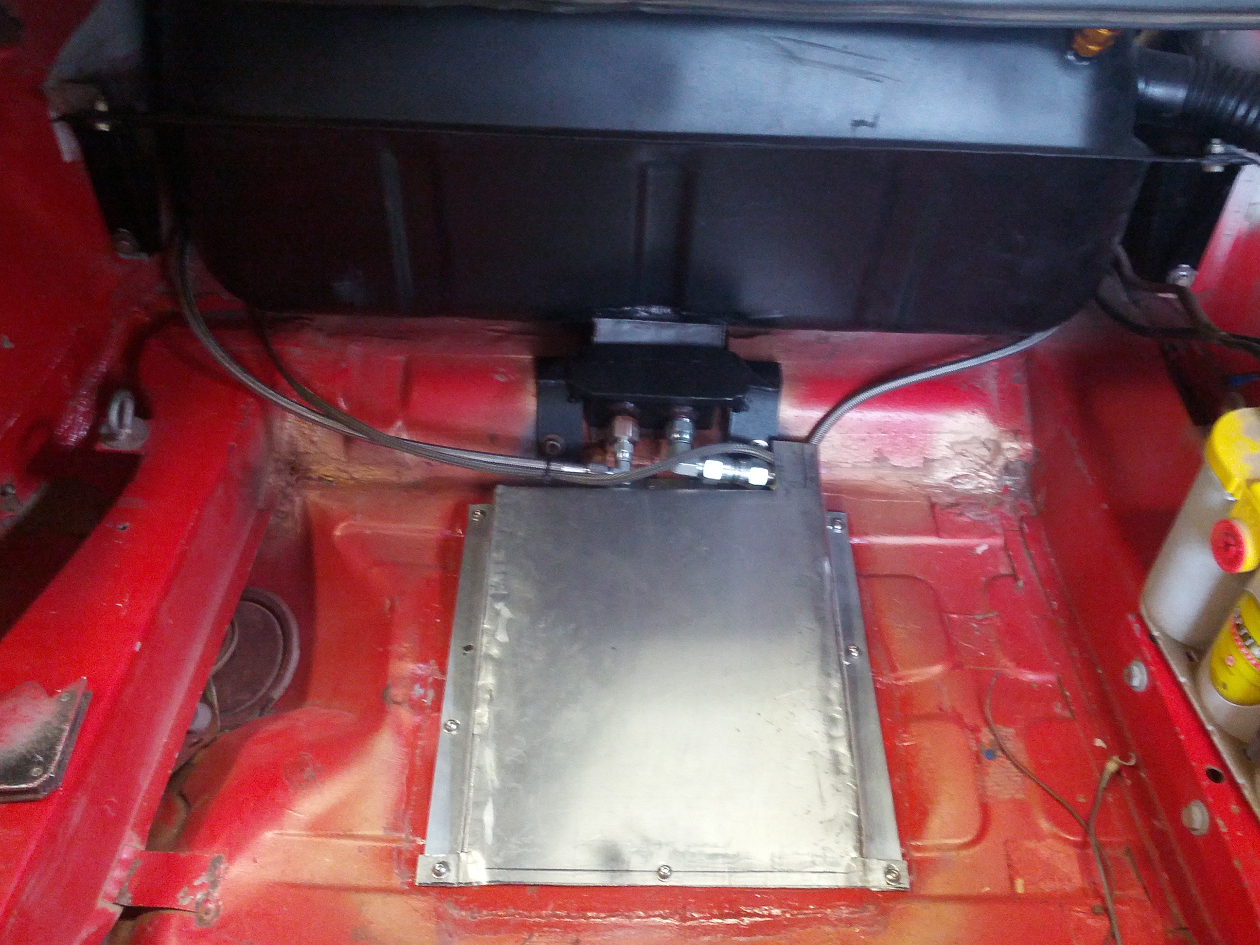

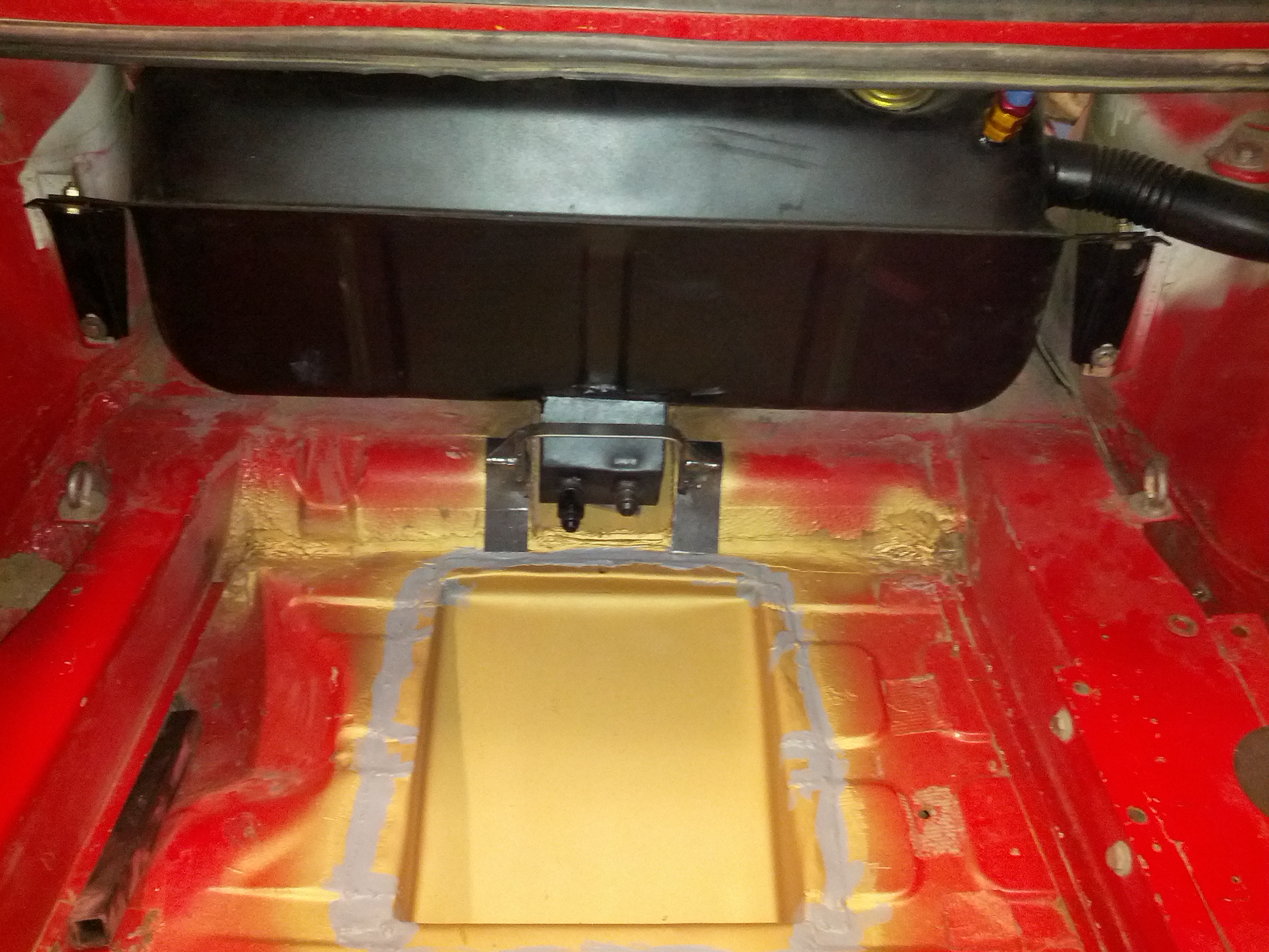

I just remembered that I moved the gas tank backwards by modifying the brackets (I'll look for those pics too) - plus you'll see that I cut the trunk a bit in a wide v-shape in order to facilitate in-out.
2 195/15 fit, but only 1 205/15 will fit

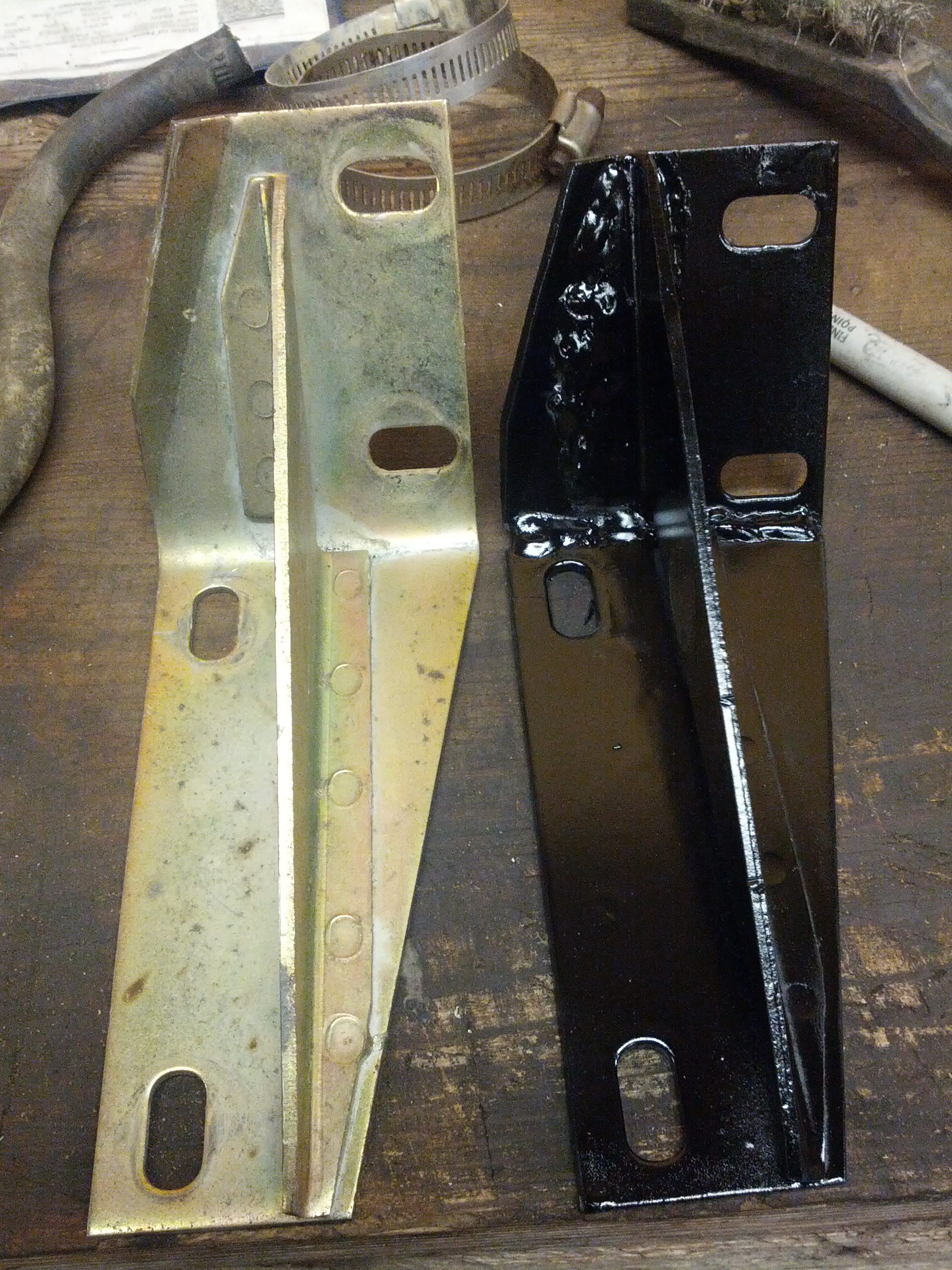

yep - here is a pic of how I changed the bracket - it moves the tank back a bit, but not so much that I had to change the bulkhead configuration. I don't know how this would work with stock fuel lines as I have a different implementation for the fuel pumps...
2013-01-21 17.29.36.jpg (2.19 MiB) Viewed 49488 times
2013-02-03 17.13.40.jpg (1.64 MiB) Viewed 49488 times

Eventually I'm going to have to modify my fuel line like yours, For now I took the factory pickup out of the bottom of the tank, flipped it around a bit and welded it back in. It comes out very close to where your box does. I would like to note that it doesn't like fuel sloshing around when towards the last gallon or two. your little box might be ideal as a kind of surge tank.
I'll have to see what sort of persuading I can do to the latch area. My tire sits in a much more upright position when in the trunk. No chance in hell of getting 2 195's in there.

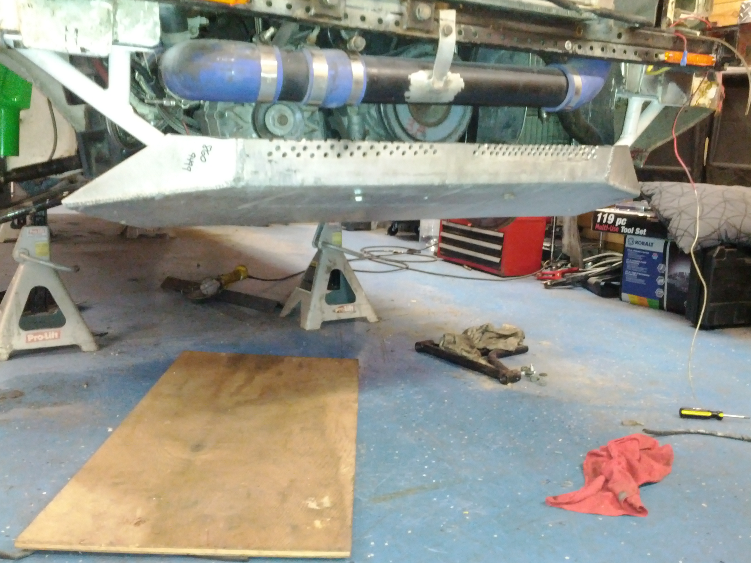

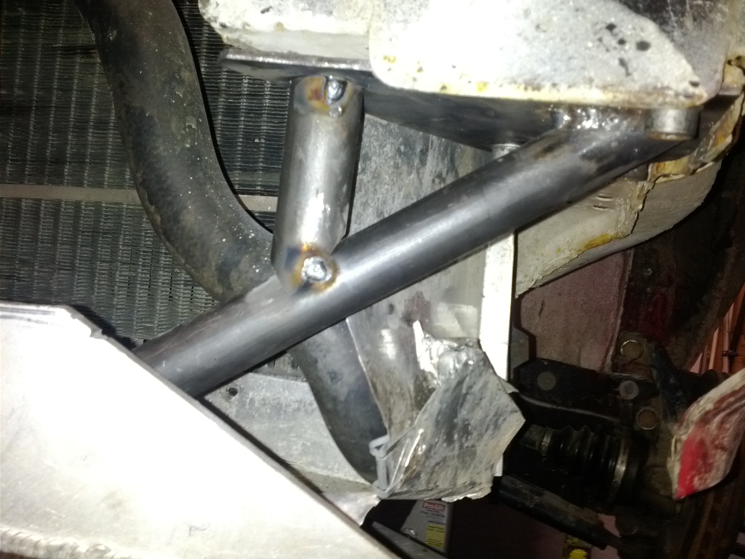

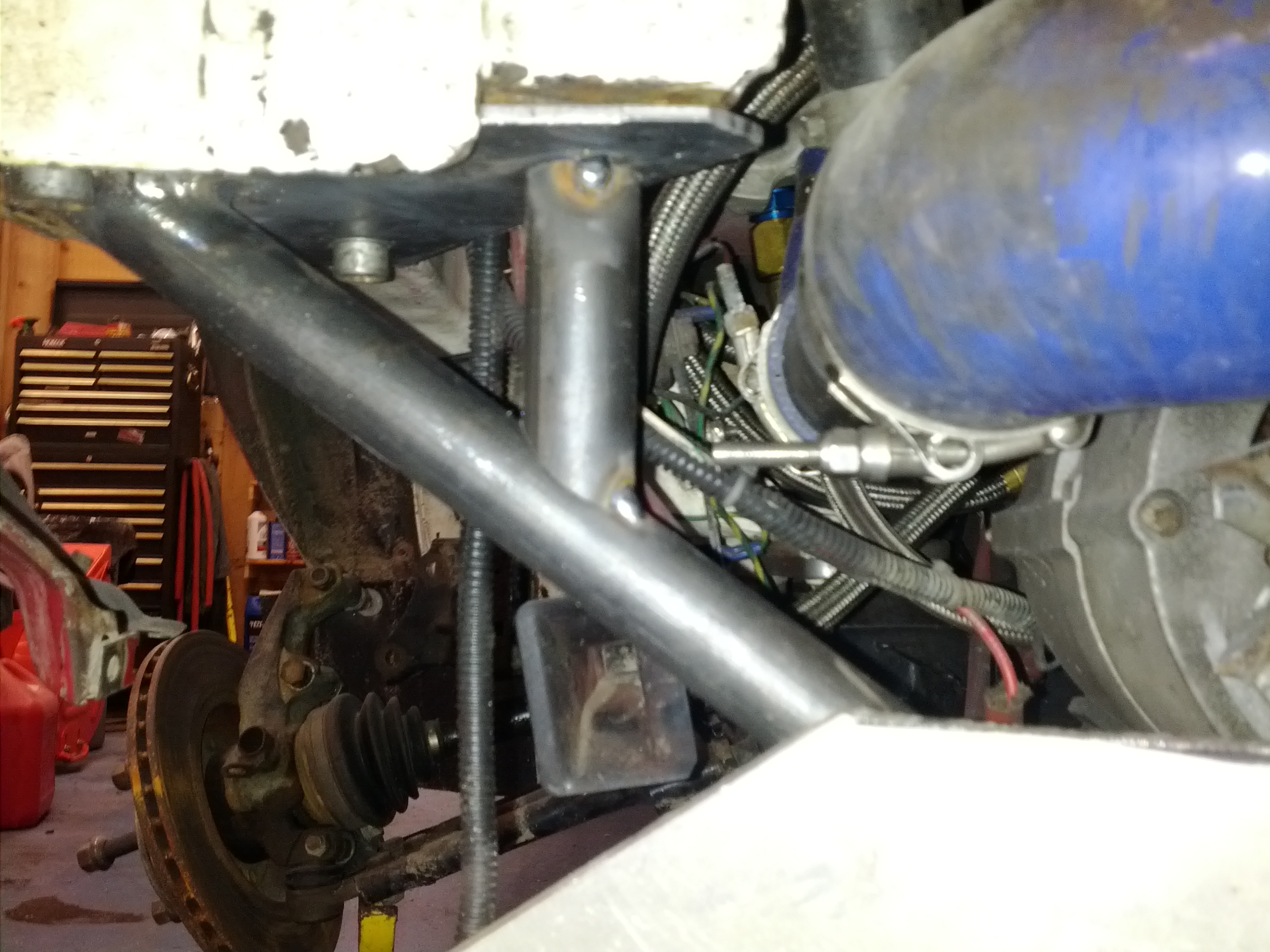

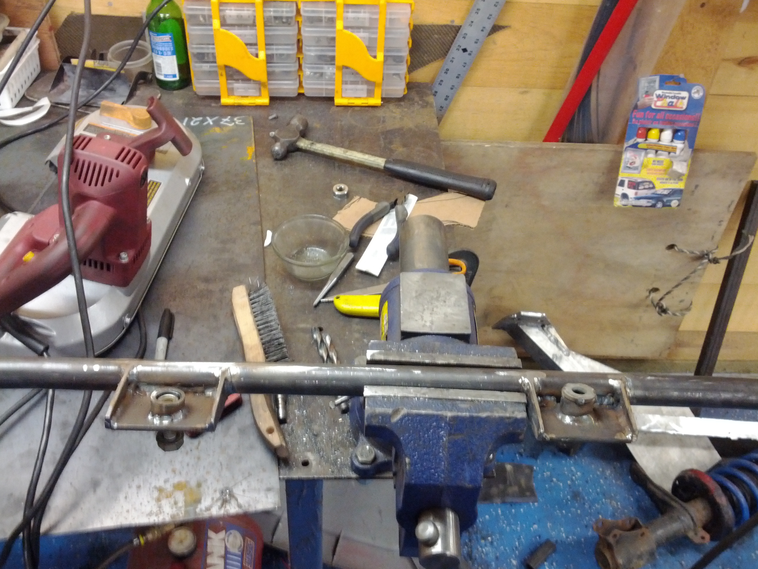

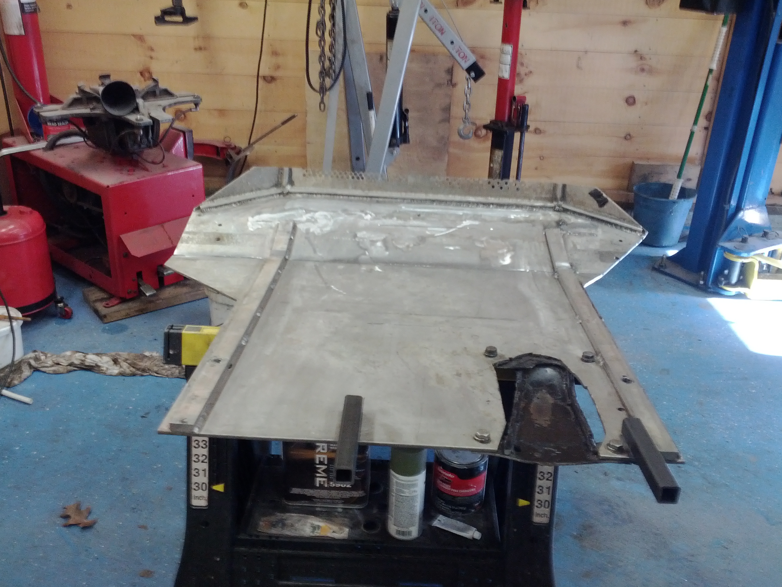

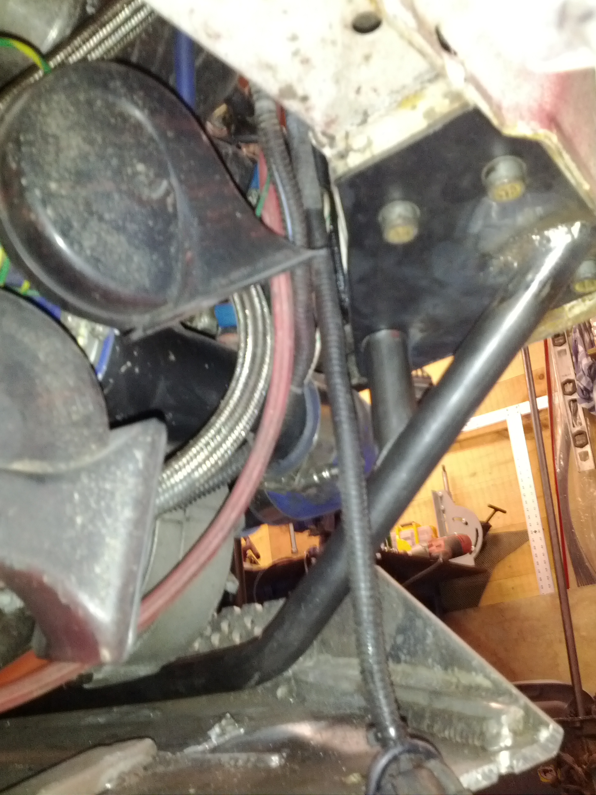

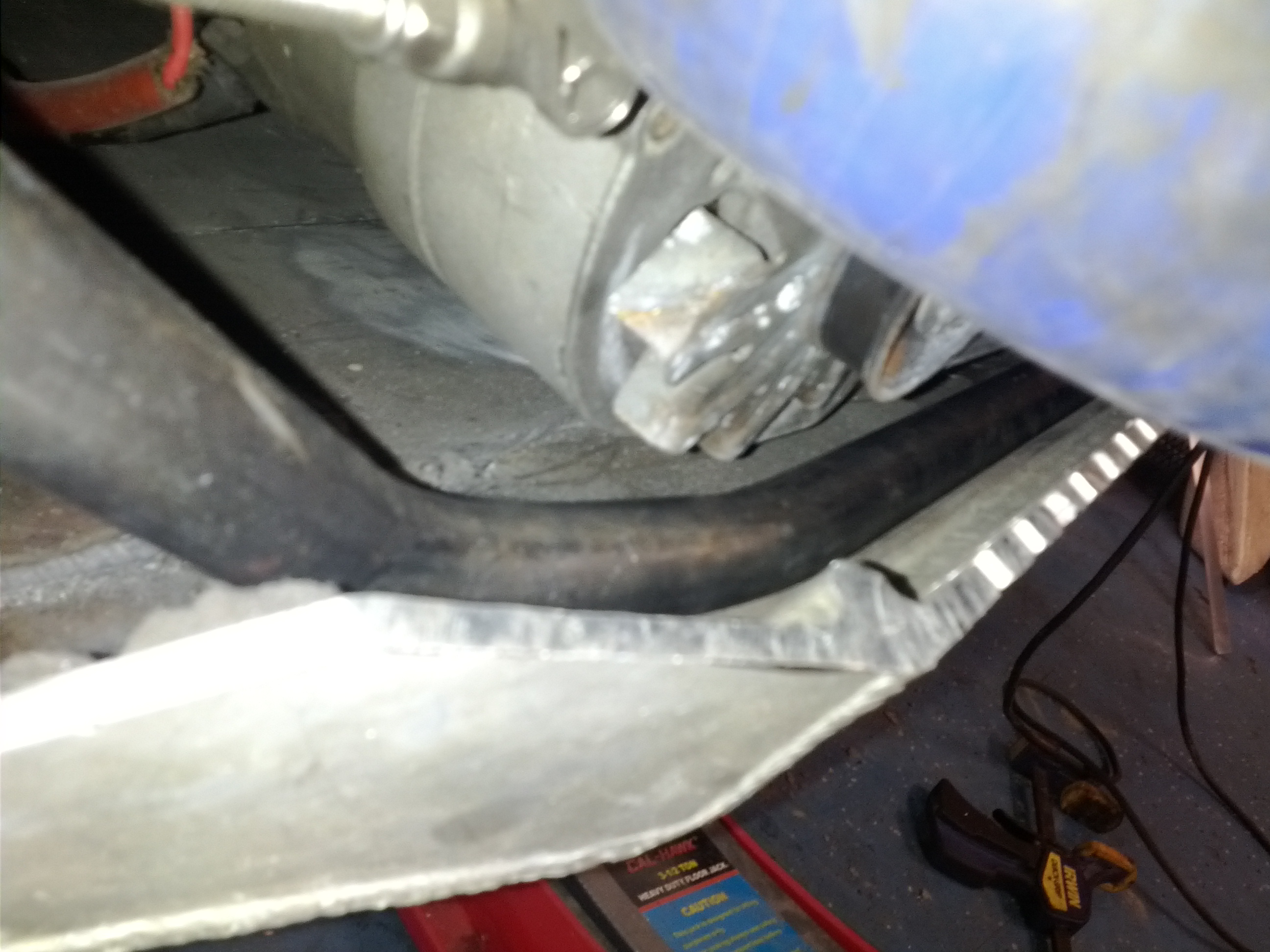

Posting pics of my skid plate setup as several folks have asked:
FIrst I built a support frame from 1" DOM.
2012-03-23 21.58.18.jpg (1.34 MiB) Viewed 49389 times
2012-03-23 22.51.12.jpg (1.3 MiB) Viewed 49389 times
2012-03-23 22.52.14.jpg (1.38 MiB) Viewed 49389 times

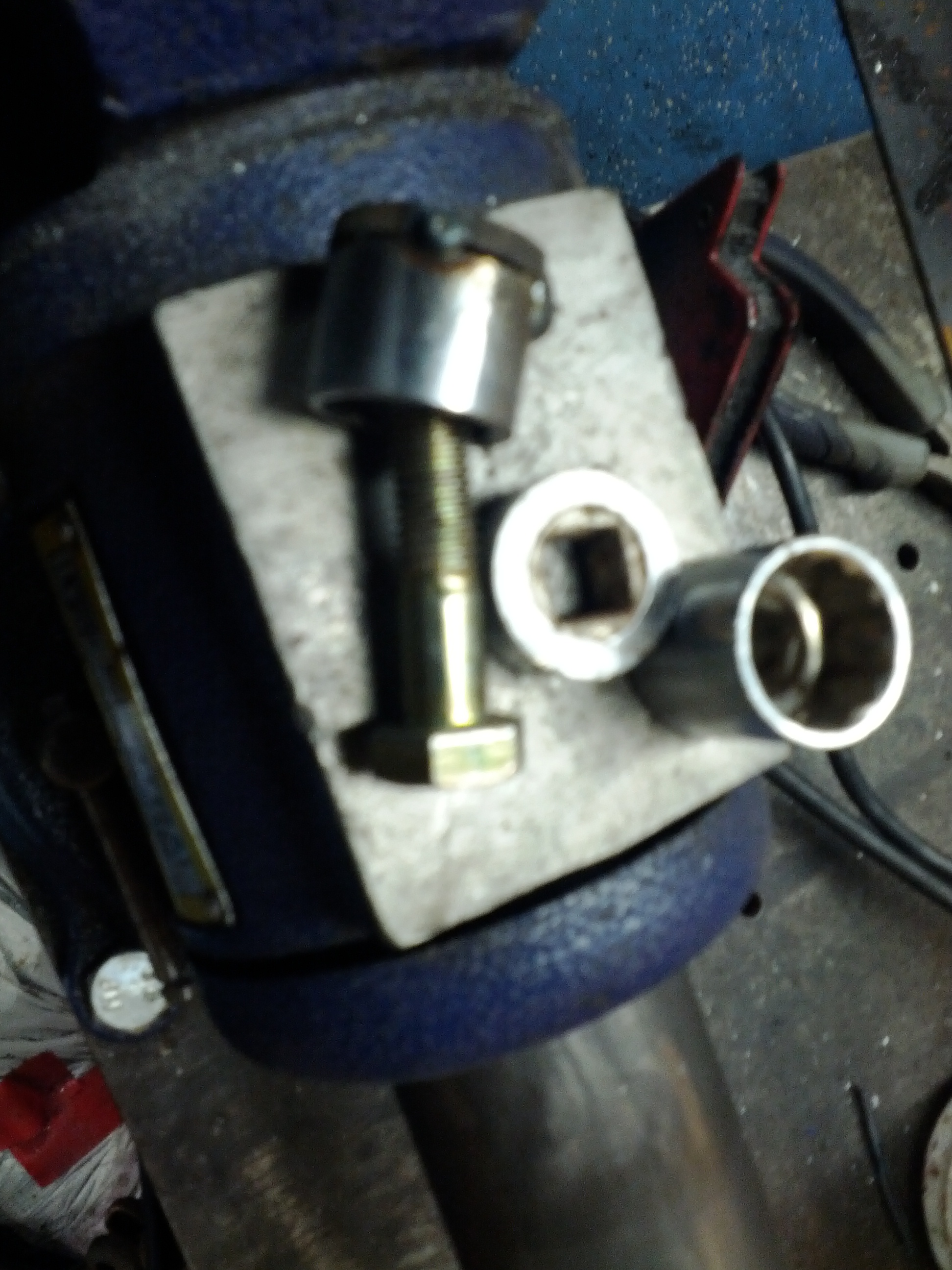

Also made some high mis-alignment nut holders using old sockets...this has proven to be invaluable.

Post by vbares »

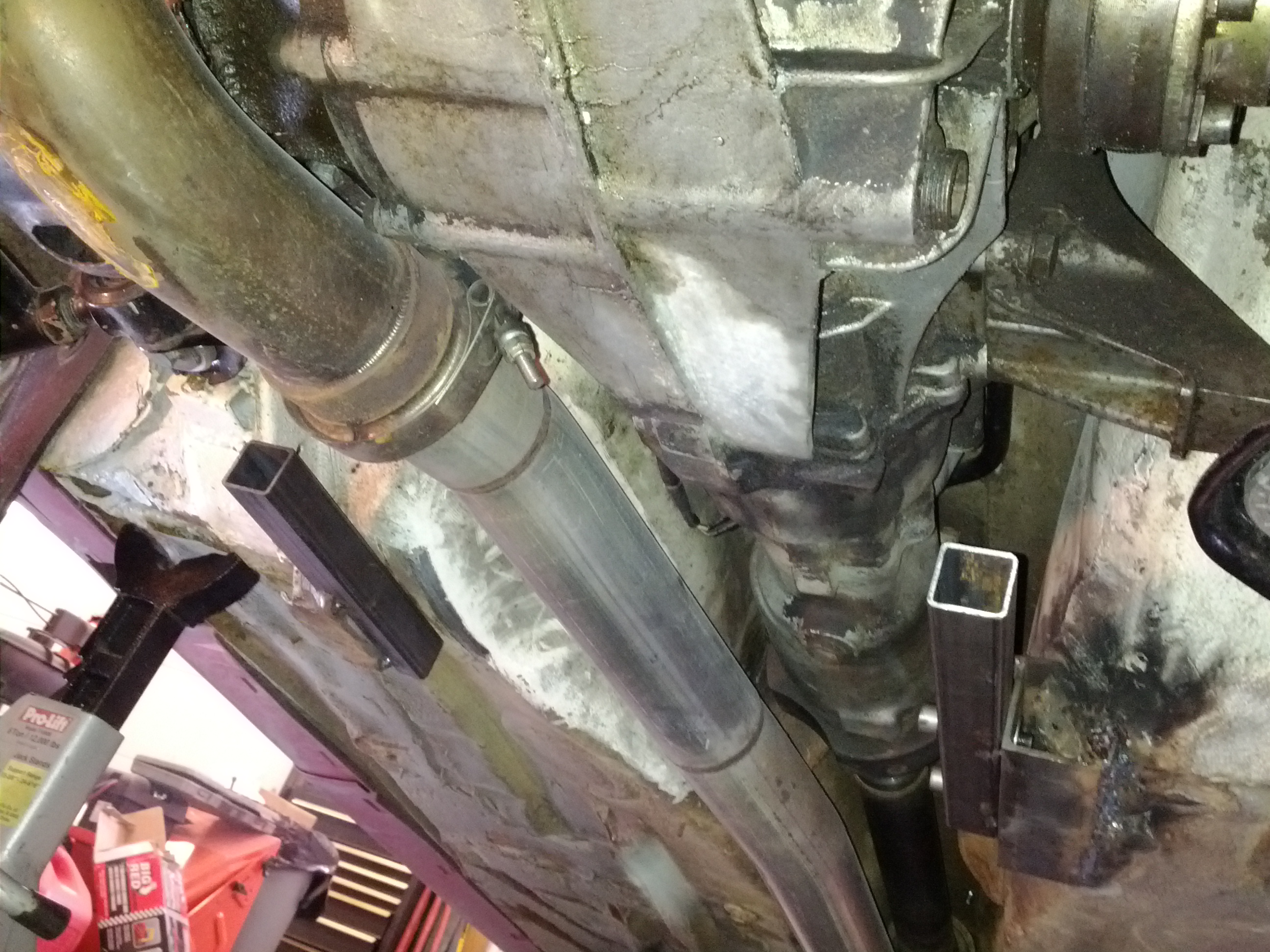

Square tube to the underbody
2012-04-06 16.42.39.jpg (1.59 MiB) Viewed 49386 times
Smaller square tube to the skid plate
2012-04-06 16.43.00.jpg (1.41 MiB) Viewed 49386 times
Slip square tubes into each other, 2 bolts - and you're good (I also have hitch pins that go through the square tube in case I do loose the front somehow)
2012-04-17 20.16.32.jpg (1.21 MiB) Viewed 49386 times

Skid plate is pretty weighty - but it still got bent by a rogue baby head in Saguenay - deflected enough to bend the bolts on the oil pan extension...but the car, with 1/2 tank of fuel and a spare tire came in at 3038#'s

Thanks for posting how you did your skid plate! That's pretty much the same thought I had for the front support. Im thinking of adding another bar across bolted to tabs too for mounting the radiator and IC. That way the upper tube core support is tied in as well, but removable for servicing the rad/IC up front. My cage stops at the fire wall and Ive found out that with out the front end tied together, it twists something fierce with the core support cut out. LOVE the idea for the square tubing in the rear! Can I steal your idea? :)
