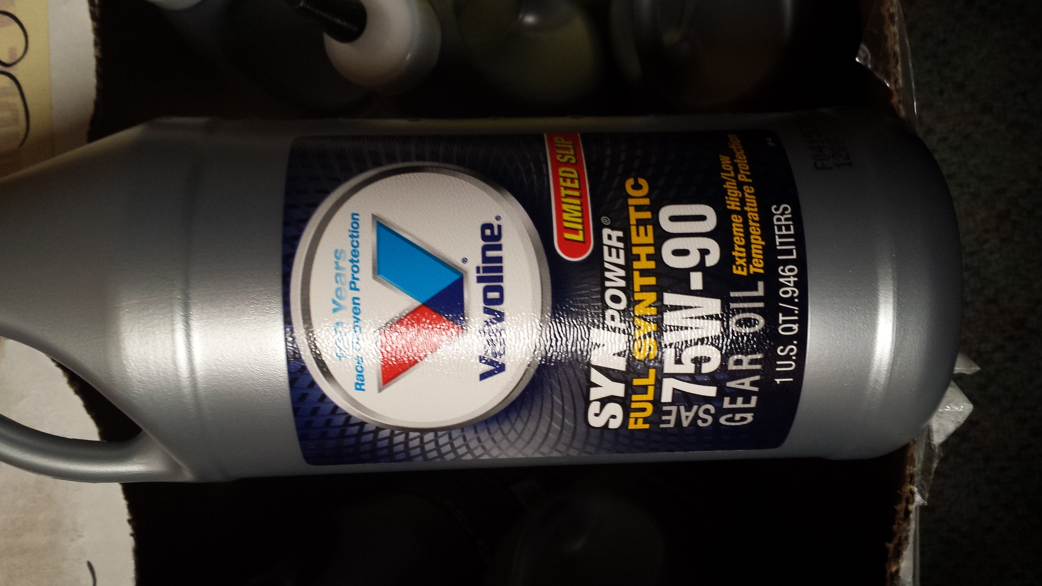

I bought 6 qts of this synpower to do the trans and diffs.
Made an appointment for it for Wednesday next week when I decided to try doing at least the trans myself. Got the fill and 1 drain plug loose but the one for the center diff has me nervous. I want to skip it actually bahaha! Can I ya think?
Anyway it's $65 labor back in my pocket if I do the trans like I want to tomorrow.
Chris, do you have an opinion one way or the other of that synpower? I believe I used it in the trans of the 5000 yrs ago... looks like it's similar to the redline mentioned on sjm. Also, I think I skipped the 2nd drain plug on the 5k's center diff as well :hide:

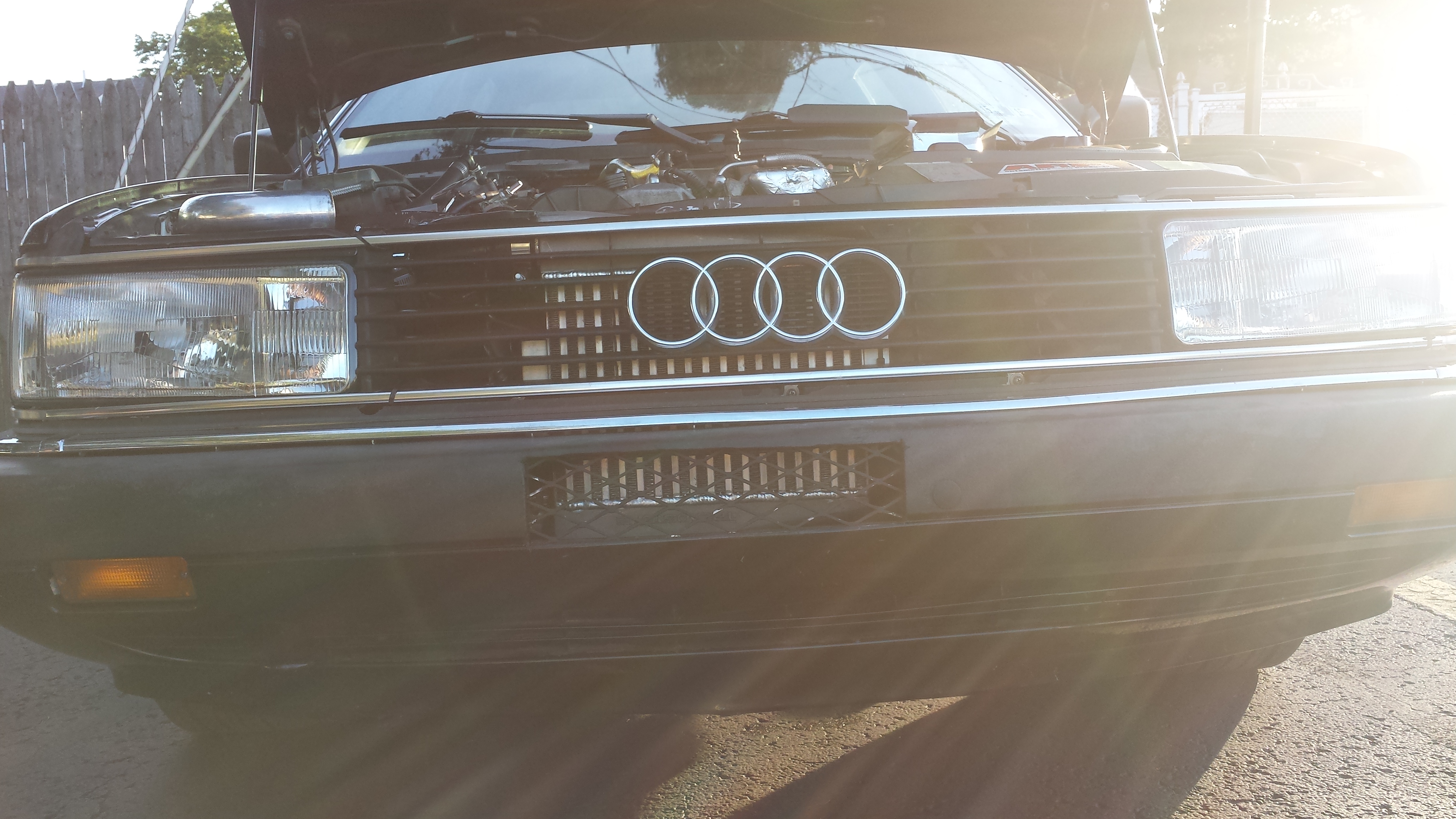

That's the IC with a flat black painted grill to keep birds out.

On the synpower, no I don't really have an opinion. All I can say is that I've had good luck with both redline and royal purple although one or the other made the rear diff in my e46 louder than the other. I can't remember which I went with in the end though. I guess it doesn't matter if you're using that synpower stuff anyway!
Sounds good, thanks. I think what I'll do is back the car up an incline and drain it like that. Maybe down the line I'll drain it again after everything mixes up. I want to change out this crap because when I take a tight radius turn slowly (only time I do), I feel a vibration that seems related to the rear wheels and diff. Last time I attempted a rear diff I rounded out the drain plug. The resulting outboard motor filling strategy that ensued was freakin unbelievable although its still working 4 yrs later hah!
