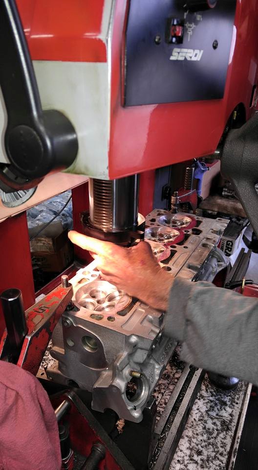

"Revver Head in the Serdi getting the final seat angles cut. Surface cut next and off to the flow bench for final numbers! 34 intakes and 29.5 exhausts. FRP developed custom angles in both seats."

Re: Chris' 200 20v Revver Project
Swweeeeeeeeeeeeeeeet
Love seeing pics of the process.
Jeff's the man!

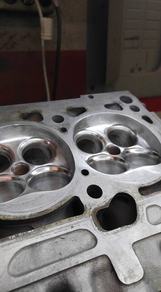

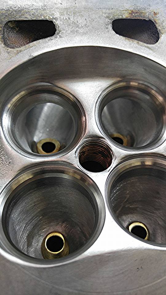

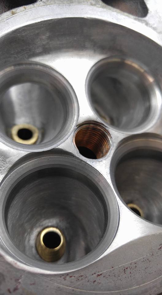

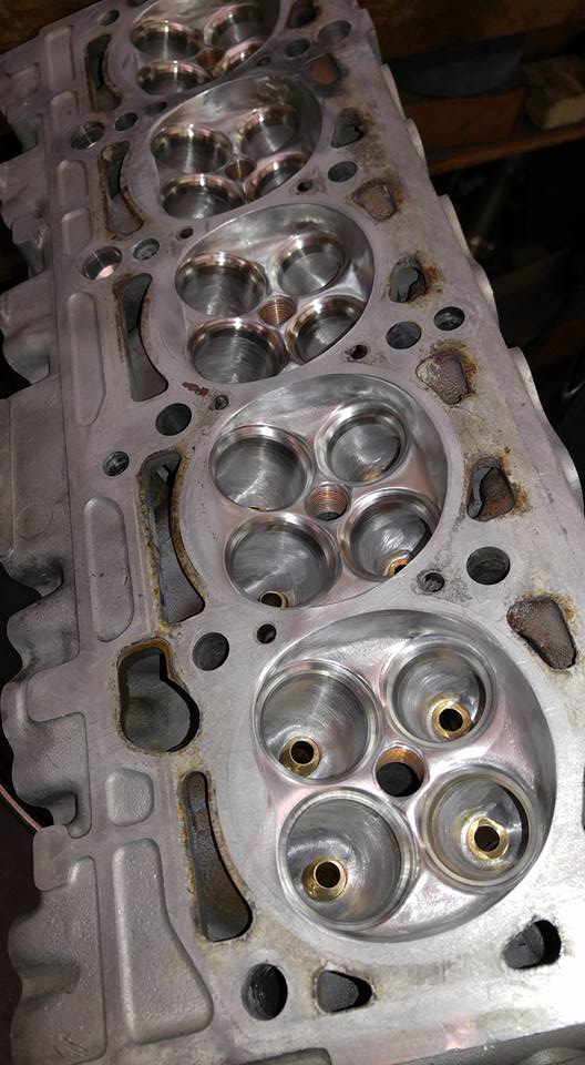

Today has been a fun day of updates from Jeff. The head is officially ready to go on the flow bench.
"Revver Head with raw valve seat machining and sharp edges and after Chamber Finishing. Four more chambers to go and onto the flow bench. Still needs surface cut but won't do that till all the solid lifter set up is complete."
"3 chambers done only 2 to go."
" 'The Revver' cylinder head is ready for the flow bench. And boy am I glad! This work is friggin tedious but needs to be perfect. I expect flow numbers to exceed the Bonneville motors numbers. Tomorrow we will see! Muahahaha."

Hot damn, you couldn't fit more valve in there if you wanted to!
