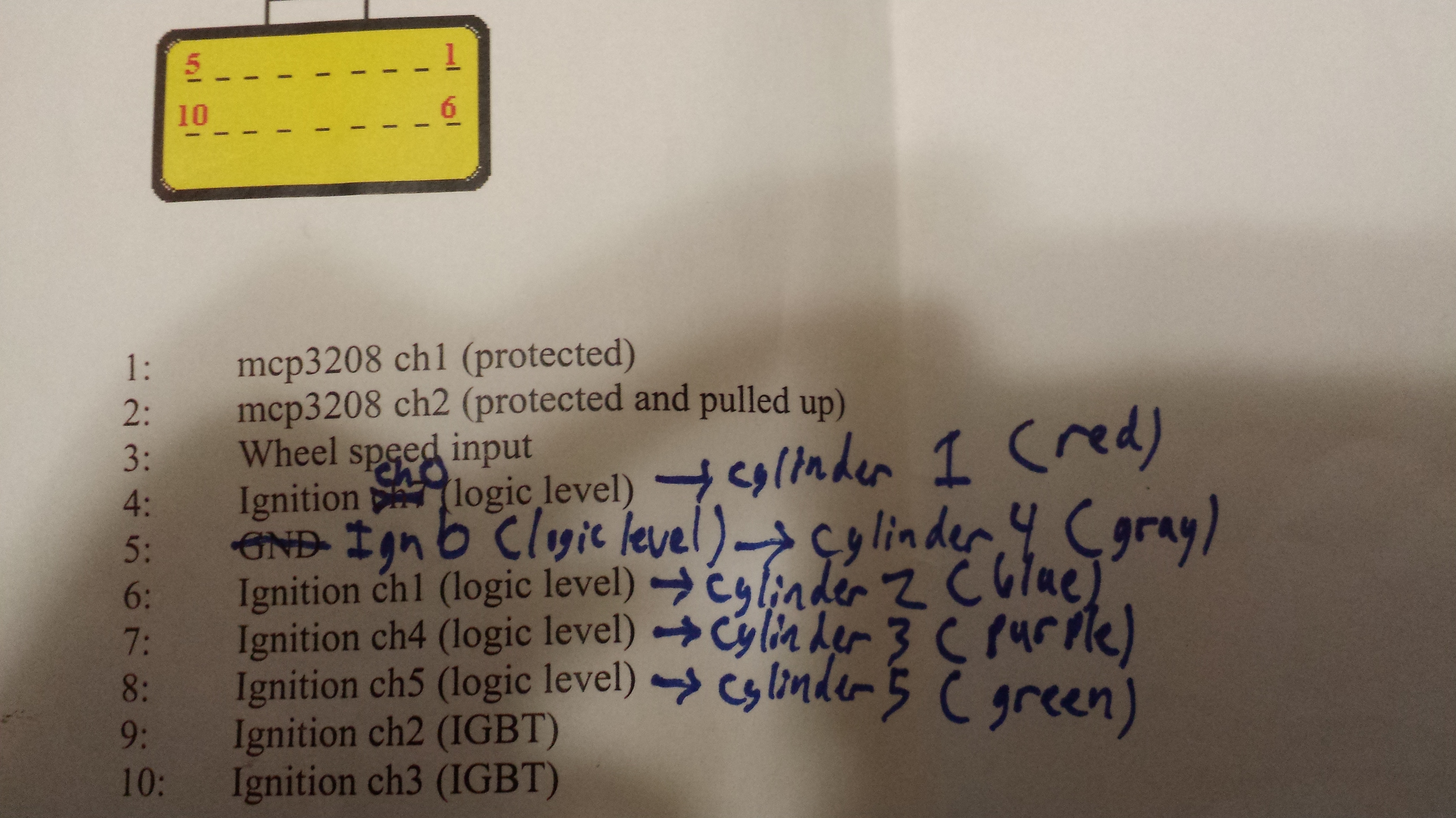

Marc, according to this pin out sheet I received with VEMS, is my launch control going to be activated when I ground out pin 2 shown below? One more question (well 3), do I disable launch status output settings and enable launch speedbase control while leaving input selector as WSPeed 2? Thank you
- 20150430_204907.jpg (3.02 MiB) Viewed 36507 times
Re: VEMS launch control RPM off
yeah, you will use pin 2 in your case to activate launch control. on the config screen set the input channel to #2.
you dont need the speedbase stuff, just disable that as well as the status output.

Cool thanks again. Sorry for the minor thread jack. Although now you all know which channel to ground from checking your pin out sheets.
