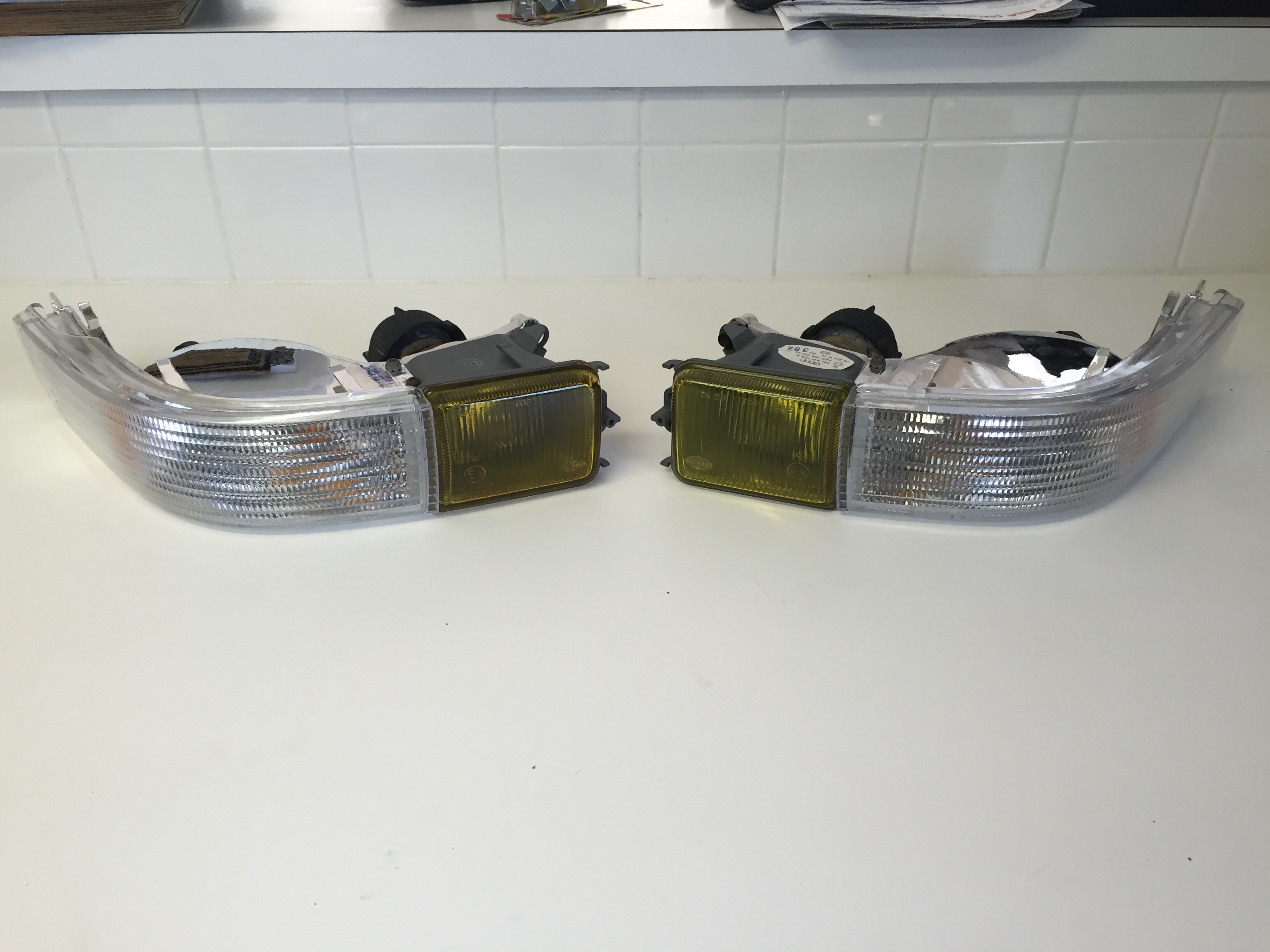

2.5TYPE44 wrote:I might have a deal on these mega rare amber D11 V8 fog lights. Whenever I get my car back, I will see if they will look ok next to the clear turn signals. These were supposedly a limited edition for D11's in France. Here is the only picture I could find of them. I'm thinking it will look better next to the CAC clear turn signals rather than the standard turn signals.
If you didn't find I can take a look, I know a few people that may have those ;)
Don't forget you have a few frenchies on PP guys, we may be helpul ;)
And just "for science", in France, until early 90's, cars had to have yellow beams (ou yellow tainted glasses)
For exemple, this E36 is "OEM"
2.5TYPE44
Posts: 461
Re: Josh's 2.5 200QT.
Post by 2.5TYPE44 »
If you can find a set, I definitely want them. I have been trying to contact the person that I know has them but he only answers his phone every couple of months. It would be much appreciated.

Just got a new set. I think it's going to pretty good looking and definitely rare. Now I need to do the 20v fender/V8 front bumper conversion I have been stocking up on to use them.

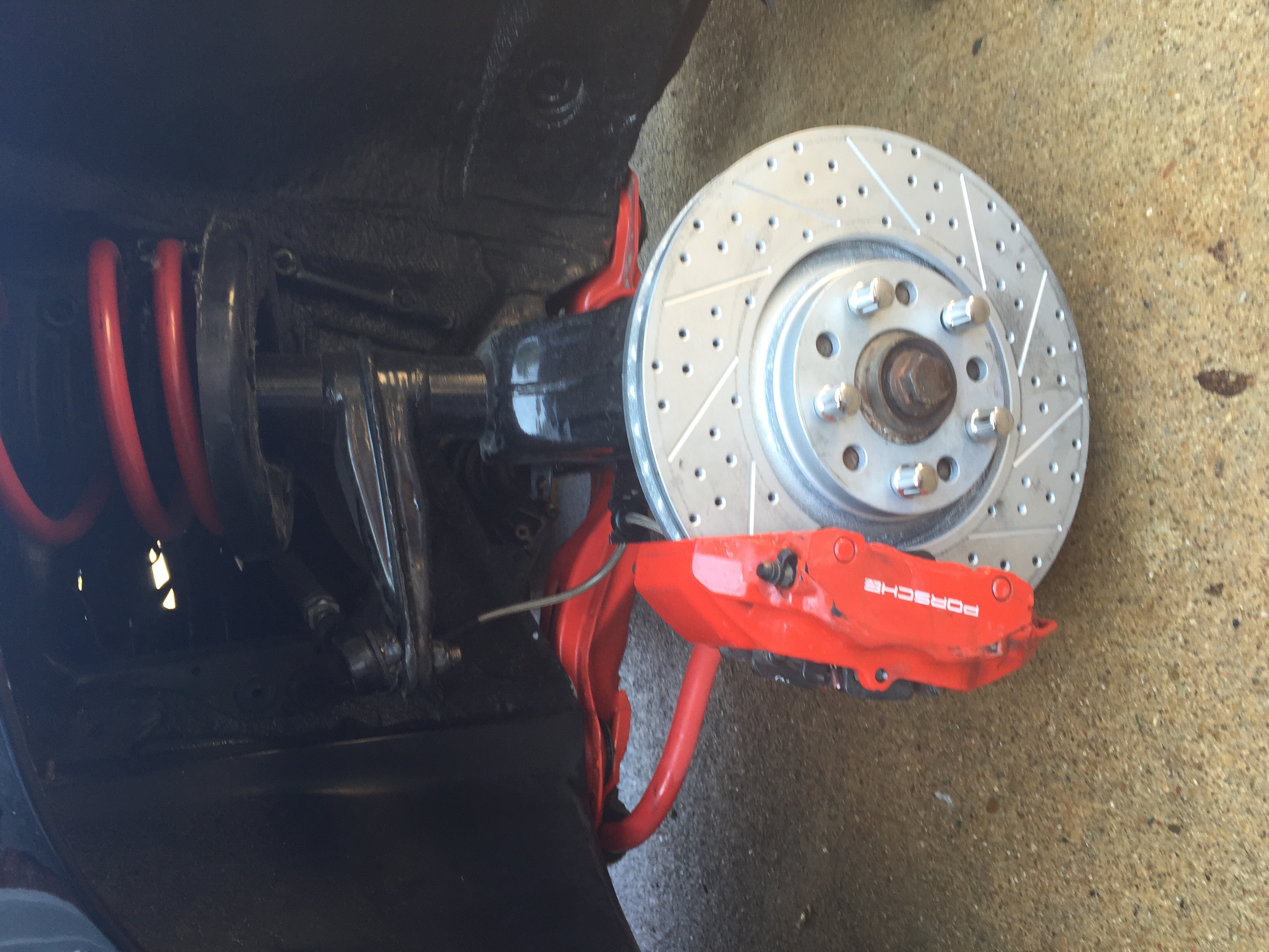

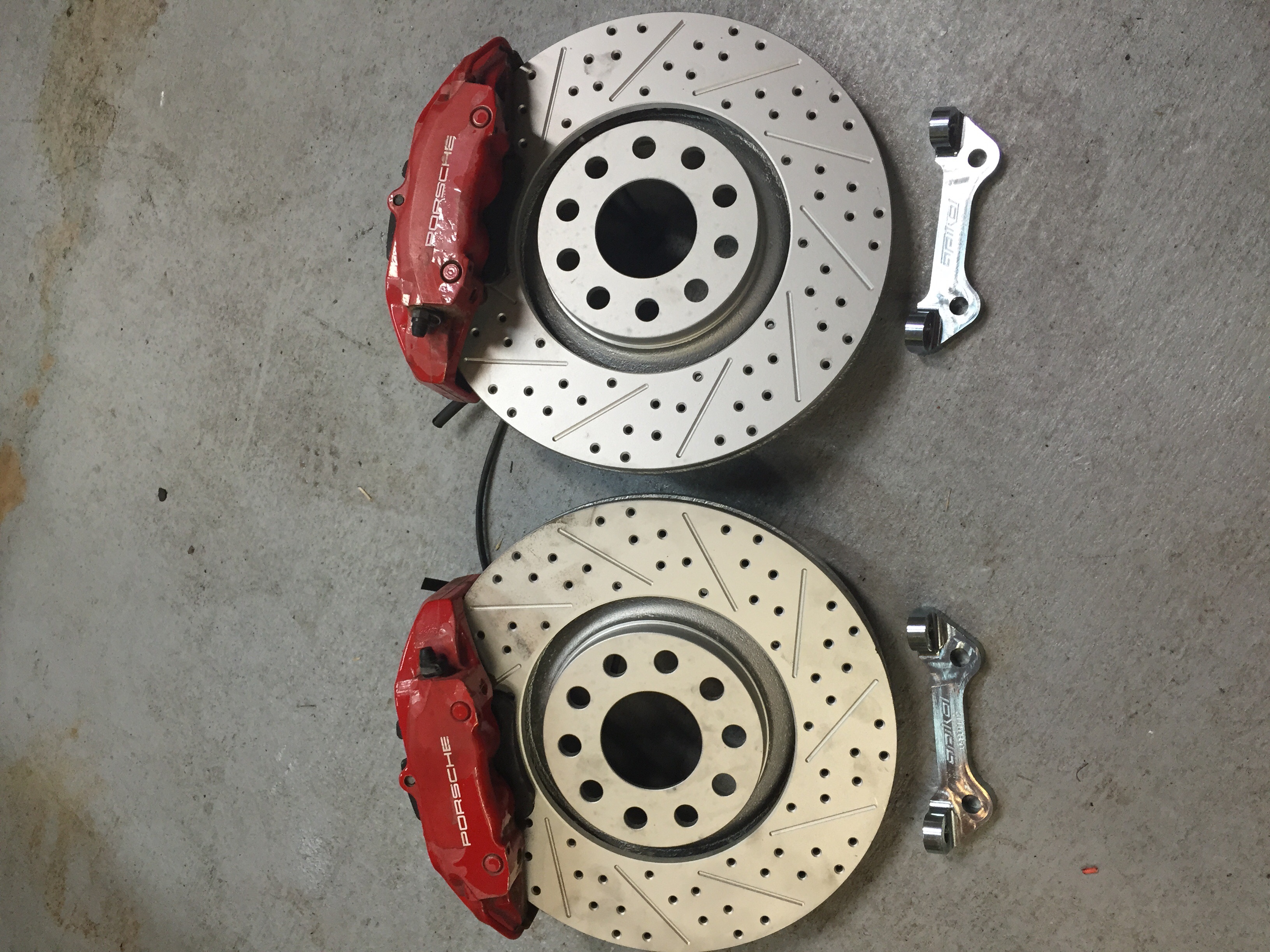

What about brakes?
2.5TYPE44
Posts: 461
Post by 2.5TYPE44 »
:D Like these...

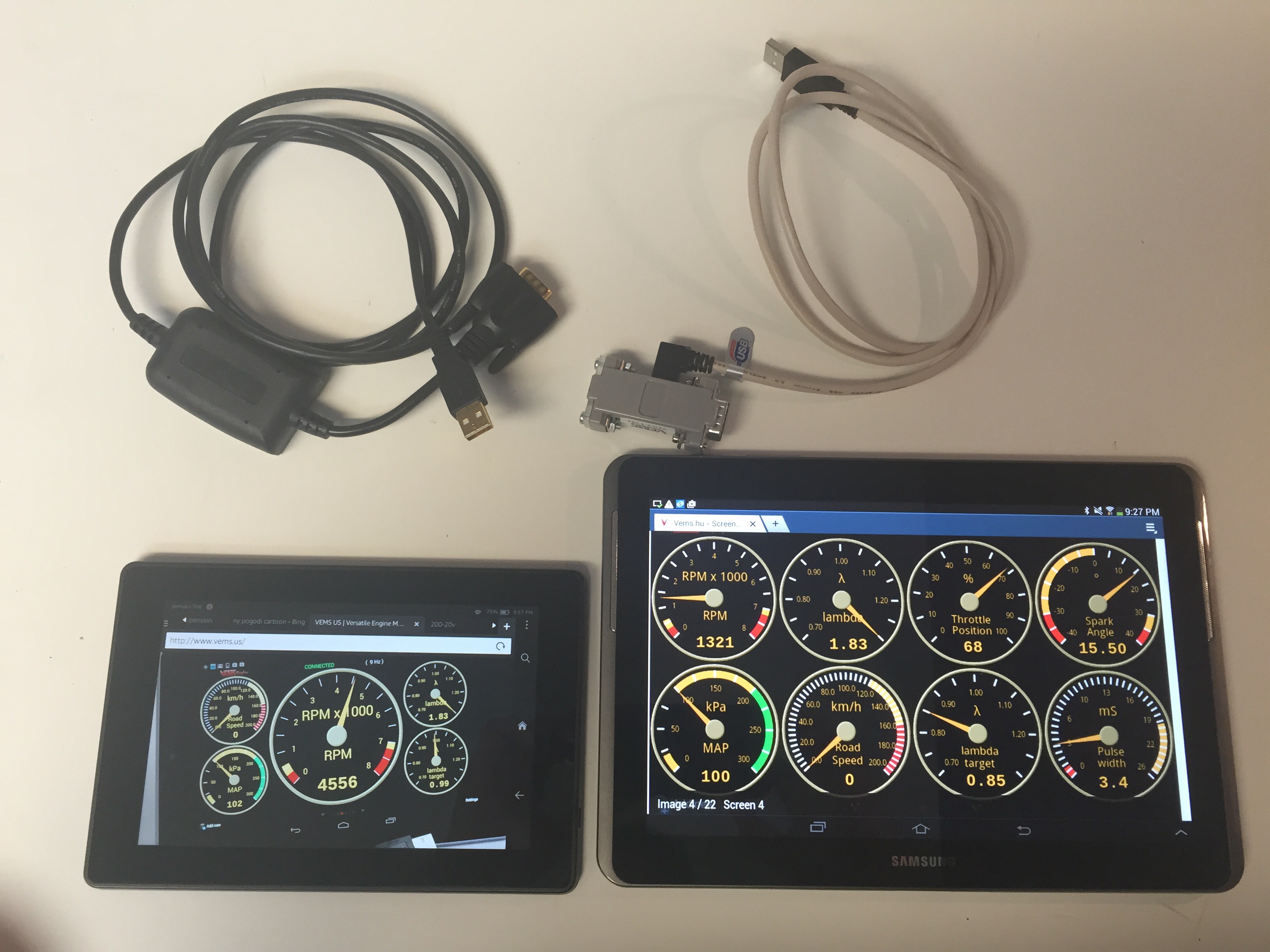

My VEMS Bluetooth adapter and power cord came in today. I also found a 6 foot long USB-serial cable at Radio Shack for $24.00 to connect to the laptop.

French V8 fogs and CAC clears...

I have a couple days of delay. I'm waiting on longer wheel bolts. I ordered them from ECS Tuning and they should be in on Wednesday. When I put larger brakes, I had to get 8mm spacers from Apikol for the wheels to clear the Porsche 996 calipers. The 8mm spacers make it where I have to find longer bolts and I couldn't find them "on the shelves" at any local stores in Houston. Bigger brakes were mandatory. There were hot molten specs of steel flying off of the rotors and embedded themselves into the aluminum wheels when they hit. Soon though. I also ordered more Wilwood racing brake fluid that has a boiling point of 417 degrees ferenheit. I also put some stainless steel brake lines.
