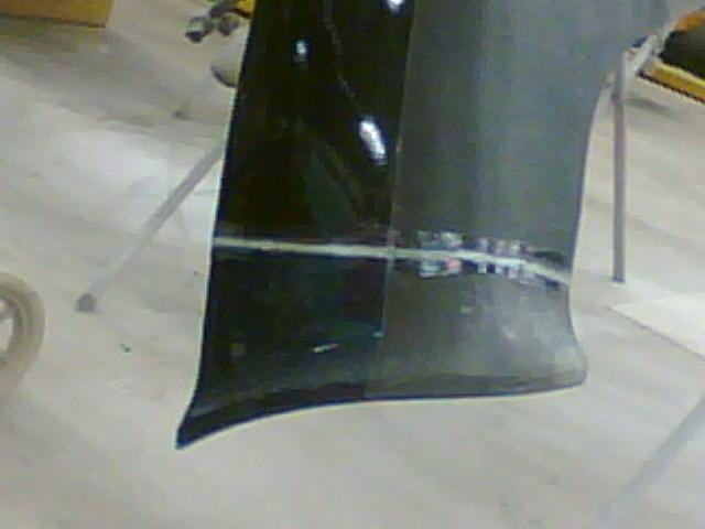

I opted to do this. A6 cover with my old S6 ends.
- 10822389_10152458135386771_1079795471_n.jpg (21.4 KiB) Viewed 20448 times
